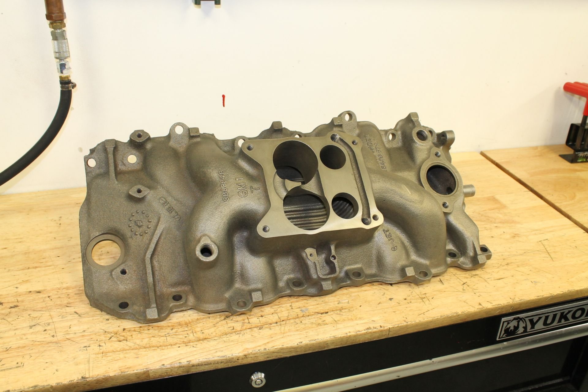

The intake I will use, factory 1960s 396/427 cast-iron Q-Jet intake.

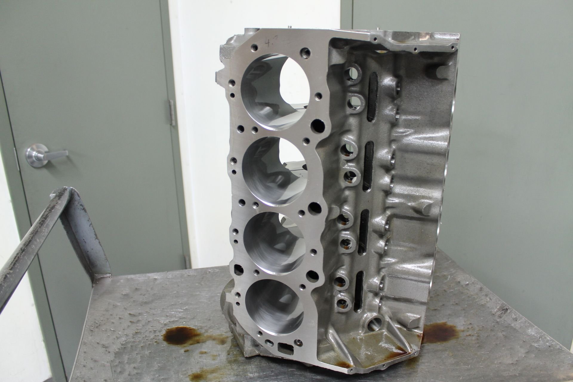

The block.

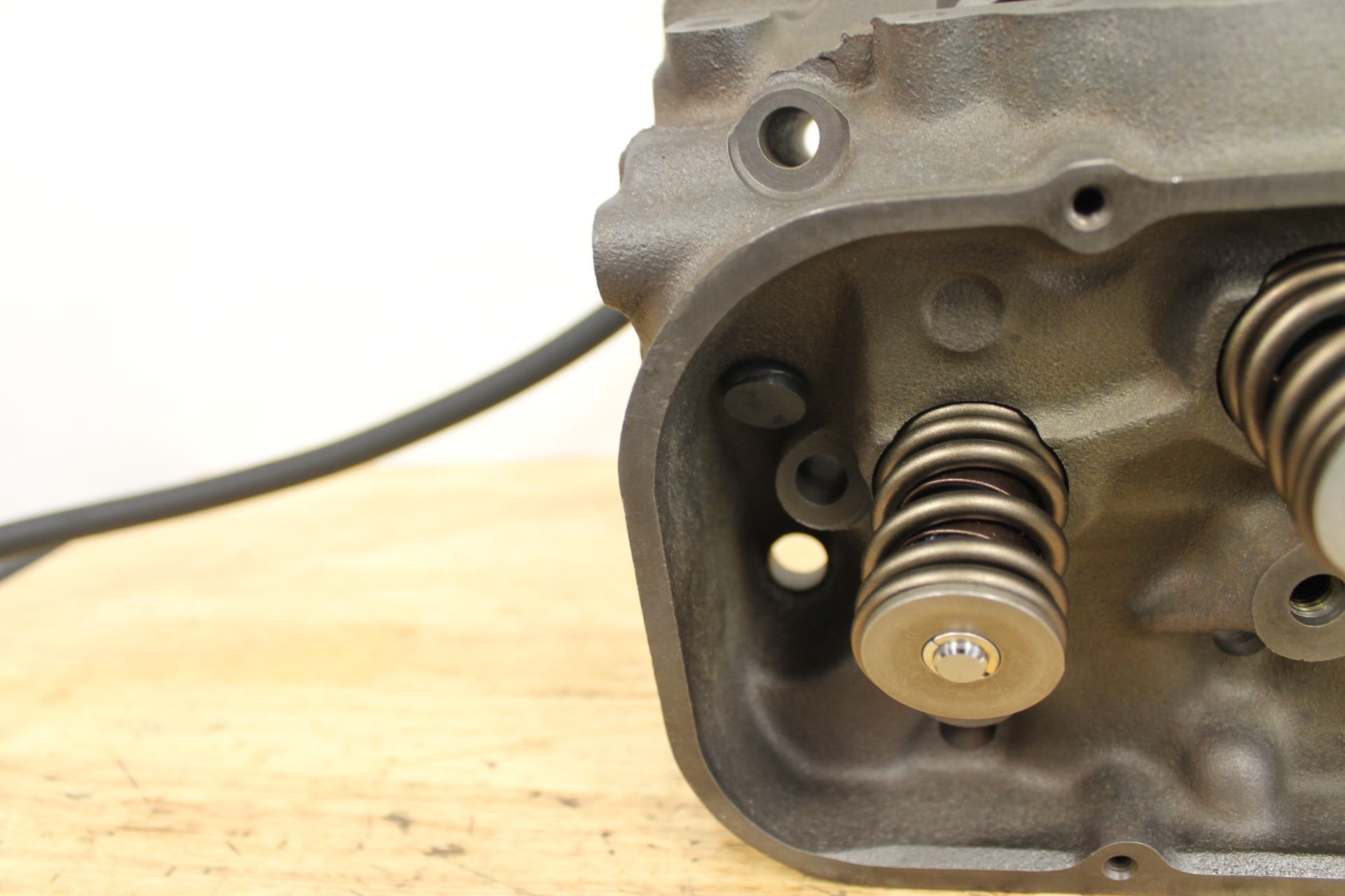

More than a bowl blend, less than fully ported, I'd say, flow was 292 CFM @ .450 lift @ 28 inches.

I assume the “notch” or clearance work at the top of the cylinder bores is to deshroud the valves?
Old Apr 11, 2021 | 03:30 PM
VORTECPRO's Avatar
Joined: Aug 2012
Posts: 1,878
From: Thousand Oaks Ca
Yes, thats what its for.

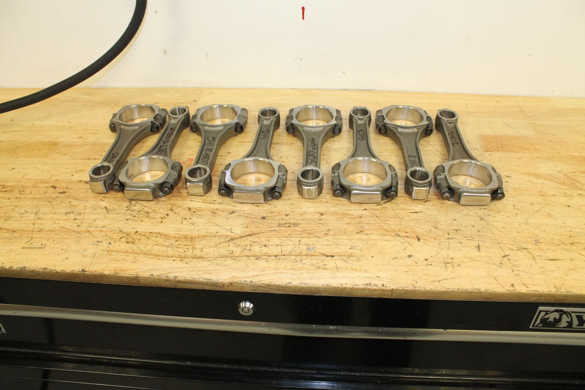

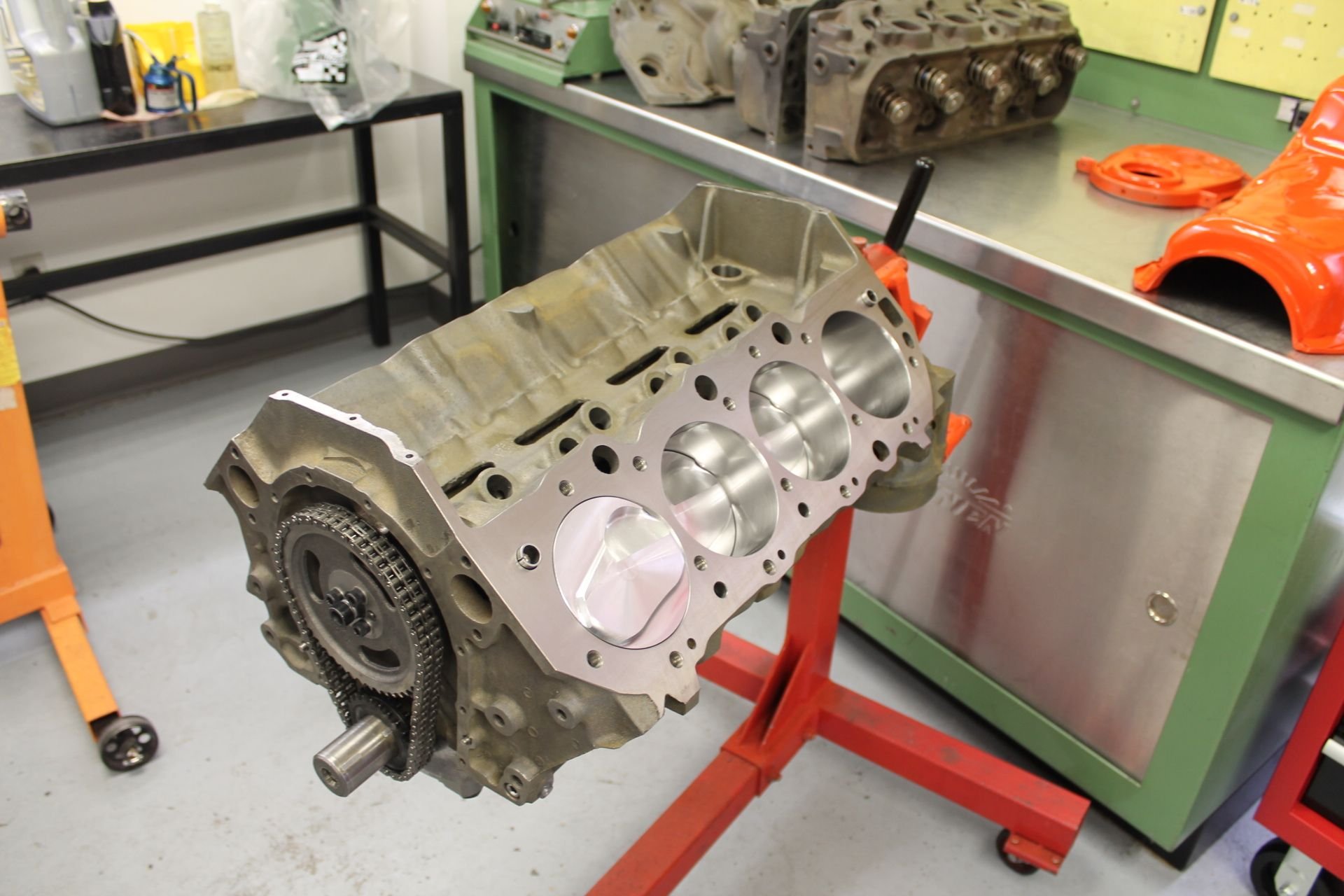

Pictures of the short block and cam timing setup.
Old Apr 11, 2021 | 08:27 PM
Battenrunner's Avatar
Joined: May 2018
Posts: 782
Looking good on the pics of the parts with the shortblock....
Have you degreed the cam yet?
What is the planned ICL that you are going to aim for?
Carb plans for this one?

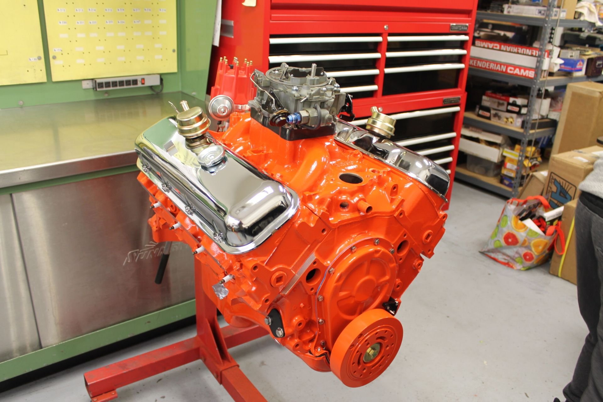

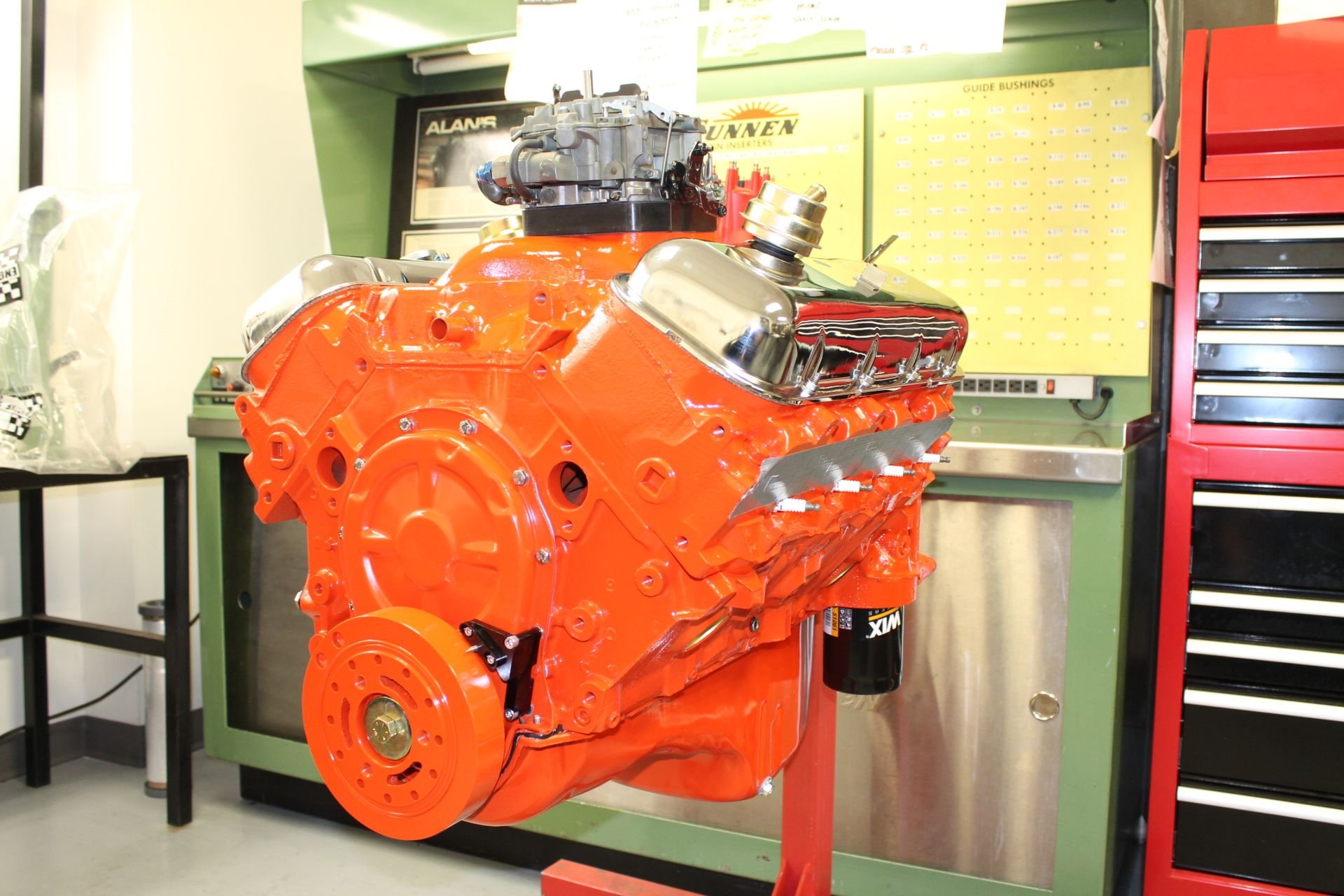

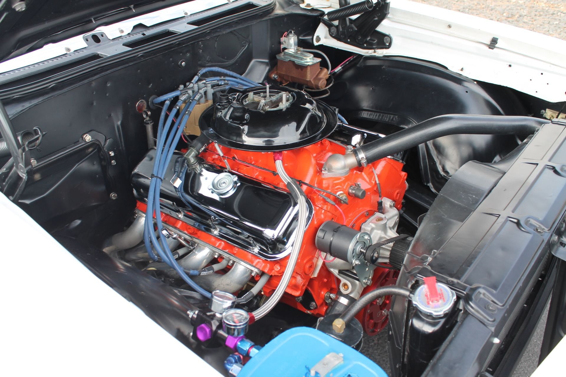

The finished 427, dyno test next.

Looking good! Cant wait to see and hear it run!

On the dyno trying different Q-Jets. Very smooth stock idle, just what I wanted

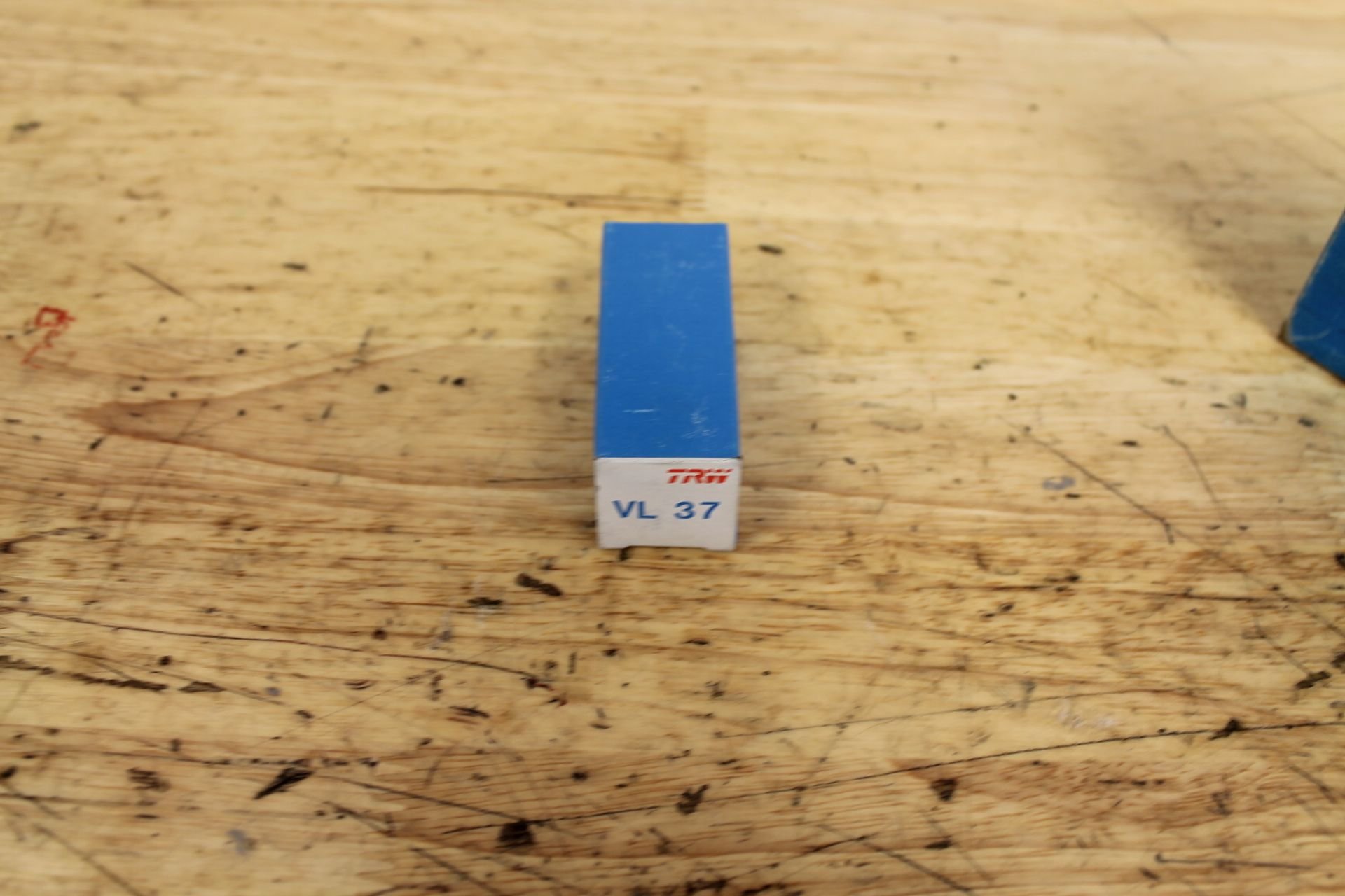

40.00. TRW lifters craigslist
