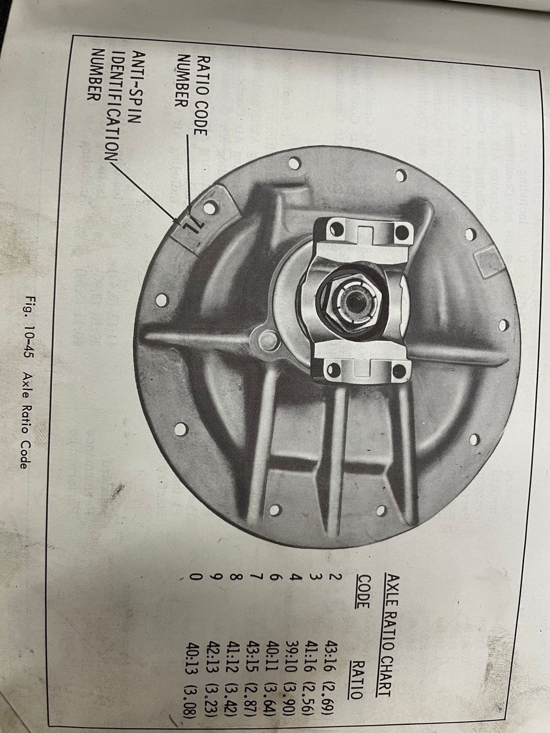

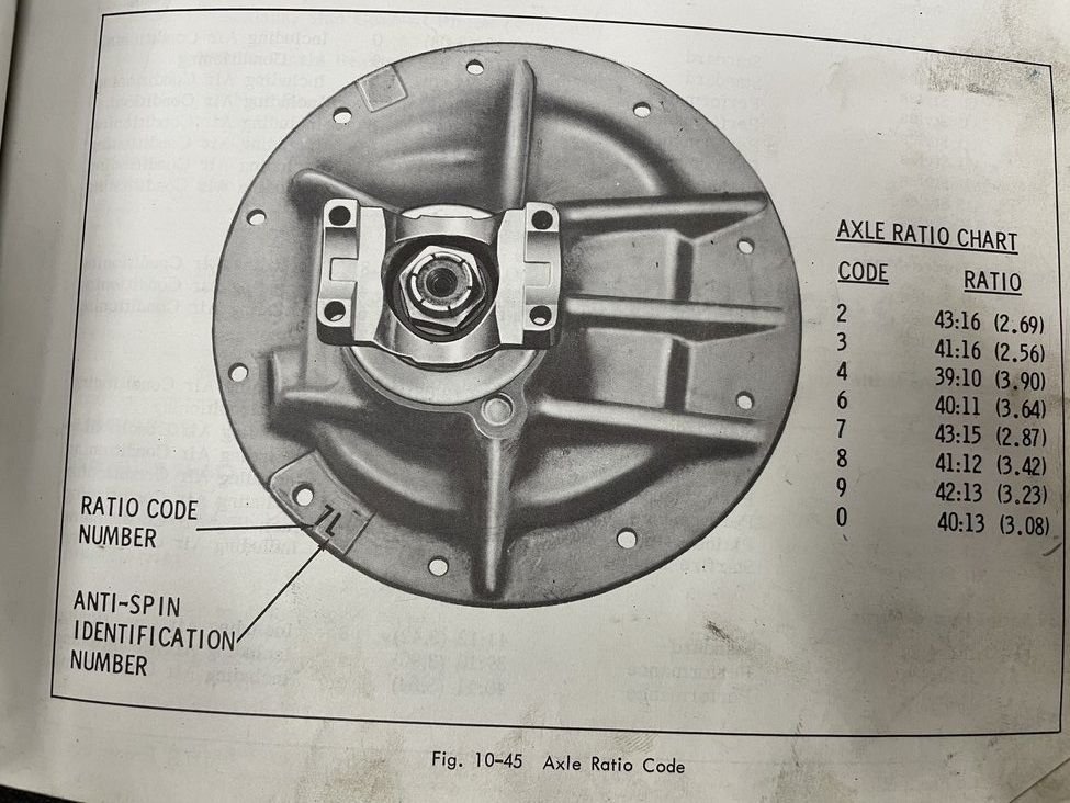

The diff carrier is stamped with a number on the outside flange where it bolts to the axle housing .
It will be in about the 7 o clock position as you look at it from the front.
The axle codes are listed in the 1964 Oldsmobile Shop Manual.
The letter "L" stamped next to the code number designates a limited slip (posi) differential.

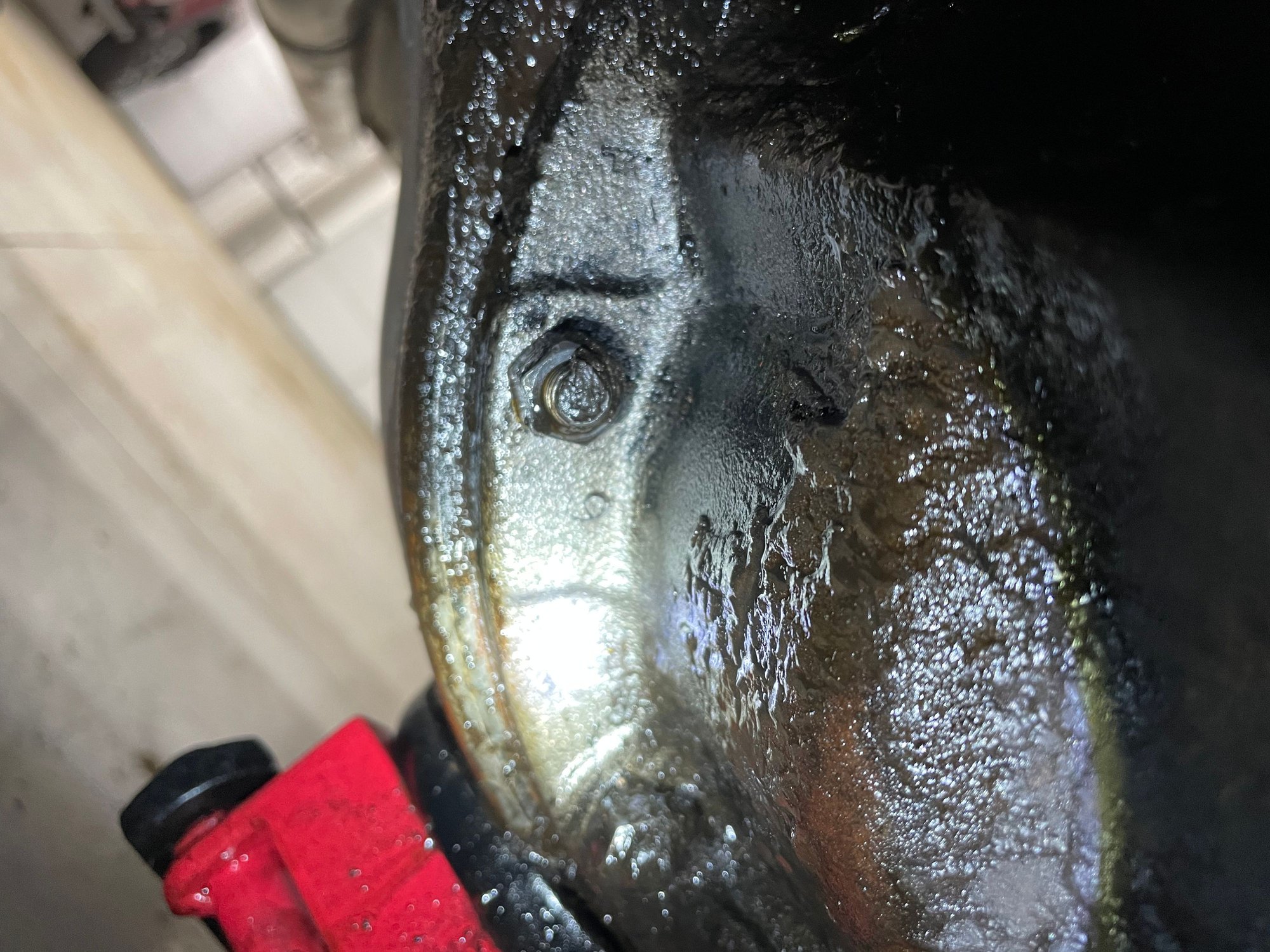

Okay, so I have a 9. (3.23)
here is the chart for anyone that might need it in the future.
