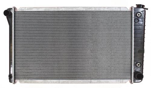

Look at the specs on this and see if it would work.
https://www.oreillyauto.com/detail/m.../oldsmobile/98

Hi thanks for the input
This Rad is a 3 core and one end tank is 3 1/2 and the other is 2 3/4 where it sits in to the pads.
i had it cleaned and rebuilt since i could not find one but this did not hold up.
i went to Autozone and they pulled A302 and A165 and both of the tanks were the same size.
but the pic for the A302 looks like a all copper rad and with offset tanks so there pics are wrong.
i did find this on summit SUM-382024 $318 but i dont know what size the tanks are.
if worse comes to worse i could cut and shorten that 3 1/2 inch pad
and make the A302 fit
it has a life time warranty but i dont want to be swapping it out every few
years.
has any one had good luck running these plastic and aluminum ones?
thanks
Old Aug 6, 2017 | 07:37 AM
Posts: 50,802
The one in my truck is now 18 years old and has 275,000 miles on it with no issues.
Old Aug 6, 2017 | 07:44 AM
The one in my Cutlass is over 8 years old and doing well. Had one issue with the plastic drain ****, replaced and all was fine again.
Old Aug 6, 2017 | 08:09 AM
The Flash's Avatar
Joined: Apr 2014
Posts: 79
From: Dallas
talked to a guy at Kellers yesterday with an old nova and plastic Rad and he also said he has no issues
thats what i needed to know
ill go get that A302 and make it fit
thanks
