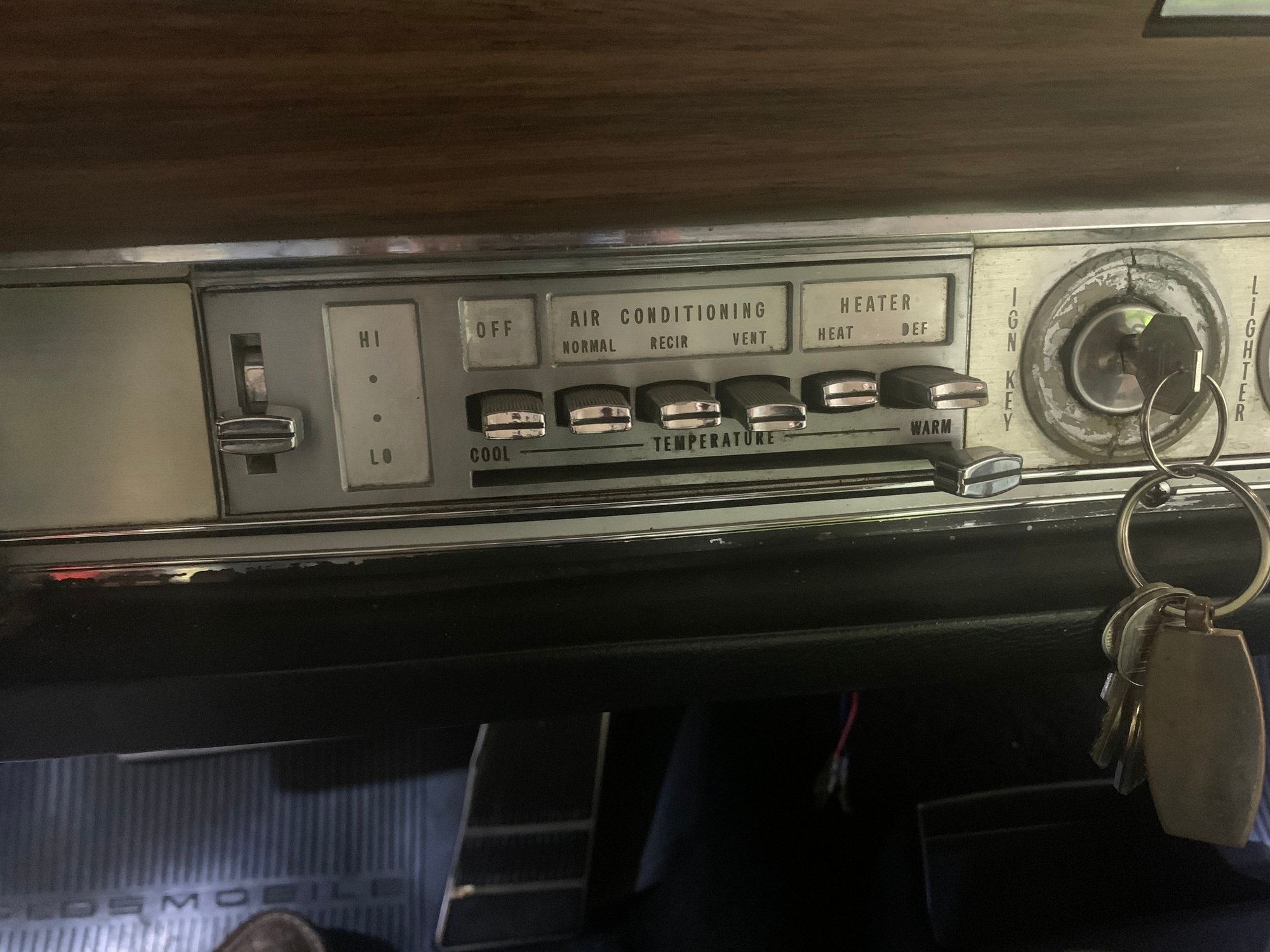

The other day on my 1968 Olds 98, I tried turning on the heater with the engine warmed up, but it was only blowing cold air. The heat button was depressed and the temp button was moved all the way to warm. Where should I start checking to diagnose the problem.

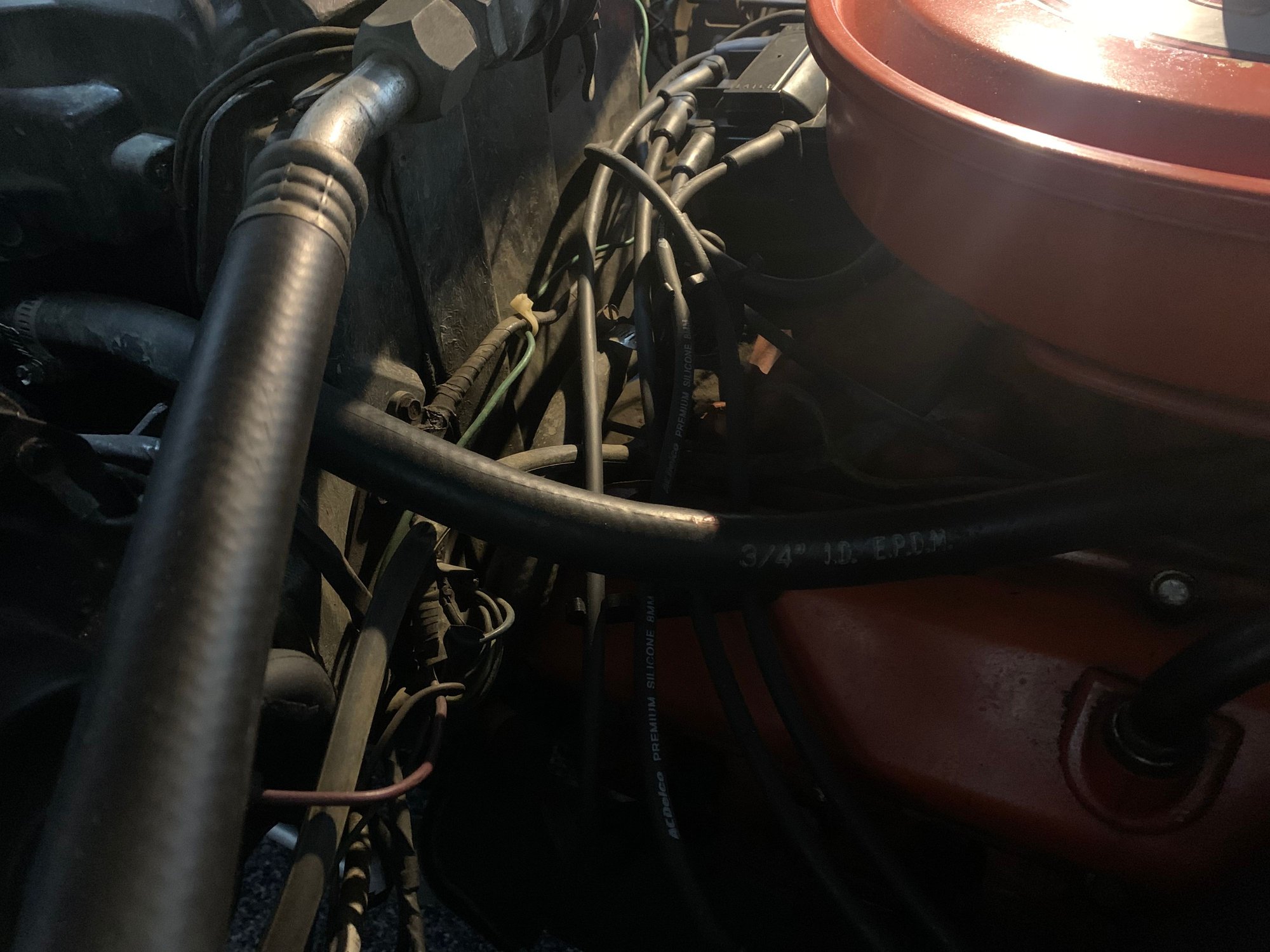

Here is the info so far. I purchased the car in Aug 2020. Being summer I only checked the A/C. The only time I knew the heater was not working when we replaced a busted radiator hose and when we turned on the heater we found there was no hot air.
I have attached some photos/videos. The heater hoses are connected. I need to start up the engine, warm it up and then check if they are hot.

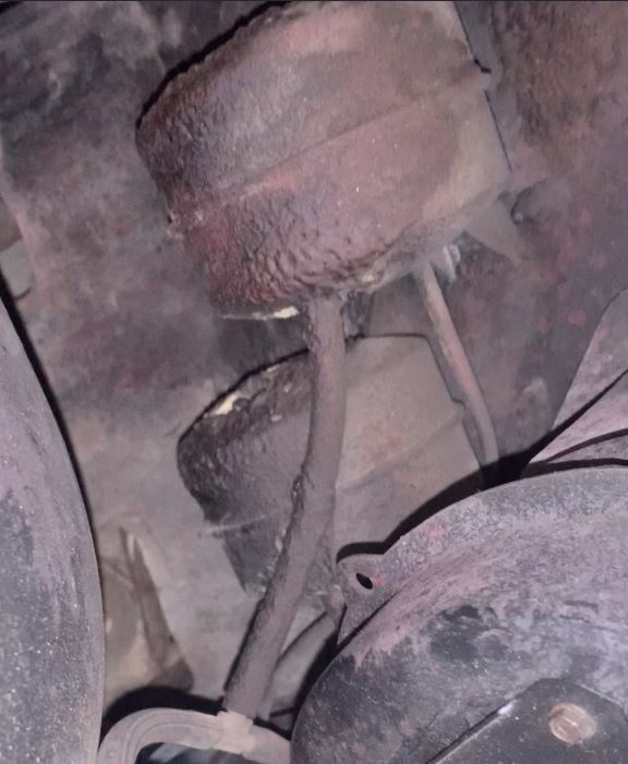

The picture of the blower motor shows no vacuum hoses connected???. The vacuum hose from the engine is connected to the vacuum tank and then goes inside the dashboard. Why are there two vacuum tanks as seen in the video.
all these vacuum hoses in the engine compartment are black. I will take pictures of the hoses under the dash later this afternoon and have noted the colors.

The picture of the blower motor shows no vacuum hoses connected???.Why are there two vacuum tanks as seen in the video.
An excellent question. Both look old and gunk-covered. I'm wondering if a prior owner "replaced" the original vacuum ball by simply attaching the new one to another spot on the firewall and just leaving the old one in place. It's not easy to see in the photo, but are both vacuum tanks hooked to something? Whatever's going on, what I would do is remove both of those old tanks and install one new one.
I didn't find a vacuum tank specific to your car, but Autozone does show three different ones available. You might take the old one to the store with you and buy the one that matches most closely. You might try other vendors as well.
Of course, one or both of the tanks on your car now might actually still work. You can check it by removing the outlet side vacuum hose and attaching a vacuum gauge to that port. Start the engine to allow vacuum to develop in the ball, and check that vacuum actually develops. If it does, shut off the engine and watch the vacuum gauge. It should hold vacuum as that's the whole point of the vacuum tank---to provide a reservoir of vacuum. If one of the tanks works, clean it up and reuse it.

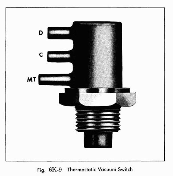

Here's the relevant information about the thermal vacuum switch from the '68 chassis service manual. (If you don't have one of these, that should be your next purchase.)

The vacuum switch Jaunty posted decodes as: D port goes to distributor vacuum advance, C port goes to ported vacuum source on carb, MT port connects to full manifold vacuum.
