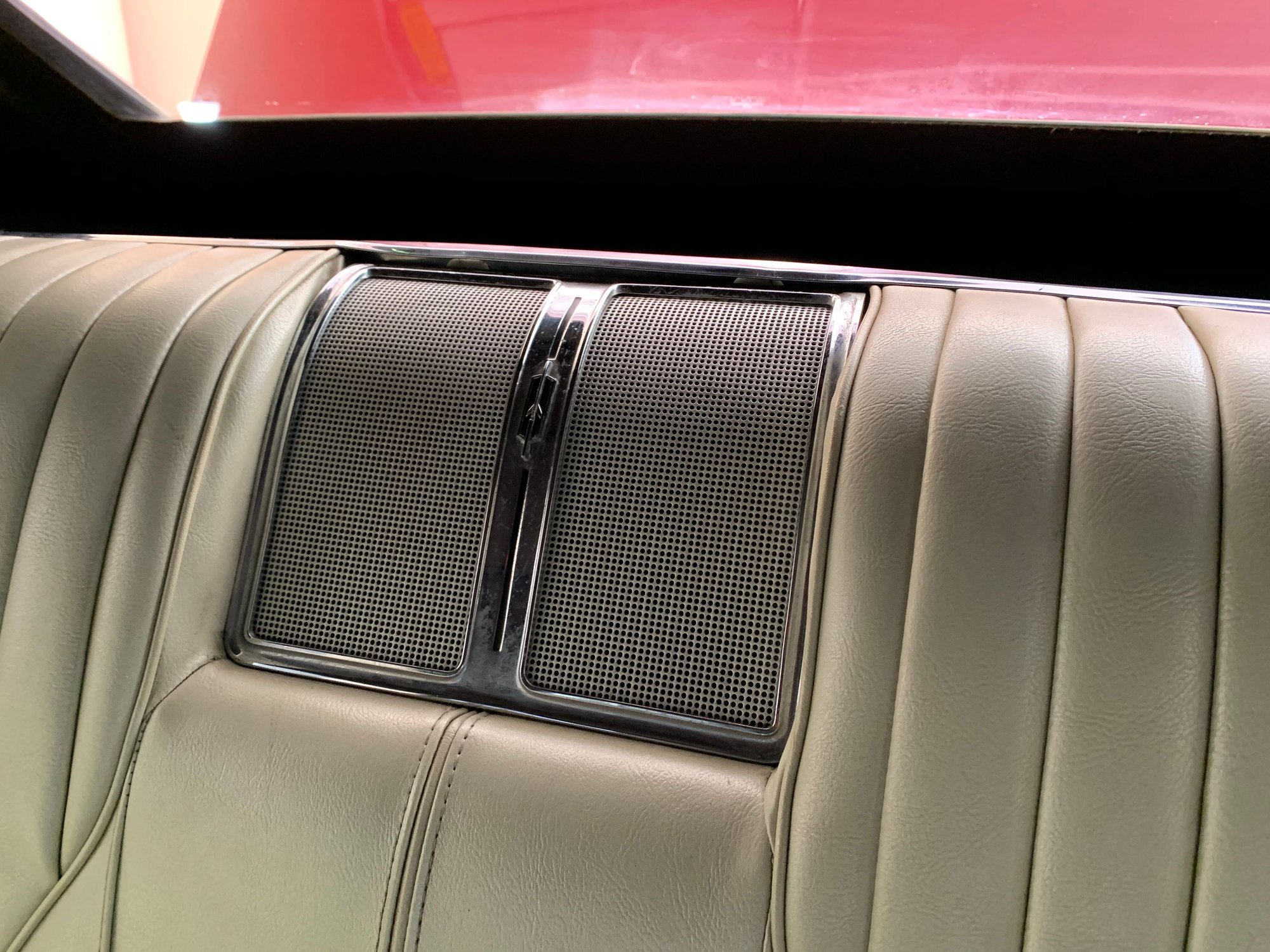

Replaced with new radio and speakers
The Geek Squad at Best Buy were very helpful and managed to replace the radio and speakers on my 1968 Olds 98. Since I had the annual tech support, it included free installation of radio and speakers.
This was the old radio in the car that did not work.
This was the new radio from Classic Car Stereo that they installed. To remove the radio from the back, they had to remove the A/C duct.
The rear speaker located in the rear seat back
was replaced with Kicker CS speakers.

The rear speaker has two speakers in it - one left and one right. You can see it in the picture.
Old Jan 6, 2021 | 04:18 PM
jaunty75's Avatar
Posts: 15,116
From: southeastern Michigan
OK. I didn't realize those were each a different channel.
