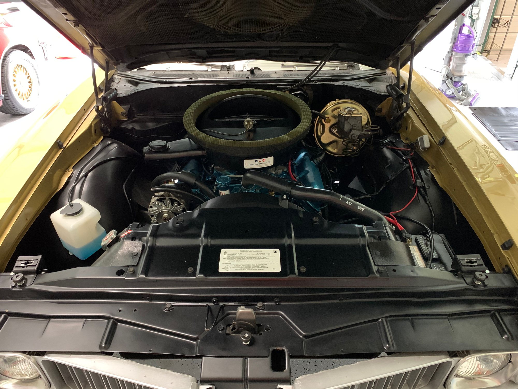

Hi
does anyone have a good pic of vacuum line routing for a W25 AOI aircleaner?
mine is not hooked up and can I use any port off of the carb?
Adding pics
Racecarguy1968
Find More Posts by Racecarguy1968
Feb 17, 2020 | 06:54 AM
joe_padavano
Mar 2007
50,802
Northern VA
It just tees into the line that feeds the vacuum actuator in the snorkel. It's just a manifold vacuum connection, so nothing special.
