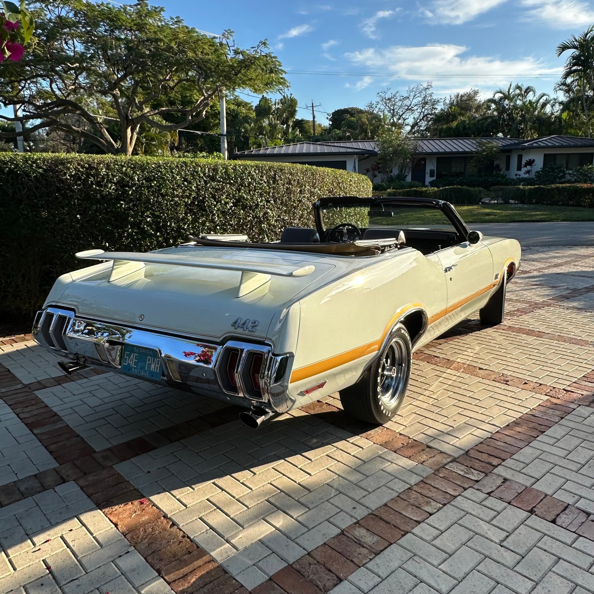

So after a exhausted search I finally was able to purchase this 442 what is the best way to check its history. Does the GM heritage center provide that.
What are your thoughts the car had a frame off Rotis about 10 years ago. I've put about 200 hundred miles on it it needs very little work

Nice looking car. The deck lid wing on a convertible is totally wrong, though.

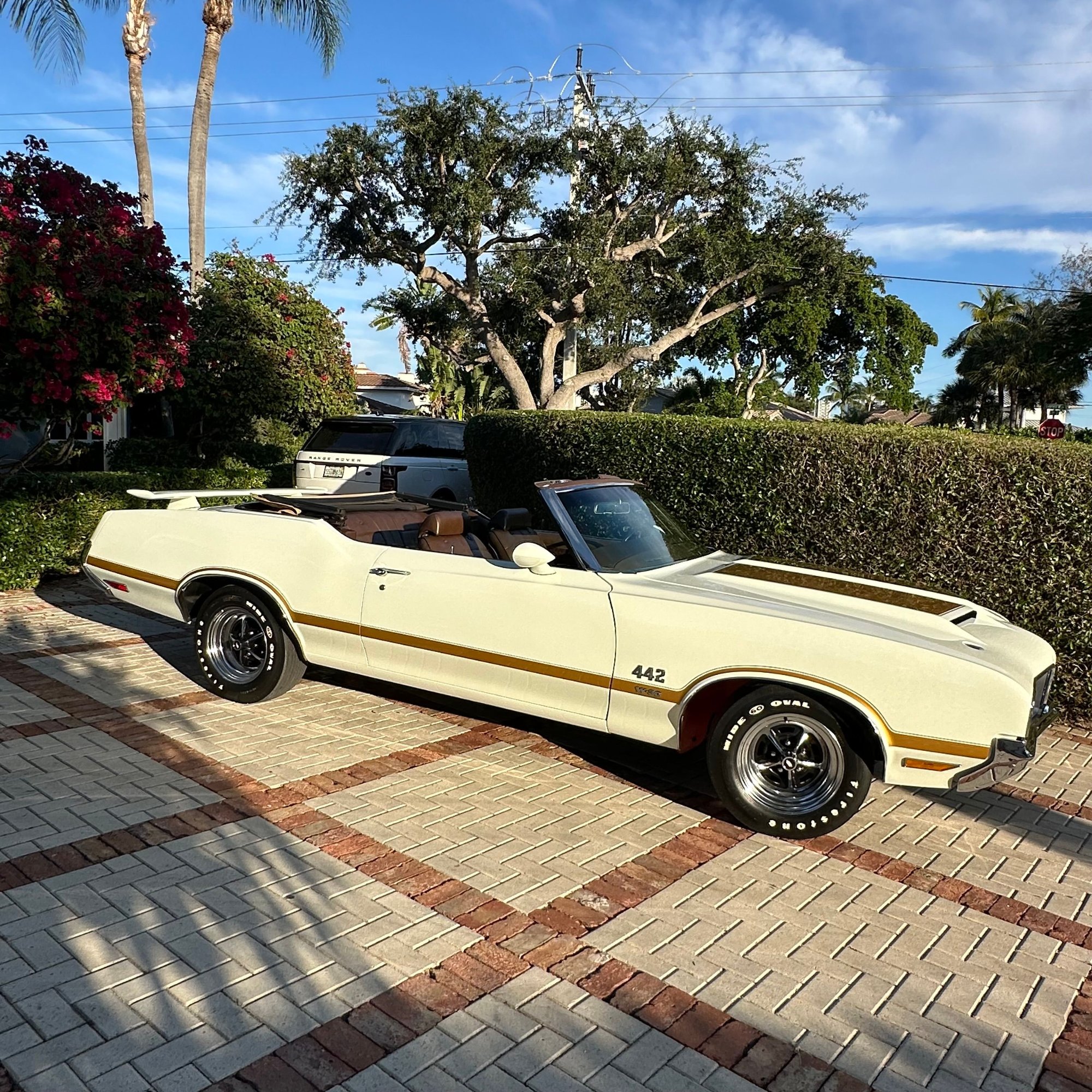

It's been repainted from Galleon Gold originally.

yes it was noted as a color change the paint work is flawless the stripes are painted on. very little work needs to be done radio does not work clock sweep hand works but not the hour and minute other wise its in very good shape has had very little miles since the restoration
