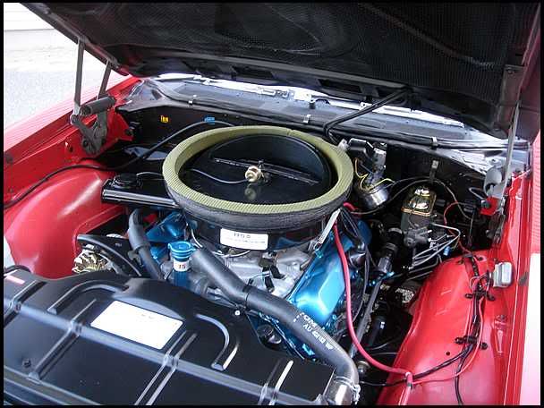

The OP didn't specify what year/model we're talking about, but most GM cars used a power brake booster that's about the side of a pie plate (about 11" in diameter) and about 5-6" thick. It will be bolted between the firewall and the master cylinder.
With power brakes (note the gold-ish round booster at the right of the photo):
Without power brakes:
