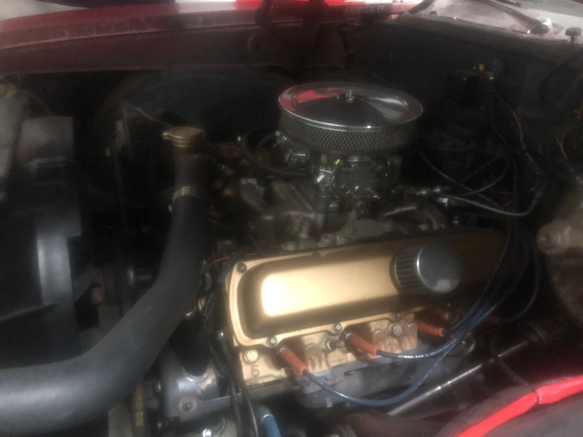

question for everyone here is what should I do next? It has a newer 350 but was not built properly as compression is off a bit (so I have been told).

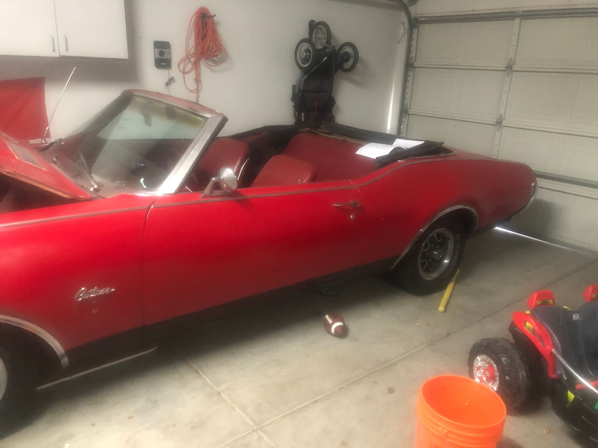

convertible top operates fine but since it spent so many years, the vinyl has shrank and will not reach.

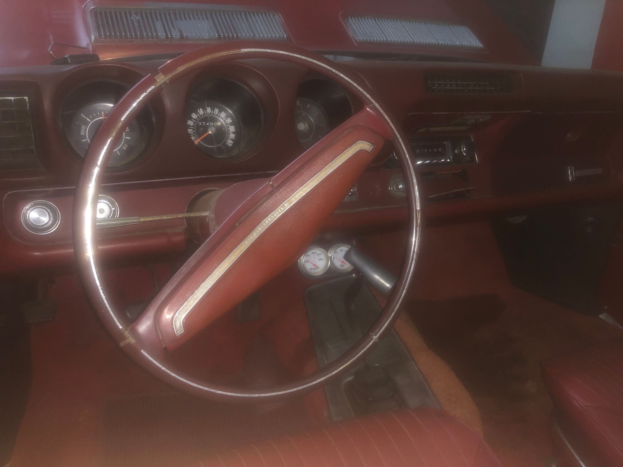

Welcome! Four speed vert, pretty nice car.

Welcome, nice looking car. 4 speed?

If you cant get the top to stretch, take it to a good upholstery shop, see if they can fix it. Once its fixed/replaced, always store it with the top closed.

Just a idea that has worked for me( and cost nothing) is to put the top up as far as it will go then leave it in the sun for the good part of a day then try to latch it closed. Vinyl will stretch with heat. If you get it closed once leave it up for a few days to stretch. I have gone as far as putting a space heater on the floorboard in the winter to do the same thing..... Tedd ... PS good looking 69.

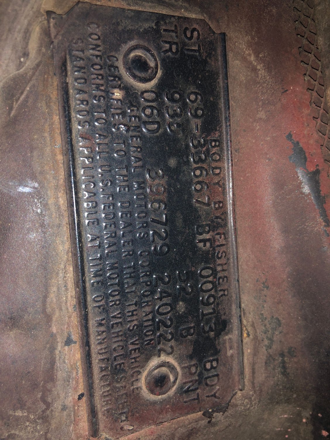

You are correct. Code 52 is Crimson. I guess someone replaced the drivers fender at some point, due to the cream color on the inside of the fender.

FWIW, I find it easier to latch the top of my convertible into place with the windows down. I assume that helps make a tighter seal once the windows go up.

Nice car. My car rolled down the same line exactly one year after yours. 06D date Fremont built 1970 Cutlass Supreme Convertible. What are your goals for the car? 10k could easily be a really nice paint job. What condition is the interior? I would make sure it’s as safe and dependable to drive then go from there. You say the suspension was fixed, I’m not sure what that means but I would replace all control arm bushings, ball joints, and steering linkage. I would also go through the brakes, looks like a power drum master. I would consider going to factory disks in the front, the rears new shoes, wheel cylinders and hardware should be good enough. Make sure you replace all the rubber hoses. Motor was probably built with the low compression off the shelf pistons, since it isn't original I would look for a 455. You could also have the 350 gone through again with different parts to get you to what you want. Be aware that most stock Oldsmobile motors will not be compatible with the manual transmission. The crank will need to be modified to accept the pilot bearing. What transmission is in it? If it is a 3 speed or a Saginaw I would build a Muncie for it. Does the car have dual exhaust? I prefer long tube headers and free flowing mufflers they really seem to wake these motors up. Do you know what rear it has? Depending on transmission and original motor it could have anything between 3.91 posi to 2.56 open. Depending on your goals that may need to be changed. Looks like it will be a fun project whatever you decide.
