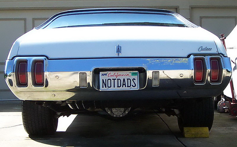

Hey all, thanks for the friendly welcome. I'll get some pictures up soon. I have to admin I'm a little sad because I thought it was fixed, but I went to get gas yesterday and it stumbled and died on me like old times. Ugh. I'll search the forum for ideas and post a couple questions if I dont see anything. I think next step is see if there is a vacuum leak on the new intake manifold. I know I had a heck of a time getting the valley pan to sit right. I should have bought the valley pan from Mondello.
As for color its white with black vinyl top. It needs some better wheels but its got the fattest tires I could get on the current wheel. :-) I had the exhaust tucked up under the bumper so that you can't see it. Other than that its all stock looking. I've played with the idea of a 442 grill and hood but we'll see. Gota get it running first.
