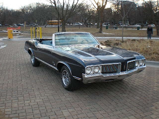

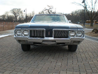

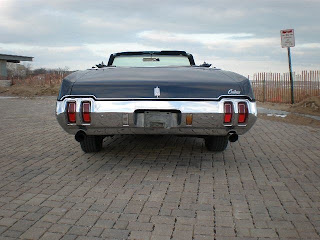

After researching on the web I became a bit of a technical expert on the 1970 Oldsmobile Cutlass Convertible SX. There are some fantastic resources and archives, as well as a great forum for Oldsmobile. Learning the details of the car gave me some insight on what to look for, and to look out for, when evaluating the cars for sale on the web. I also had alot of help from Gary Riley, who was able to spot things very quickly from some pretty poor photos.
The first car I actually went to look at was in Manchester New Hampshire, and my friend John and I drove up to see it. It was not an SX. It was a two barrel 350, in good shape, but the price was too high.
I spoke with a number of other sellers, and the second car I saw was in Chicago. This was an SX. It did not have AC, nor bucket seats, but it looked interesting. It was advertised as a W32 option. Gary flew out to Chicago and met me there and after spending a morning going over the car we decided that it was not a W32 but an L31 engine. More torque less horsepower. In many ways this was more interesting to me since I want to drive it, not race it. In addition, any car we bought was going to have the engine rebuilt and I could put any cam I wanted on it. The price had already been negotiated, and we decided it was a good deal. I bought the car and Gary helped me make arrangements to ship it to Denver. Three weeks later it arrived at his shop.

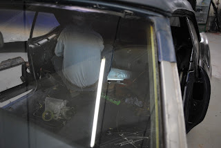

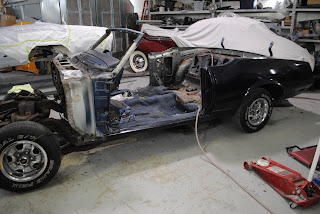

Gary and his crew pulled out the big guns in late November to take almost every nut and bolt off the car. There were no major problems found thankfully; only a rusted out radiator support and a cracked exhast manifold were worth noting. The windshield was original, see the bead of cloth tape in the photo. The car was very straight, and aside form the driver door all the panels were original.
The engine and transmission are being sent out for rebuilding, with stock specs being the goal.
Some minor metal work was needed around the windshield, the trunk lid and fenders.
The car was taken off the frame and sent for media blasting which took a week or so. On return, new body mounts put on and the body reinstalled for filling.

Floor Repair
There was some rust holes in the front floor pan so Stu got out his welding kit and went to work. He also put in the brackets for the new buckets. That completed the repairs to the rust areas; not bad at all.
