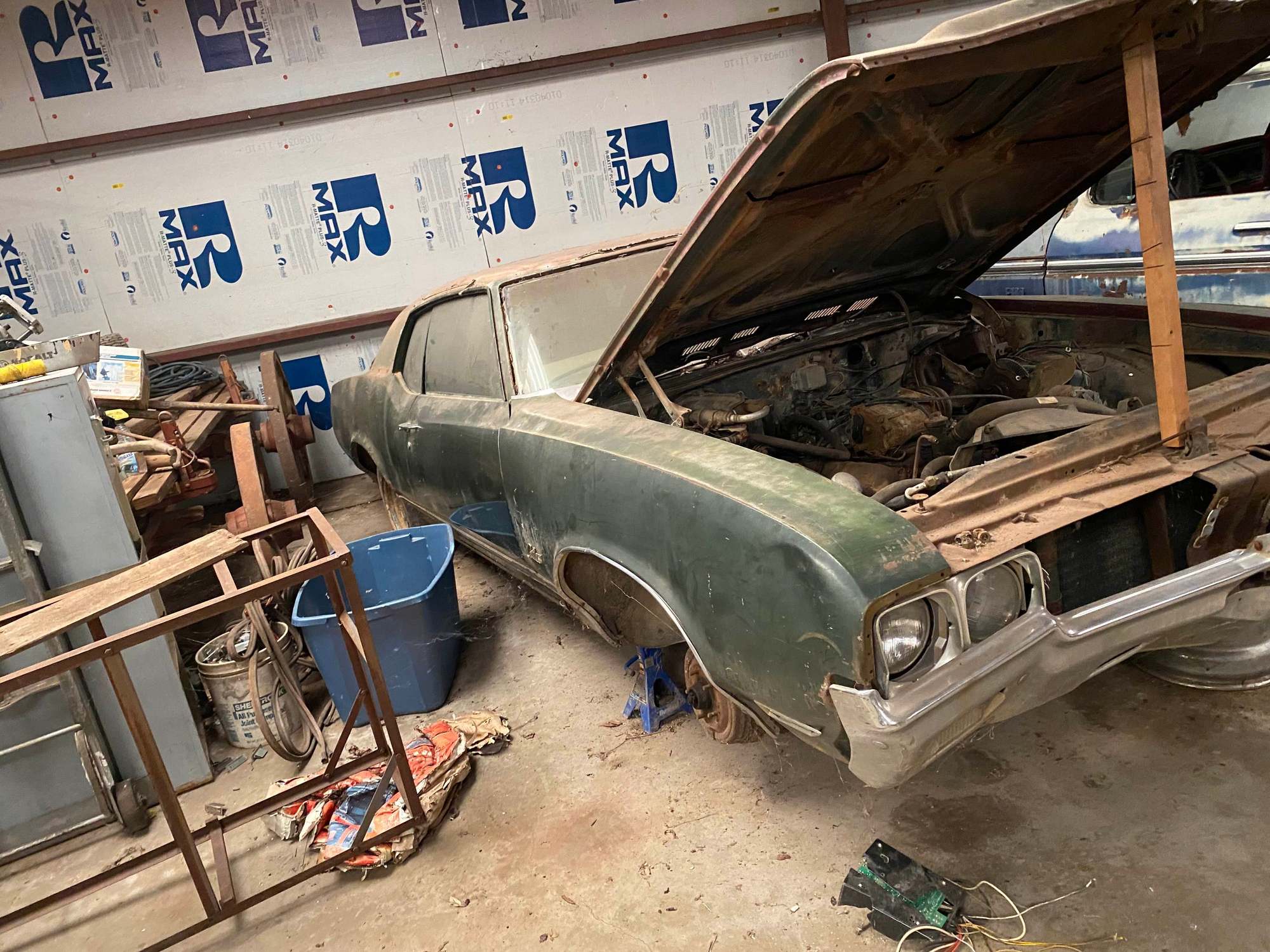

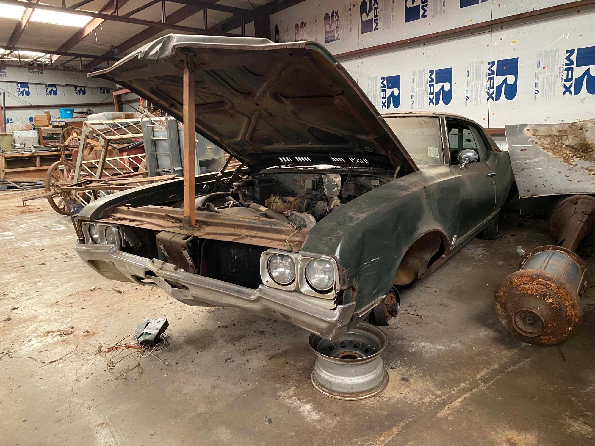

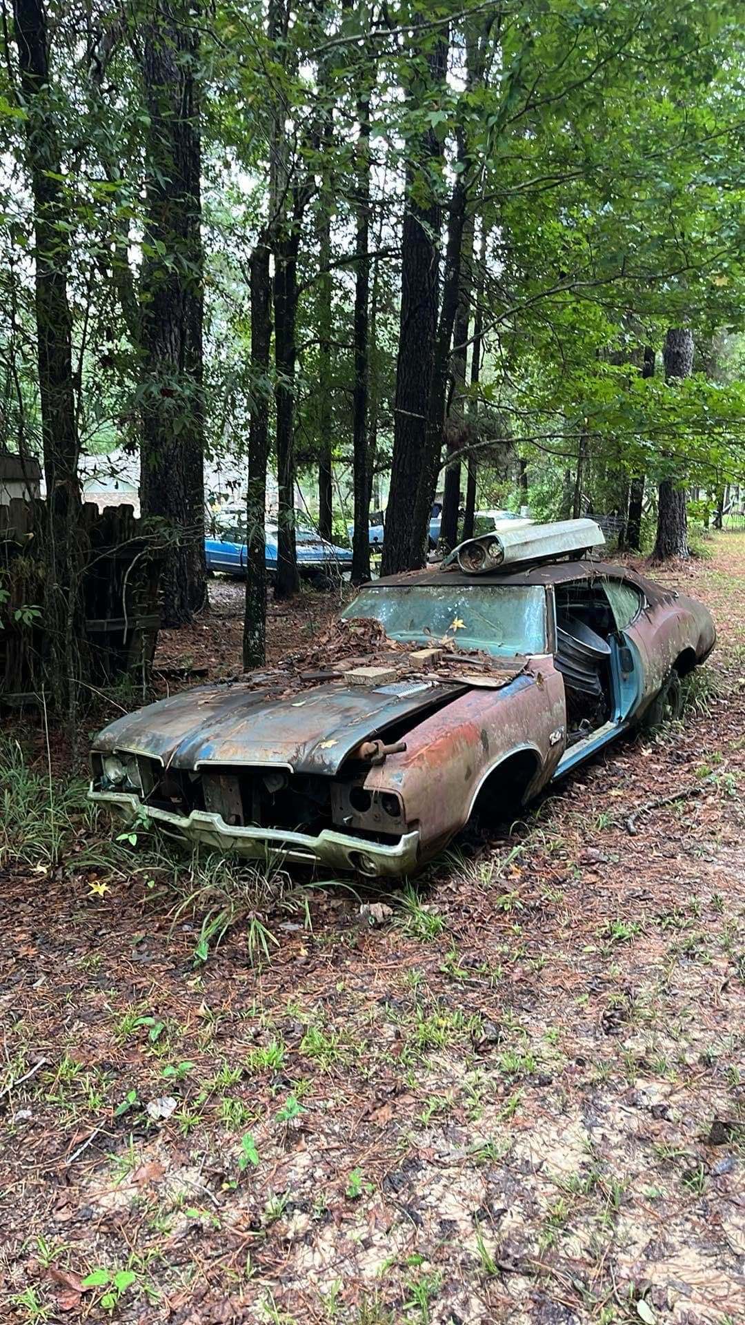

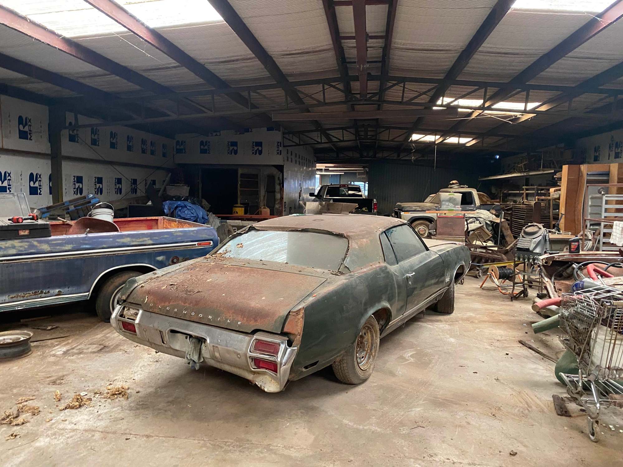

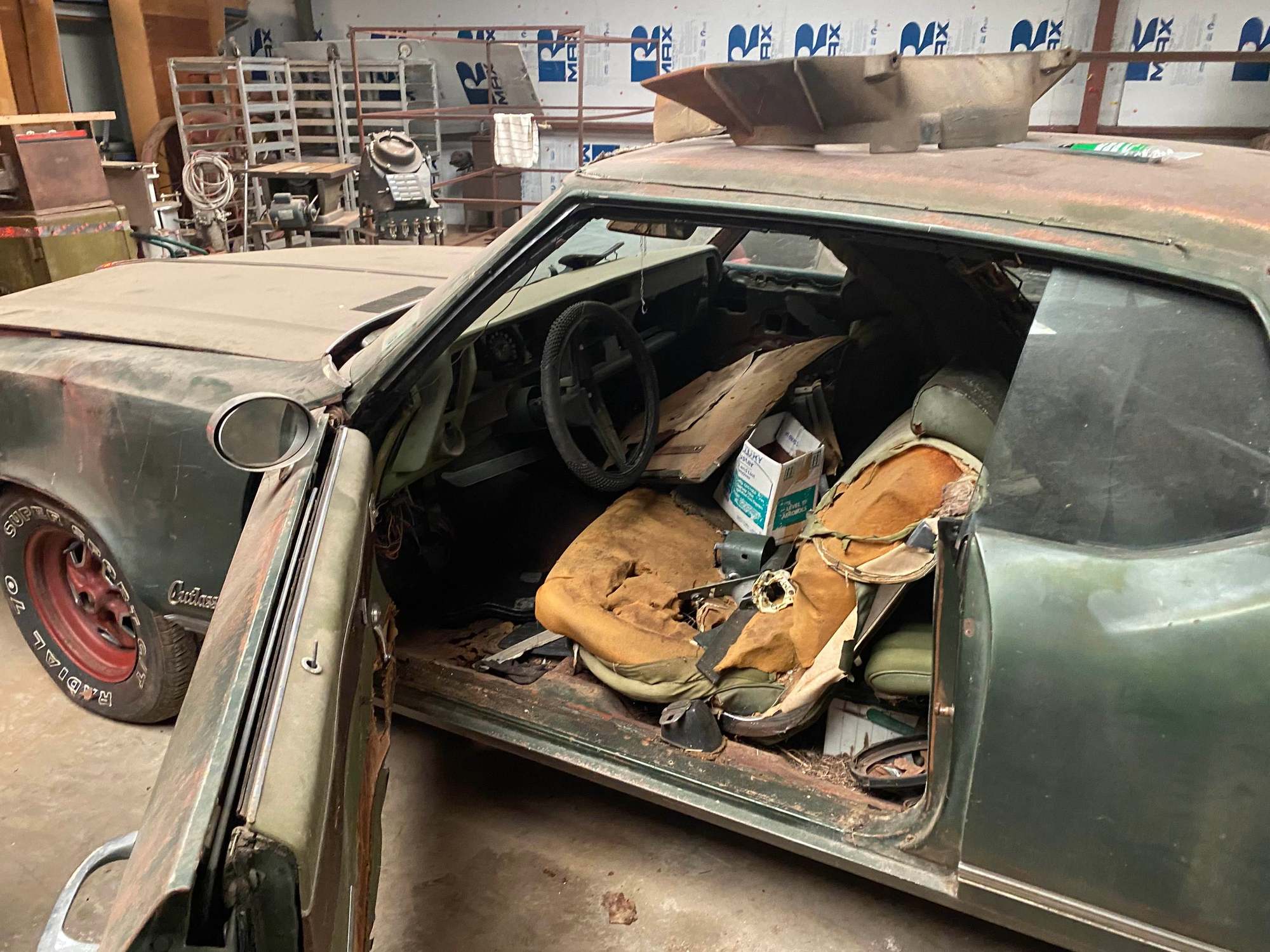

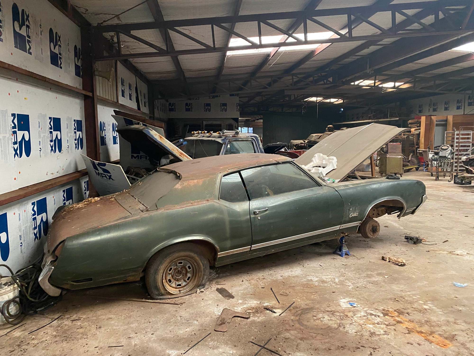

My friends grandfather bought this car for parts around twenty years ago. I found it shoved off to the back of his shop and forgotten over a decade ago and have been trying to buy it ever since. Finally in early 2024 they agreed to sell it to me and I can finally breathe some life back into it. It might not ever be a proper show car, but it will hit the road again and I plan to have fun with it.
Here is how the car was sitting.
Left to rot and taken over by rats I don't remember when I first spotted it but it caught my eye and I immediately started after it. I hated seeing it sitting there wasting away.

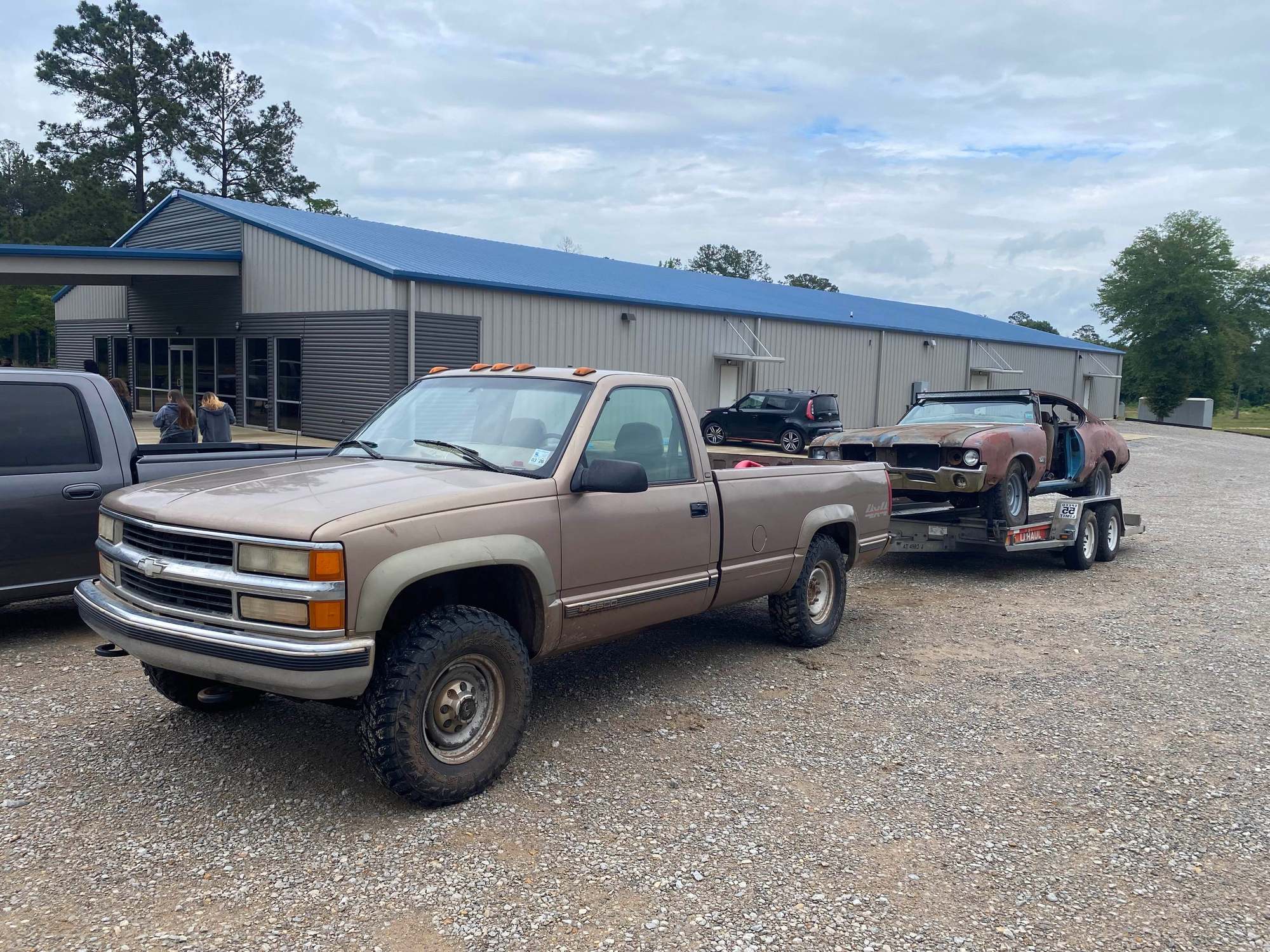

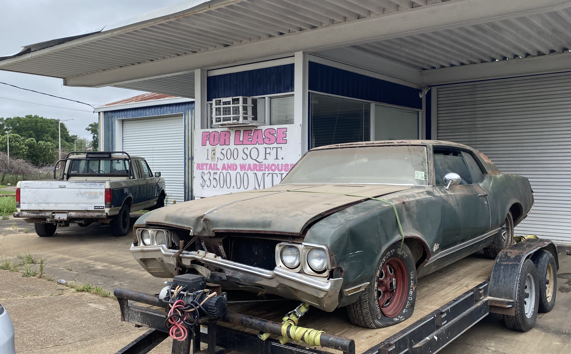

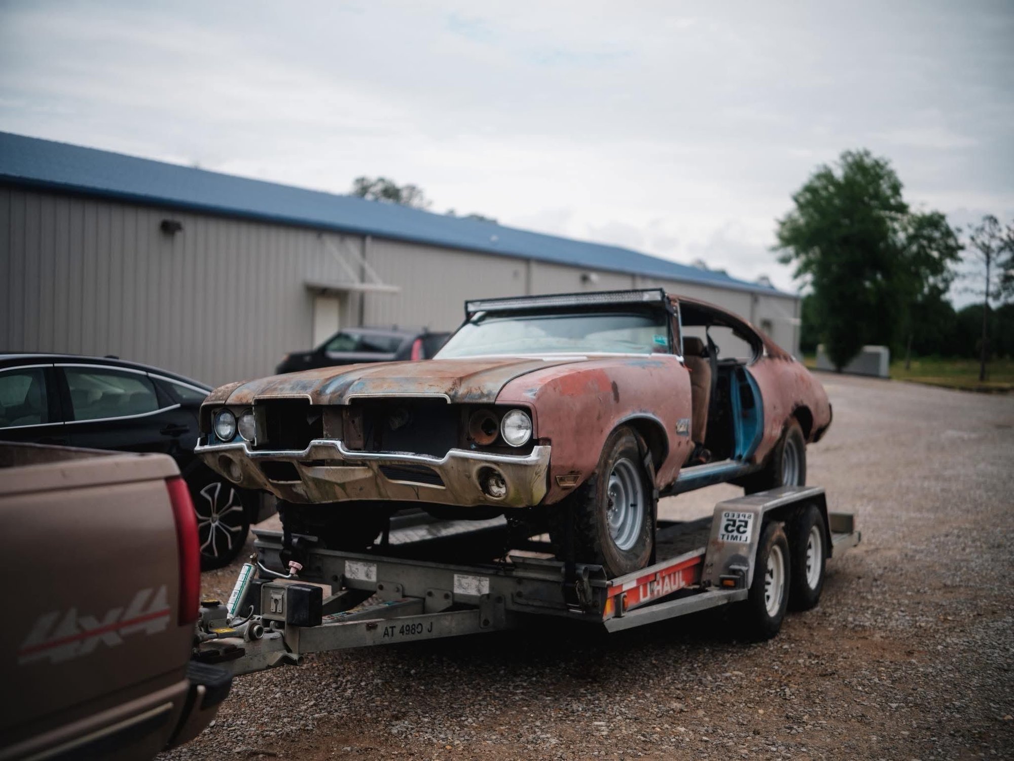

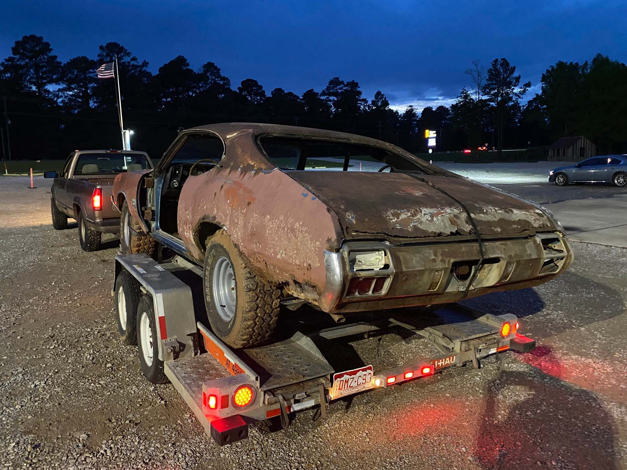

In April '24 I finally got the chance to pull it out of there and bring it home.
Loading it up with four flat tires and a winch that gave out midway through was a fun time.

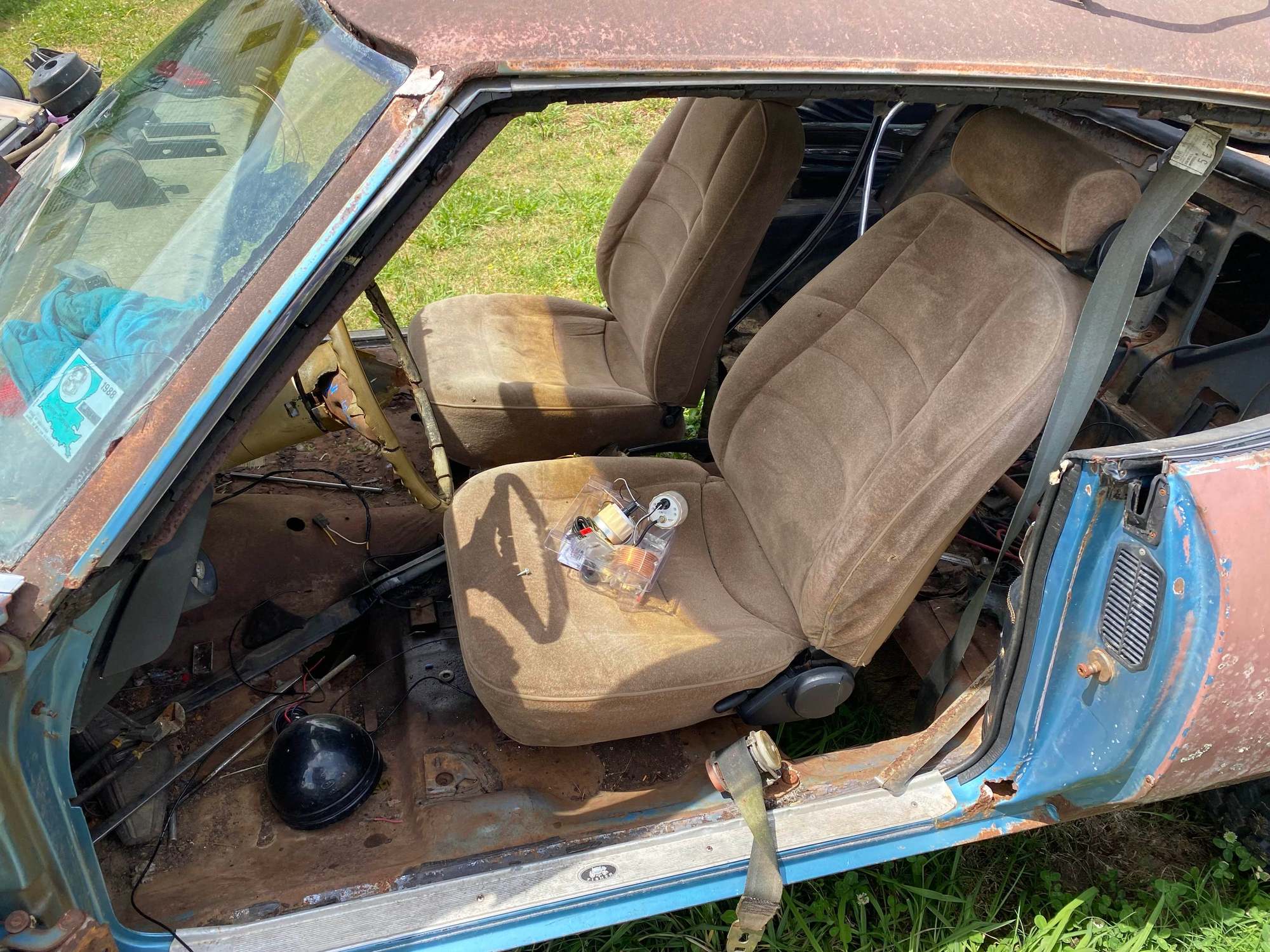

I could not breathe inside the car it was terrible.

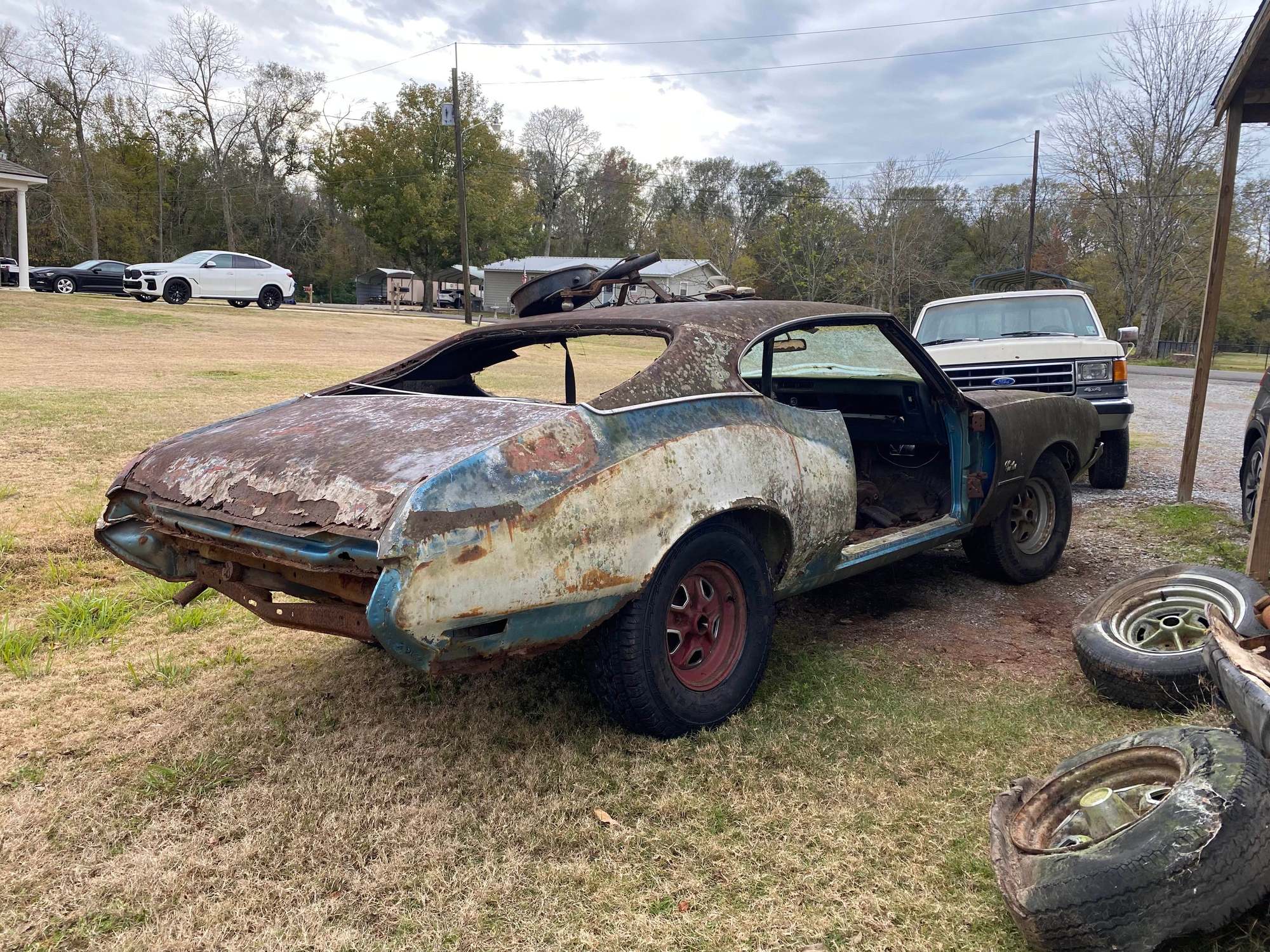

Outside for the first time in twenty years.

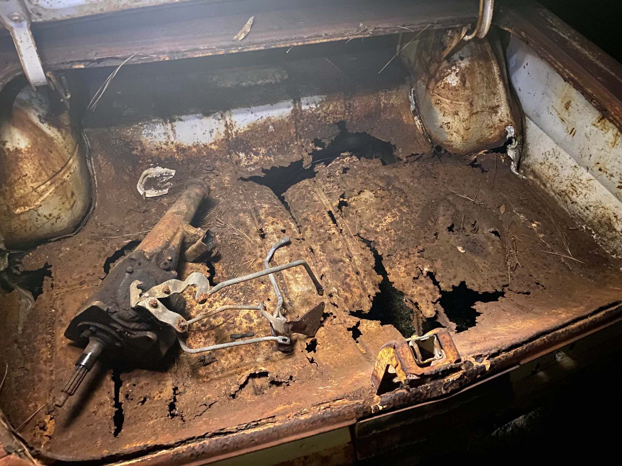

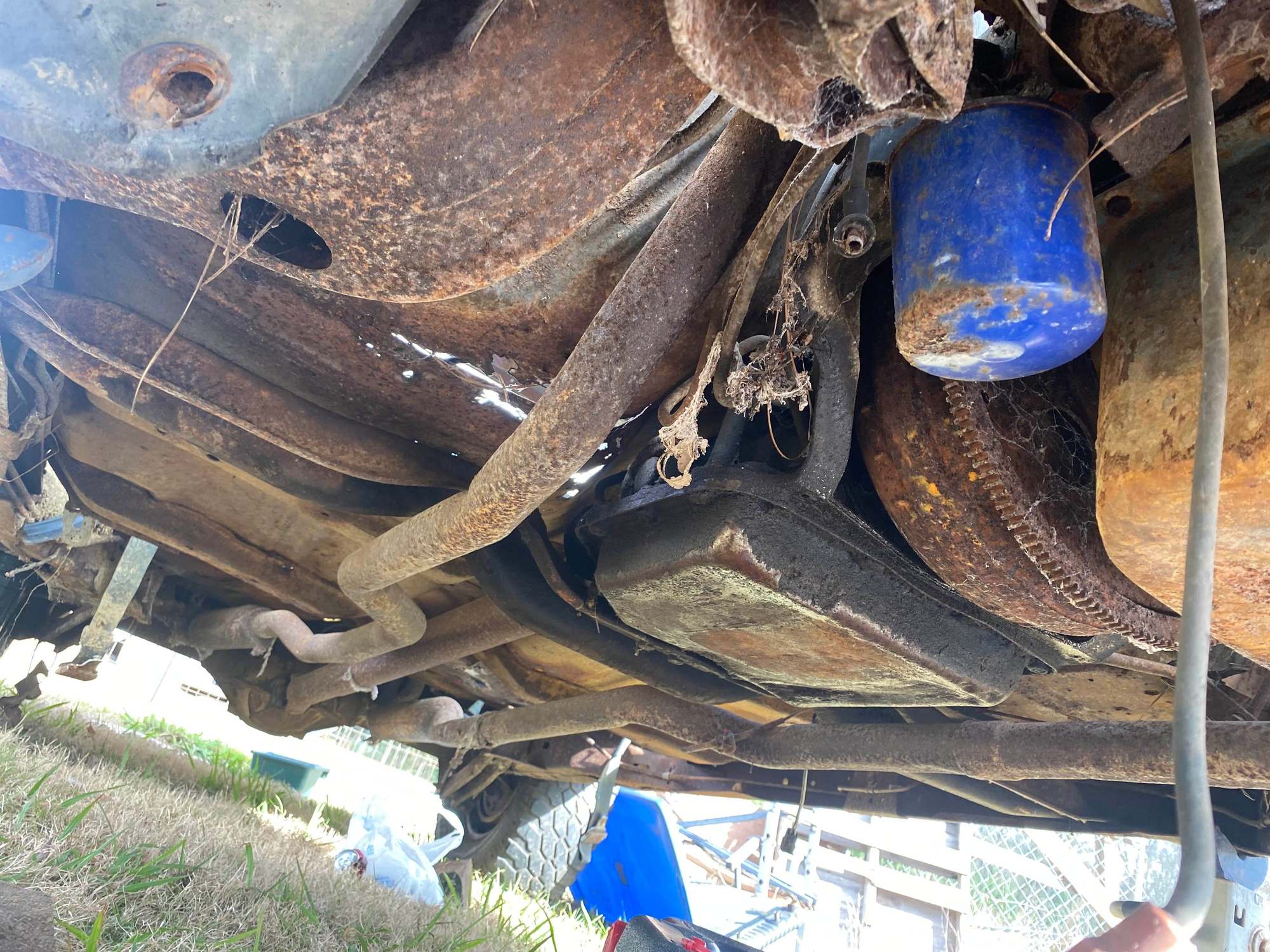

Got it home and cleaned out, it has some rust holes in a few spots and you could throw a cat through the front floorboards but all in all it appeared to be in decent shape for a $600 car.

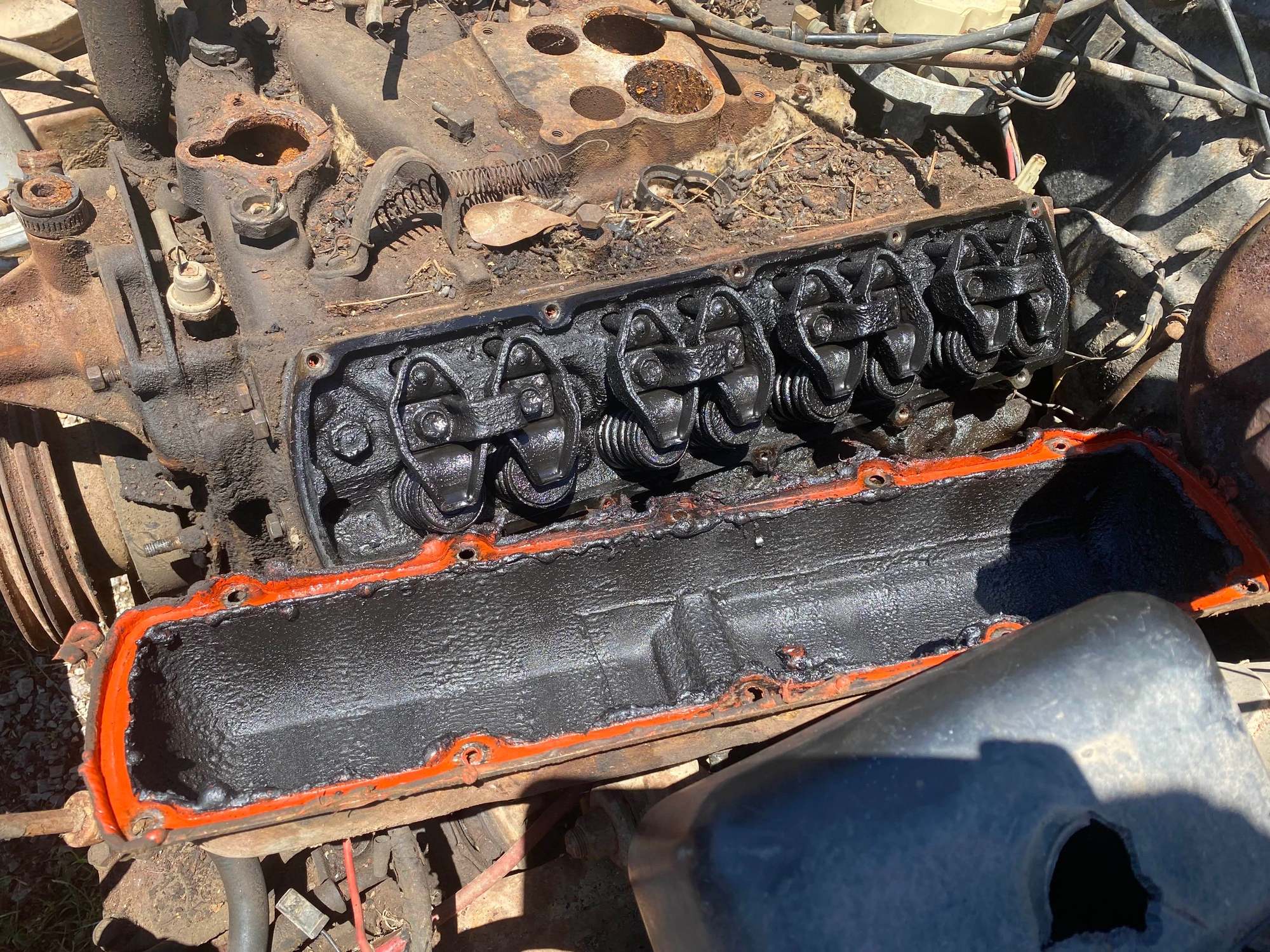

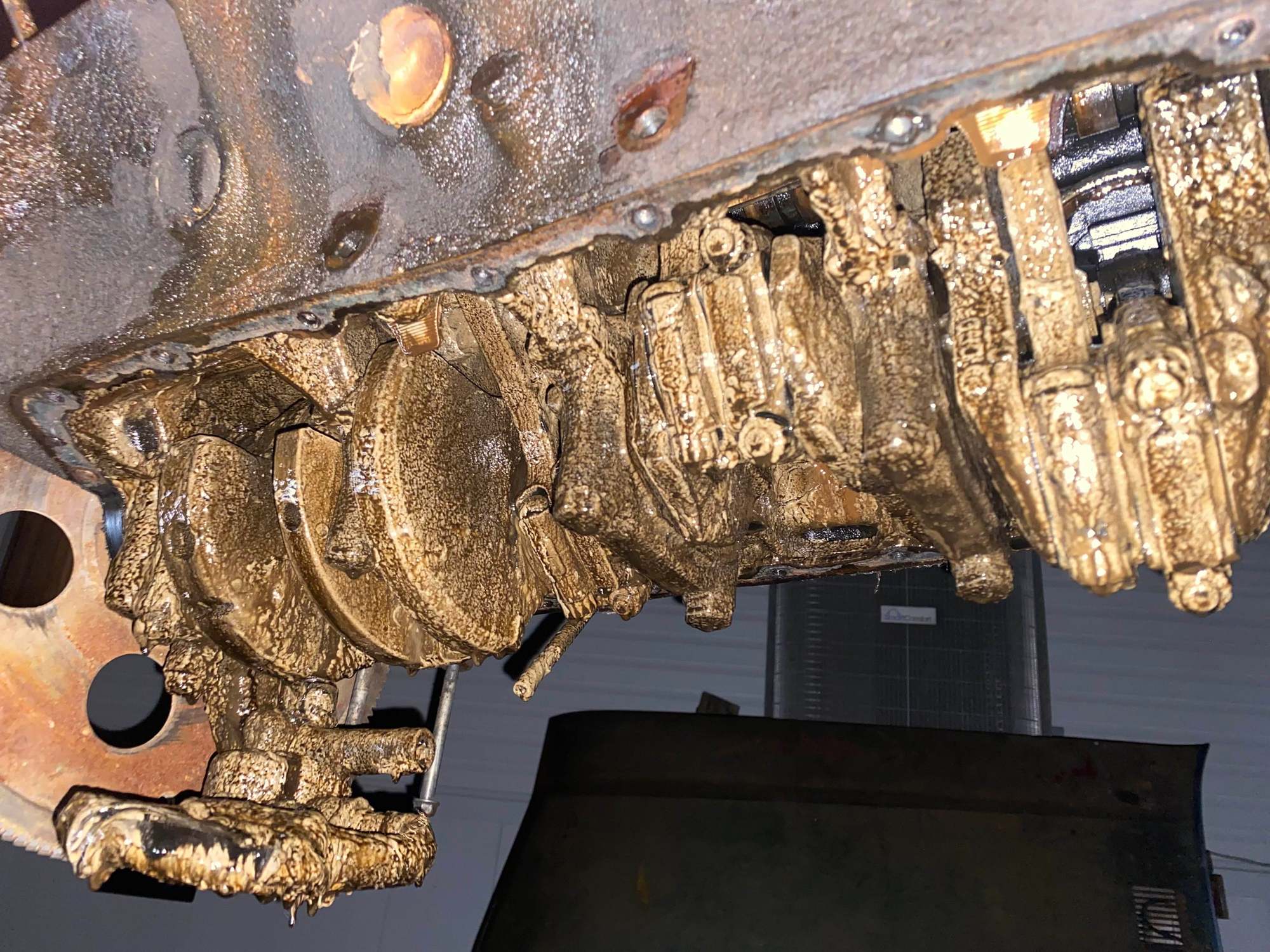

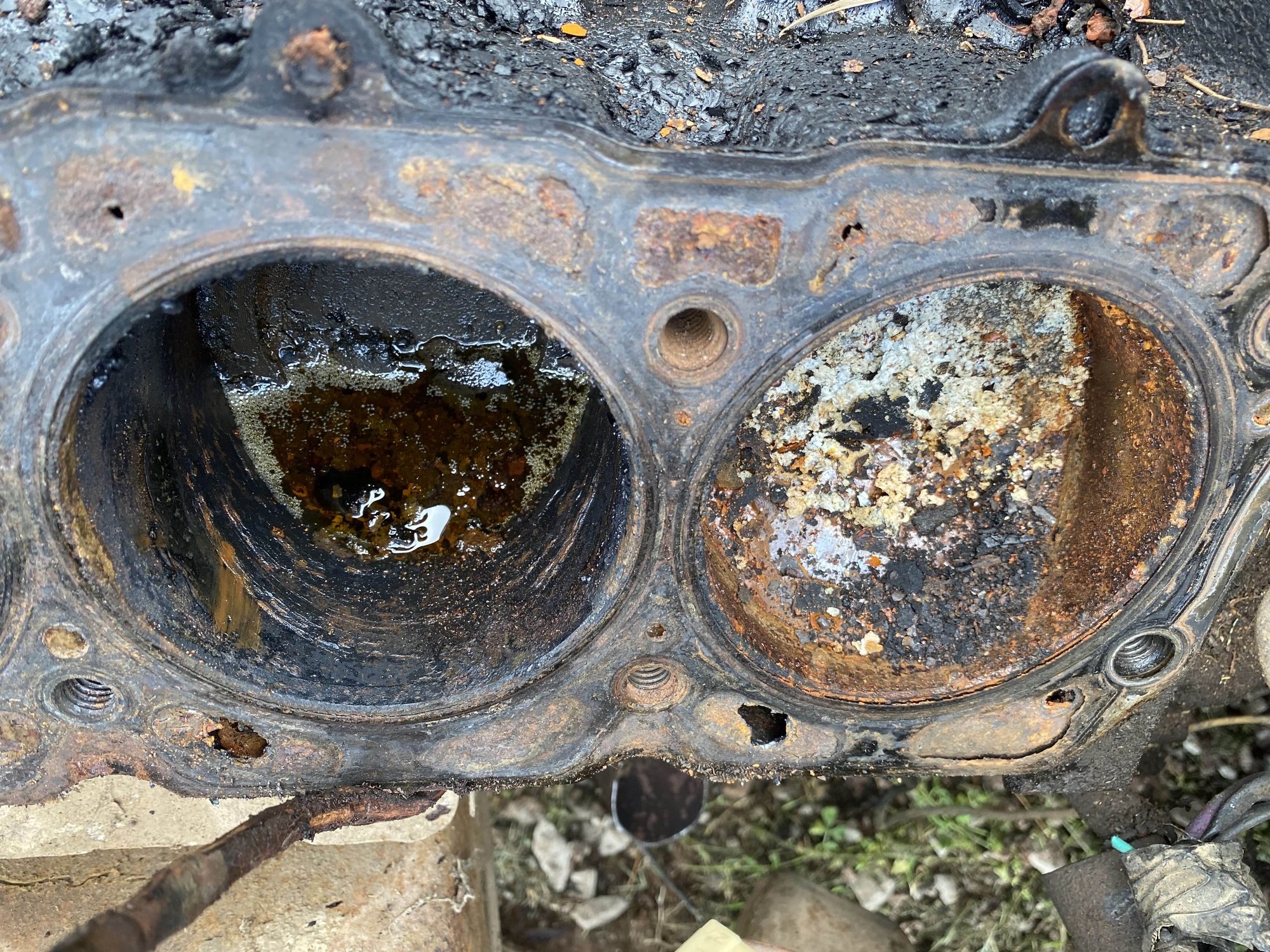

After gutting the interior minus the dash I started on the engine, opening it up because I couldn't turn it over. This 350 has not had a good life.

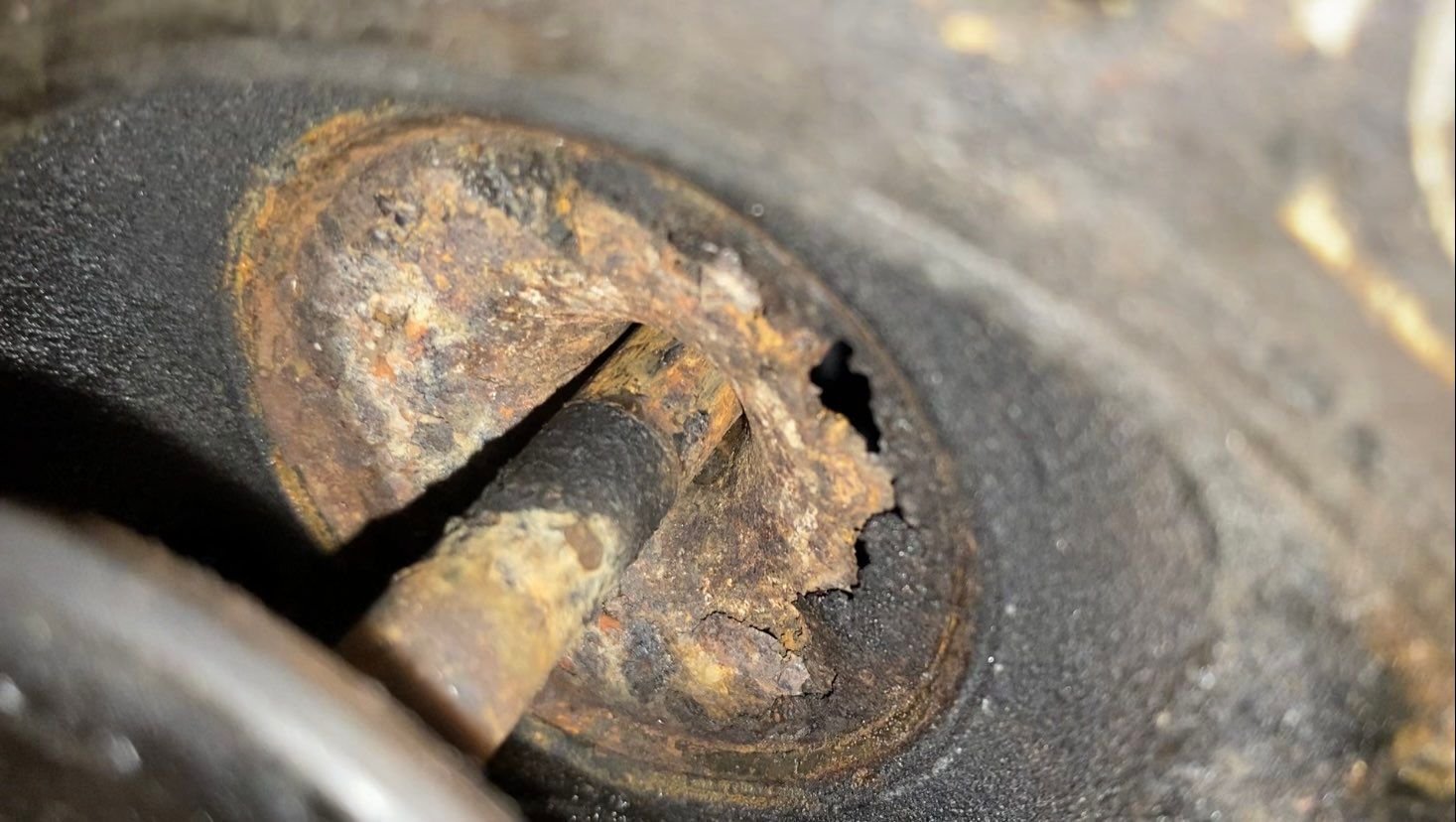

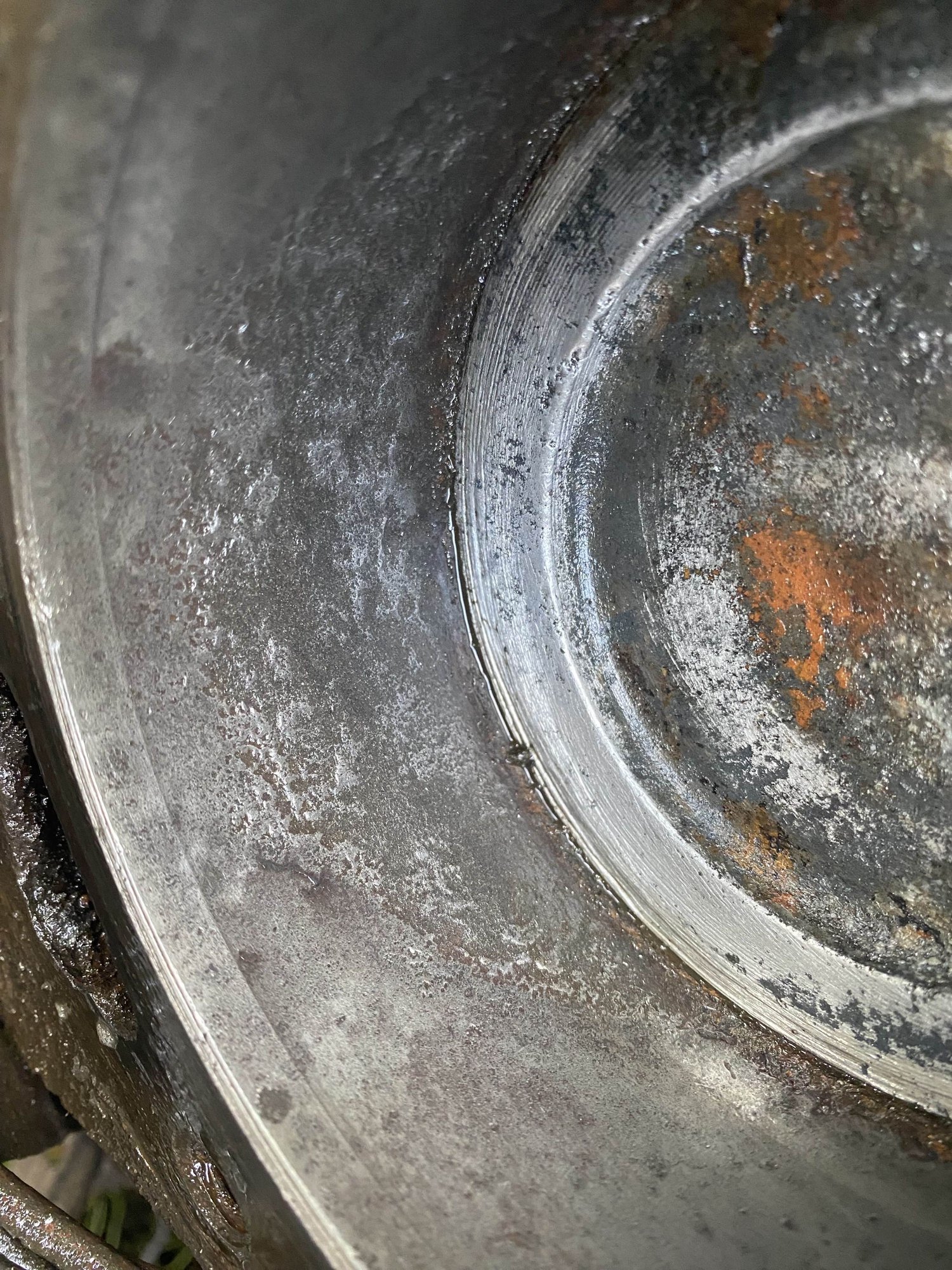

I found cylinders 5 and 7 pretty rusty and locking everything up. I did manage to clean them up and get it to spin but the pitting in the cylinder wall and every coolant passage being blocked with solid rust led me to look for another short block. Which I found surprisingly easily in my local auto yard.

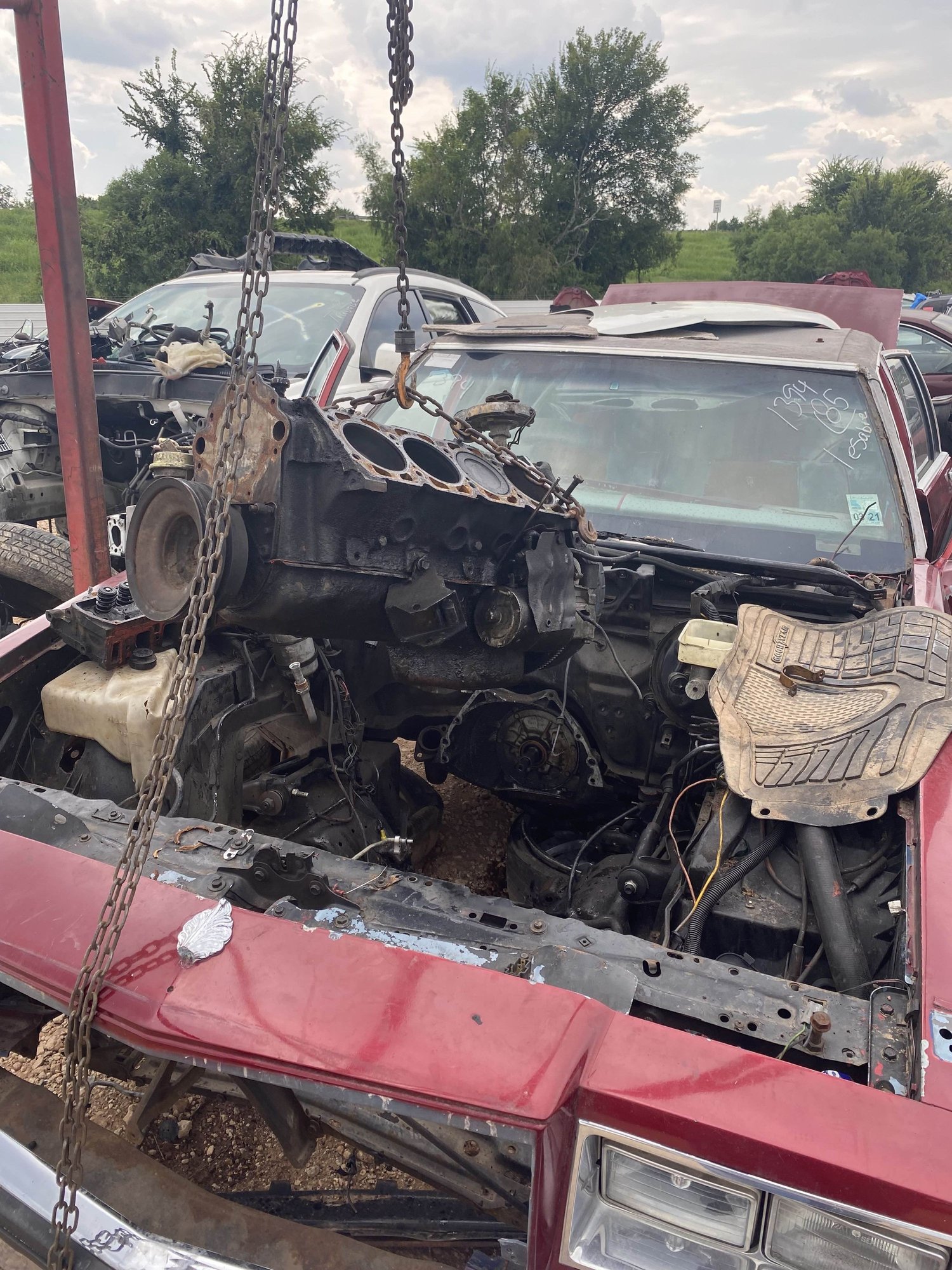

Two days and some minor heat stroke gets me this beauty
Only Olds parts in the yard. Hiding in a Buick. 1974 350.
I will be rebuilding the heads I have and using them with it. I got this engine home and was ( and still am) still in the middle of getting it back together when I discovered the frame of the car is bent in the front passenger corner putting the front wheel at a pretty bad angle.
Could it be pulled out? I don't know, might see about that eventually.

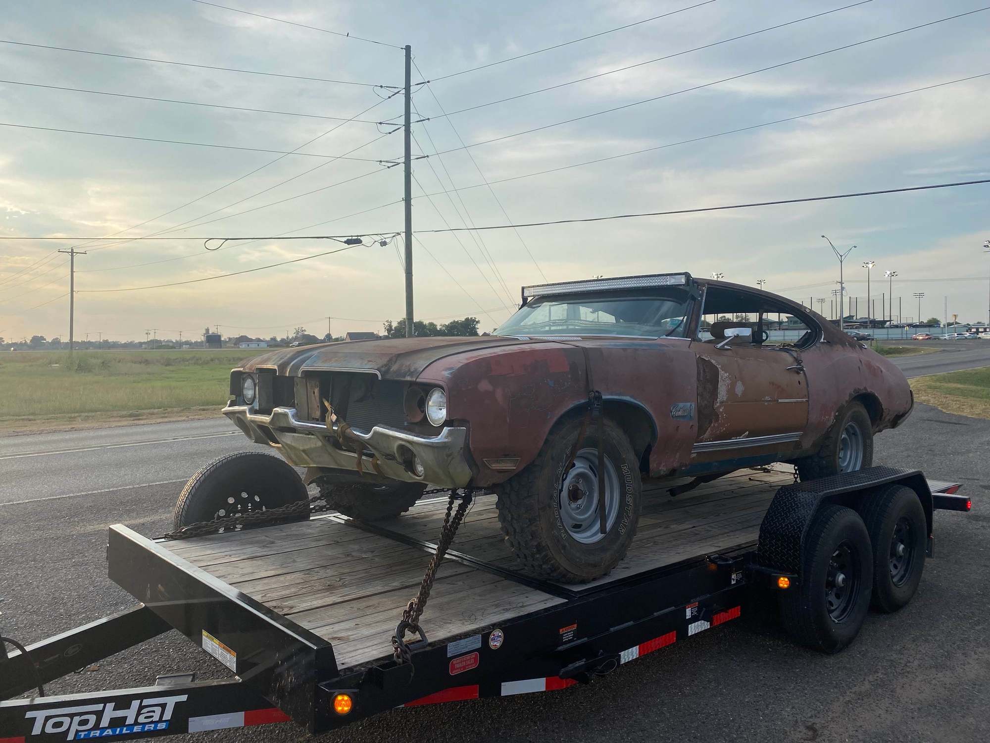

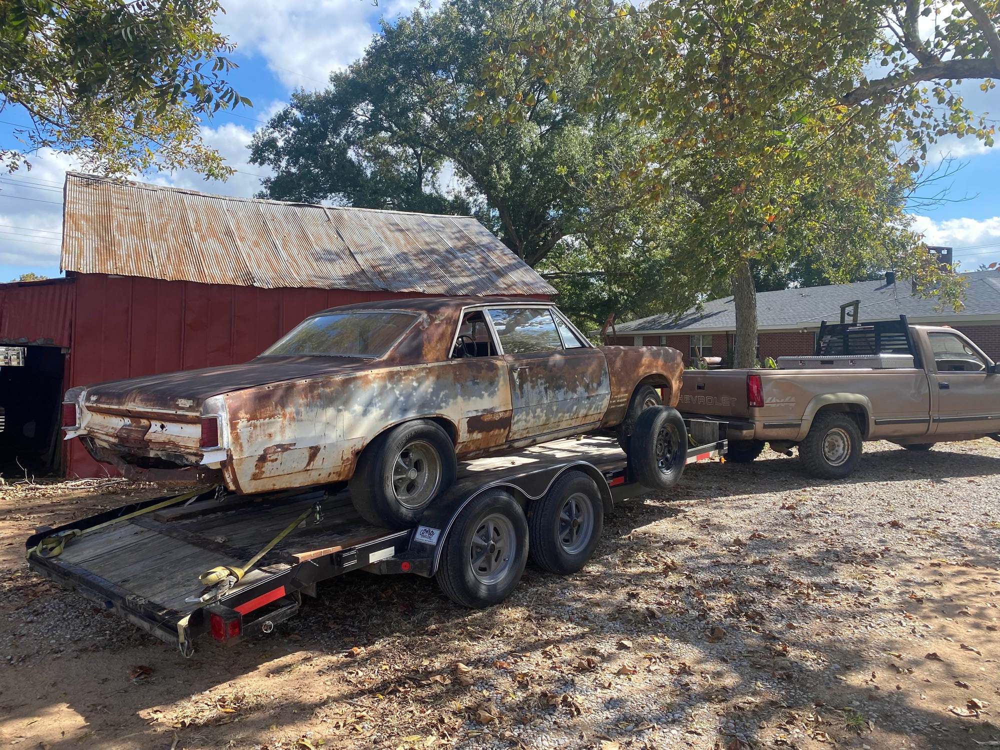

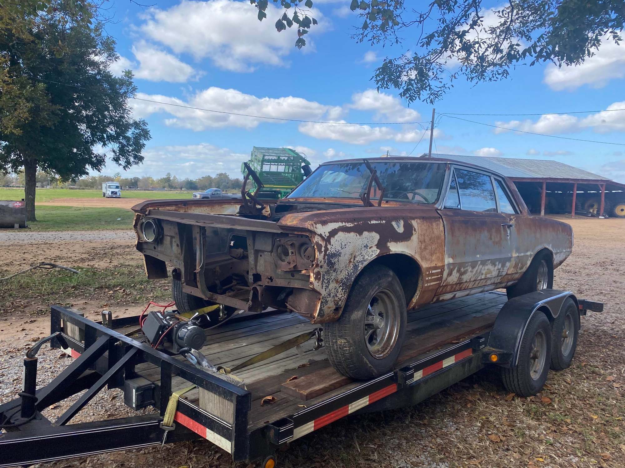

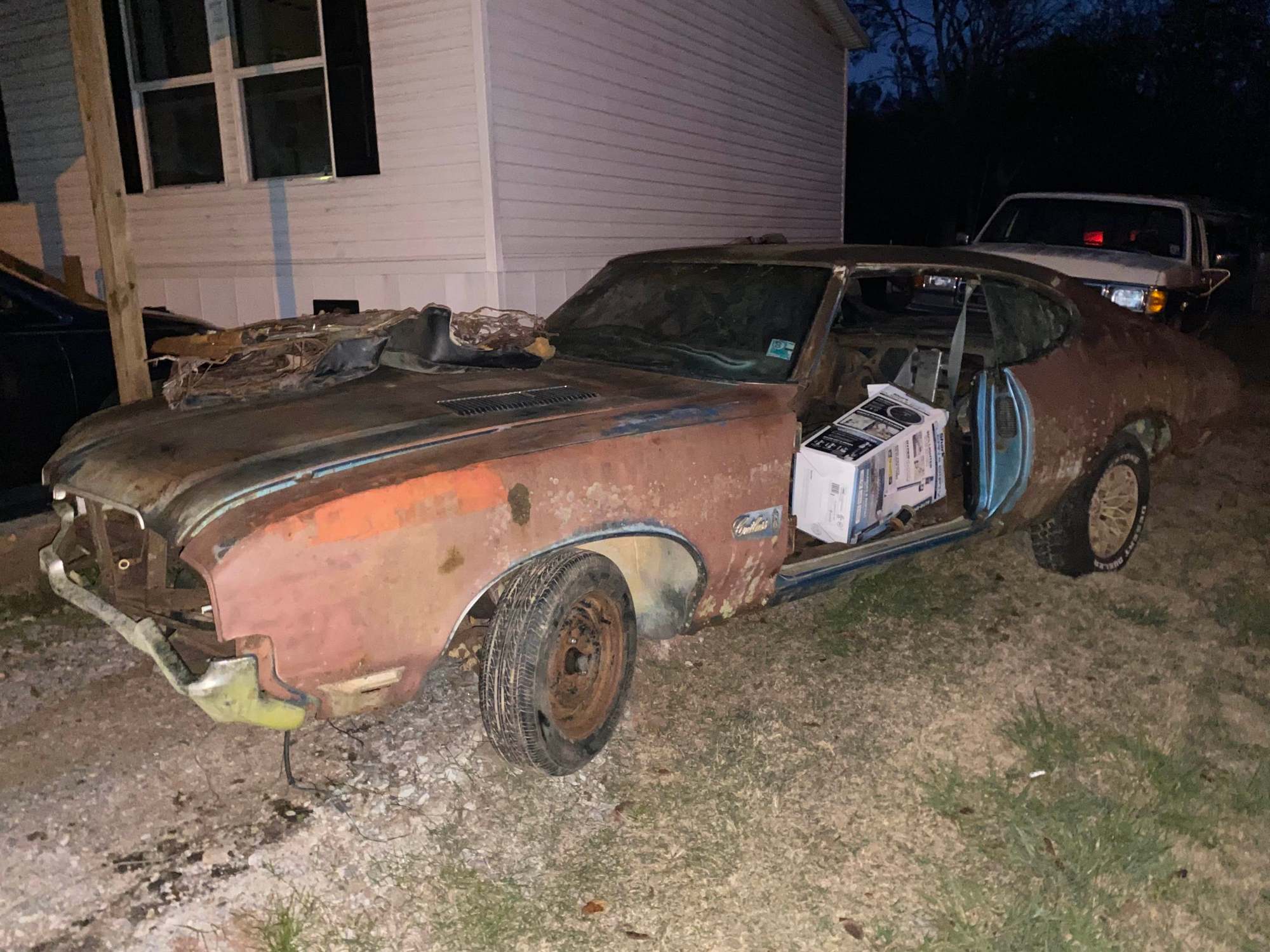

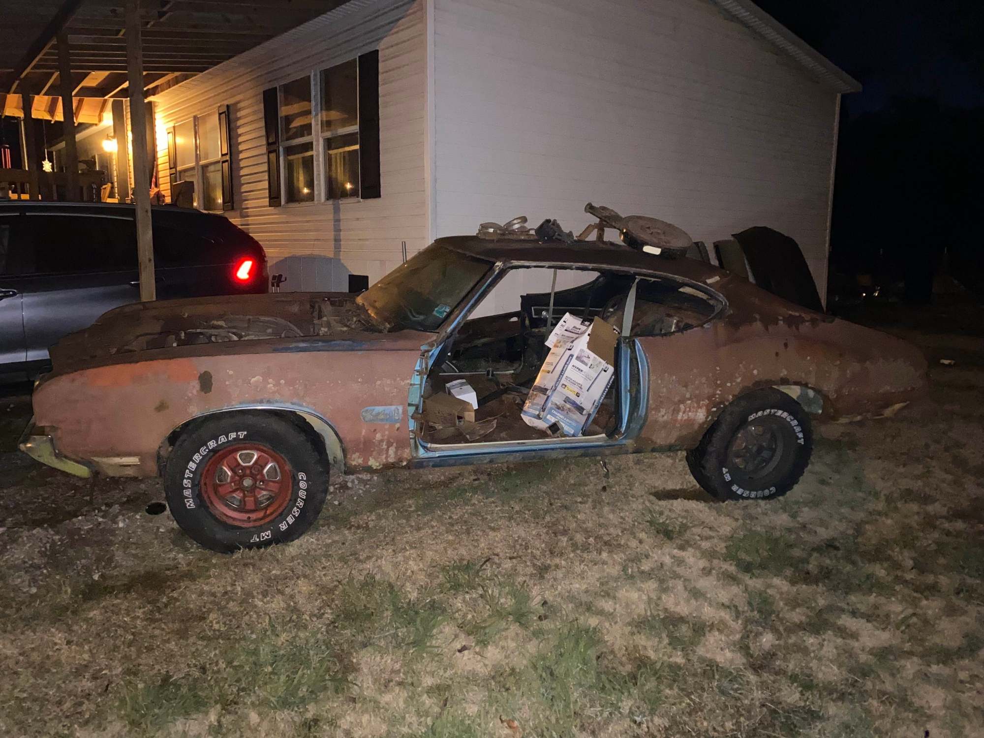

So I started looking for a frame and as luck would have it a friend messaged me a car he had for parts. I've never been one to turn down another project so I jumped at the chance.
It is a '72 Cutlass and just a little rough by my standards but what started as just parts for the '71 has turned into making a good car and a good enough car out of what I have now.
Sitting in my friends yard for I dont know how long. Was last inspected in 88 though.
Sitting in my friends yard for I don't know how long. Was last inspected in '88 though.
It is rusty but not rotten and the frame is straight so good enough for me.

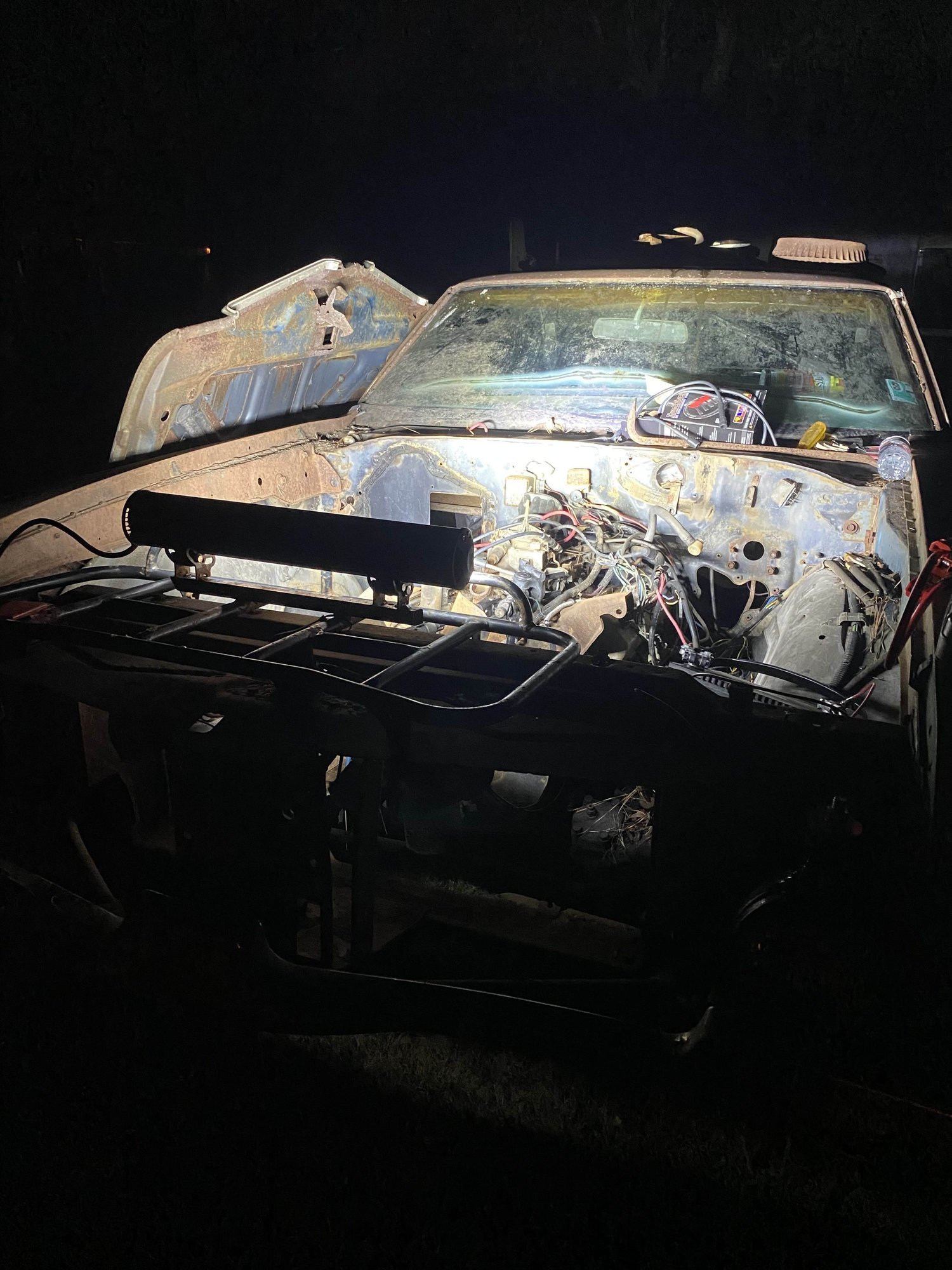

It also has a 350. It spins and I have power, I want to hear it run before I tear the car down.

Are you sure the Supreme is a '71? Looks like a '70 front clip on it with a '71/72 rear bumper.
Yeah it is a '71 with a '70 front clip. That threw me off at first but I like it so I'll keep it that way if I can.

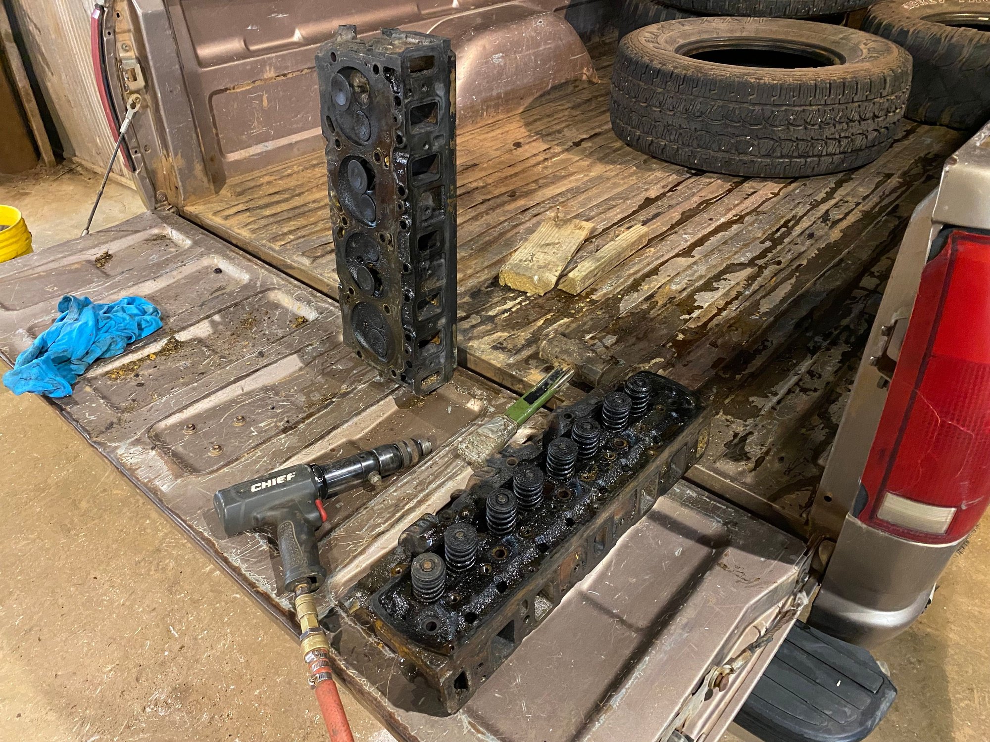

Progress is slow but getting there. Finally getting the heads apart for the '71, valves were a little more stuck than I was anticipating but I have them free now.
First time needing an air hammer for valves.
And that would be why.

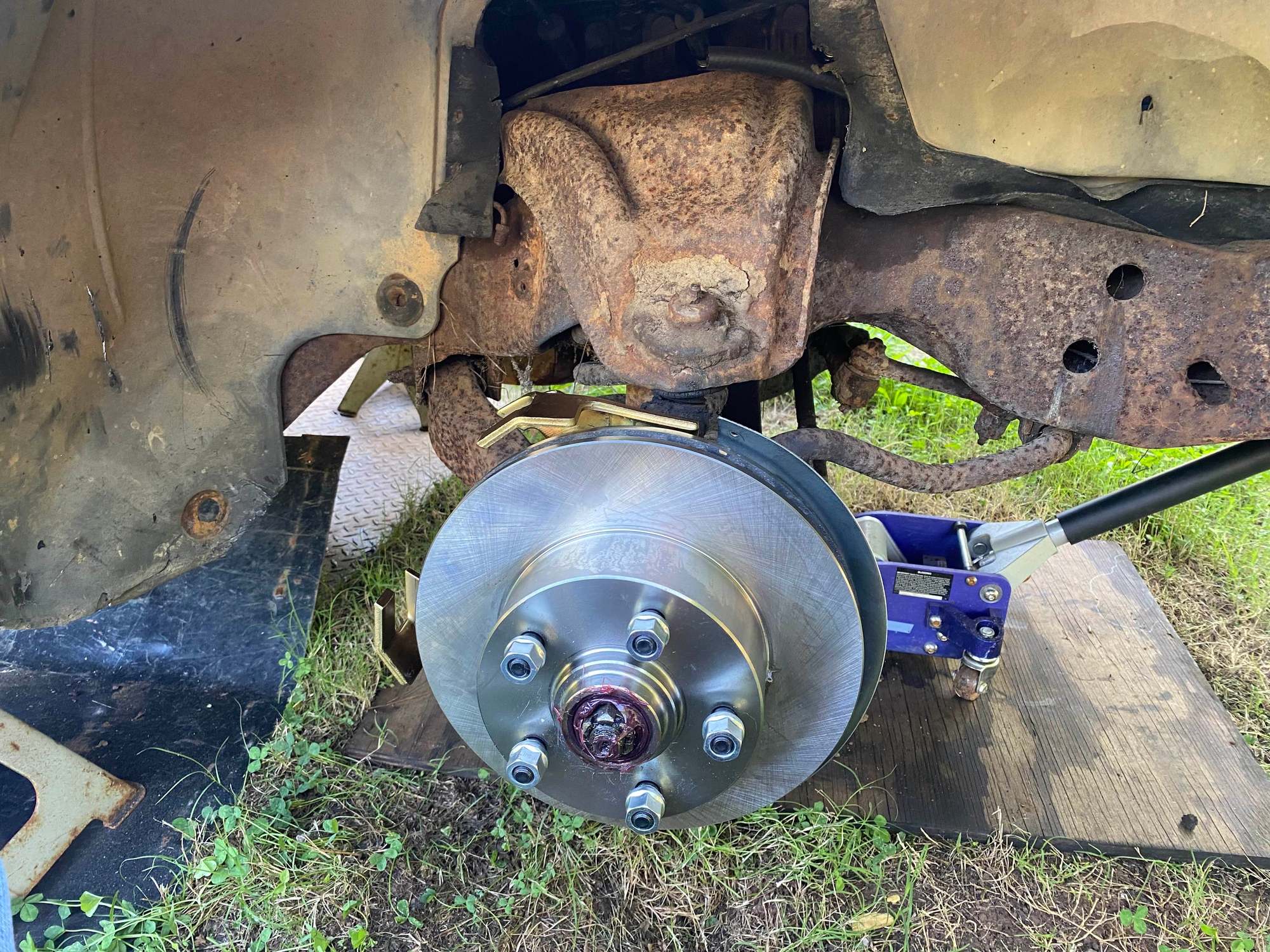

Converted the drum spindles to disc.
I didn’t think the “parts car” would be the first to get powered seats and disc brakes but here we are.

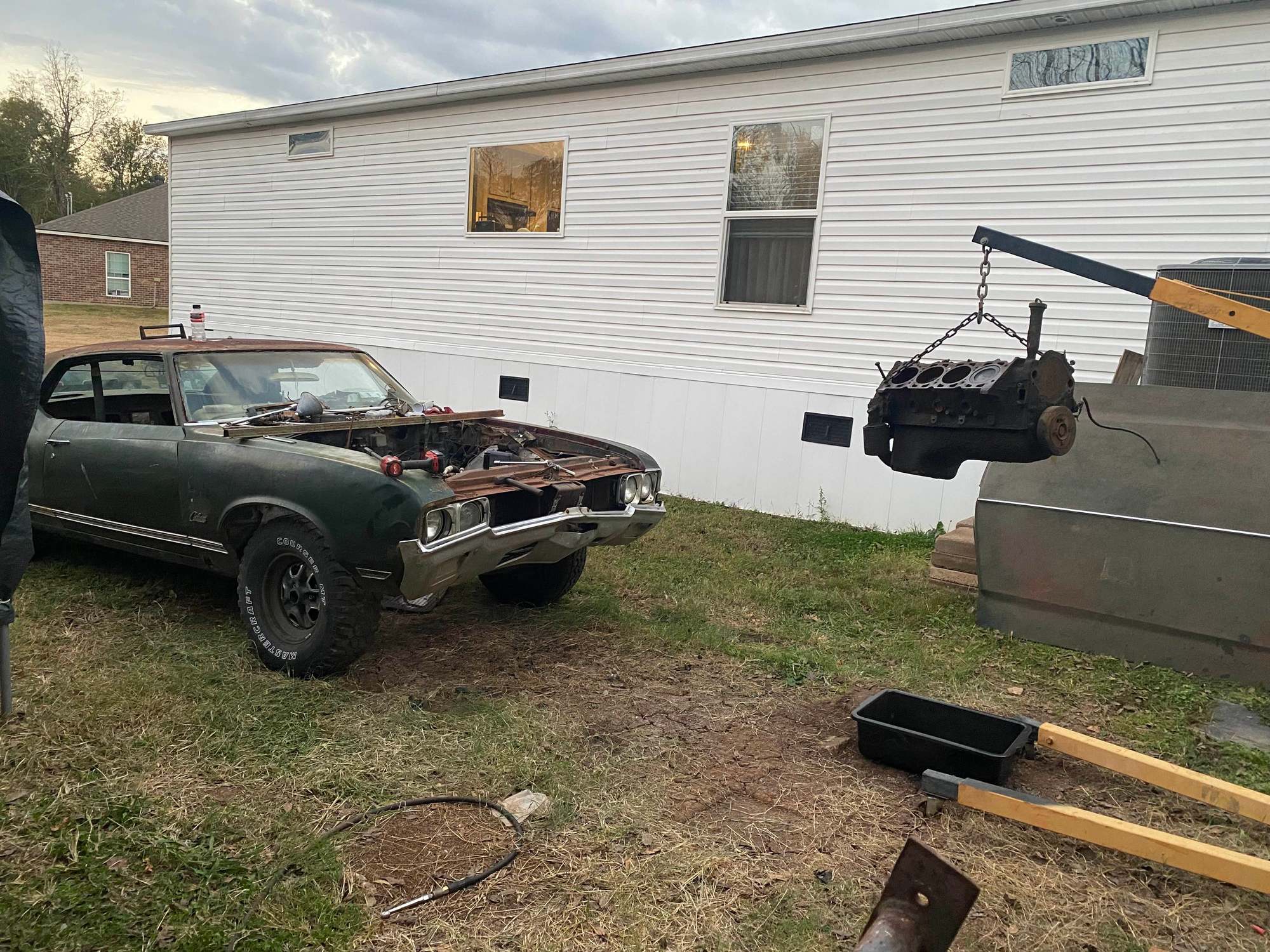

Finally pulled the old engine (maybe original I don't know) out of the 71. It went easy enough, thankfully I live where rust isn't an issue most of the time.
Much easier to push with it out of there
