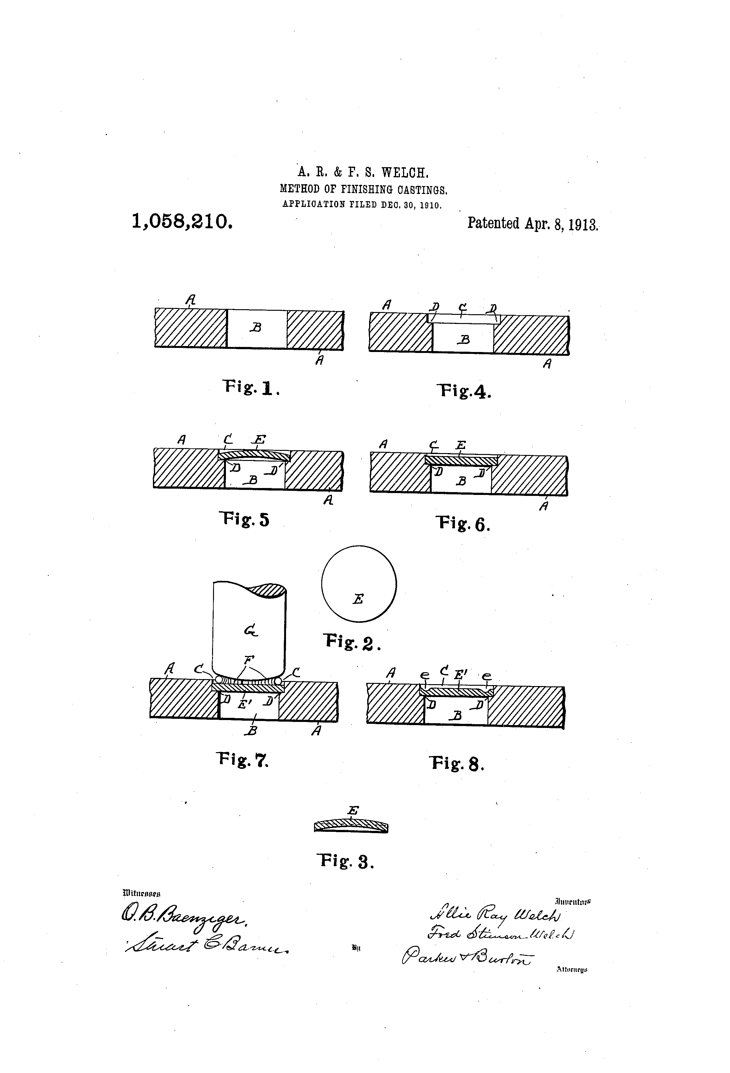

Originally Posted by 1PDQ55
... was wondering what the heck a Welsh plug was
Maybe because that's not what they're called.
They're called Welch plugs, after the brothers Ray and Fred Welch, who patented them in 1913.
They were invented in Pontiac, not Cardiff.
