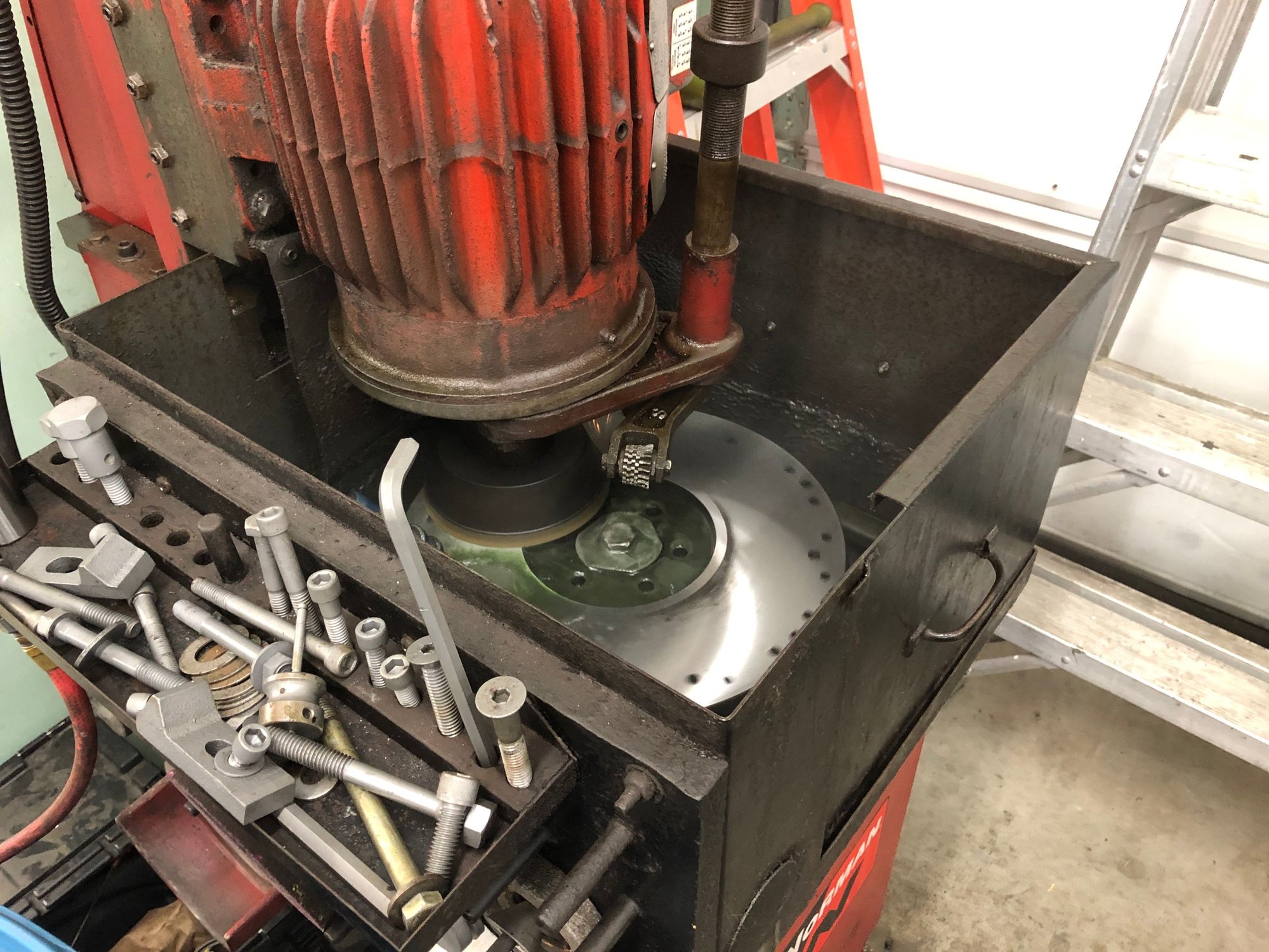

October 16th 2021 we removed the trans to replace the clutch set and cut the flywheel. As well, the rear u-joint was replaced because of a tight spot. Trans fluid drained and refilled. Oil and filter changed. a new clutch fork adjustment rod installed (needs new Z bar and bushings)

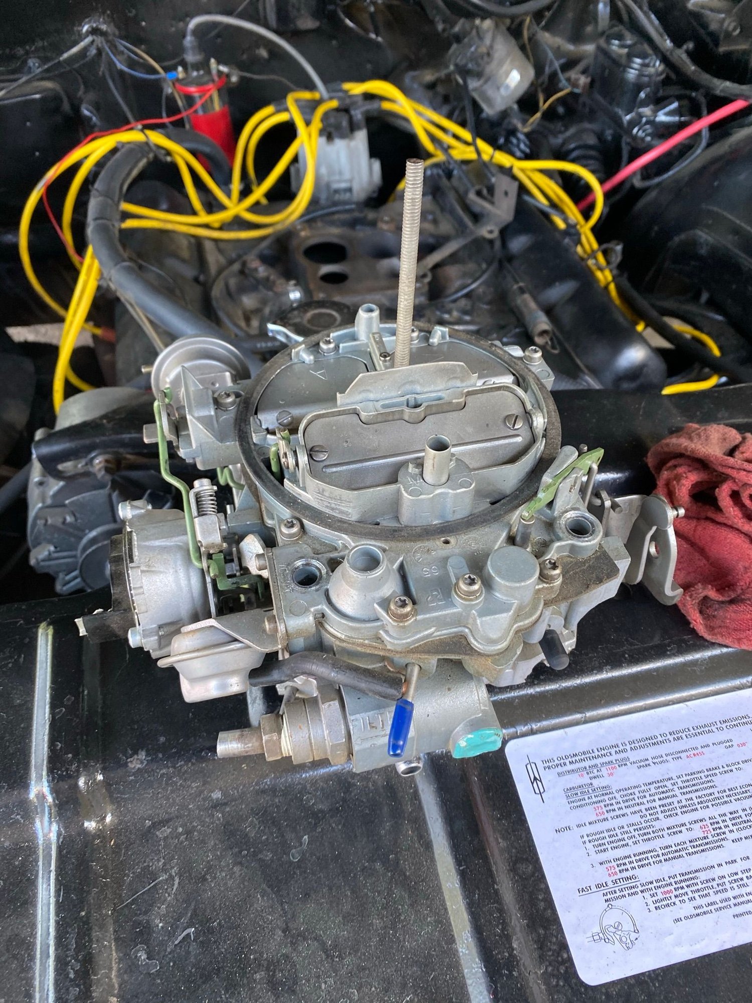

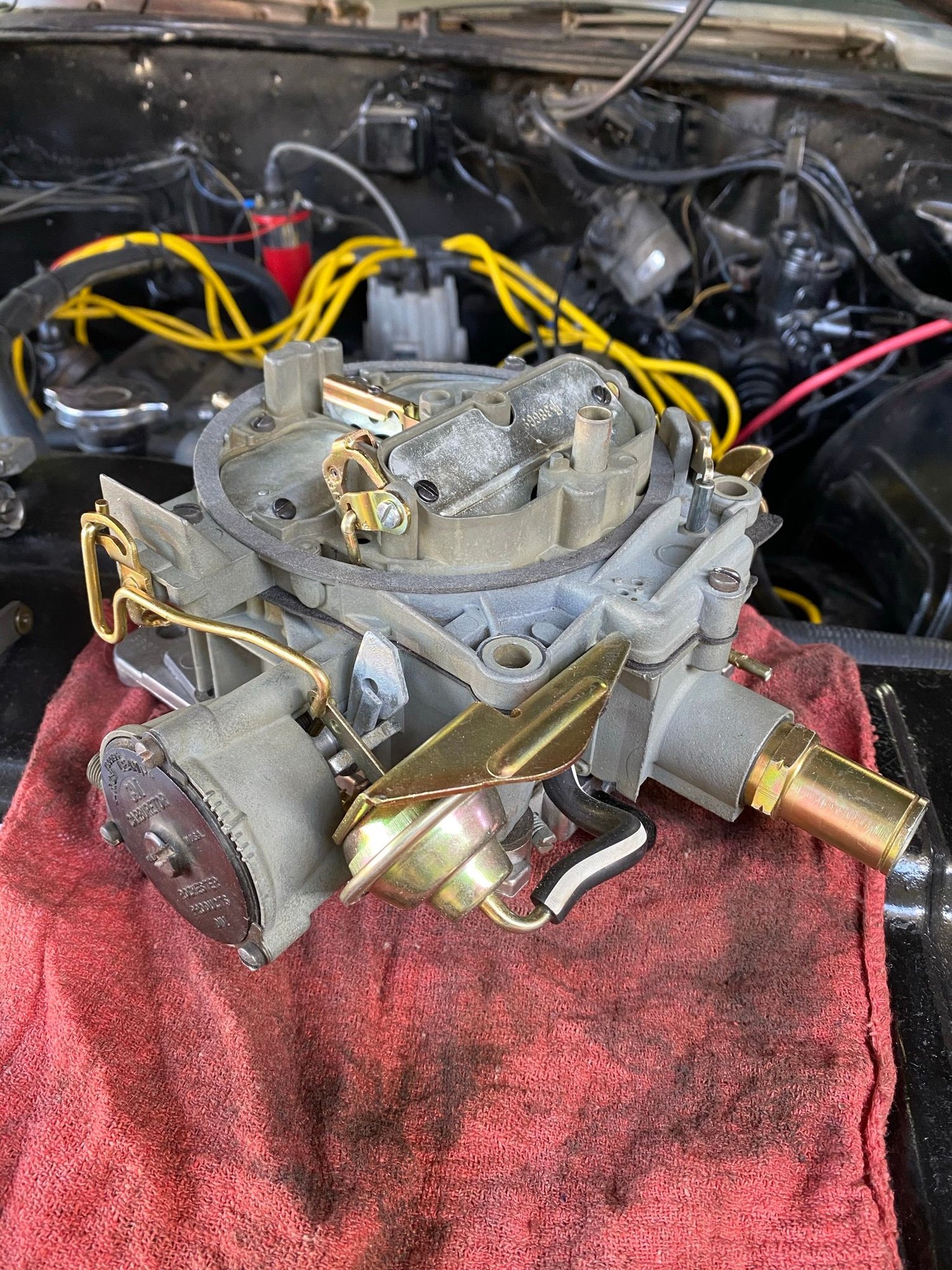

Incorrect carb from a 1980s era GM truck removed
Correct carb being installed
Correct carb mounted

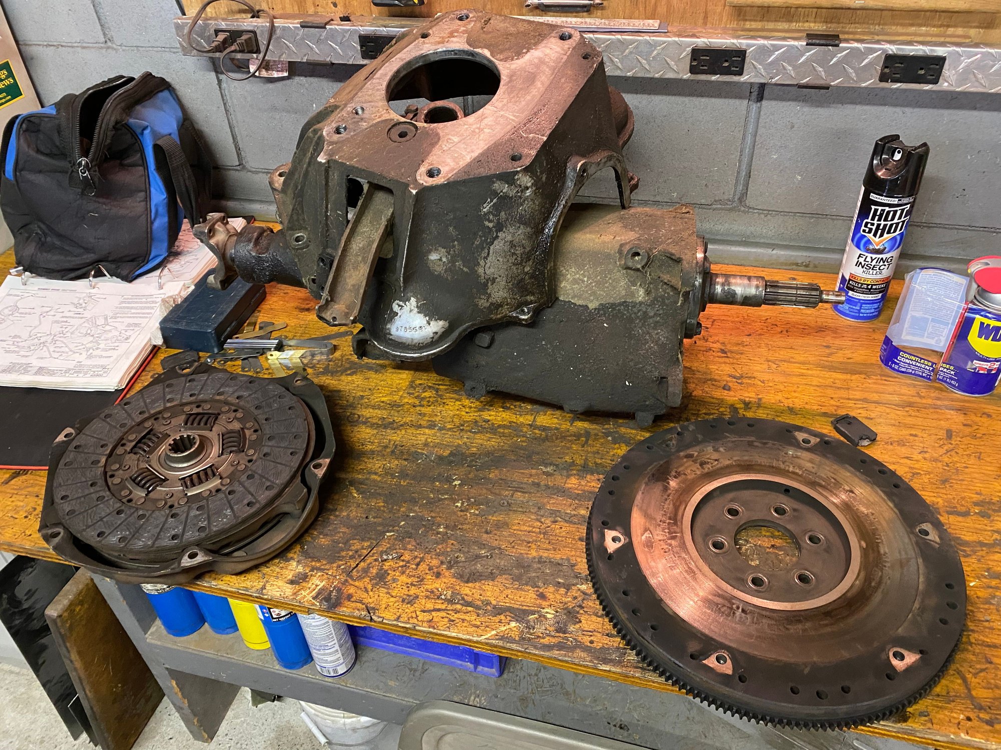

October 14 2021- loaded up to head to New York for a 10 day vaca
South of the Border first stop northbound
Arrived in New York 10/15/21
Unloaded to remove trans and replace clutch
Brothers 69 w-car
Trans removed

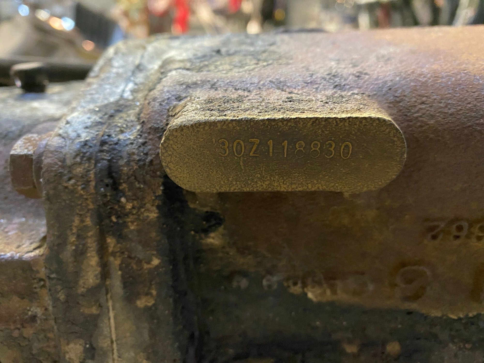

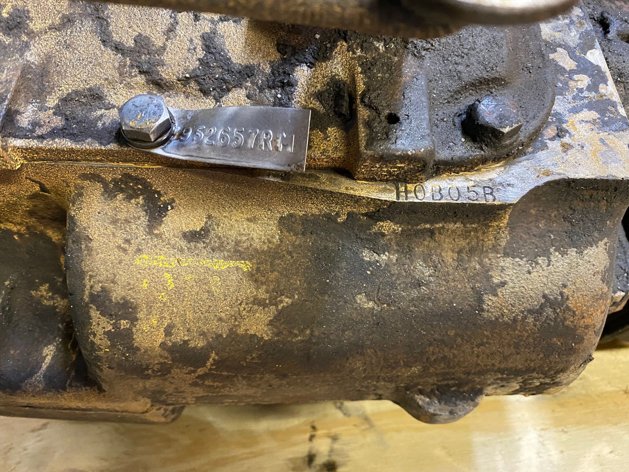

Tag intact and RM stamping still evident
Vin matched
Flywheel being cut
Clutch reinstalled, now testing adjustment.

Curious to know if you found one of these under your clutch fork?
Old Nov 6, 2021 | 01:38 PM
A1970QB's Avatar
Joe Puleo
Joined: May 2021
Posts: 50
I most certainly did not! But, this clutch has definitely been replaced before. It was not the original and honestly we think the wrong throughout bearing is still in there?!
Old Nov 6, 2021 | 01:54 PM
tnswt's Avatar
'70 4-Speed W Machine
Joined: Feb 2020
Posts: 1,248
From: North GA
And I don’t know if you should have one since you have a M14; my car has the M21. I just assumed it should be there. Most all these clutch fork stud rings have been tossed, misplaced, or purposely left out of re-installs in the past.
It’s my understanding they are not reproduced, and are rather rare finds today, and that is the reason I asked. I was lucky enough to find this ring installed when I replaced the clutch in my ’70 442 last year. I saw a post on here at one-time where a guy actually reproduced the part himself. Assuming again, that the purpose for this ring is to enhance the clutch pedal experience.
Just one small piece out of thousands that one finds on a car. By the way, what name-brand clutch did you install?

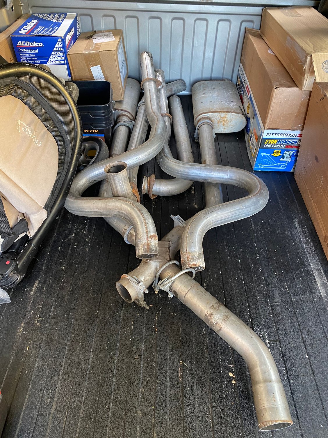

Last week new PYPES exhaust system installed. Finally got rid of the junky cherry bomb duals with horrid tips. If only I could figure out how to upload a video clip of the exhaust note now.

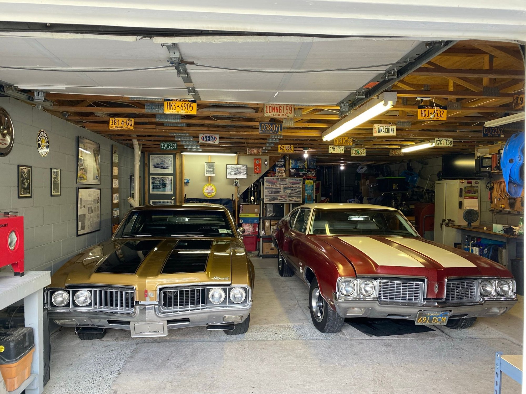

What a change 1 year was. I’ve loved my brothers car forever, partially because it’s all I’ve known for 34 yrs but also because I think it’s the stylish design through the years of our era vehicles. There’s nothing else like them. The 70 model has certainly grown on me, I just have a thing for all classics in one way or another.
*Note the historical timeline wall of my brothers ‘69 f85 w-31 car. 1 of 212 made.
Hoods up in the Olds cave
