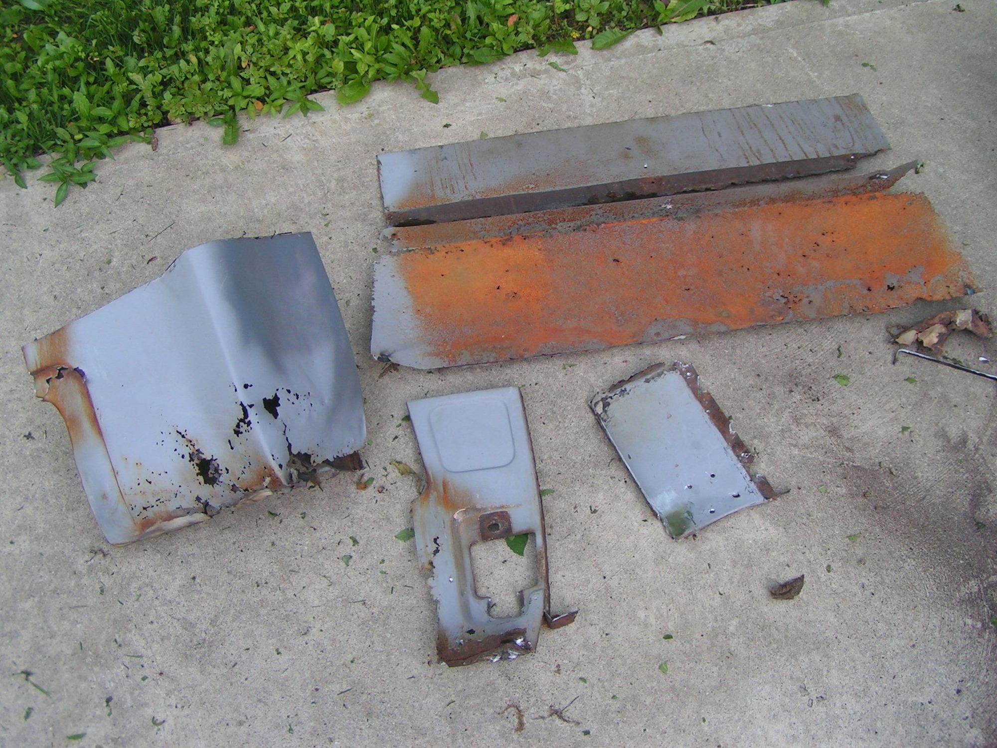

New quarter skins will be part of the build.

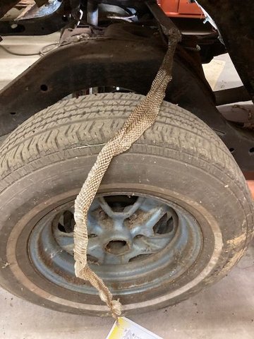

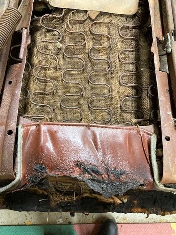

Had many snakes and mice living inside.  Heres a nice remnant from a large black snake.
Had many snakes and mice living inside. Here's a nice remnant from a large black snake.

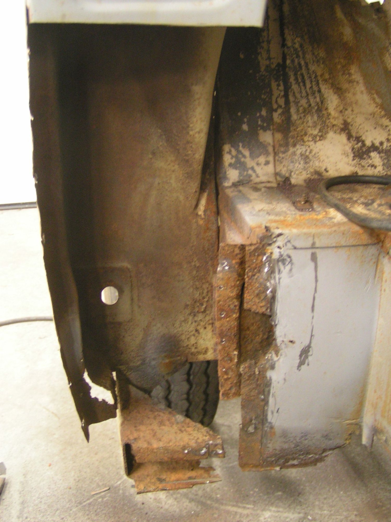

...and the trunk is pretty much a mess.

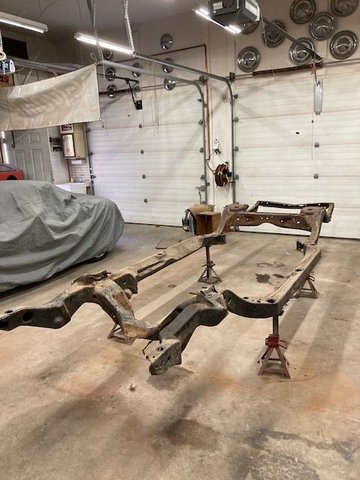

So here is my first major problem. The blaster removed the frame from my trailer by inserting his forks above the rear cross bar and under the rear spring mount bar. The front of the frame caught on the trailer, and he may have bowed the frame. I need to check for frame damage. Does anyone know how far the rear cross bar should be from the floor when the frame is sitting on the floor? (This dimension isn't in the Fisher Body manual.) Or, is there another way to check? I really don't want to have to put the body back on right now. I work alone and it would take me a day to do that.

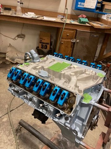

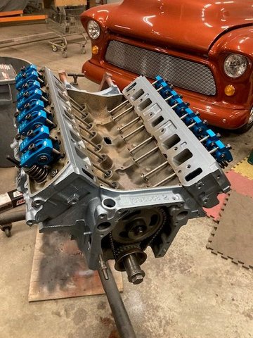

I've made quite a bit of progress in the last 3 weeks. Did some assembly on the engine, and the valves are now adjusted. Indexed the cam, and the deck height - corner-to-corner - is within a thousandth! (I had the block decked, but I didn't expect that!) The intake lobe centerline spec is 106 degrees, and mine measures at 105. I suspect that the align bore caused a slight looseness in the double roller timing chain (less then 1/4" deflection), which caused the one degree difference. Moving to the next keyway in the crank sprocket would retard the timing 4 degrees, which is too much.
Valves are set.
Valves are set.

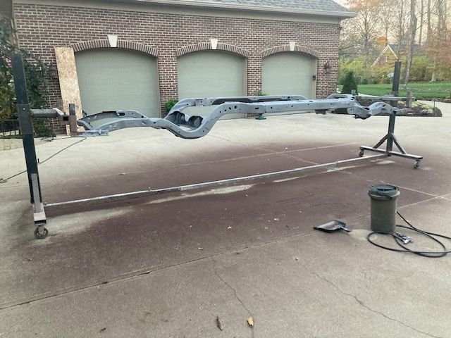

Yesterday it was 54 degrees here in Southern Ohio so I amused myself by touching up the sandblast work on the frame.
Sand blasting.  Ugh.
Sand blasting. Ugh.
Today it got to about 60, so I took advantage of one of the last warm days of the year by shooting primer on the frame and on about 30 small parts that had been 'blasted a couple of weeks ago. Looks great!

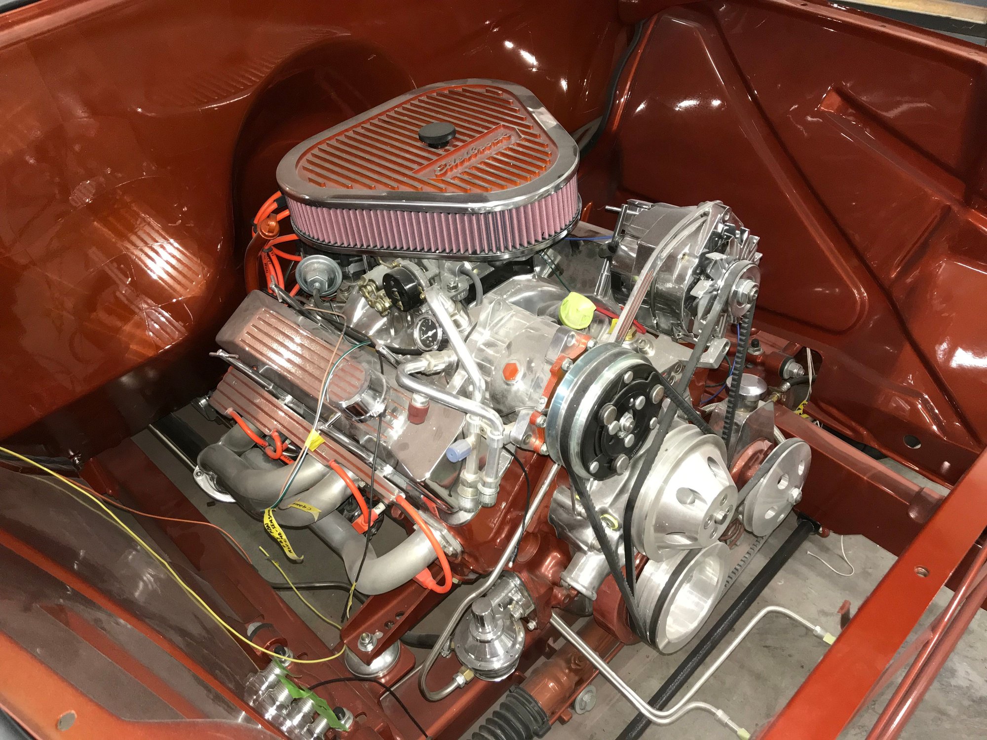

THE DRIVETRAIN:
The ENGINE is showcased a little above, but here are some more details. About 5 years ago, bored with winter weather, I decided to play with the #5 heads I had found, so I cleaned up the ports based on what I had learned years before. I stopped without "fixing" the siamesed center exhaust ports (why did they ever do that?), then turned the heads over to a buddy of mine that does trick headwork in his garage. (He even has one of Bill Jenkins' old valve grinders, and has 12 torque wrenches hanging on the wall. I've never seen so many precision measuring devices, many of which are dedicated to head work.) We added Ferea stainless valves, comp springs, some lightweight retainers, bronze guides, studs to allow valve adjustment, hardened seats, pushrod guides and a triple-grind. Spring pressures were tuned via spring spacers. I worked the chambers to 64.7 cc and then Bob touched up the surface to perfection.
The block went out for de-rusting and overall cleanup, then over to Precision Engineering for magnaflux, deck, a .030" overbore and align hone. The crank got the normal .010"/.010" grind, oil hole chamfer and index. The Speed Pro flat tops checked in at 653 grams and the assembly was balanced. Pushrod length spec'ed out to 8.50" and the drive train was topped out with PRW rockers, which I've had good luck with on my GTO. The compression ratio was more than desired at 10.1:1, so I looked to Cometic for the solution. $145 per gasket? I don't think so. I bought a second set of blue Fel-Pros on Amazon for 18 bucks for BOTH, glued them together with Spray-a-Gasket, and doubled them up for a ratio of 9.6:1. (Now, before you purists go crazy, please realize that 425 HP '63 409 came from the factory with double head gaskets. Besides, it's not the end of the world to have to change the head gaskets. Let's just look at it as a learning experience.)
I had picked up a near-new Edelbrock performer for $60. I had a '75 Quadrajet in the attic. It is now rebuilt and converted to an integral electric choke, so it will top off the engine build. (Are there better carb choices out there? I suppose, but not for the price of a carb kit and a float. Besides, I know a lot about Quadrajets thanks to Cliff Ruggles.)

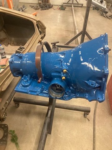

The TRANSMISSION is a 700R4 that someone had trashed by running it without a proper TV valve adjust. (Yeah, I know 200-4Rs are easier to slide in what with BOP cases and no requirement to change the driveshaft and crossmember, but I'm a sucker for additional punishment..) This trans will be good for over 500 horsepower, and will be an easy fix once I get it apart. Besides, I'm curious to see which clutch pack gets launched when someone does this. Goodies in this unit include a Trans-Go kit, heavy duty sunshell, Corvette servo, pinless accumulator piston, 29-element forward sprag, Alto red clutches and an unbreakable pump ring kit.
The REAR END started out life as an open 2.56, I believe. Due to some tough choices between cost and performance, it will be a set of Dorman 3:55s mounted onto a Yukon positraction carrier.

Time for an update. The engine is complete enough to put into the chassis once it is ready. I will put the starter and headers on before planting her though.
Ready to go into the chassis once the chassis is ready

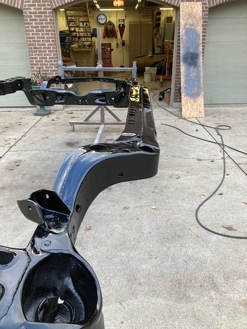

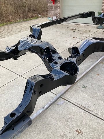

All of the welding repairs are done on the frame and I'm applying a little body filler here and there to fill pit marks left over after the rust was blasted out. Just sanding with 80-grit now, with hopes of one good weather day to shoot high-solids primer, maybe a sealer coat, then the gloss black. Pretty soon I'll be taking the engine off the stand so I can use the stand to hold the transmission. I have a feeling the winter will be filled with rebuilds of the trans, steering box, wiper motor, etc. due to the weather hold-up on the frame.

The 700-R4 is apart, and I'm trying to solve a excessive clearance issue in the 3-4 clutch stack. It's at .110", and I need to get it down to about .075".
I suppose I can either stick in a thin steel or use a thicker selective. I'll have to talk to someone with more experience.

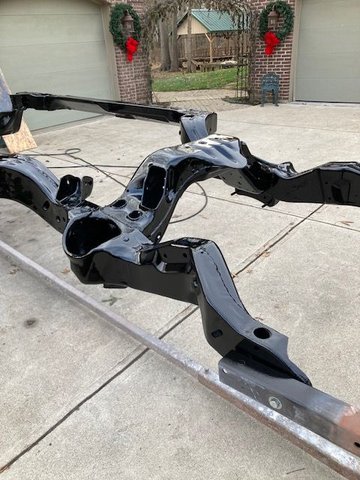

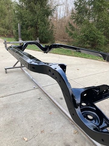

I've been sanding on the frame off and on for about 3 days in anticipation for today. It got to 60 degrees, and I got the frame sealed and painted:

Further work on the transmission showed that both the 3-4 apply plate and the backing (pressure) plate were cupped due to the heat from the fried clutch pack. The trans parts place didn't have either of them in the thickness I had, so I bought two other ones, added a .060" steel and solved my problem. I'll probably be back on the trans tomorrow.

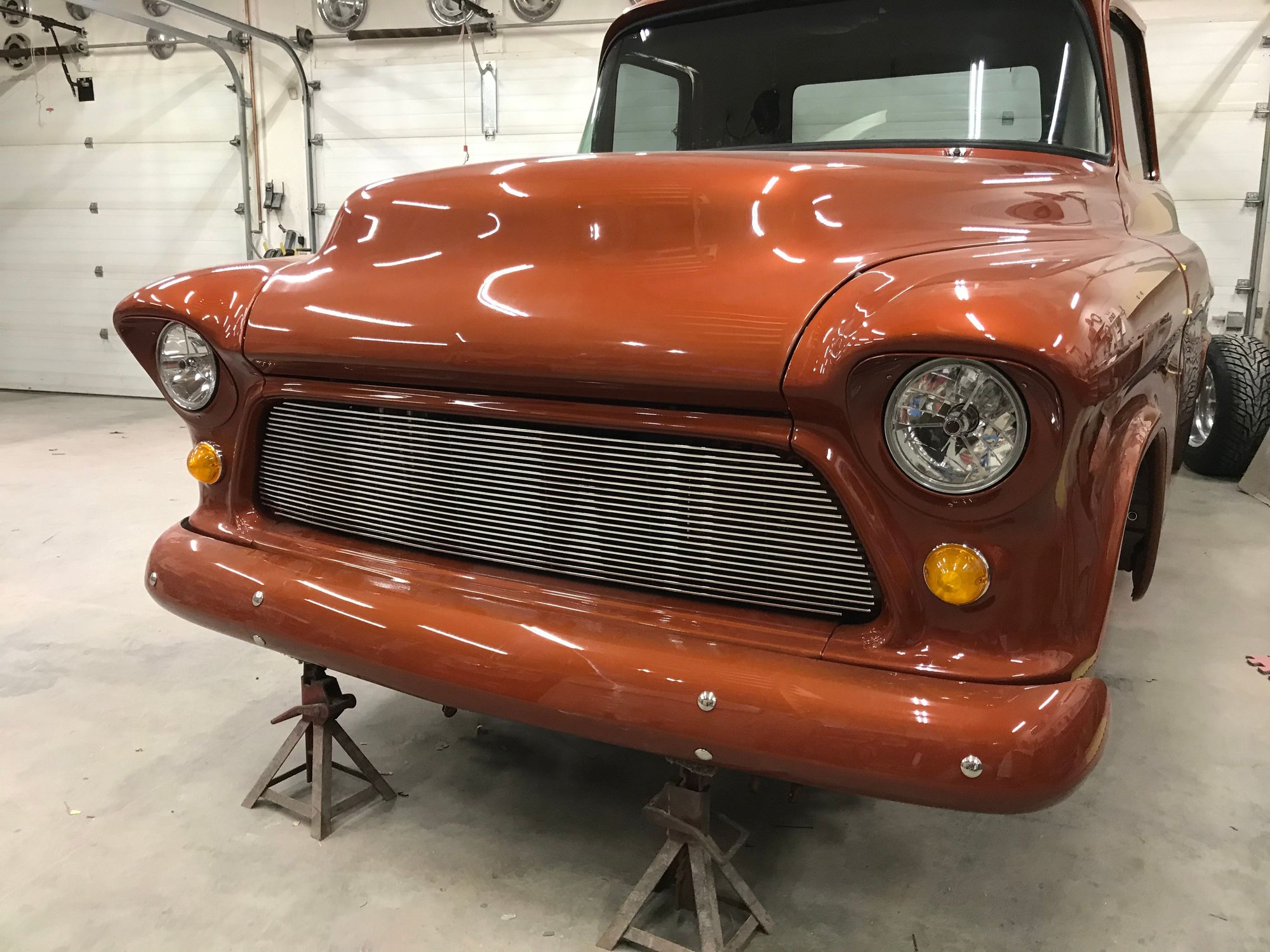

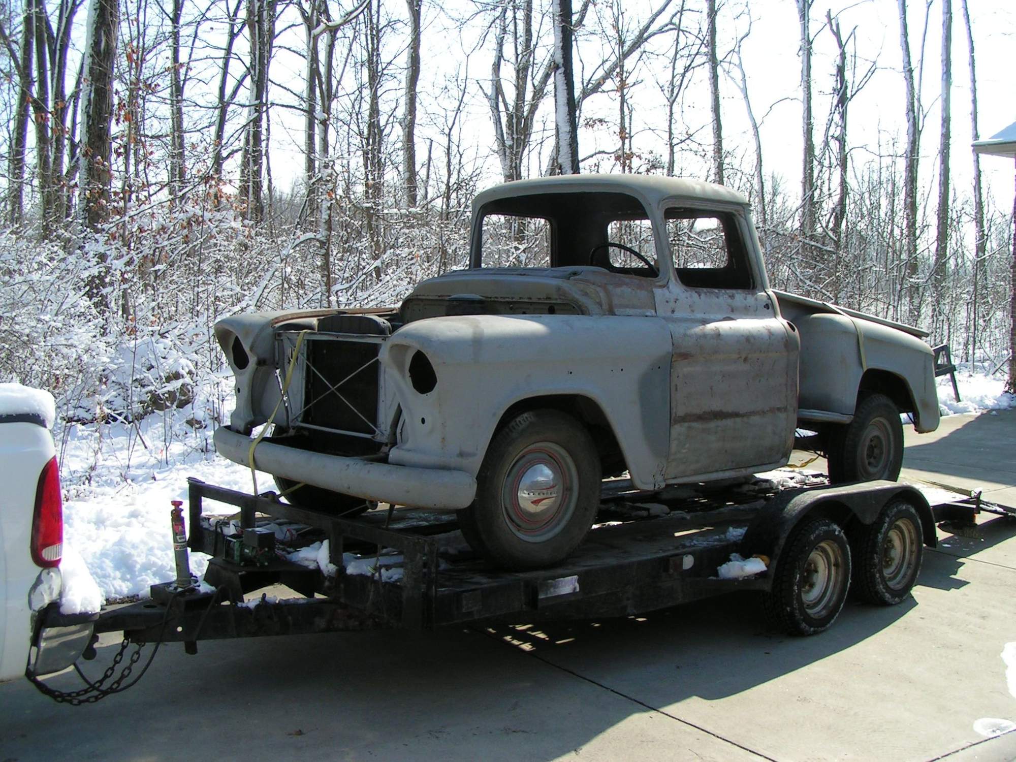

I spent 11 years on my '55 truck, but that was a lot of amateur custom work.

Swiss cheese
Swiss cheese
Hinge pillar
Hinge pillar

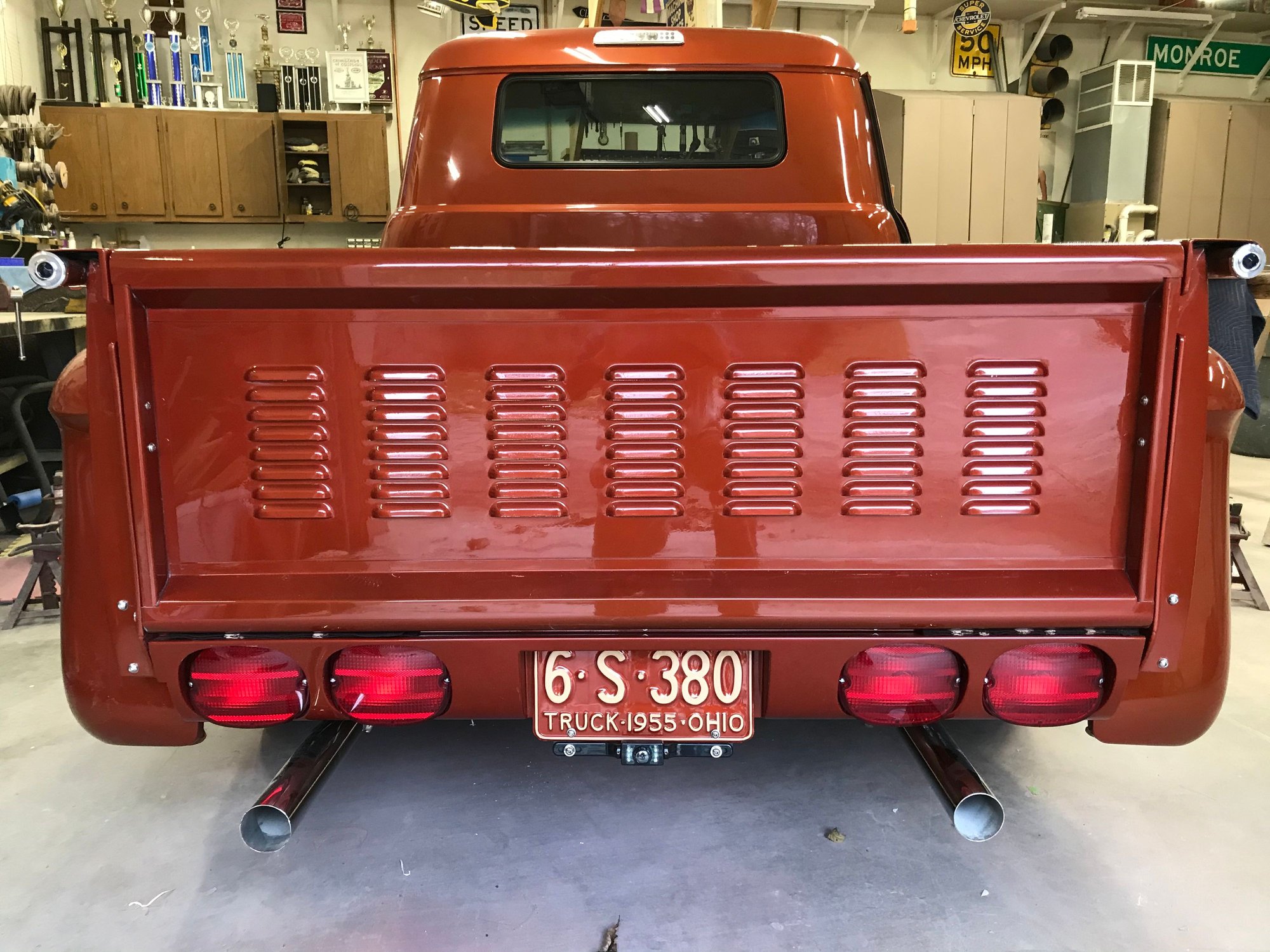

Frenched C5 tail lights
Built from swap meet picks
Nearing the end
Nearing the end
Almost done!
Almost done! (Tail pipes look terrible here, )

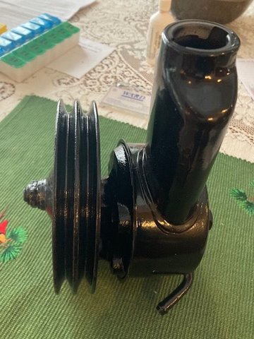

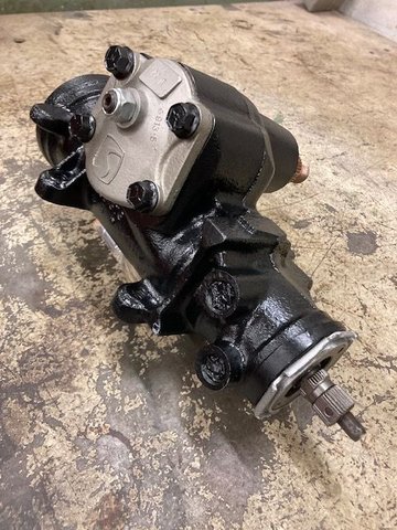

Since I can't work out on the driveway (what with the snow and all), I took the steering box to the basement and rebuilt it:
I never did a '60s power steering box before, and it was interesting. Amazon had a Sunsong kit, and it was perfect. There also are a couple of very good videos on YouTube by "BFH Garage" and "Craft Customs', the latter being pretty humorous in places to boot.
Yesterday I tore apart the power steering pump, but it'll be 5 more days until the kit gets here. The external parts are now sandblasted, and I might get them painted this afternoon. It will be an easier build than the box.
While I'm waiting for the pump kit I'm going to tear apart the proportioning valve, which will be next. Hoping for warmer weather so I can get back on the chassis by blasting and painting some of the bigger suspension parts.
Old Jan 14, 2025 | 12:24 PM
  #36
69 Ragtop's Avatar
Joined: Jun 2010
Posts: 275
From: Lebanon, Ohio
Knocked out the power steering pump over the last couple of days:
Also bought the hoses and painted the brackets, so I'm done with this subsystem.

Time for an update. It's been cold, but I've been working in the basement, trying to do a little every day. I've restored the alternator, regulator, brake distribution block and the wiring harnesses. I know I did some other small stuff too, but here are the harnesses, hanging in the attic.

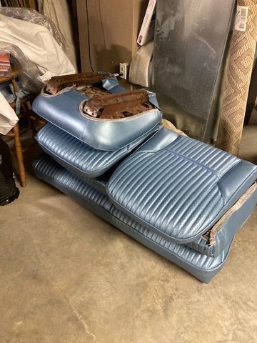

...but the big thing was the upholstery. The bucket seats that I had found had been in a fire, but the springs and bases weren't affected. This first picture shows some of the fire damage, but I didn't take a good pic before I stripped them:
Fire damage.
Fire damage.

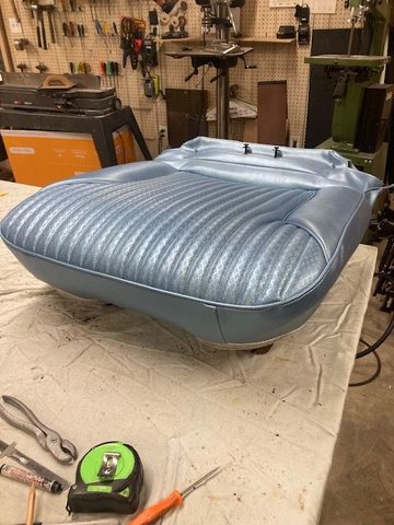

After that came the repair/replacement of a few springs:
The two black springs are the new ones.  Dont laugh too hard at the cable clamps, but those really work!  I used lock washers and loc-tite on them as well.
The two black springs are the new ones. Don't laugh too hard at the cable clamps, but those really work! I used lock washers and loc-tite on them as well.
I installed new burlap, and a felt perimeter:
Then came four layers of 1/2" dacron:
Dacron before trimming.  Slots cut to access listing wire.
...and, the final product!
One seat bottom...
One seat bottom...
...and the rest.
...and the rest.
No steam has been used yet, but I have to look hard for any wrinkles.
Old Feb 14, 2025 | 09:24 AM
  #38
67OAI's Avatar
Old(s)GuysRule
Joined: Apr 2016
Posts: 1,566
From: S.E.Georgia
Nice work! I'll have to get my seats recovered soon. Not something that I'm looking forward to doing!
Old Feb 14, 2025 | 09:50 AM
  #39
69 Ragtop's Avatar
Joined: Jun 2010
Posts: 275
From: Lebanon, Ohio
They really weren't too bad to do. Legendary Auto Interiors has some great YouTube videos to guide you along:
Thanks!
https://www.legendaryautointeriors.c...llation-videos
Also, this guy (Craft Customs, YouTube) does a good job on many of his videos, and this one has some great tips:
His tip on the dacron led me to try 4 pieces right off the bat, and it was perfect (although you'll swear the vinyl will never stretch that far!). Also, his tip on covering Lowes 1/8" steel wire with masking tape worked pretty well too. Those kept me from needing to buy the expensive cotton and "paper coated listing wire" (as the guy says 50 times in the Legendary videos), and saving me some serious beer money!
