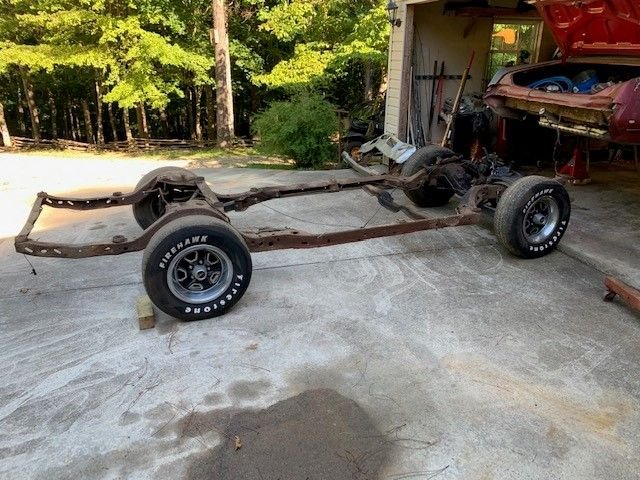

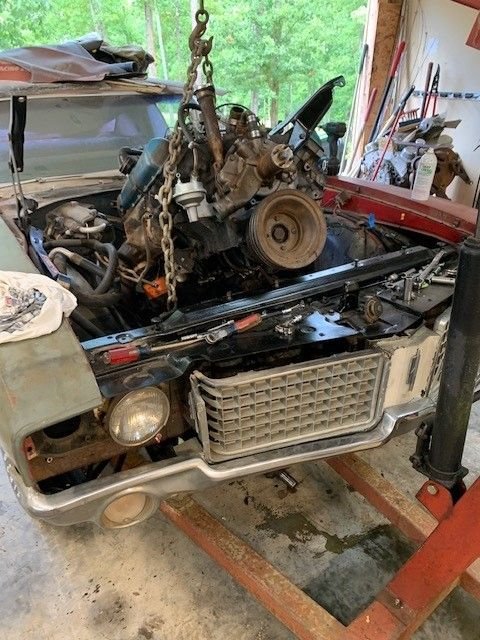

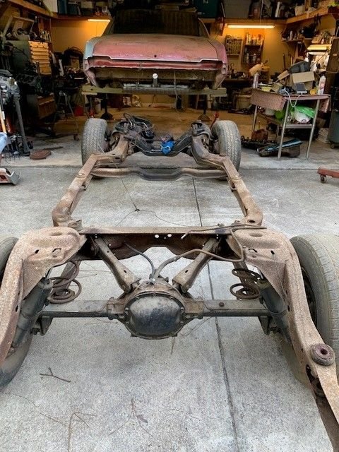

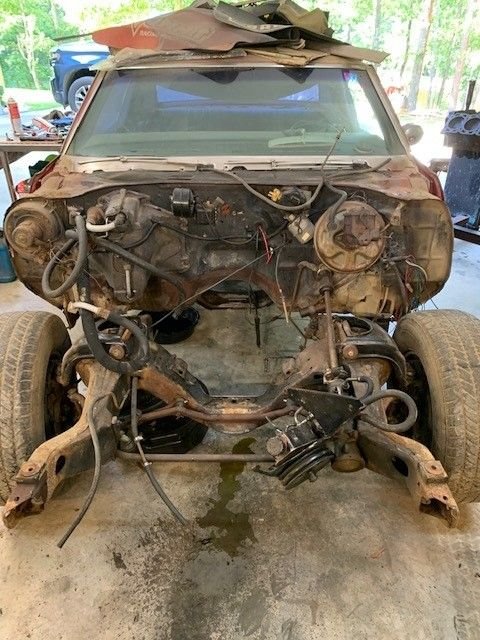

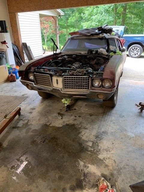

Hi All! so this is my first attempt at a frame off restoration. Of course this project didn't start out as a frame off resto, I've had this car since I was 20. I just wanted to get her road worthy and fix things as I went along. She had had been parked for about 10 years. I finally got it running last year but it wasn't running very good. The front oil seal was slinging oil so I started with that, which means you have to take off exhaust, starter, distributor cap, motor mounts, then jack up motor just to get the oil pan off. I then decided I was this far in I might as well go ahead and rebuild motor. I already had a new Painless wiring harness so I thought I can do this now that motor was out. Then thought well I already had body bushings so I might as well go ahead and take body off so now here I am! The rear body mount brace i had to remove that's the part I'm waiting on now. I cant mount the back Rotisserie until I cut out and weld in trunk patch and braces back in. Cars are not my full time job so working nights and weekends when I have a hour or two. this is what have gotten done in the past couple years. seems year one or any other body parts place takes forever to get parts. Sure gad I am not in a hurry!

scrappie's Avatar
Posts: 3,442
From: eastern MA
Front oil seal turns into a frame off resto…. Might as well
Looks like you have a 455 also? What year motor?
Nice job, definite labor of love.

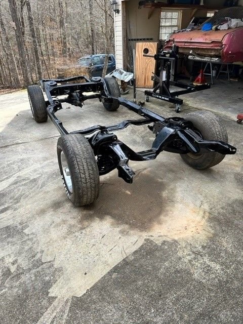

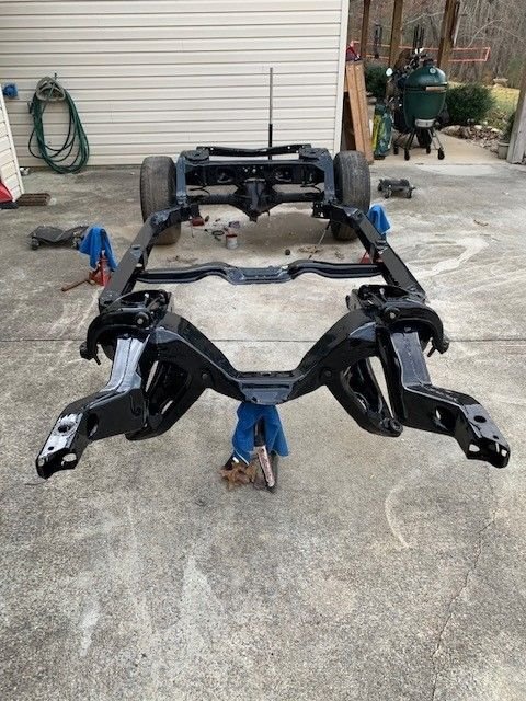

Old Feb 8, 2023 | 01:17 PM
ddd777's Avatar
Joined: Sep 2012
Posts: 334
From: Maine

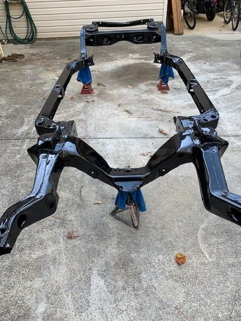

Frame looks great.
Painted or powder coated?

Old Feb 8, 2023 | 03:13 PM
budlite70's Avatar
Joined: May 2021
Posts: 15
From: West Georgia
Not a 455 although i wish it was. its a 350
Old Feb 8, 2023 | 03:14 PM
budlite70's Avatar
Joined: May 2021
Posts: 15
From: West Georgia
Frame and suspension parts are powder coated.

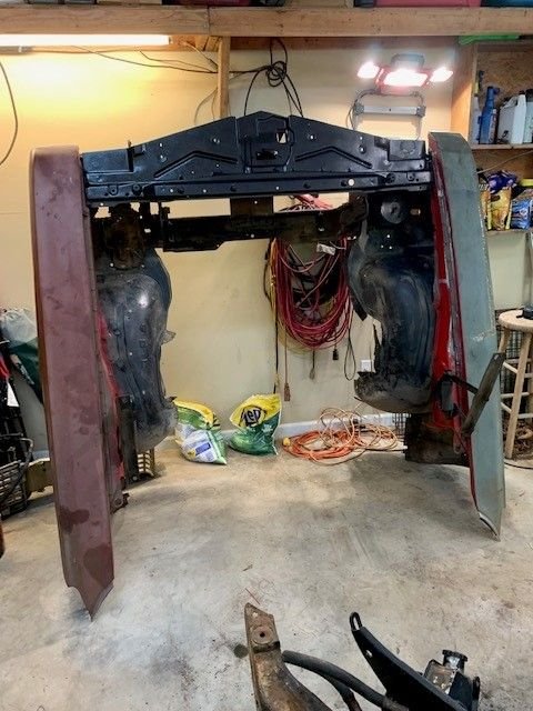

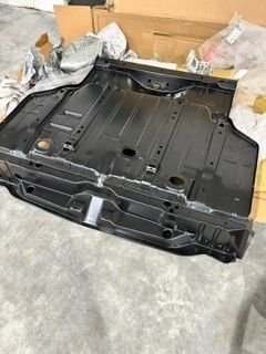

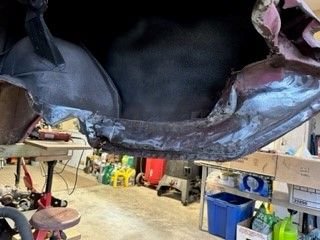

72 Supreme First Attempt at a frame off (UPDATE)

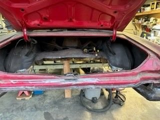

So just a update. Now hoping for a day or two to work on it.
rear body brace too rusty to mount rotisserie
reason for the new Trunk pan
still have to remove some more sheet metal for the complete Trunk pan
New trunk Pan from the Parts Place its listed as a 70-72 Chevelle from AMD
a little rot repair needed
test fit the pan to make sure all the body bolts would line up

Originally Posted by budlite70
It looks like you were originally planning to just replace this rear brace (not sure what the correct name is) - the part with the rear body mount caged nuts that you've removed here. Obviously you've opted for the full trunk pan replacement but did you find a replacement piece for that cross member on it's own?
Old Mar 22, 2023 | 12:18 PM
budlite70's Avatar
Joined: May 2021
Posts: 15
From: West Georgia
My first plan was to just replace the rear body brace but I was never able to find one for a 72. I think someone in a previous thread I read in here said that one from a 69-72 Chevelle would work. Located that part, it looked the same so I ordered it from year one, of course now they don't know when it will be available from overseas. AKA Japan. Then after attempting to refabricate/customize the rear body brace and cleaning up all the rust it was more Swiss cheese I didn't want to deal with and found the complete trunk pan.
Amazing how these "little" MAWs explode beyond expectations! Looks like you're on the right track though.
I've got a solid section from another car so it sounds like using that to patch mine is the best option for me.

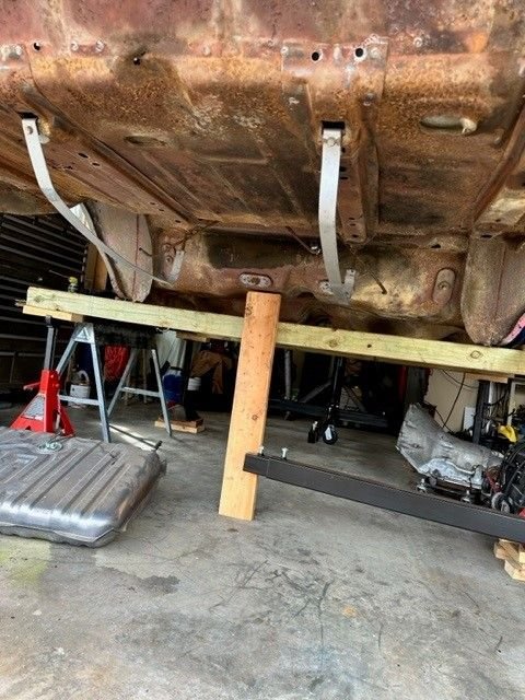

Looks very familiar.
My rear brace was rotted out as well.
I ended up welding a piece of angle iron to the rear brace so I could mount it to the rotisserie.
Then I flipped the car over and let it sit on saw horses so I could detach the rotisserie and replace the brace.

Powder Coated ... I opted for the Gloss finish
