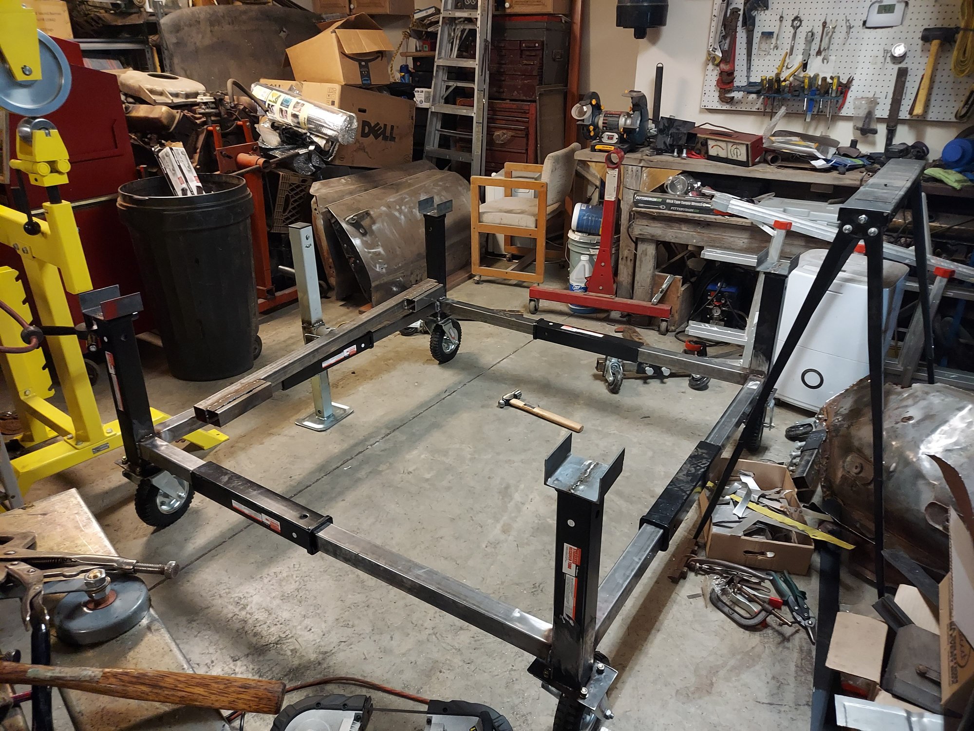

Since shipping is crazy for body carts I decided to make my own.
I had a set of wheels for my frame cart that will work nicely indoors.
Also, I set it up for some easy outdoor rolling.
I hope to finish up tomorrow with some channel pads.

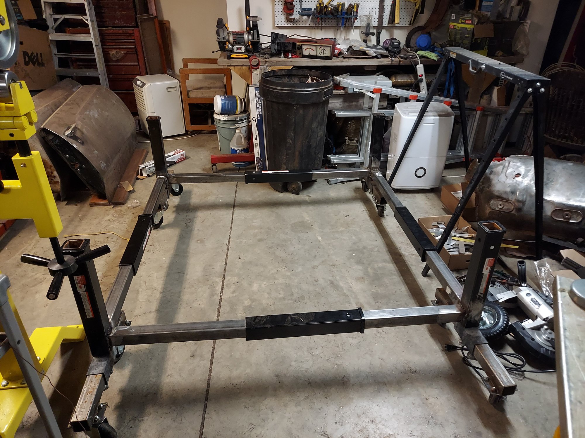

Pads are in, just a few holes with welded nuts to lock the adjustable arms left to go.

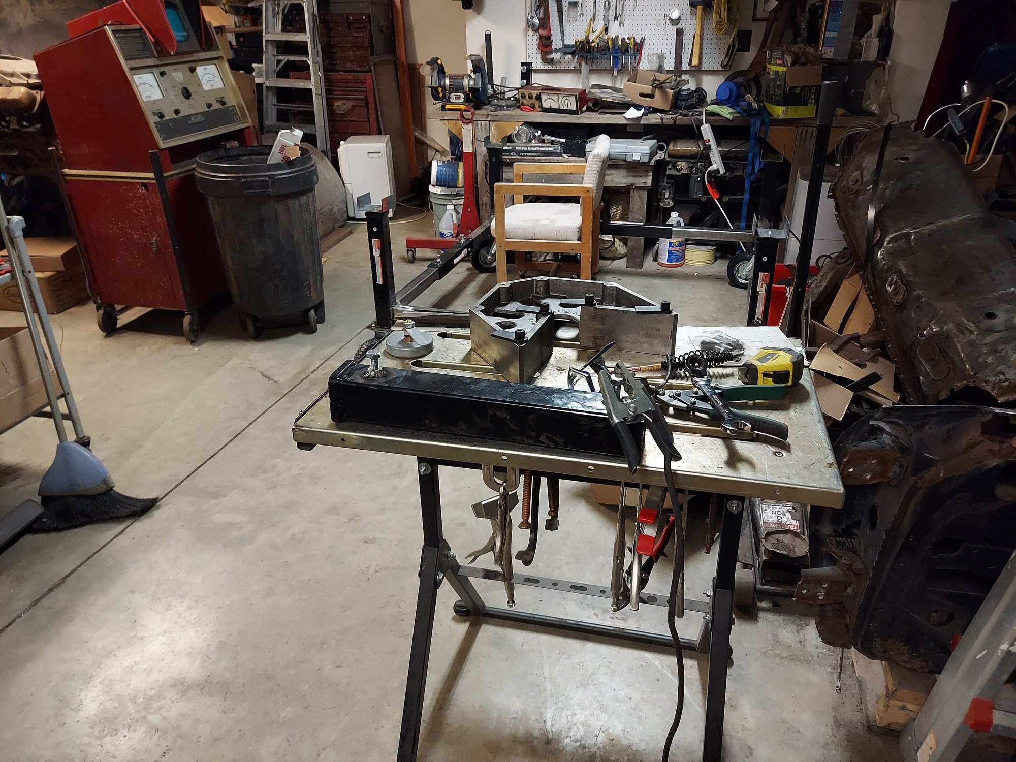

Drilled the holes and welded the locking nuts in place...
I think it's done for now.

Looks sturdy, nice work.
I havethe same welding table, i like it folds easy enough to be put outof the way and sturdy enough to hold some heavier items
