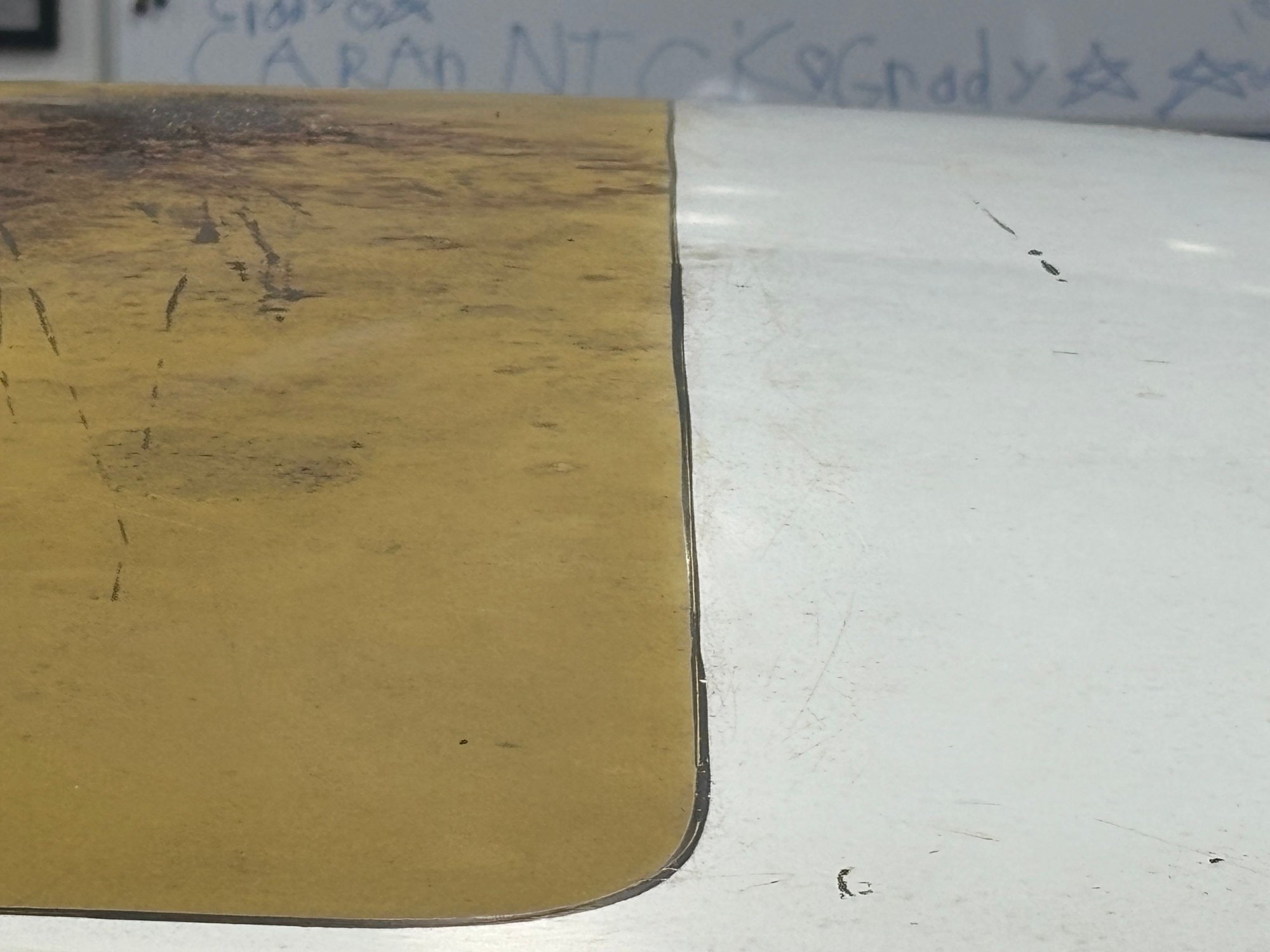

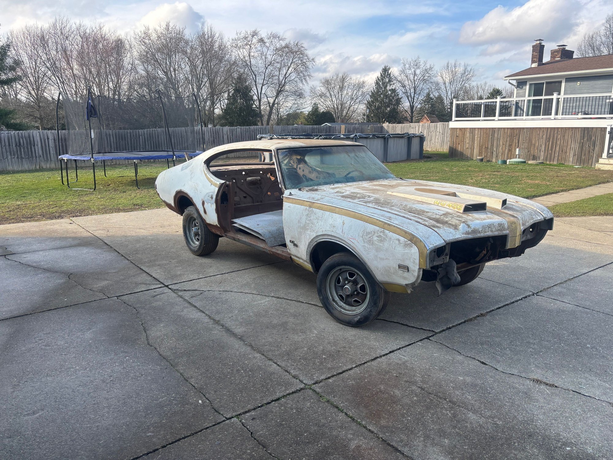

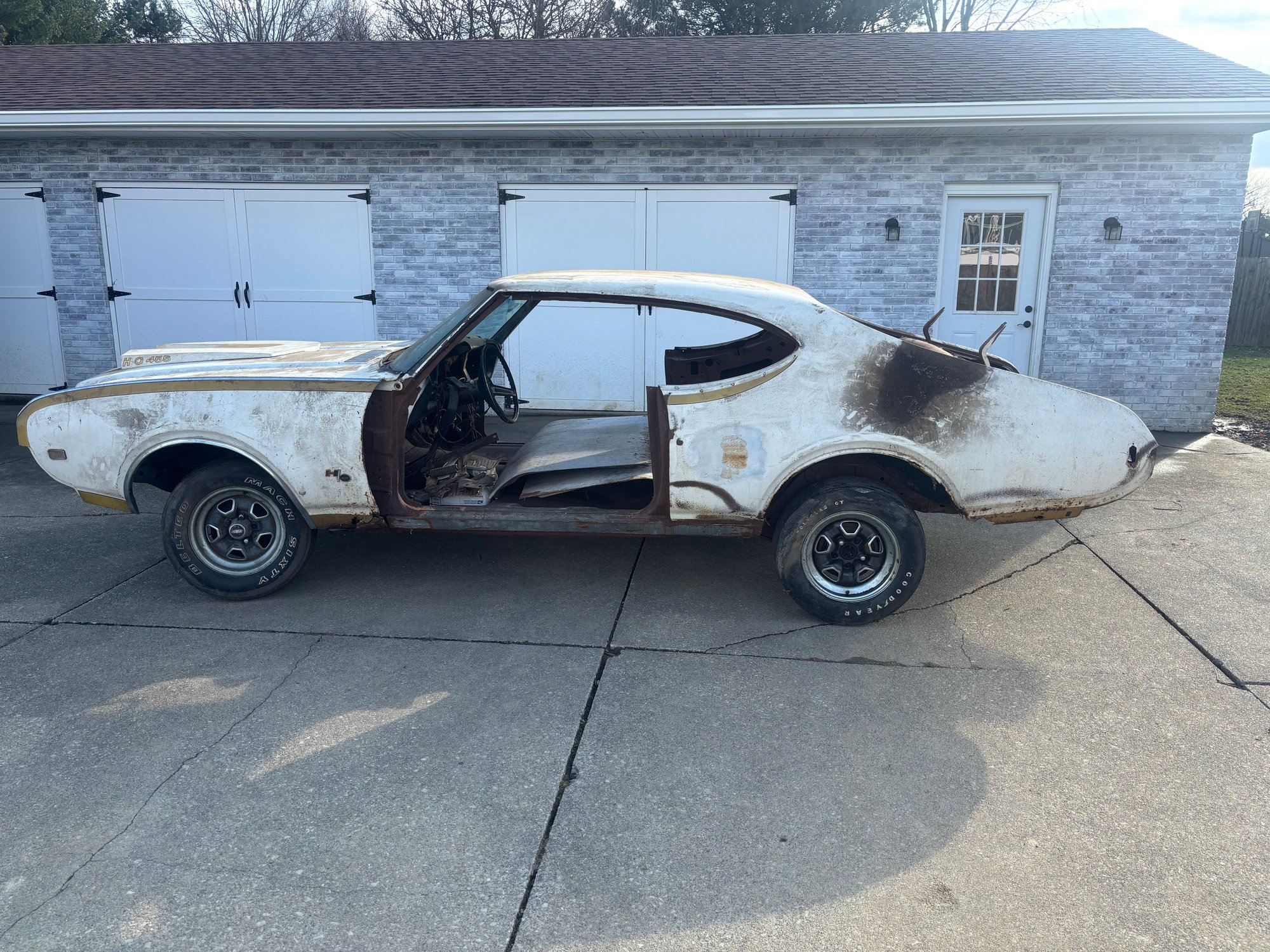

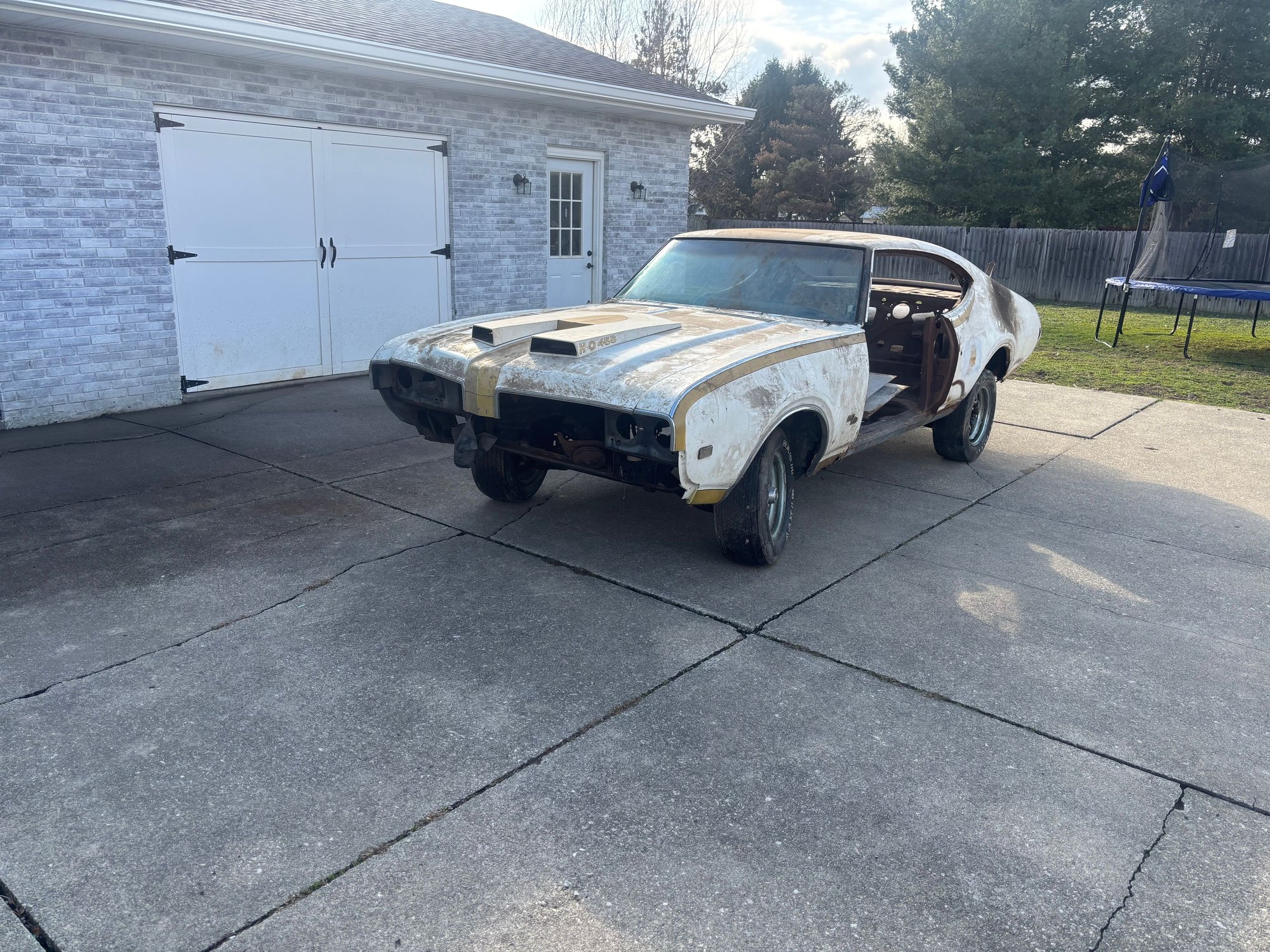

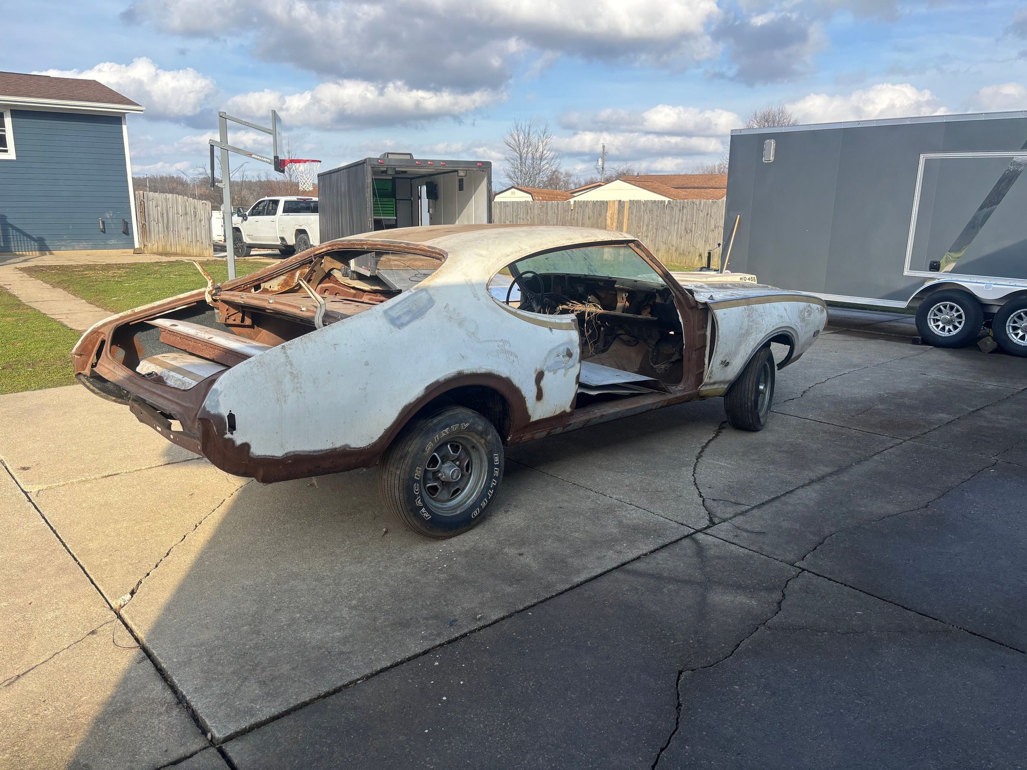

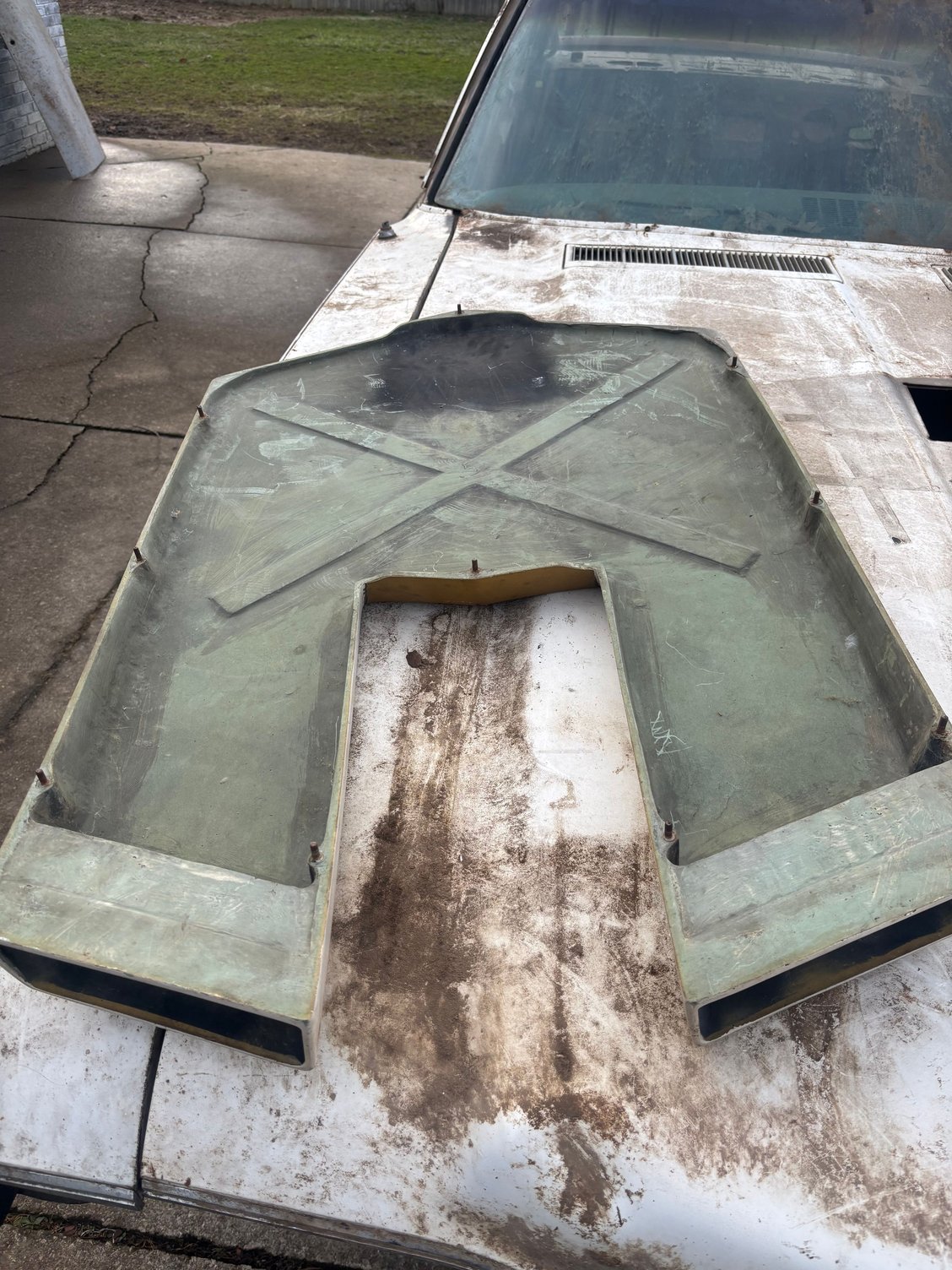

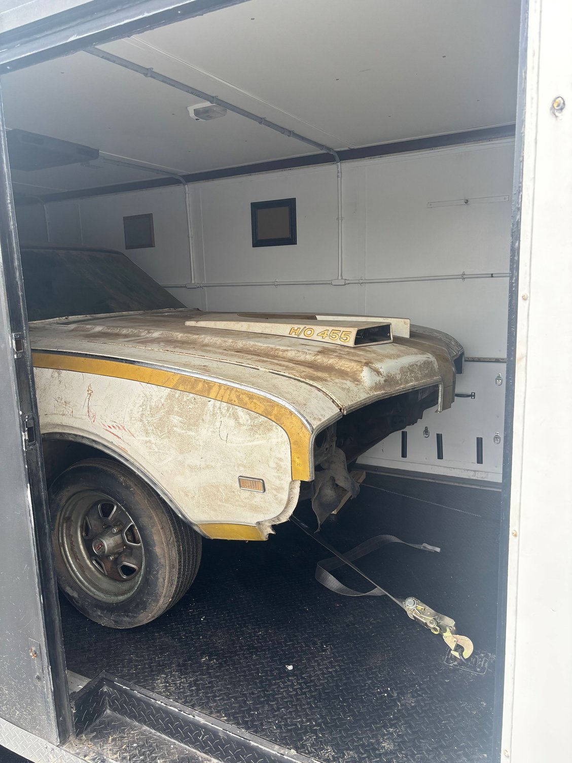

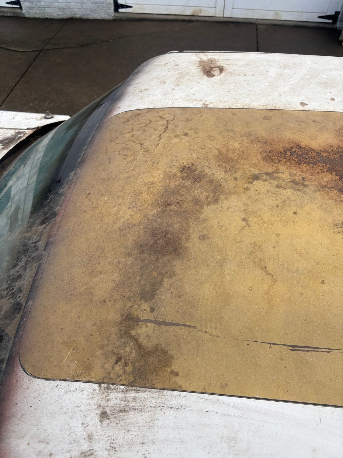

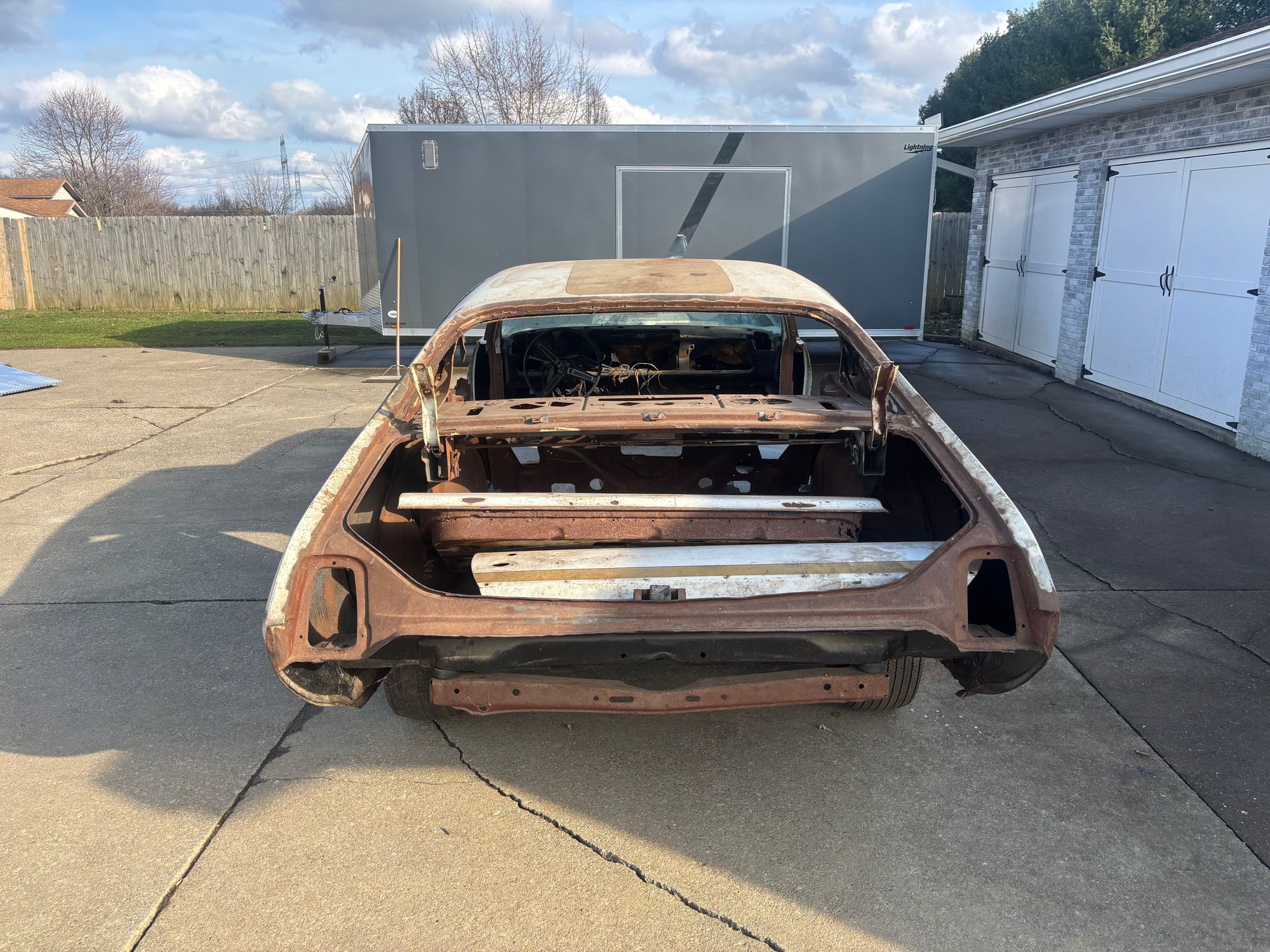

A little back story to this car. Tim Murphy had told me about a 69 W31 was and of course I was very intrigued. I reached out to Bill, the owner, on this website through a private message about 2 years ago about the 31. The conversation lead us to this 69 Hurst Olds, it’s number 318, original paint and original stripe car. It’s a numbers matching non A/C. Very cool car,
very cool story. Bill had asked me if I would help him with the body work and getting the chassis done. Without hesitation I jumped at the opportunity to help him out. So my brother James and I will be getting this car ready for paint and restoring the chassis back to original. First thing we’re gonna do is document all the dimensions of the stripes and try to make templates. Here’s some pics, I can’t wait to get started.

Yep, Bill has a few of them..
Glad to see it's getting back out there, document it up nice, take a ton of pics!
The last pic it great as it shows what I've seen a few restored cars get wrong.
The rear of the roof stripe is what you can call ever so slightly 'concave' as it follows the rear roof line, good stuff!

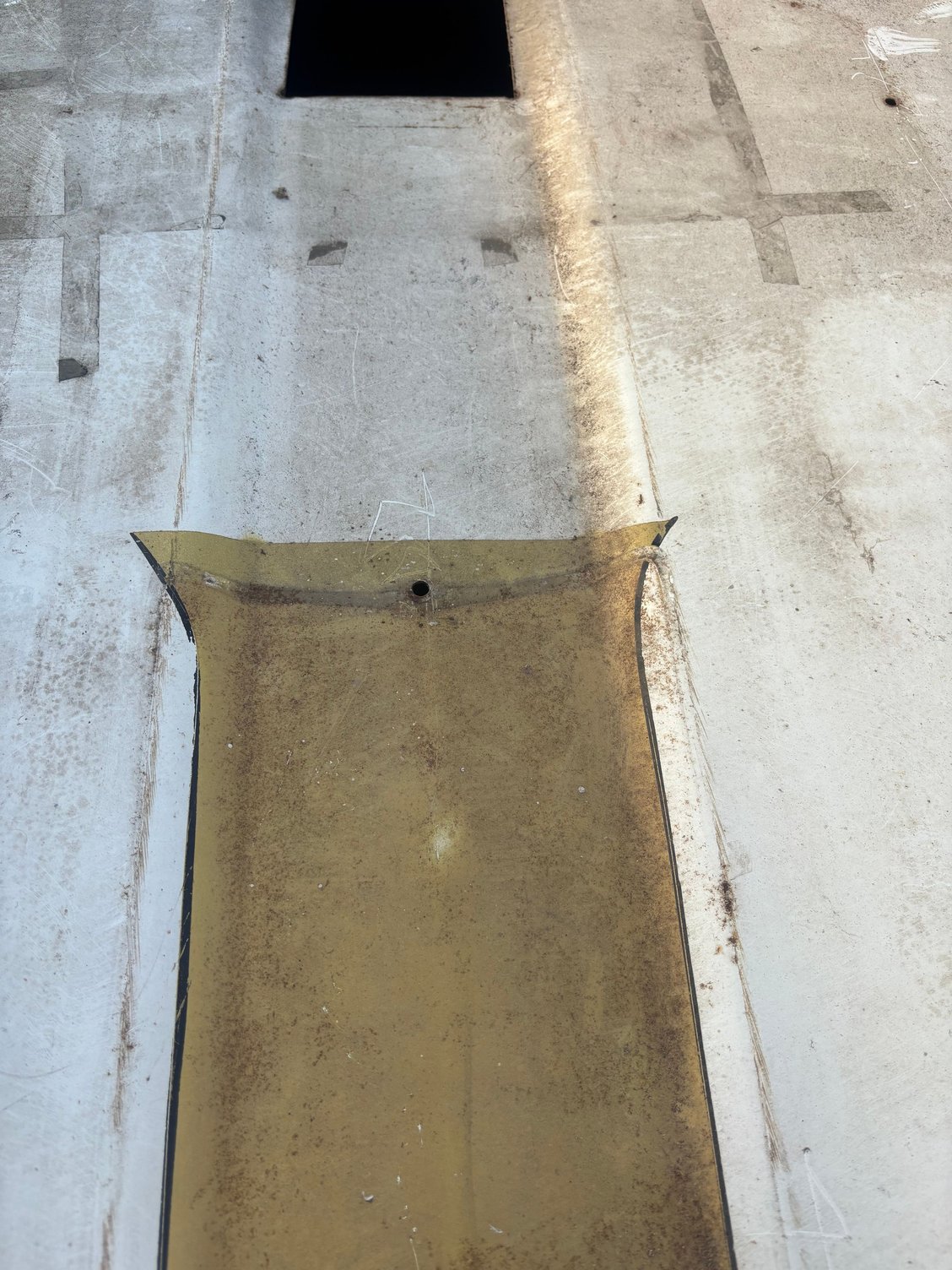

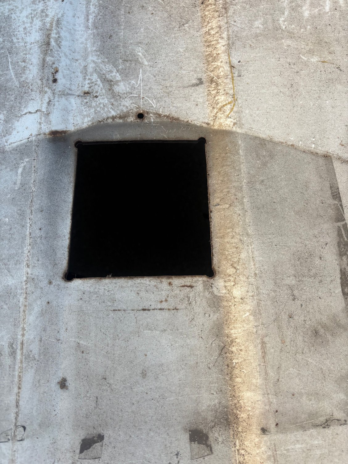

Interestingly it has the "X" under the scoop. Mine does not have that. I don't know what cutoff point they added the "X" under there. Supposedly for more support as most sag on the top.
Plus, those "H/O 455" decals I don't think will ever be replicated correctly. I love the "brassy gold" look they have, but they're on some sort of weird material and screen printed with that golden hue outlined in black. Stuff seems more like a paint. Many years ago, I had a number peeling on mine and had a big decal making company look into it to see if it could be replicated, but sadly, while it was outside possible, the entry cost was way to high to make it feasible, at least for this guy. They never even sent me back the rest of that number I sent them. Those A-holes. I even forgot who it was now.

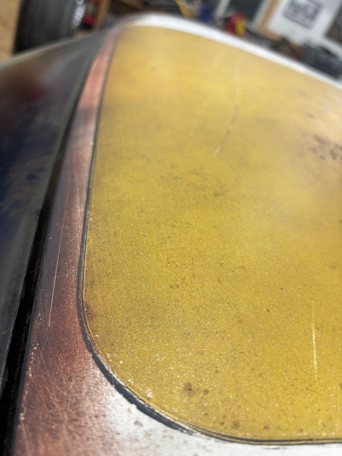

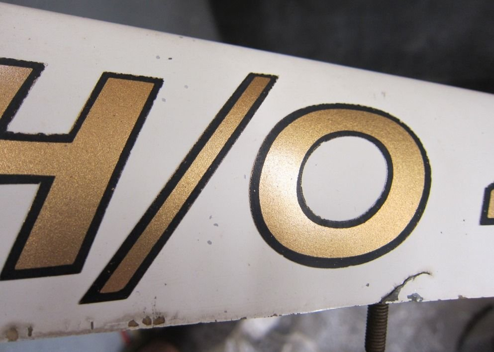

Yeah, here's a closeup of the original decal. It has some sort of a strange "texture" of sorts to it. It's not smooth like regular vinyl striping. And it's not exactly the same shade as the painted stripes. Or the head rests for that matter.

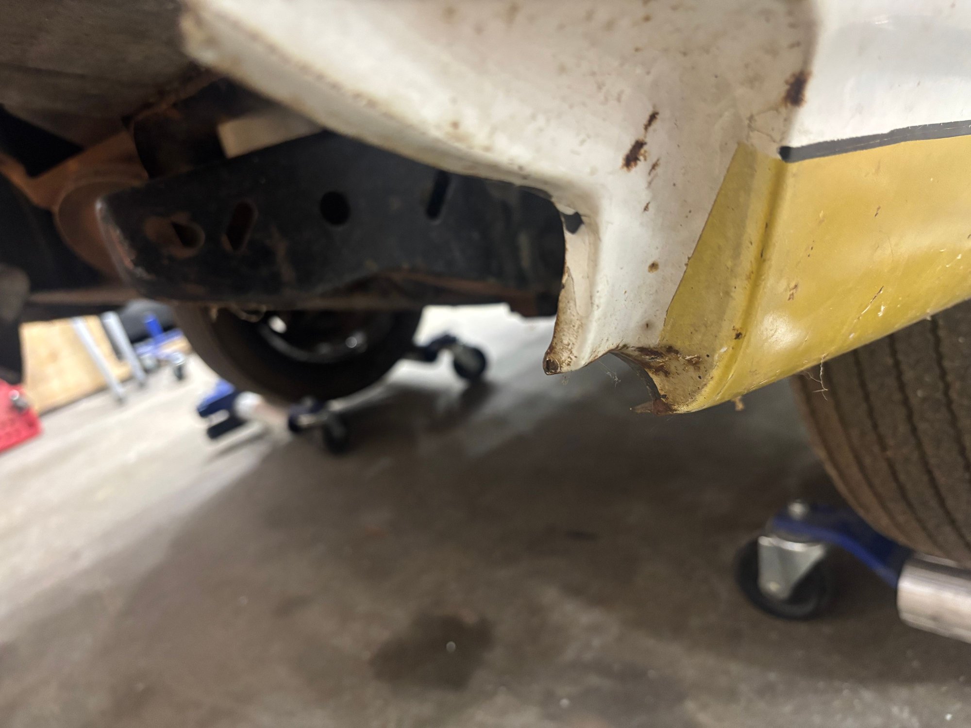

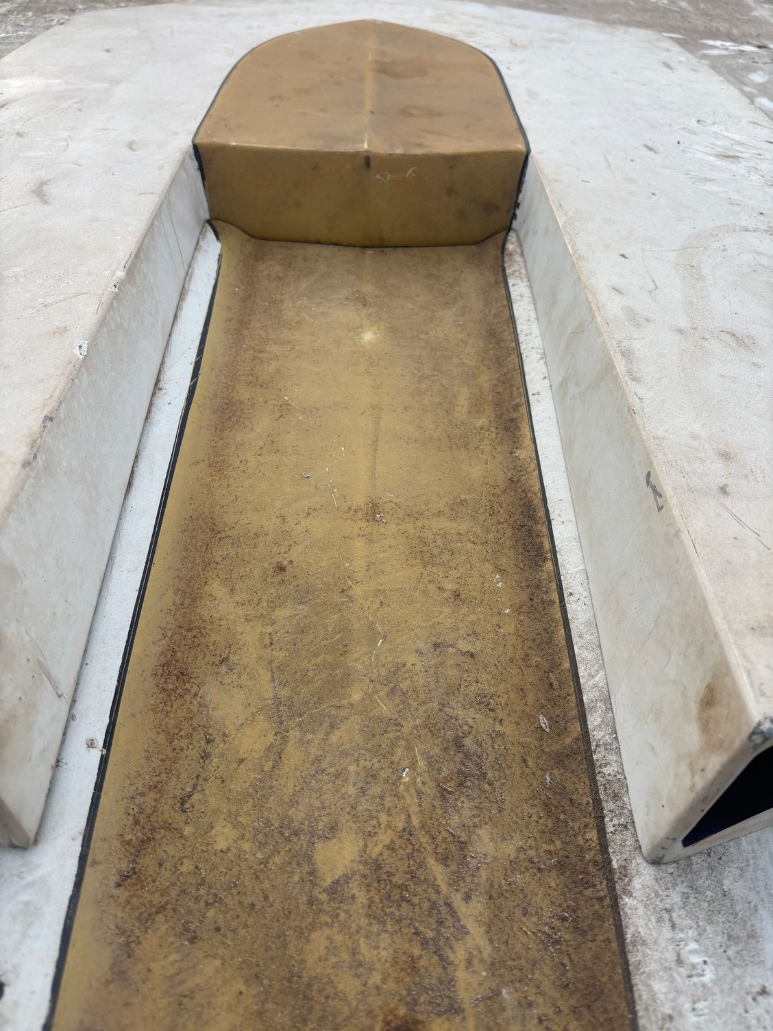

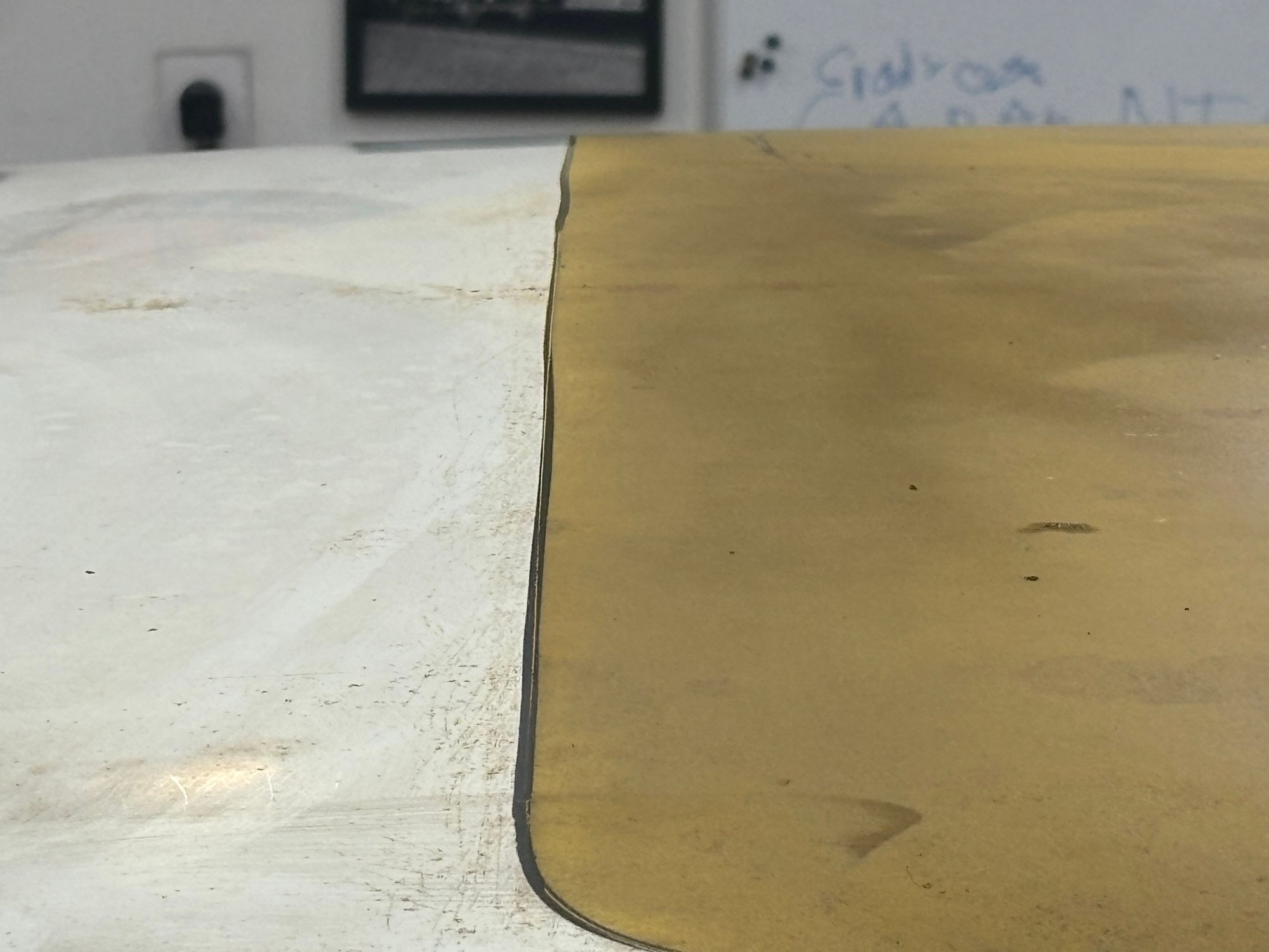

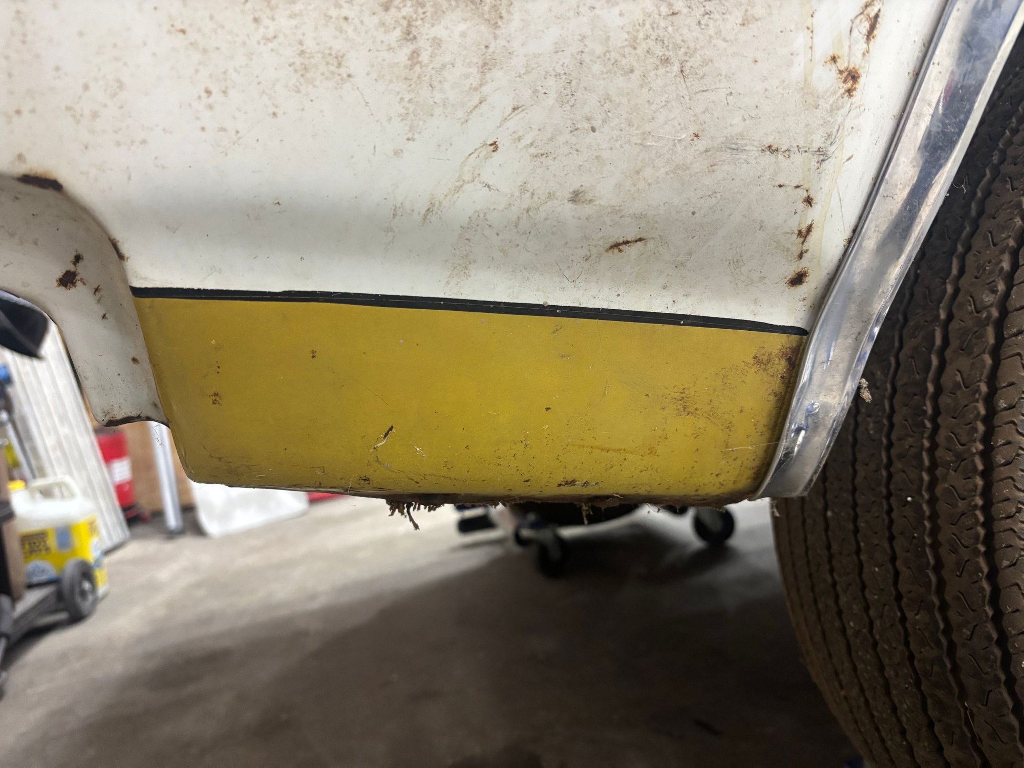

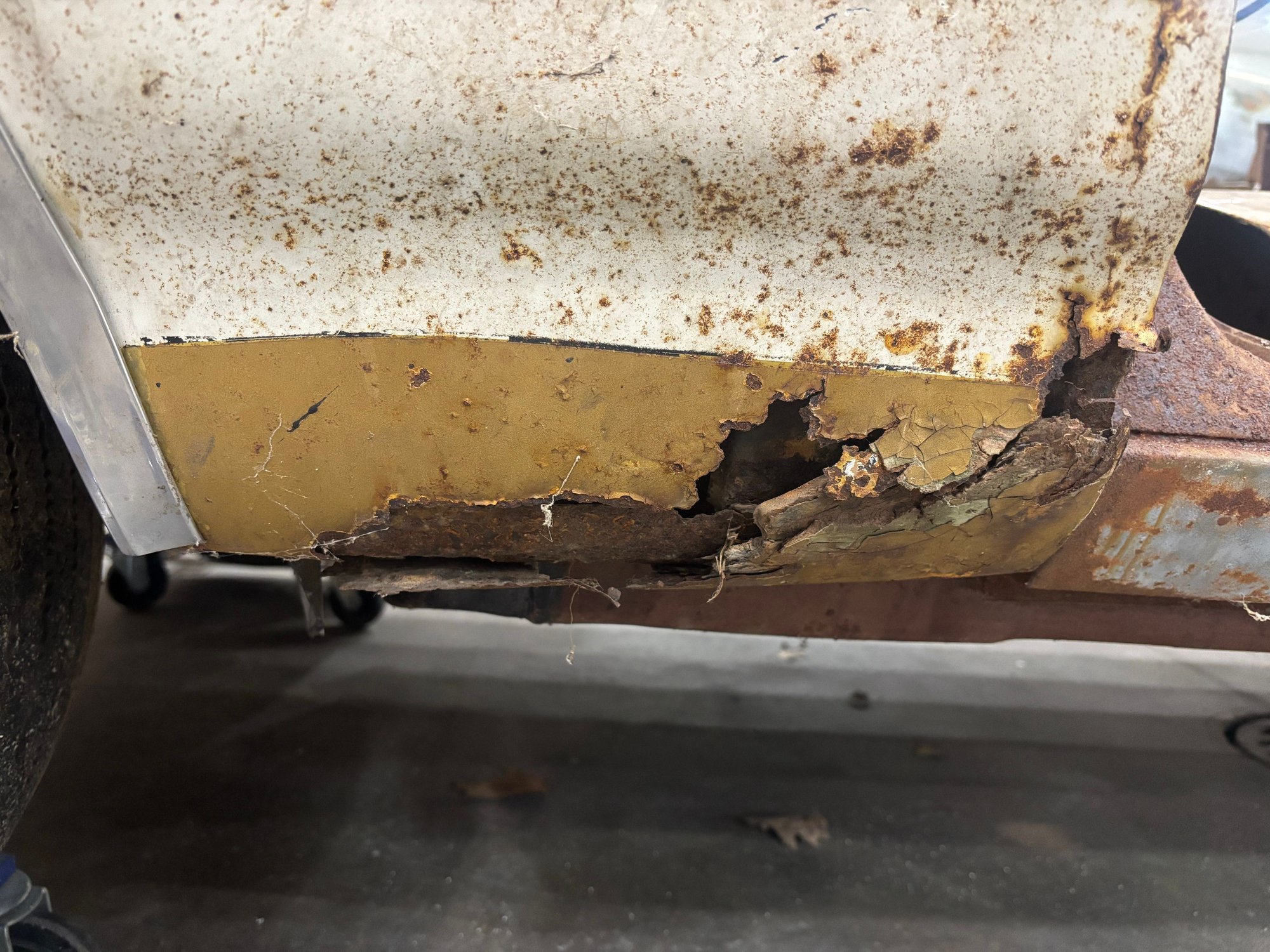

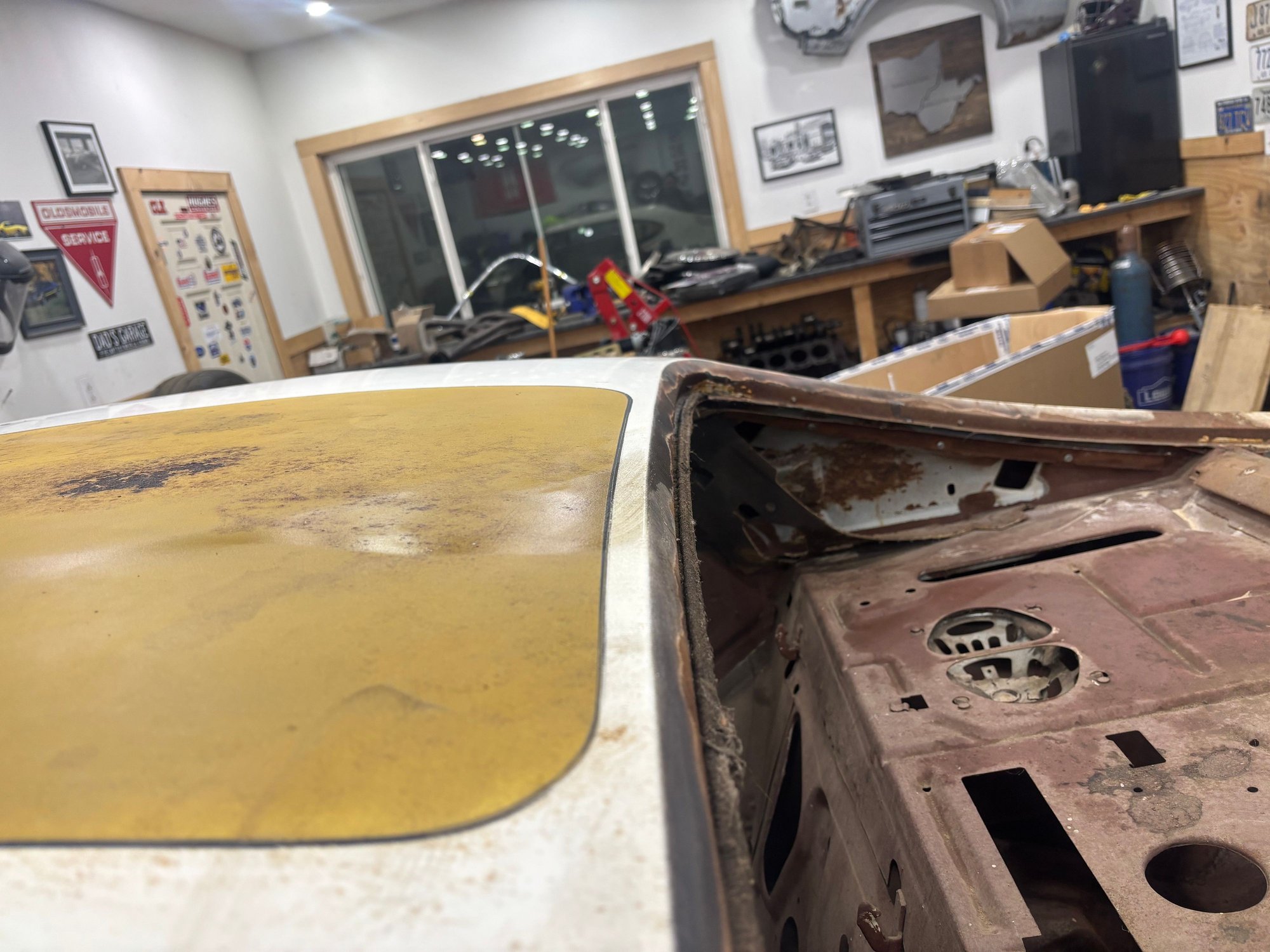

Tonight I started measuring and documenting the stripes on this car. Im gonna try to use some wax paper to make templates. Here’s a couple pics. The guy who pin stripped this was in a hurry

Templates are a good idea, however, they'll only match to YOUR car, really. I know that's what you want it to do, but every time someone asks me for dimensions, it's always a caveat that they were measurements from MY car. They just taped them up on the fly, and "close" was the name of the game back then. When I measured the top fender stripes on mine one side was 2" and the other was 1-7/8". Some bottom stripes between the wheel wells were more straight across and a tad lower on the door as others were a bit more up the door and bent down a bit on the ends to follow the body break lines. Each car was unique.
Look forward to the progress!

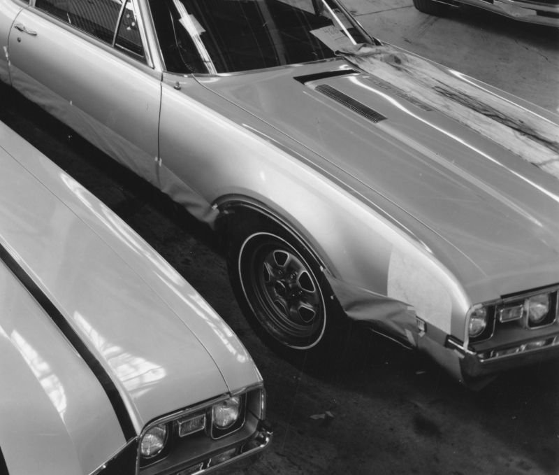

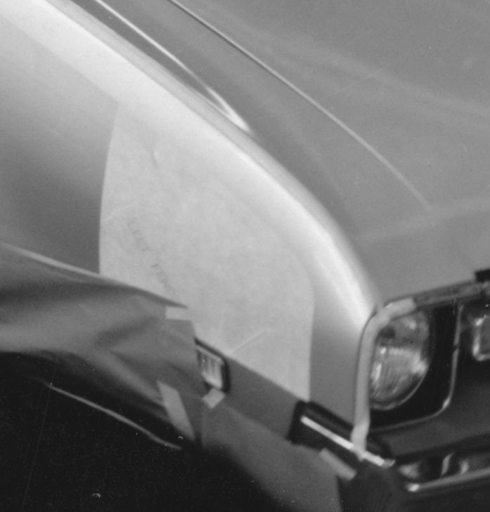

Albeit these are 1968 H/O pic's, I was told Demmer used templates for paint on 68's and 69's.
I don't have good info on all the portions where the templates were used, but I'm sure they were fairly consistent in their job.
First pic below you can see an applied left front fender corner template, close up on the pic you can see 'Left Fender' printed on it.
Third pic it looks like they are using that front fender template to base the remaining upper stripe off of.
Close Up.
Drivers side....
Full picture....

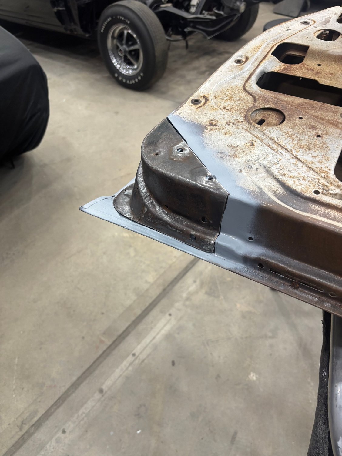

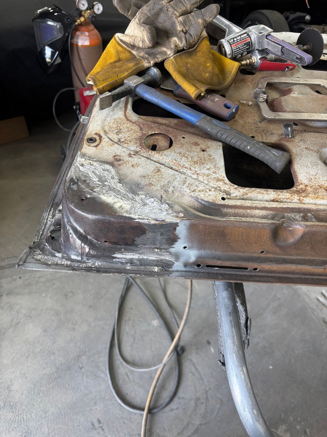

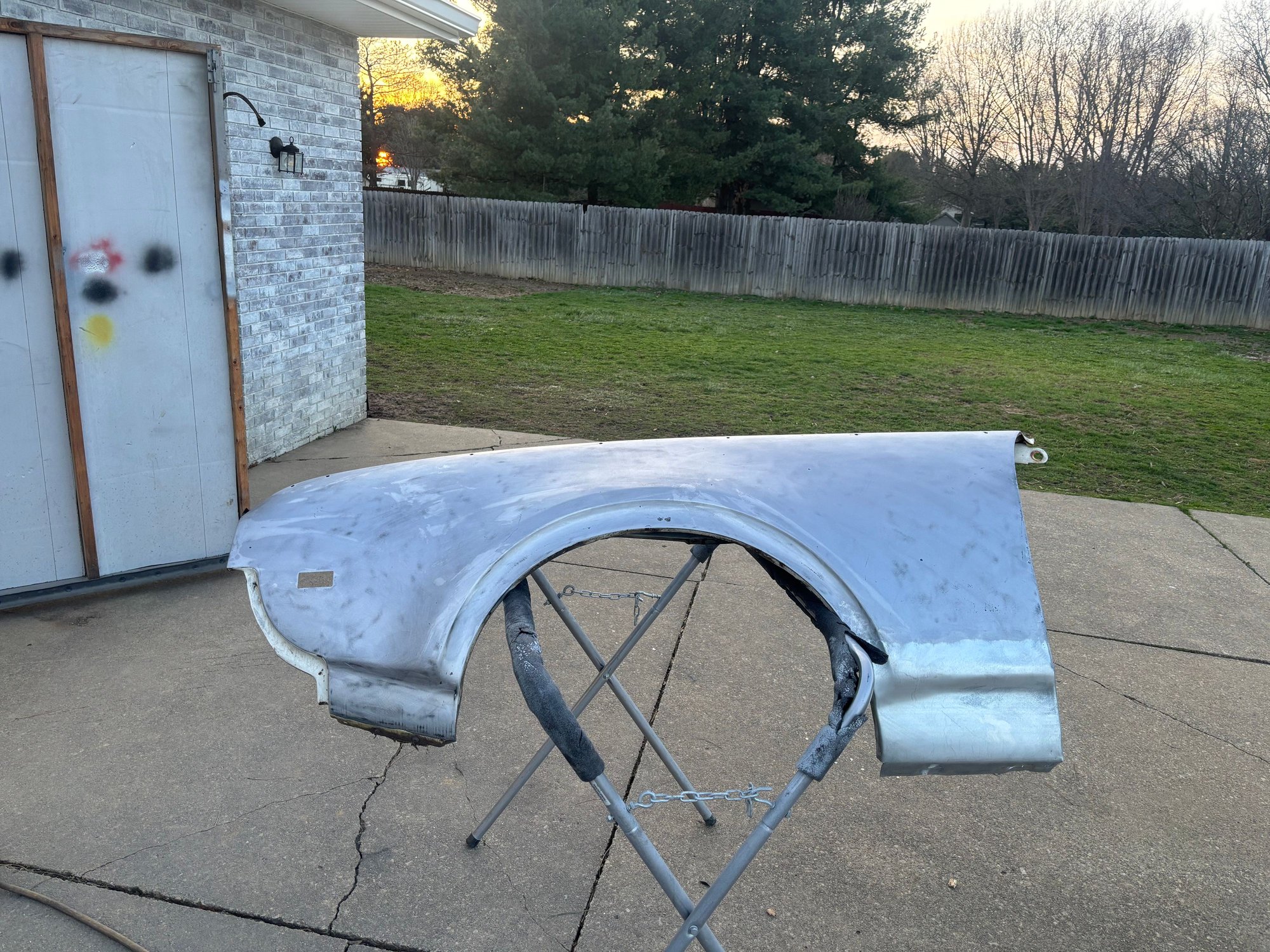

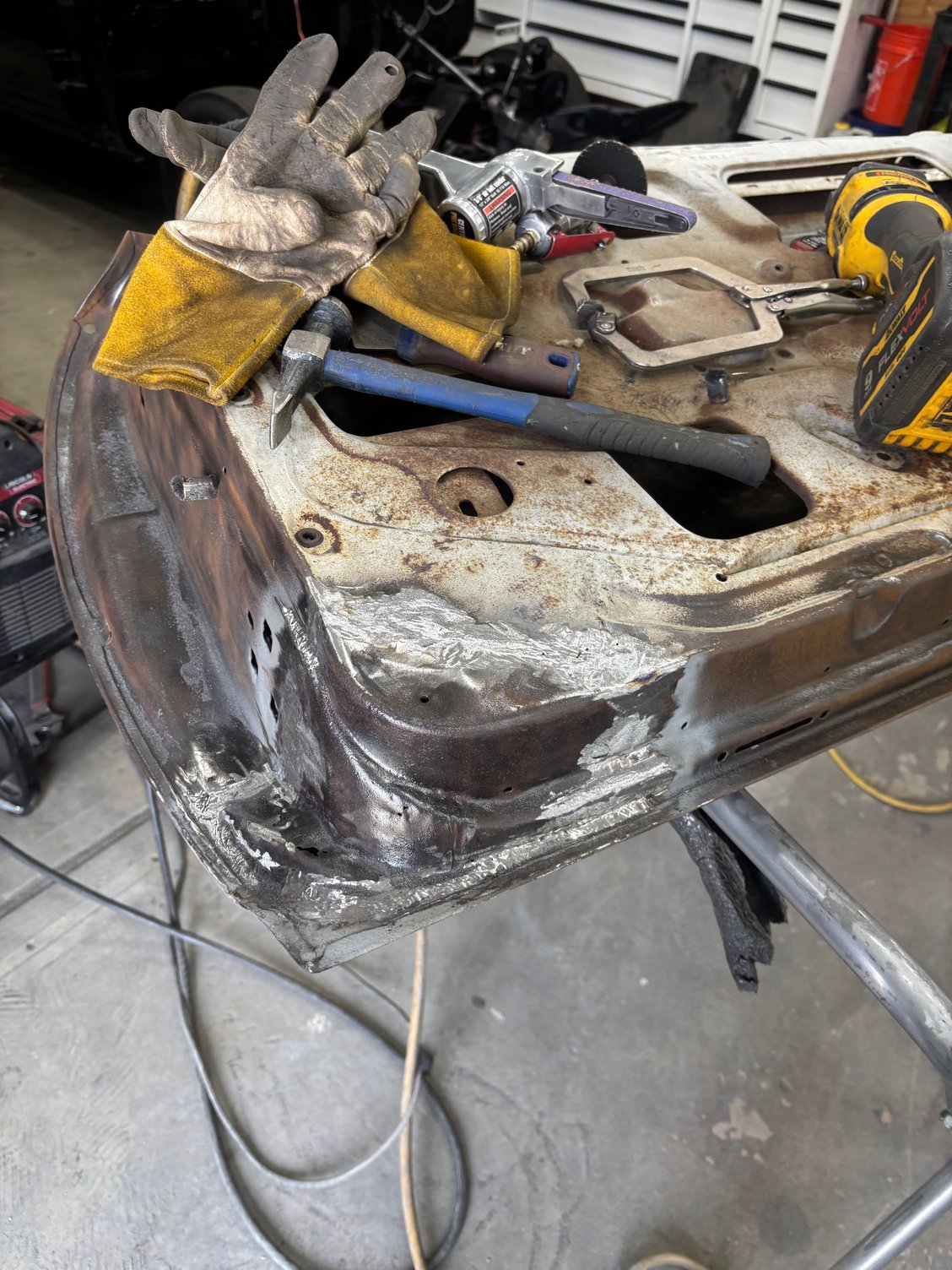

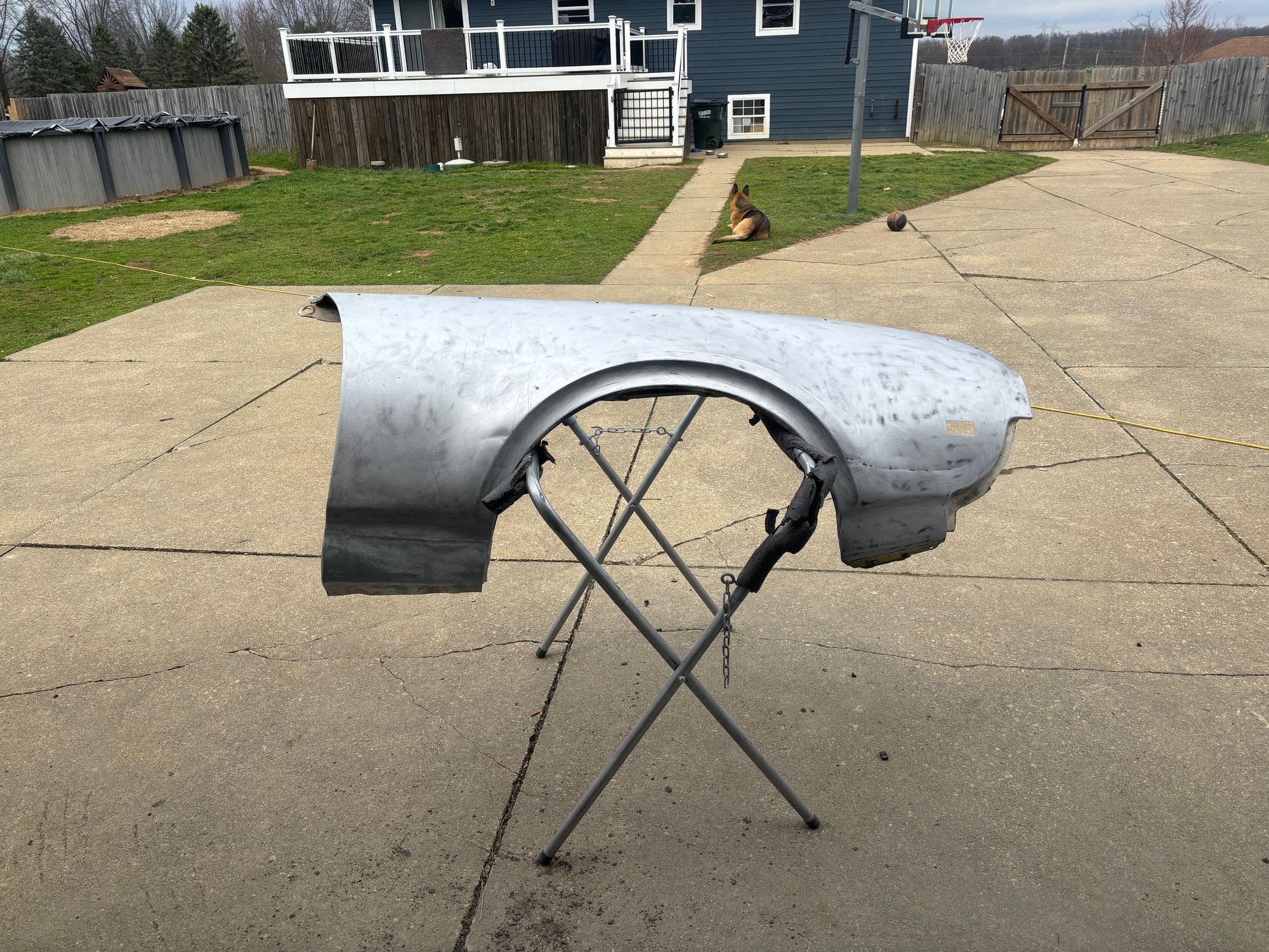

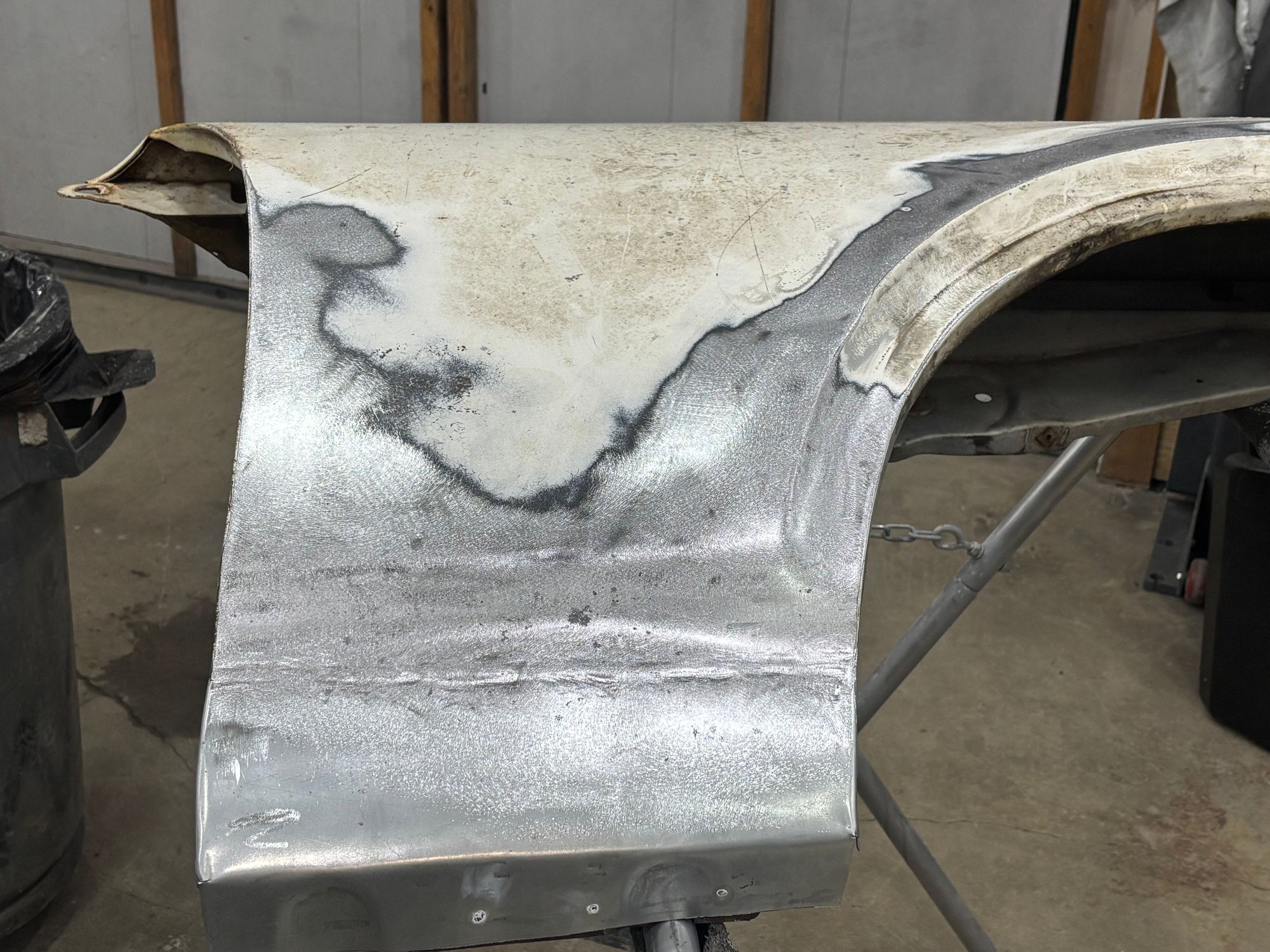

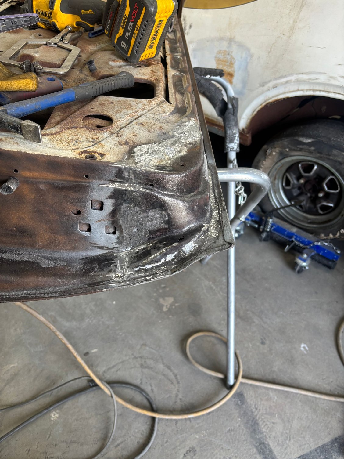

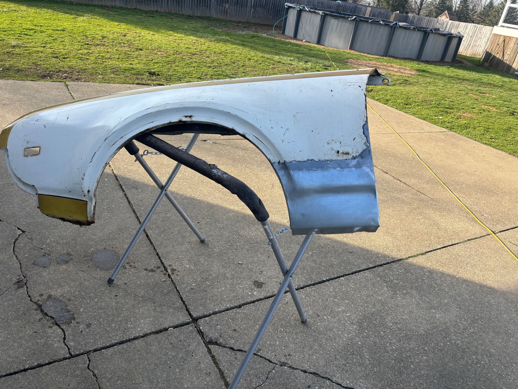

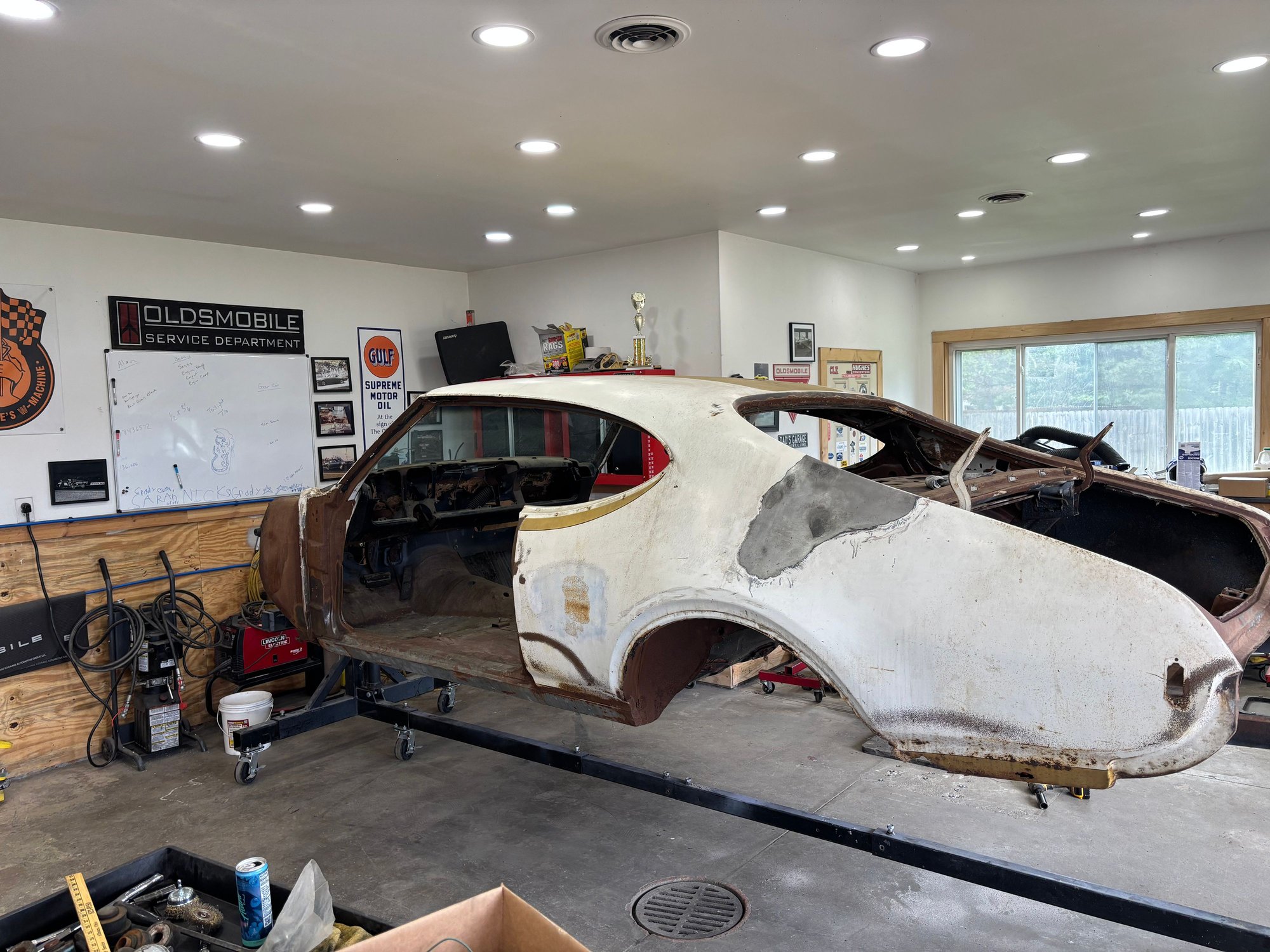

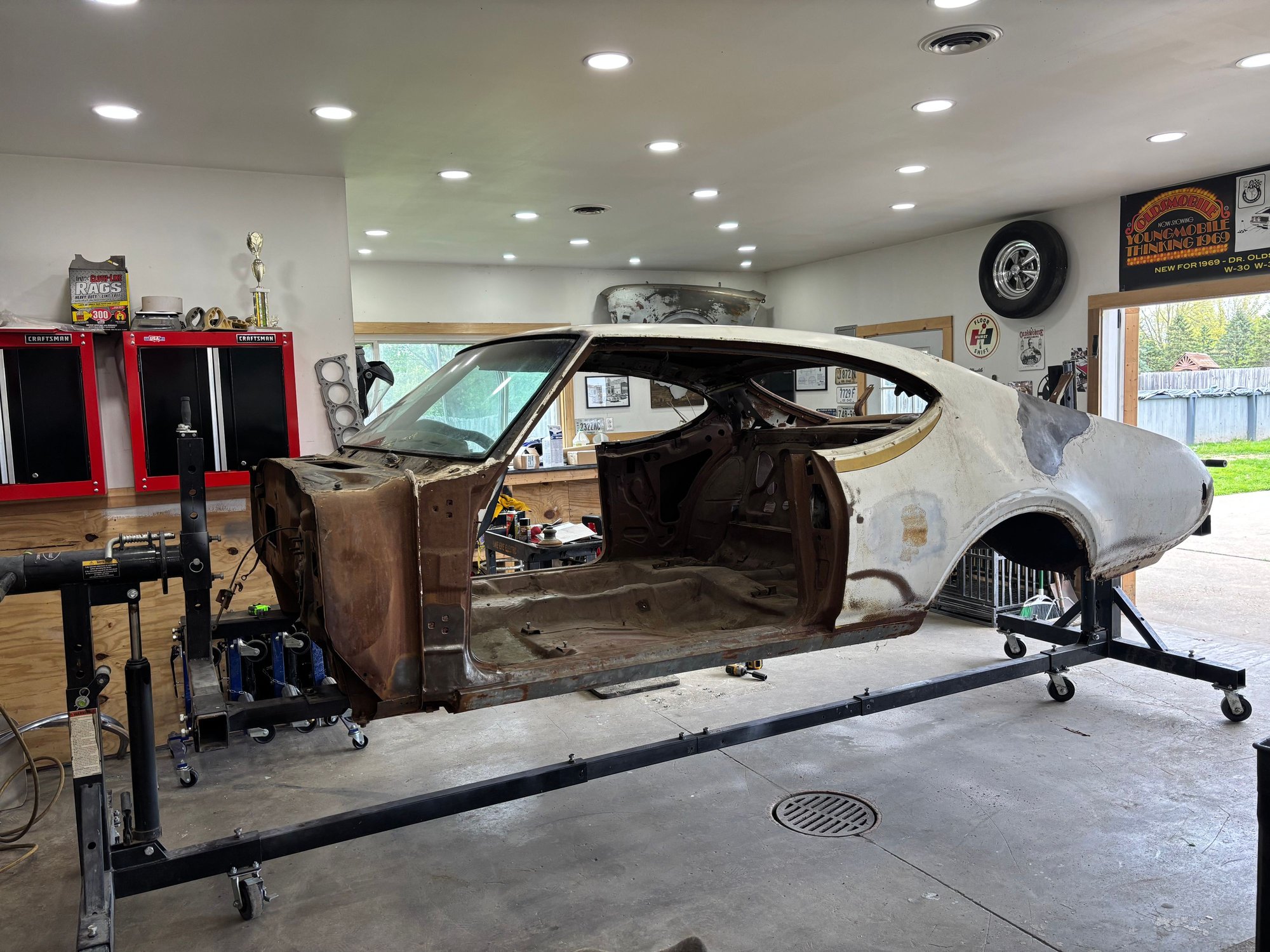

So I got both fenders patched and stripped to bare metal. I have a few little dents to dolly out but Im gonna wait till I get the doors patched and stripped. That way I can epoxy doors and fenders together and then put the body on the rotisserie.

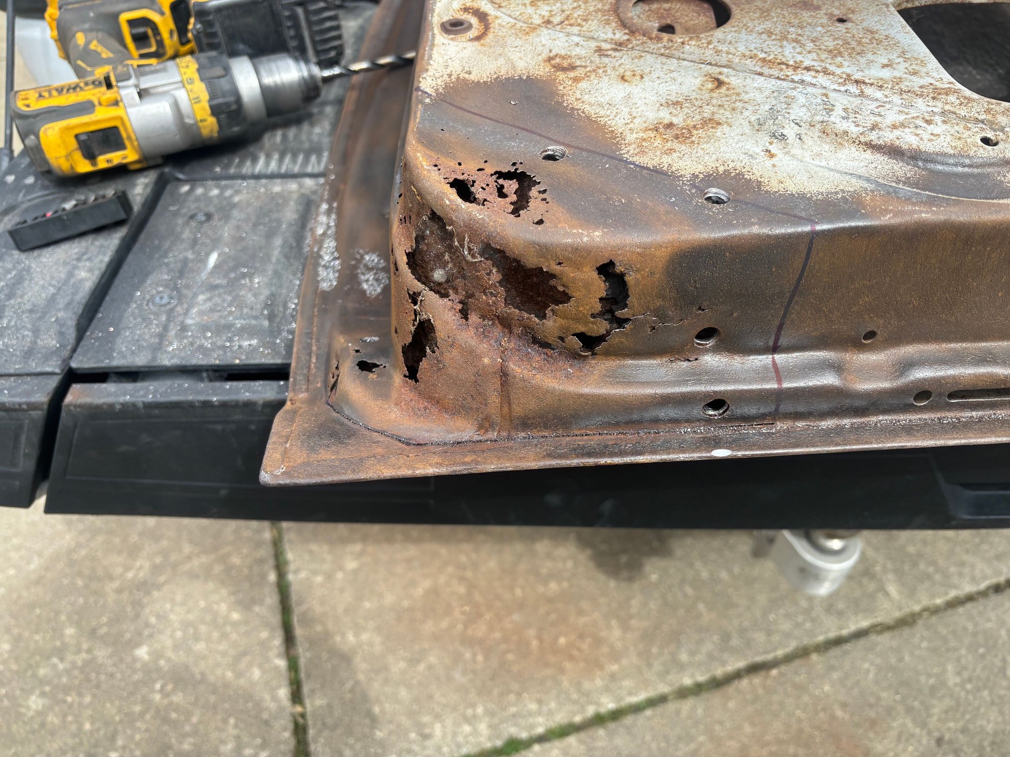

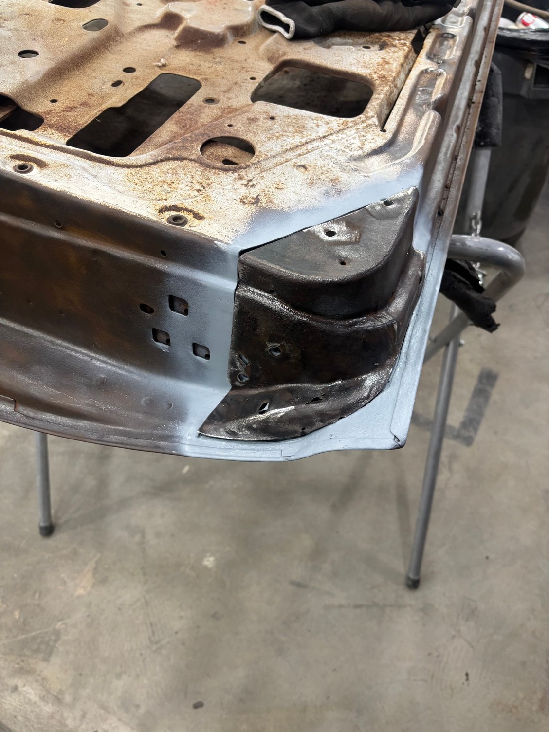

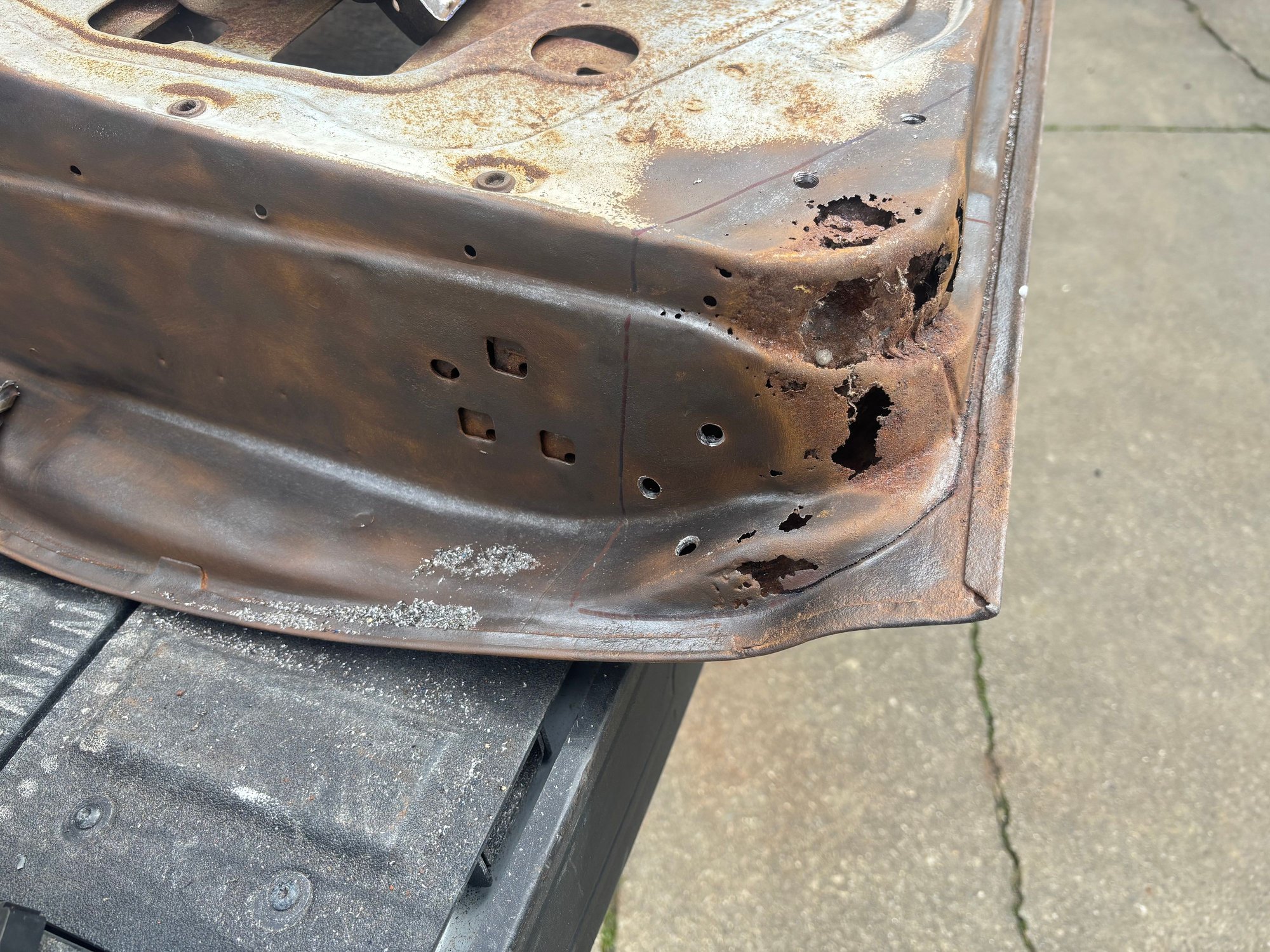

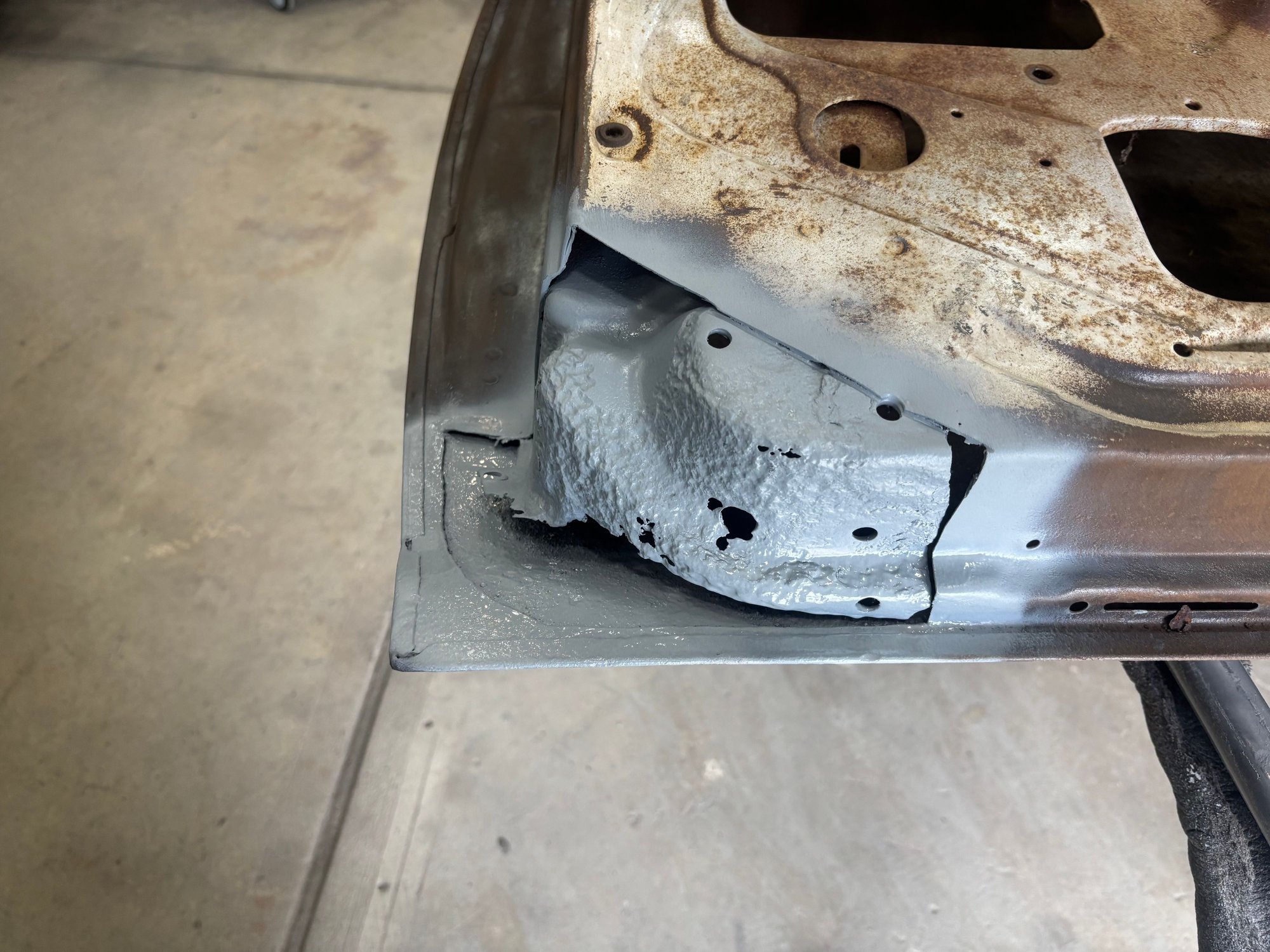

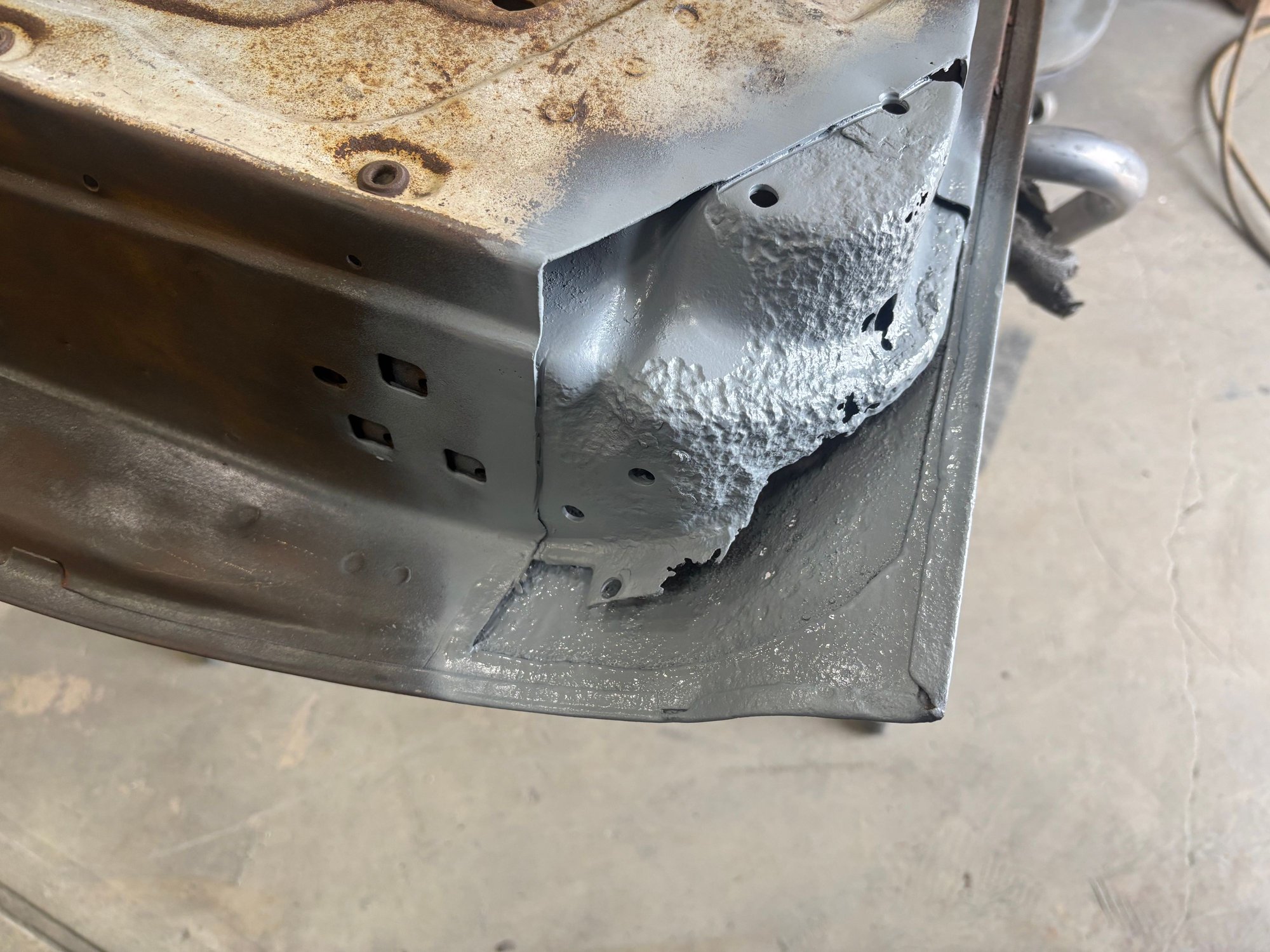

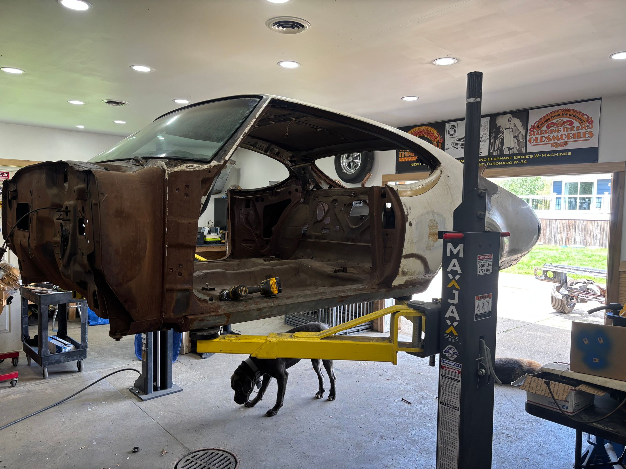

Passenger and driver doors are sanded to bare metal, patched hole on passenger door tomorrow I’ll patch the driver door. Both doors rotted on the inside part of the door and nothing on the door skin. I thought that was kinda weird. Im shooting to have this baby on the rotisserie next week

Those inside door patches are thankless. You spend so much time cutting, trimming, welding and after the resto is done...
no one comments on them and you barely remember having done them.
But it's part of the process.
