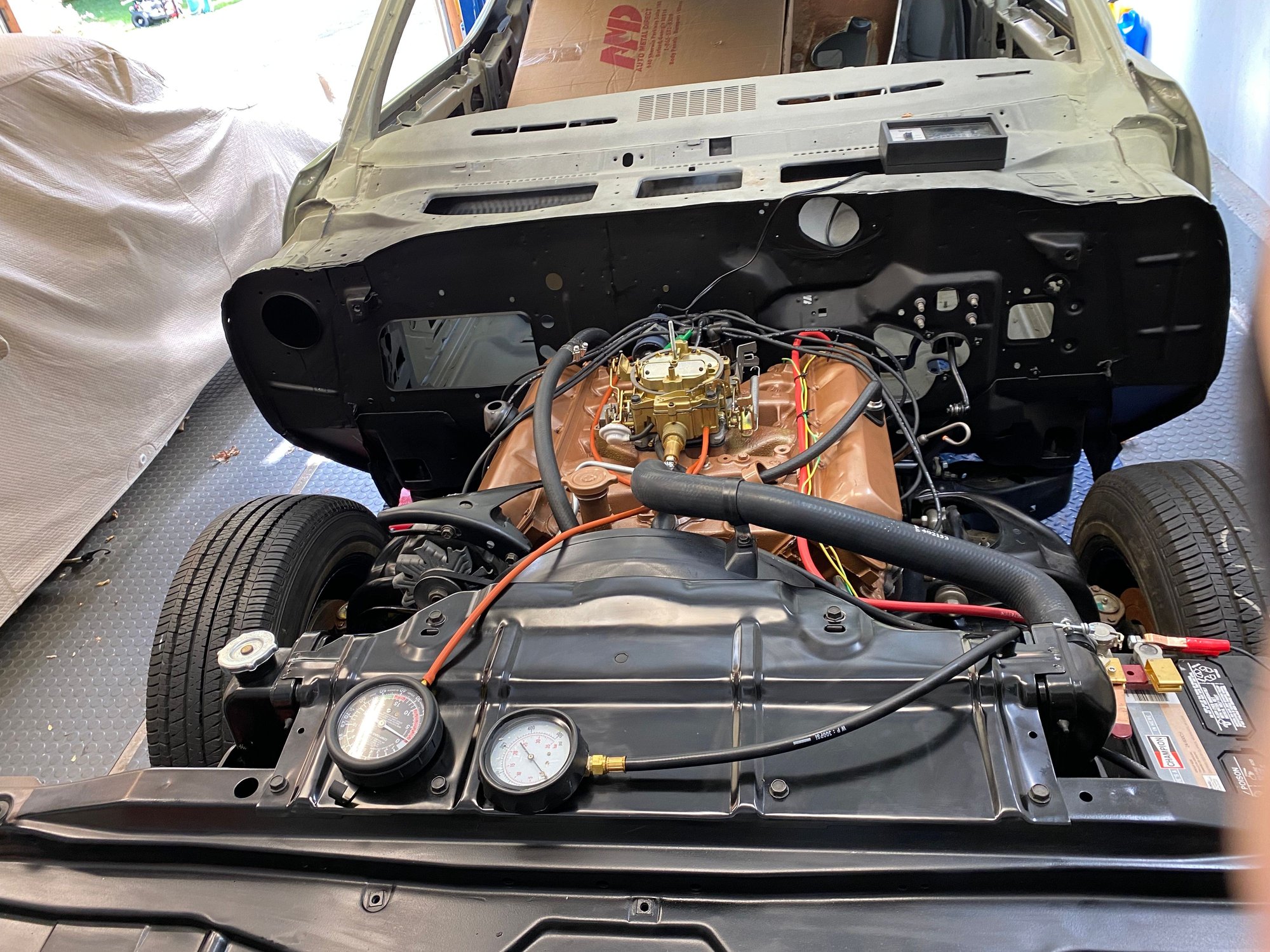

I can’t believe it’s been 9 years since my first post on my 69 442 restoration. I’ve made some progress but is slow going.
-Working with Brian Trick I rebuilt the original 3.42 posi rear end. Had the rear end and suspension parts powder coated and replaced all the bushings.
-Replaced the frame mounted front to rear brake and fuel lines.
-I had the body blasted, all rust spots repaired and sealed. Put it back on the frame with new body mounts.
-Next step was to have the numbers matching 400 rebuilt. Basically took 2 years to get it right. I had the engine rebuilt using original C heads, exhaust manifolds, and original intake and original carb and distributor rebuilt by Everyday Performance. Pistons are .30 over with a 9.5 to 1 compression ratio. Shop installed a Comp 42.600.J cam, AKA a Thumper. They told me I would love it, I hated it. I didn’t like the Idle or the sound and I wouldn’t be able to run power brakes. I spent a summer trying to get the quadrajet to tune with the lumpy idle.
-I decided I was spending too much time and money on this project to end up being unhappy with the cam so I bit the bullet and changed the cam. I got a cam recommendation from Mark (cutlessefi) to give me a “stock 442” idle and sound with some improvement over stock at higher RPM’s that would support vacuum assist power brakes. Comp Cam 42-221-4. This car will be a driver, I don't plan to race it, I just want to have a little fun driving it. I got the engine back in car with the new cam and I’m very happy with it so far.

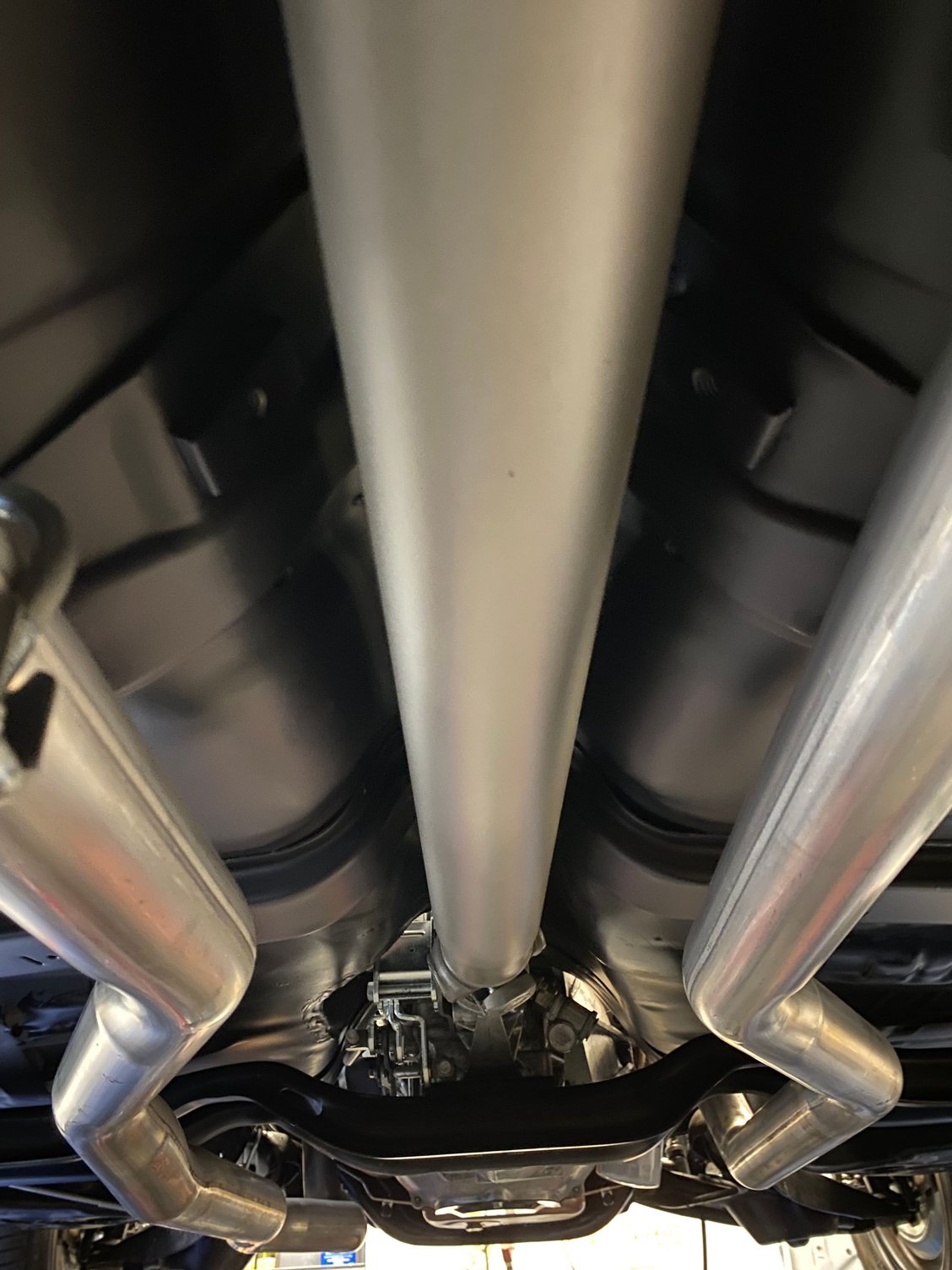

-Installed a Grardner exhaust.

Here's the sound I was looking for
I attached a video of the engine and new cam.

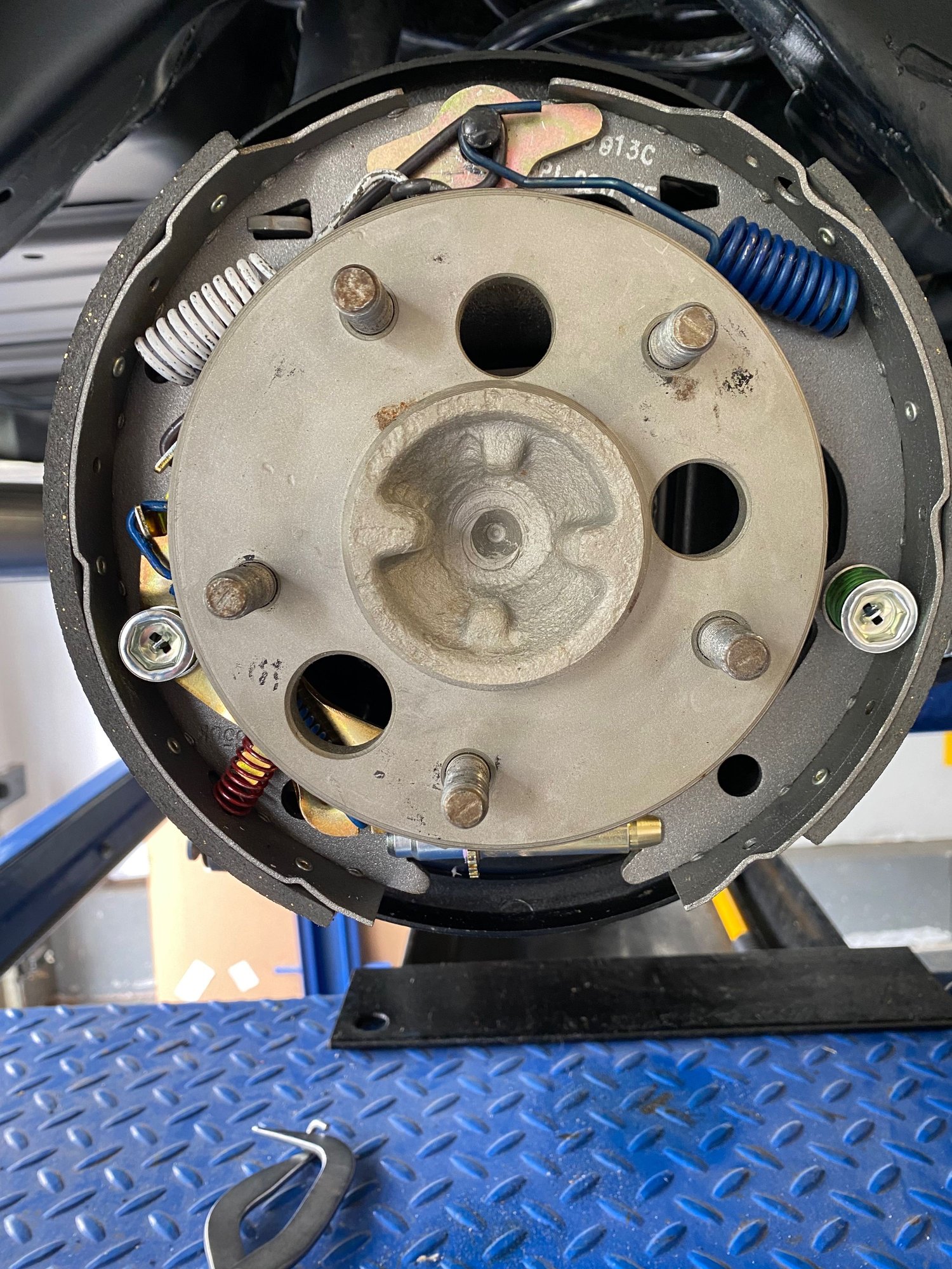

Making progress rear brakes done

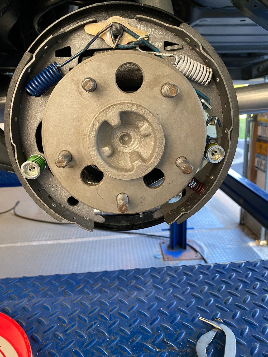

I installed the rear brakes. I used this video from Inline Tube. Its the best video I could find for someone doing it with all new parts.
I bought the parts from RockAuto. They are all Raybestos except the screws to attach the wheel cylinders and the parking brake rods which I got from Inline. Here are som photos of finished work.

Loos like the shoes are on backwards on the left side. The shoe with the shorter friction material goes on the front.

Crap, I guess I wasn't paying close enough attention! . Oh well, my next job will be to fix that. Thanks for the heads up

Fixed. Thanks again for the heads up. One of the best parts of this site is having a set of inspectors check your work. Now on to the front disc brakes.

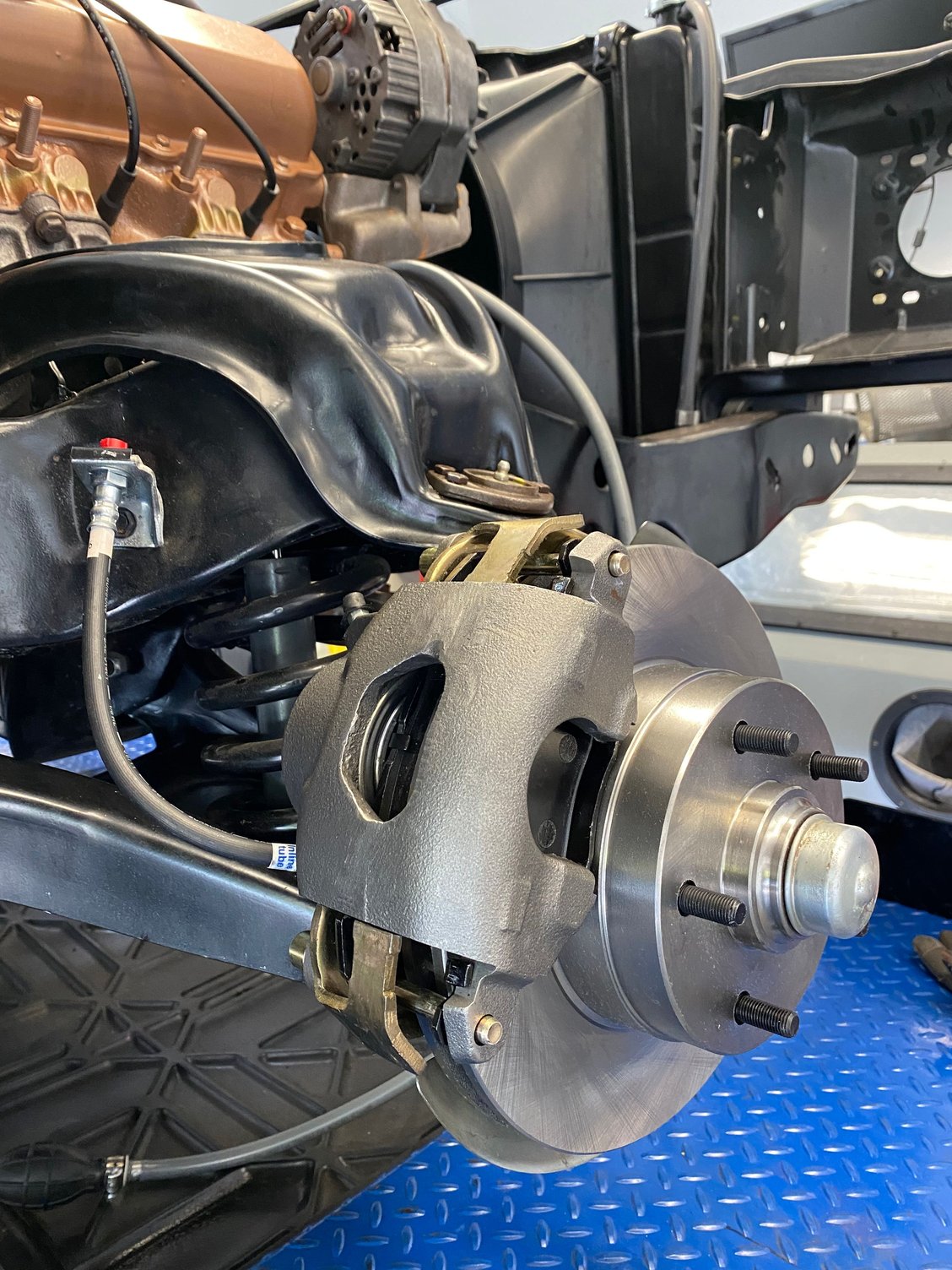

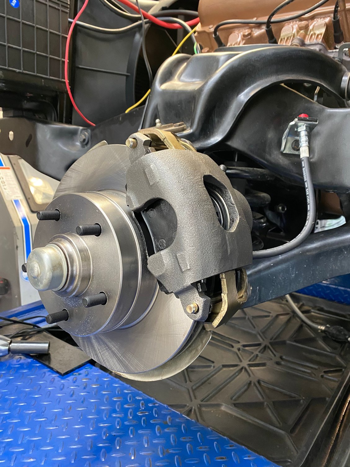

Old Apr 24, 2023 | 11:06 AM
442operator's Avatar
Posts: 68
From: Long Island, NY

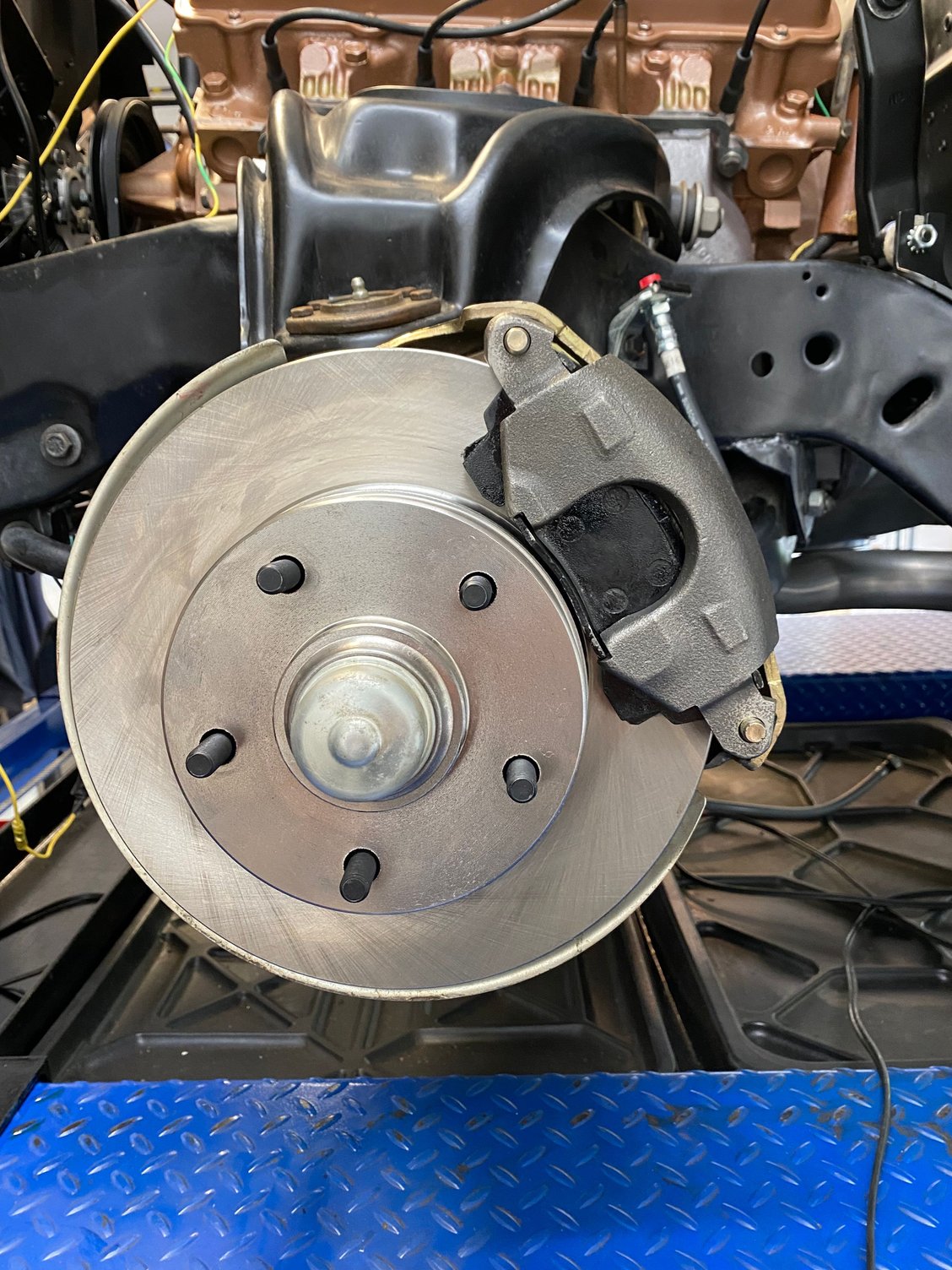

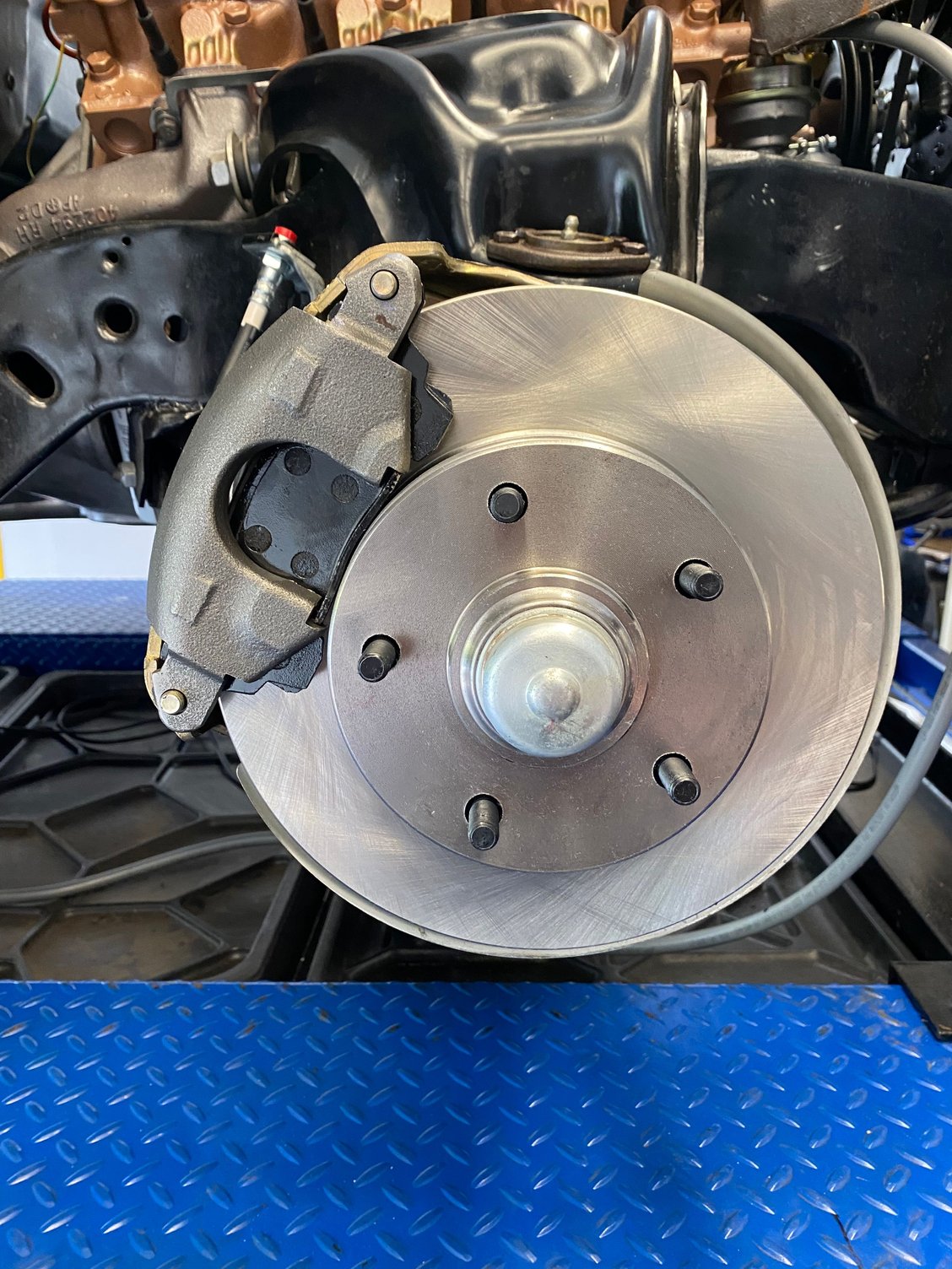

Front disk brakes installed. Now on to booster and master cylinder.

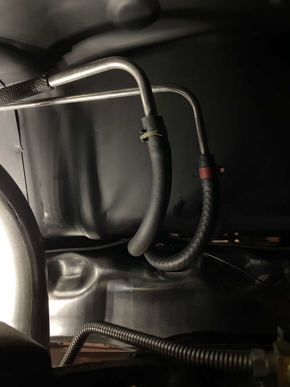

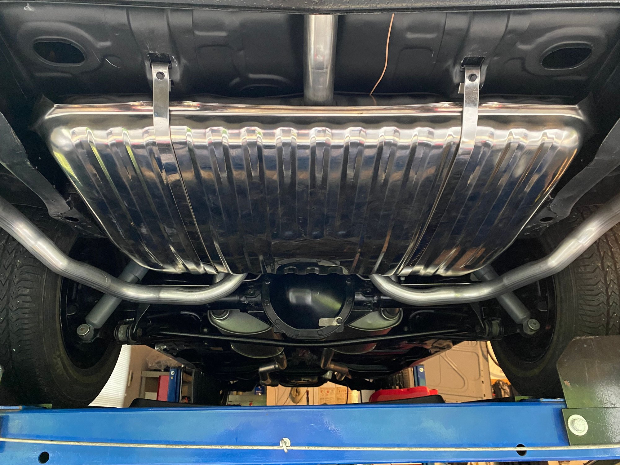

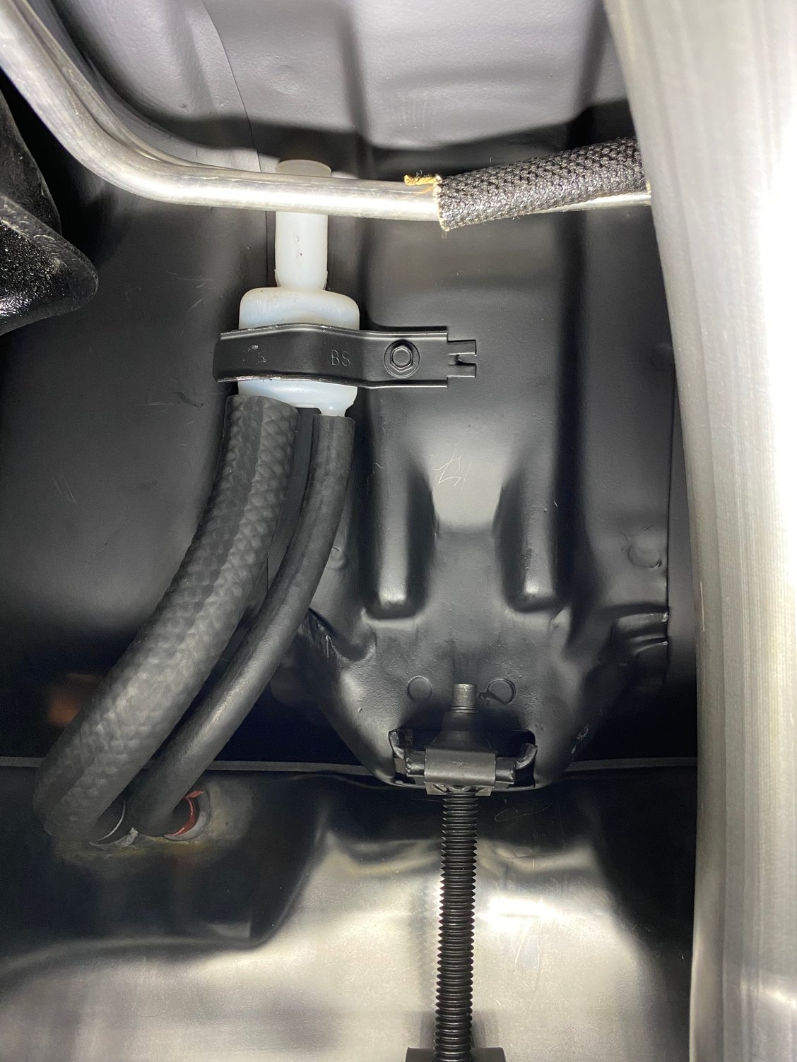

Installed fuel tank
I installed the new fuel tank. I ended up getting a stainless steel tank on sale to go with the stainless steel fuel lines I installed a while ago. A couple of notes:
-I attached all the hoses to the tank before I installed it.
-The flanges on the original tank were bent up to clear the frame rails. The new tank came with the flange stinking straight out. I had to use vise grip pliers to bend it up. It doesn't look as neat as the original.
-The stainless steel straps come flat with just the rear hooks bent in. I copied the original straps and bent hem in a vise to fit. The stainless steel is very stiff so you have to get this right. You can't bend them around the tank as you install.
-Way easier with 2 people and a lift! As I've read in other posts, doing it under the car on the ground is challenging.
I'm not sure I'd do a stainless tank if I had to do it again, but its in and it looks great. For the first time I ran the rebuilt engine off a real gas tank. One more step complete towards moving on its own power.

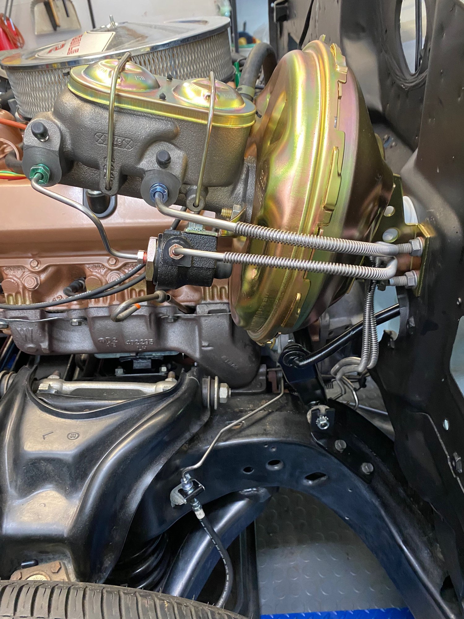

Old Jun 17, 2023 | 01:52 PM
Posts: 68

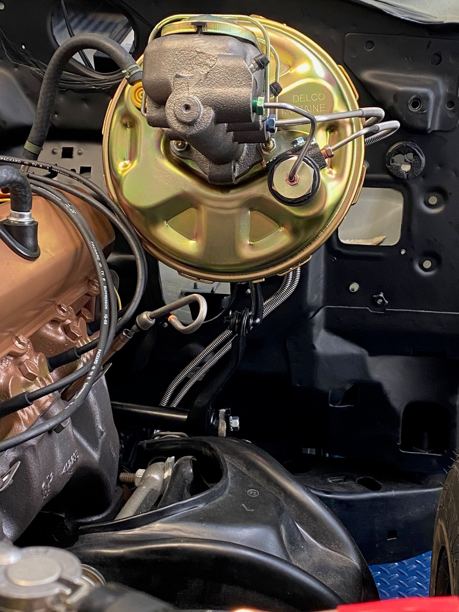

Brakes are done.
Finished installing the master cylinder and plumbing. Bled the brakes using a vacuum bleeder (continuous kind that hooks up to the compressor) and an auto brake fluid feeder ( the kind that clamps on to the master cylinder and feeds fluid as is drops). That made it a solo operation and very neat, no spills filling the master cylinder. I highly recommend this approach. I only had one small connection leak at the left caliper banjo connection. Tightened it up, all good, solid pedal. Of course i won't know if everything is all good until i drive the car but all done for now. On to the installing the power steering!

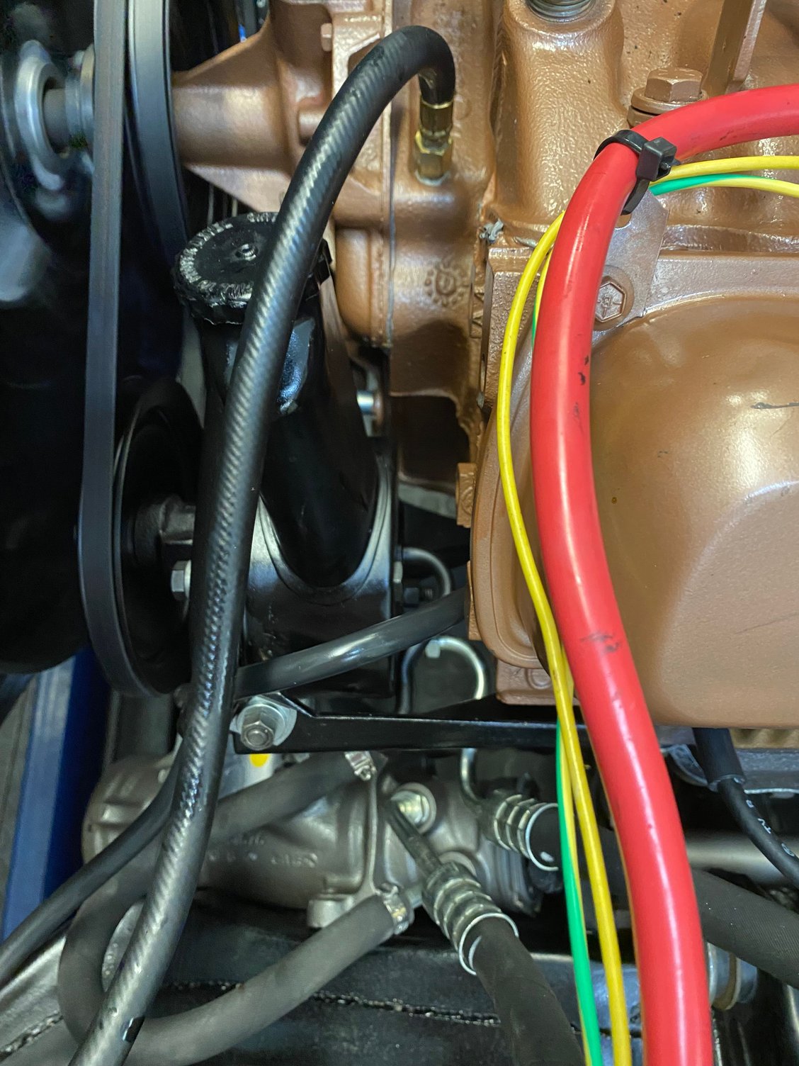

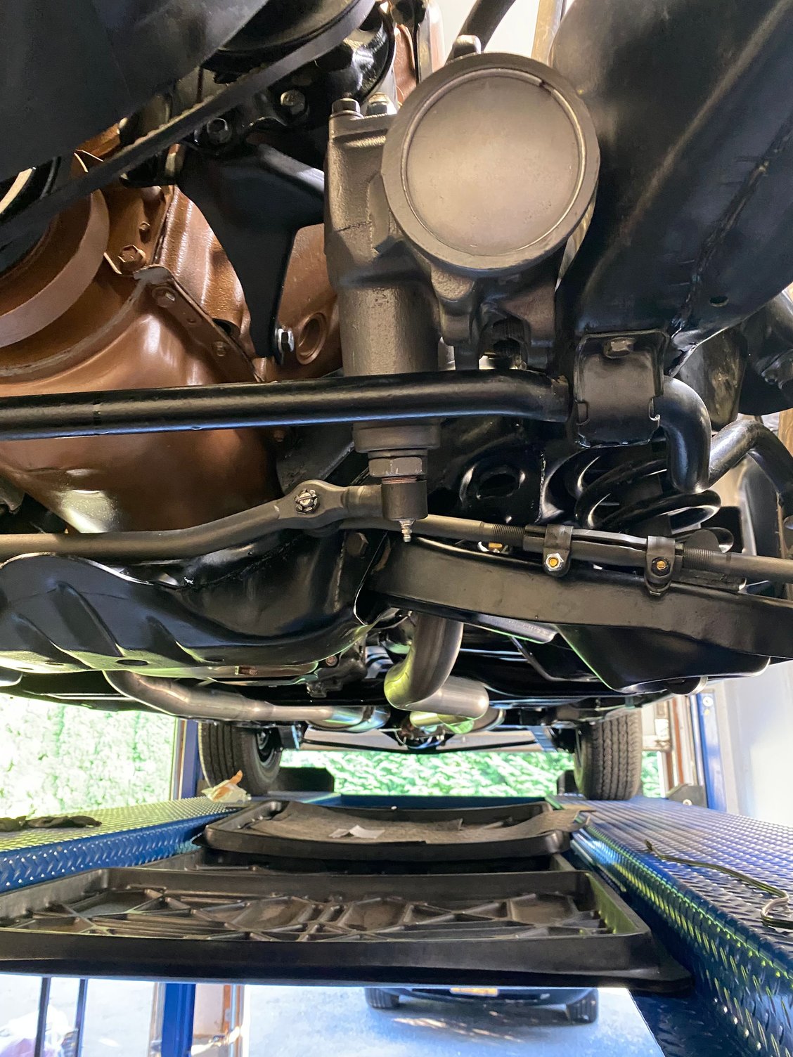

Ready for test drive.

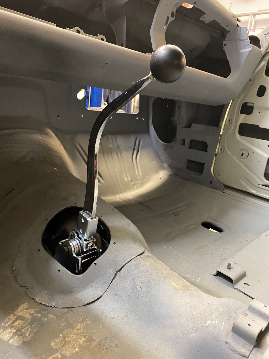

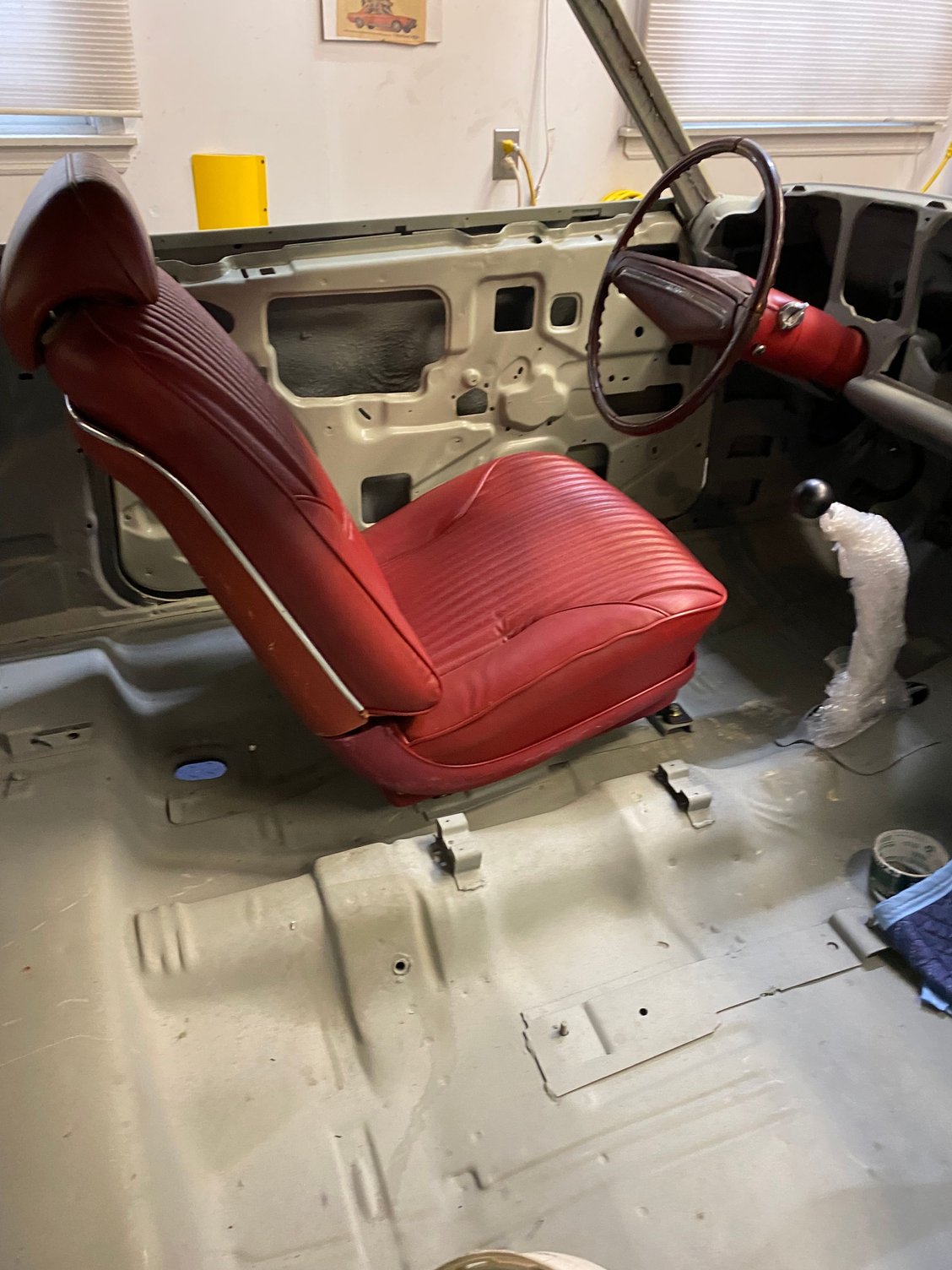

I finished the installation of power steering. Pretty straight forward installation. Also installed the steering column, shifter and drive shaft. I'm ready for test drive off lift and once around the court.

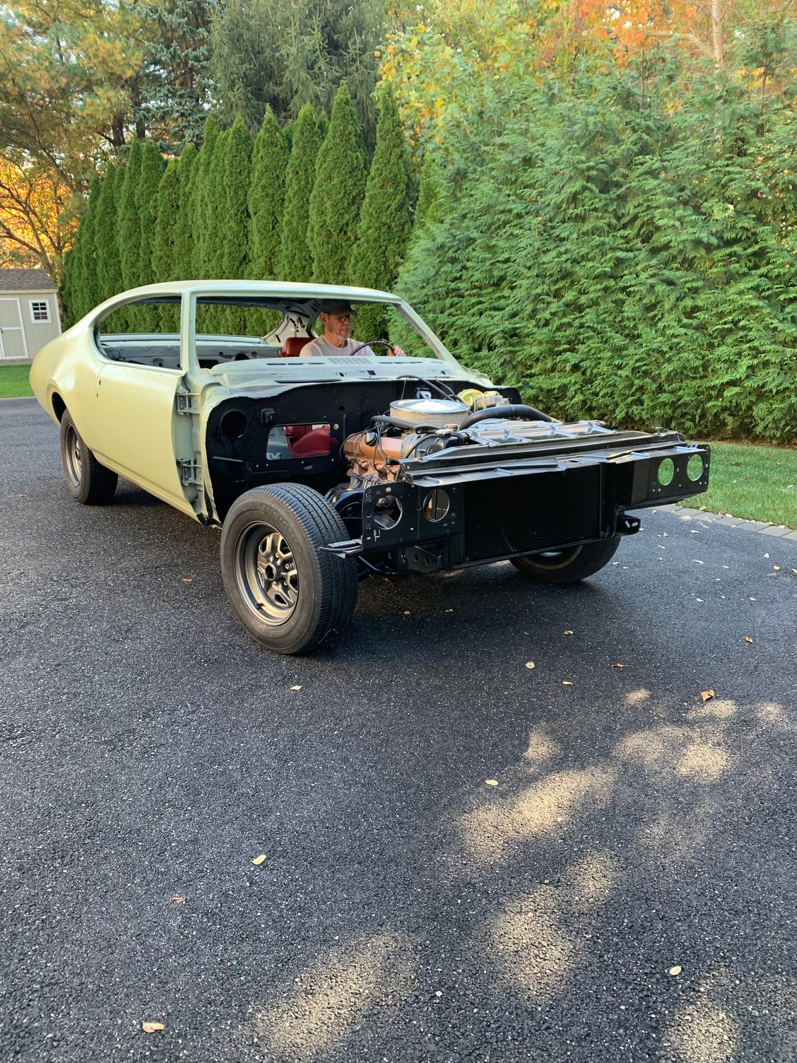

Successful test run

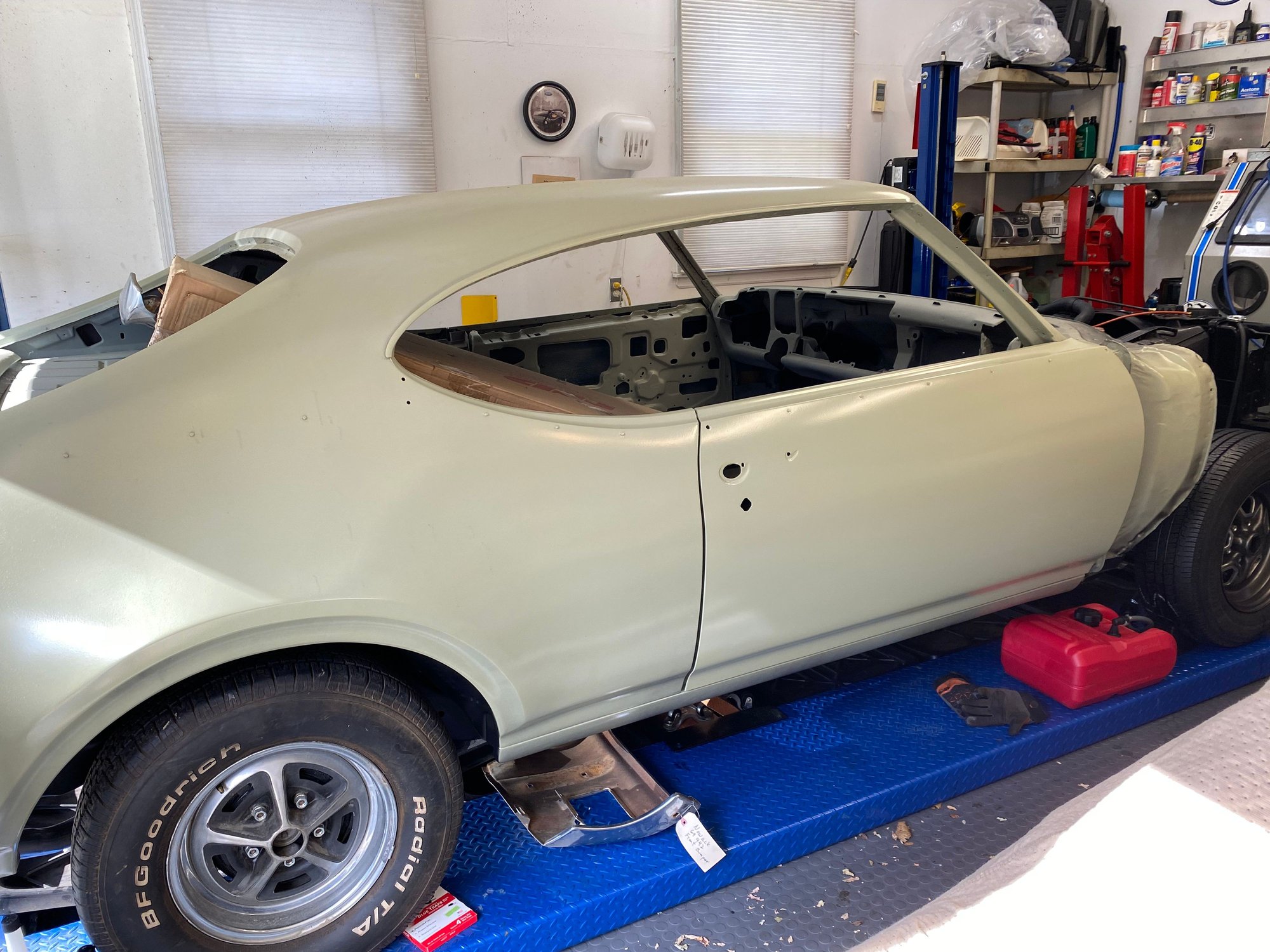

My goal for this build season was to be able to back my 69 442 off the lift and drive down my driveway circle my court and go back up. The test was successful! This is the first time the car has moved under its own power in over 10 years. The next steps are to get it ready for paint. which means getting as much as I can get done in the engine compartment before paint and attaching the fenders and hood. I'm going to try to collect and restore all of the parts to do this over the winter. Here's a photo and video of the test. As you'll hear from my buddies, I decided not to "sign my street" on this go around!
