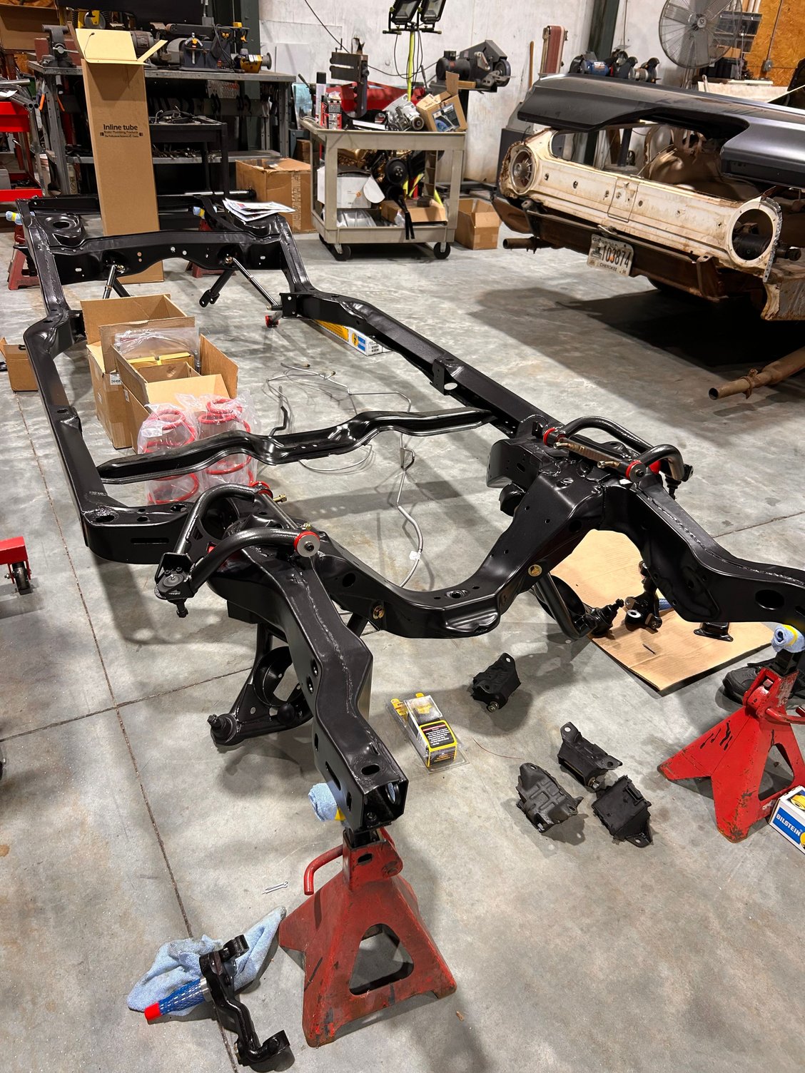

Chassis is going back together after coming back from powdercoat and curing for a few months. Don’t want to rush these things you know?🤣

Slow progress is still progress…
Engine and trans are back in the chassis.(forgot to take a pic after the trans went in). Suspension and brakes going on, rear end going together.
