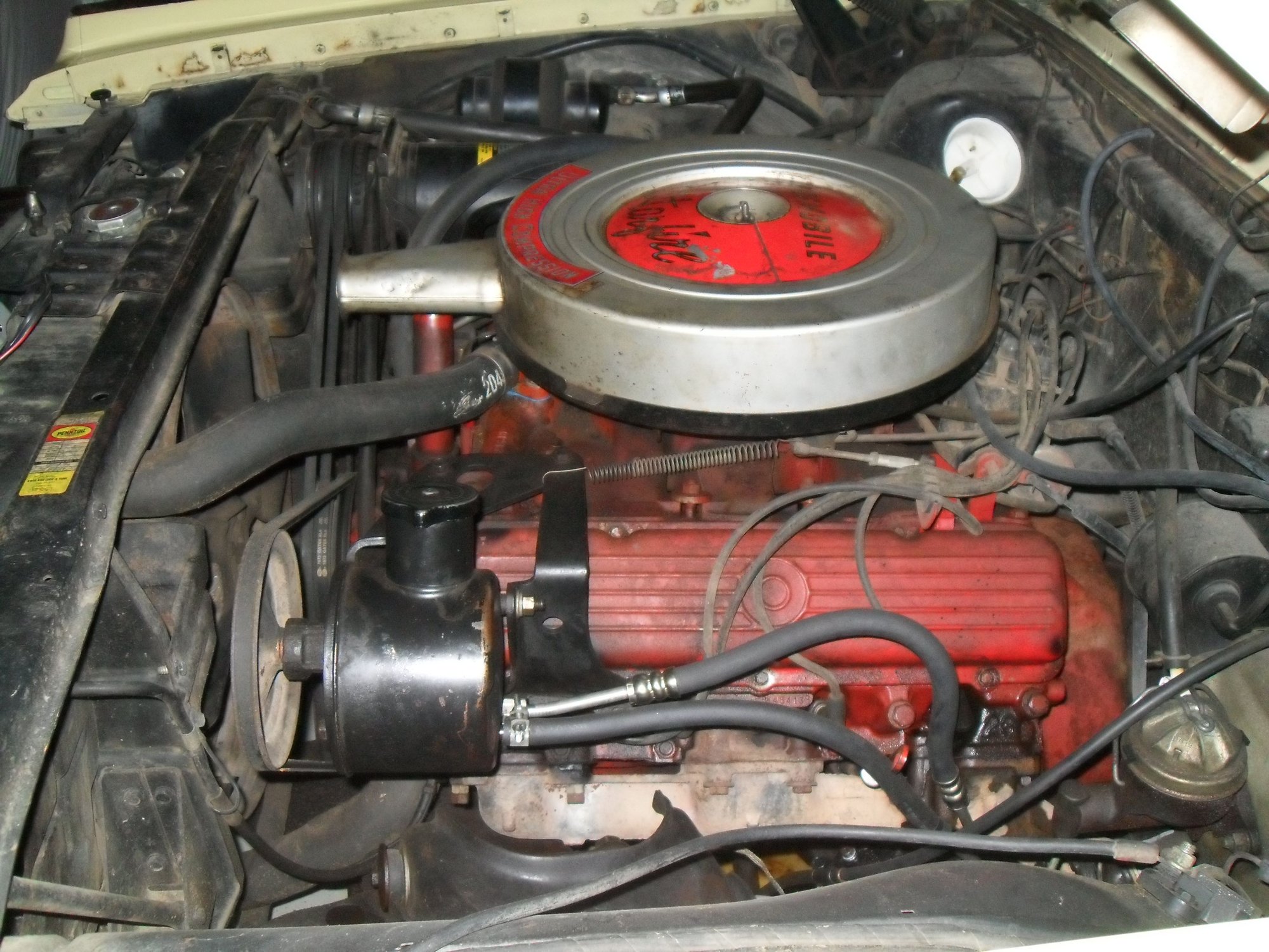

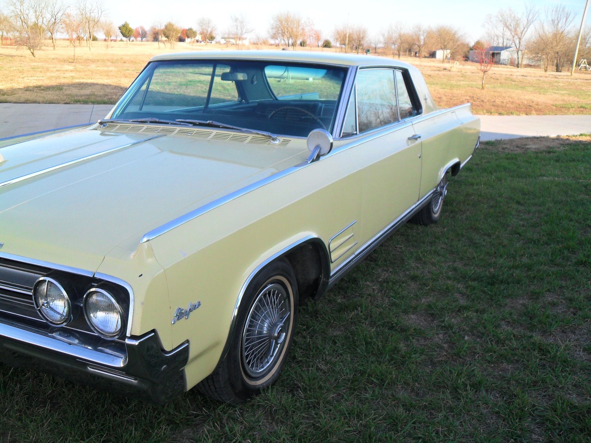

I had a 1964 strfire
Thanks for the advice, I still would like to do it. My 64 I bought from the original owner it was still in pristine shape I loved to take it cruising, for a big boat that 394 easily powered it right down the road. Good luck on your starfire
Old Aug 1, 2020 | 05:22 AM
oldsmoboogie's Avatar
Joined: Mar 2012
Posts: 754
From: Quad cities Illinois
Wow, that sir is a beautiful car!
Old Aug 1, 2020 | 06:31 AM
mr442joe's Avatar
Joined: May 2010
Posts: 36
Yes it is, my neighbor growing up bought it new and I remember him taking meticulous care of it, I grew up and moved away, my dad calls me one day and says he has a for sale sign on it. I told him to go tell him I'll take it. well the brake line going to the front passenger wheel had rubbed a hole and it was too much for him to fix. I bought it and enjoyed it several years and never did anything but oil and maintenance. I sold it to a guy in springfield , mo he was a car sniffer for a car dealership. I seen it on a online ad, looks like they freshened up the paint/ it must of been a massive job there is a lot of chrome trim to deal with. It was yellow with green interior kind of odd but beautiful. Thanks .
