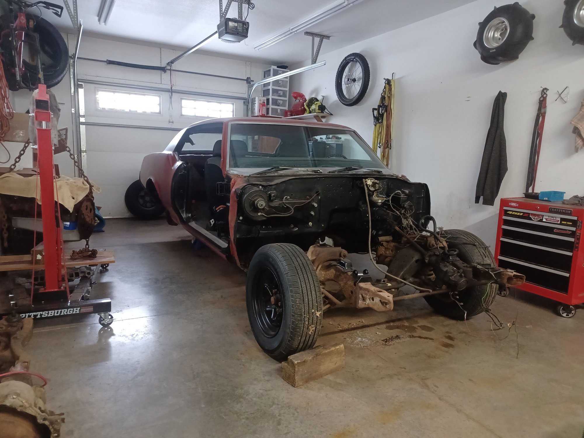

Posts: 44

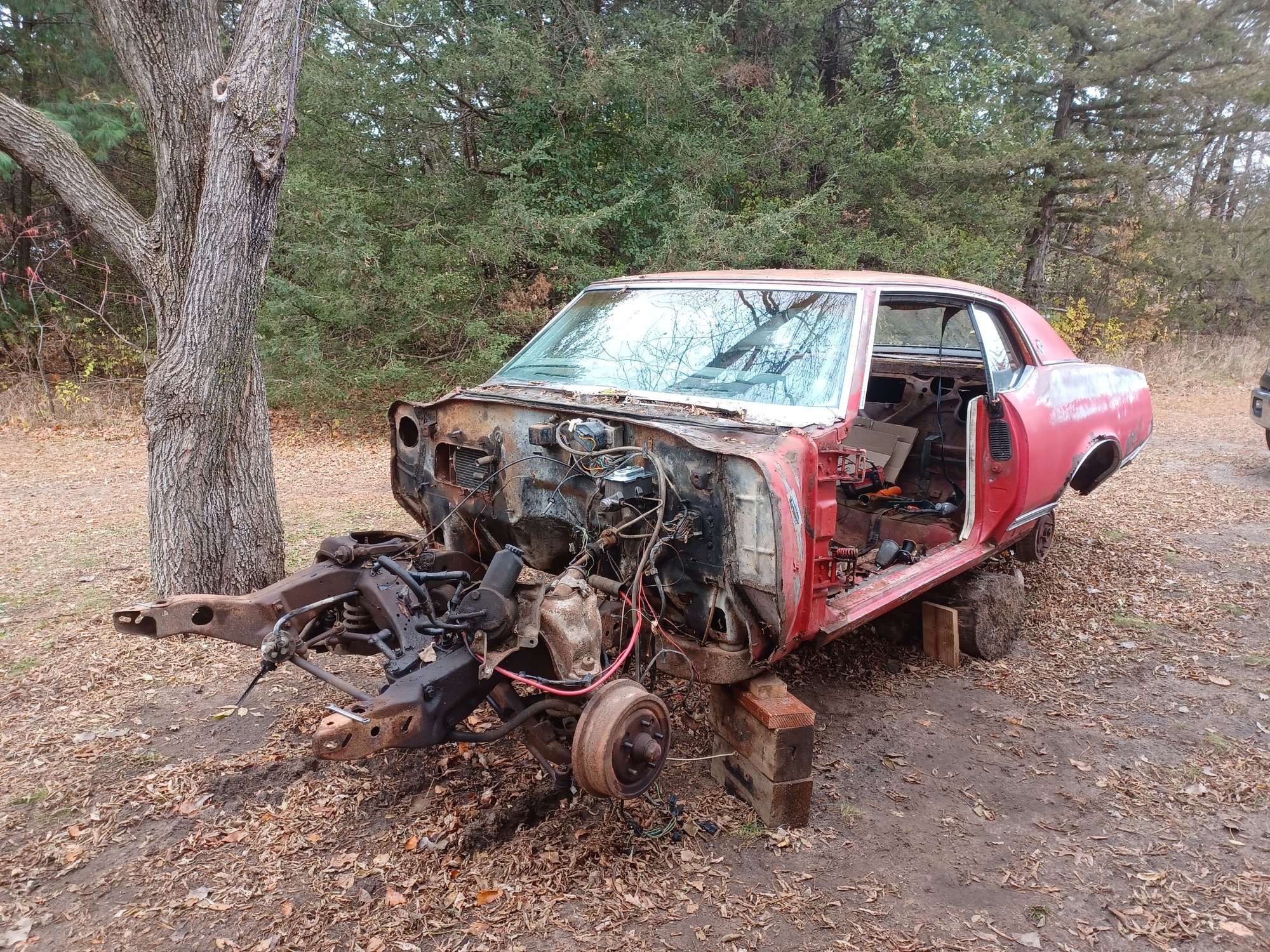

I parked the car in a quiet spot next to our house and started ripping it apart. It took me a while to even get the hood open, as the rust and damage from being pushed around with tractors etc for years had taken their toll. Here is a picture of it ripped apart. Notice the damage near the heater fan from a "mailbox" hit that I was told about before buying. It took a hard hit...

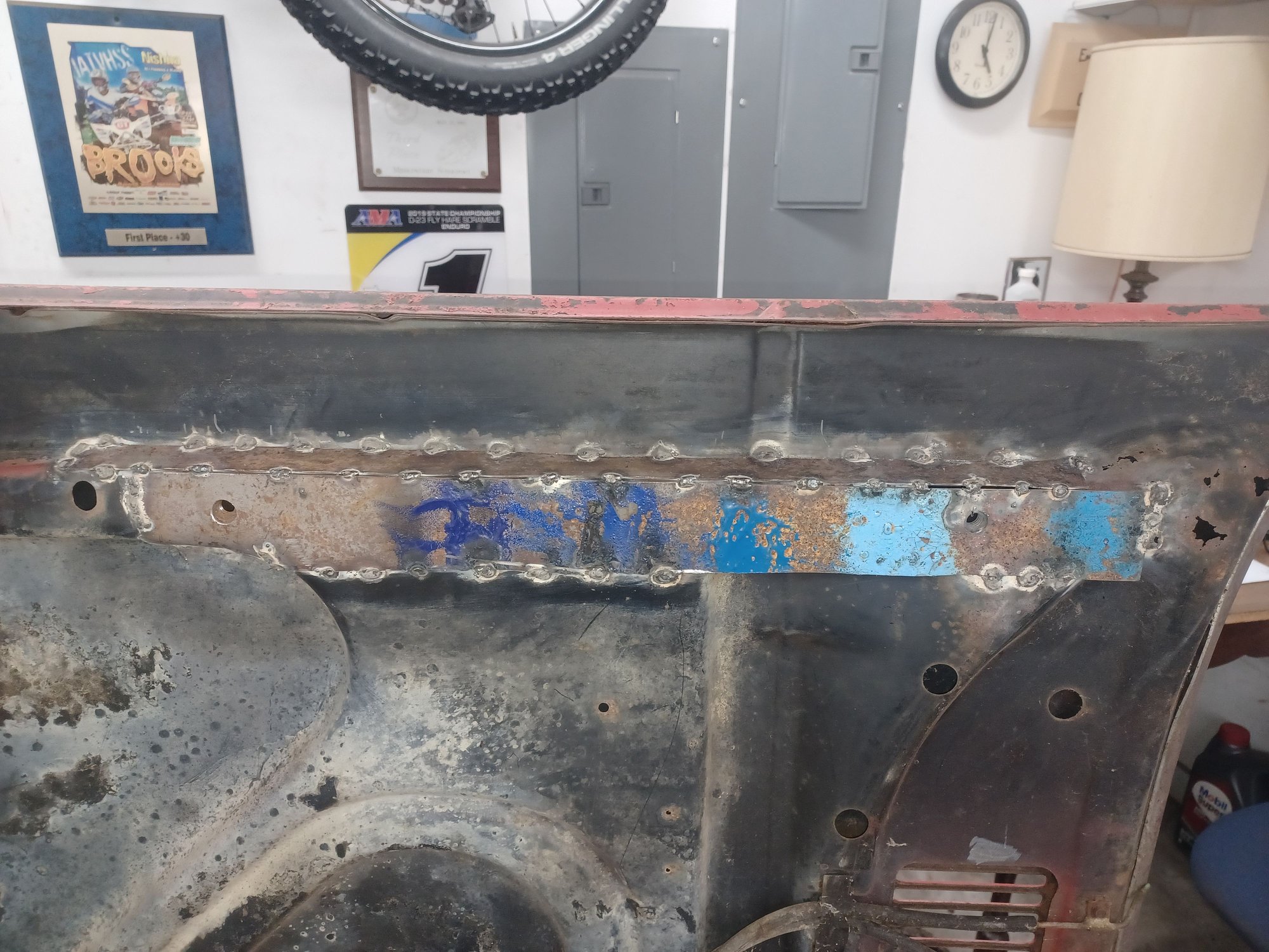

Posts: 44
Getting the hood open... The metal where the drivers side hinge bolted was completely gone. Here is a pic of the scrap metal that I patched the hood up with. I don't remember what this steel came from, but I must have been doing some color samples or something. Again - this is just junk that I throw in a pile and maybe use later. 0$ spent except for a little wire.

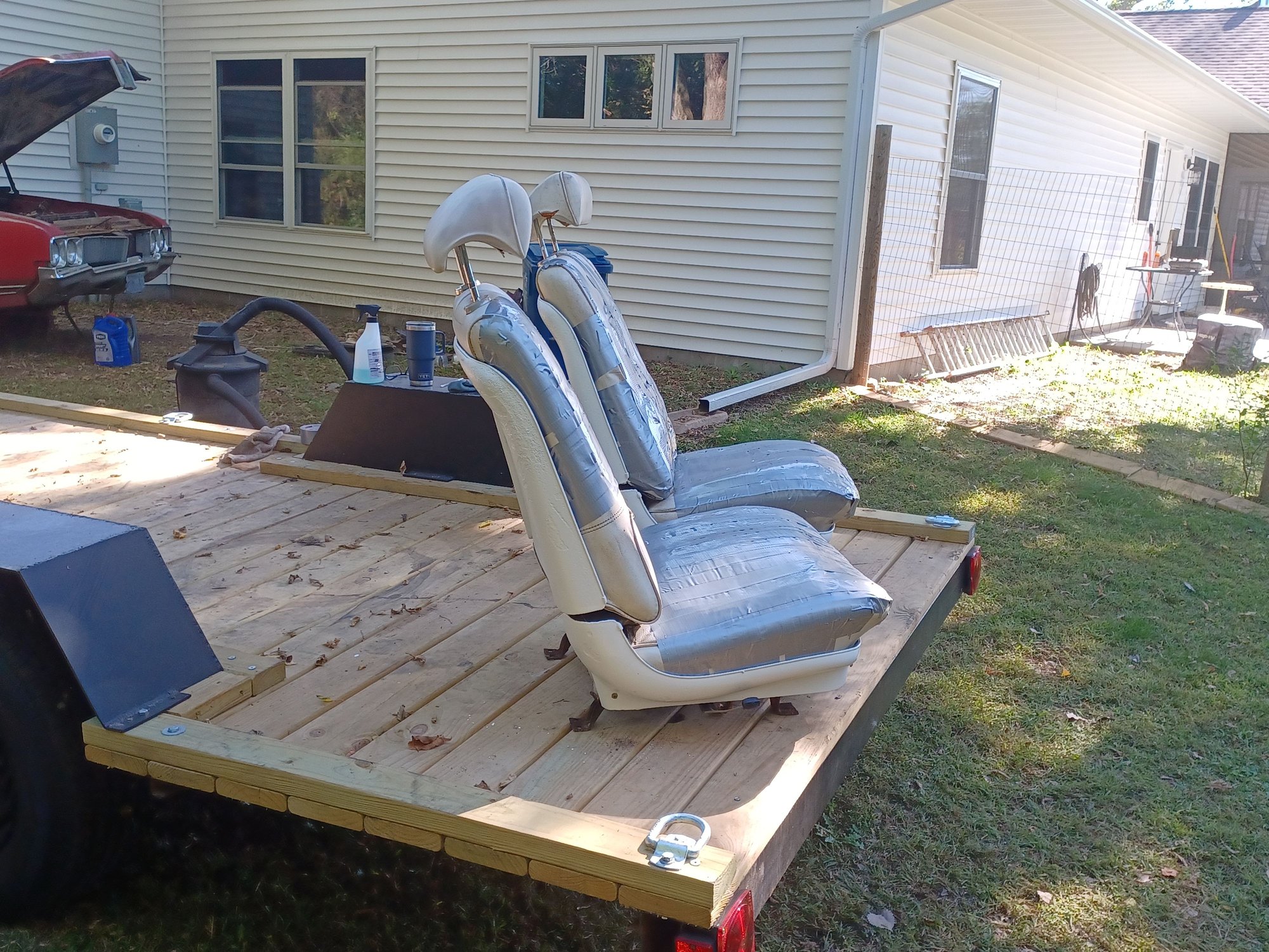

The seats were in tough shape. I took them apart and cleaned up/lubed the important stuff. Removed the chrome trim from the plastic and painted the plastic with some gooey xo rust that was left over from another project, just to keep the plastic from sloughing. I then cut out the most rotten foam and patched in with decent foam that I had saved from another project, then duct taped the seat covers where the vinyl was gone.
Old Mar 21, 2026 | 08:02 AM
letitsnow's Avatar
Joined: Sep 2025

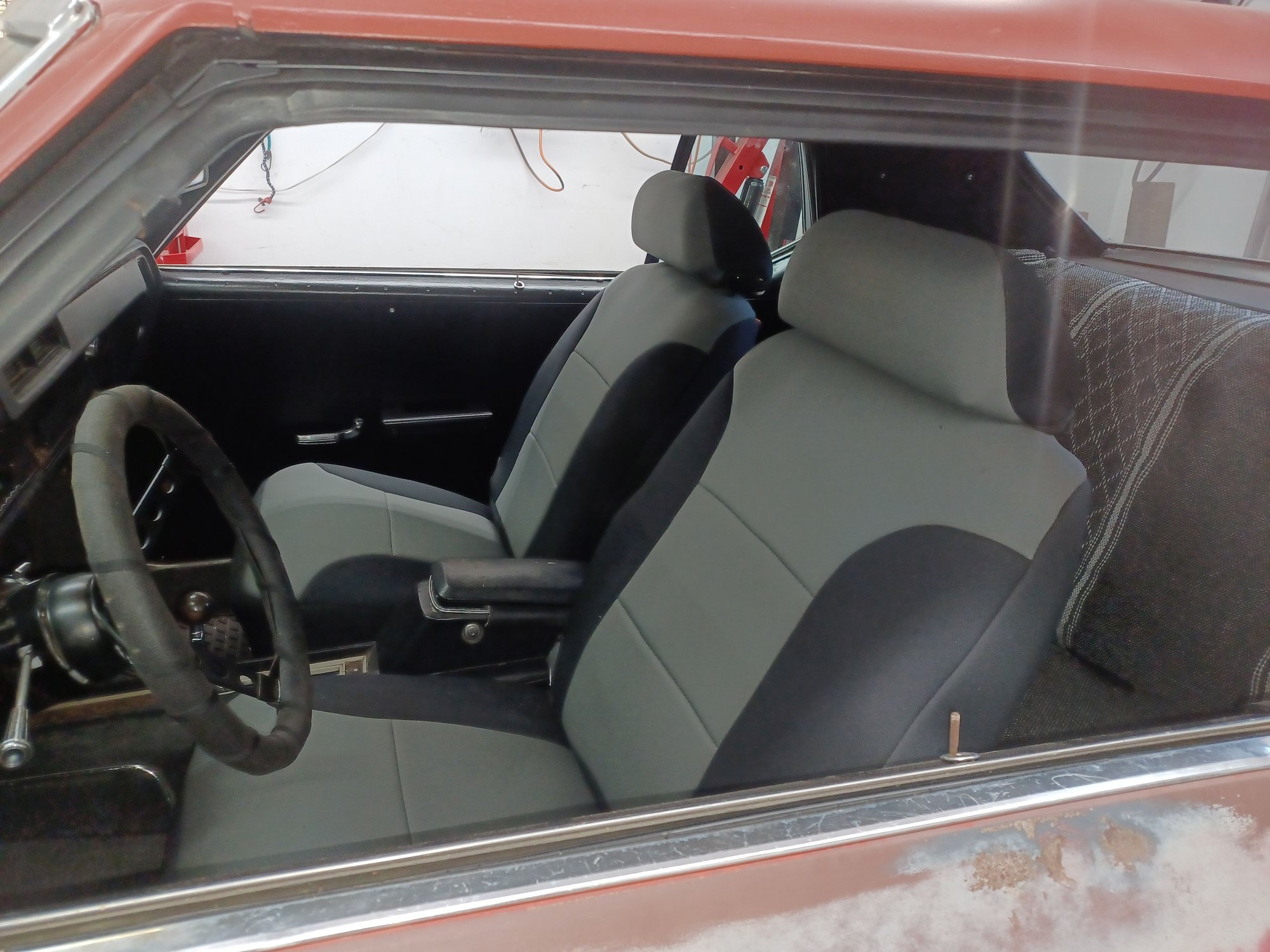

Posts: 44
Installed some coverking seat covers that I had used for years in an old k2500.

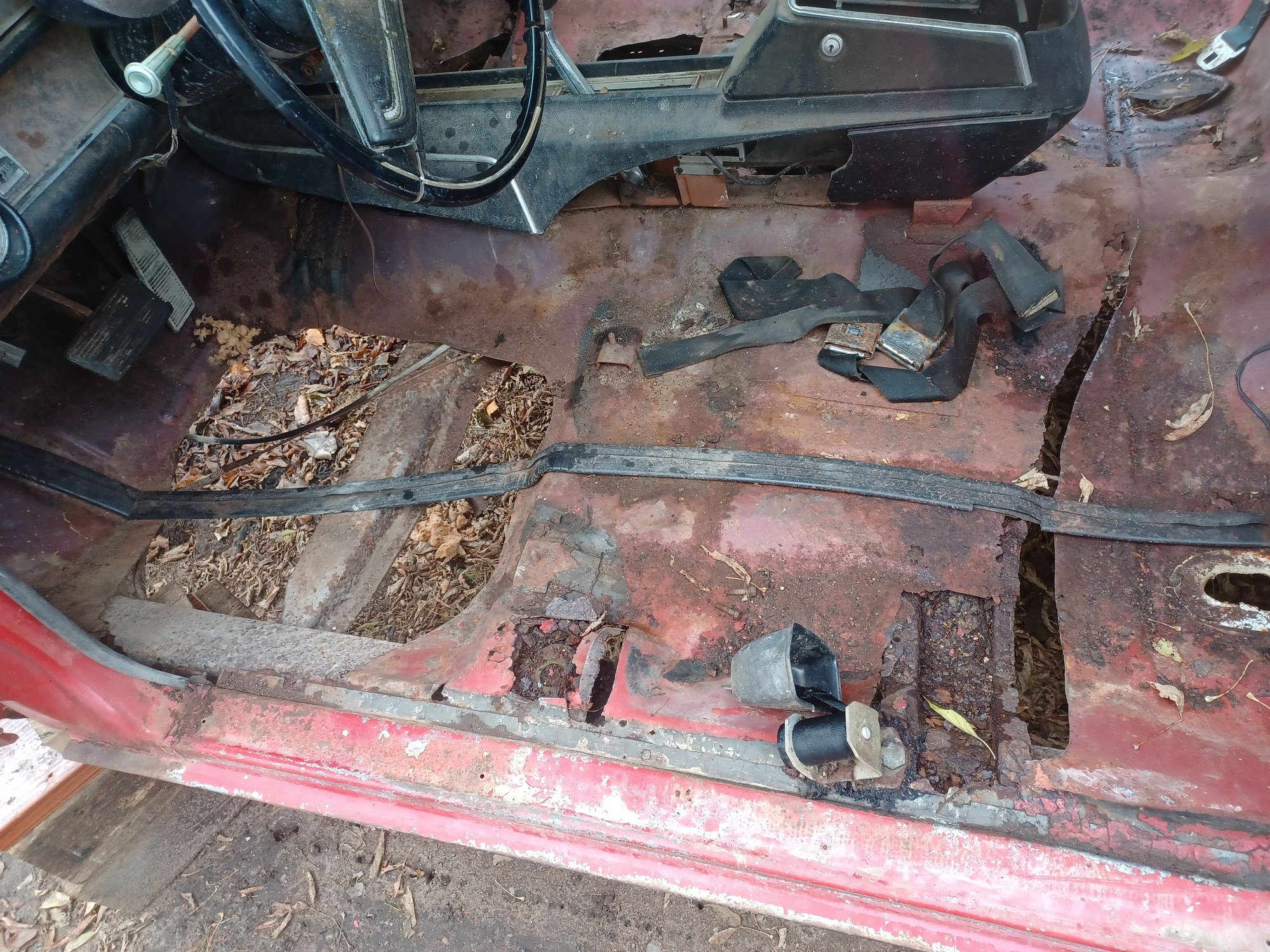

Some pics of my floor hackery. Again - $0 spent except some wire. I forgot about the seam sealer - maybe $15 worth of that. Also, notice the area where the door hinges attach on the passenger side. That was a pretty stout mailbox...

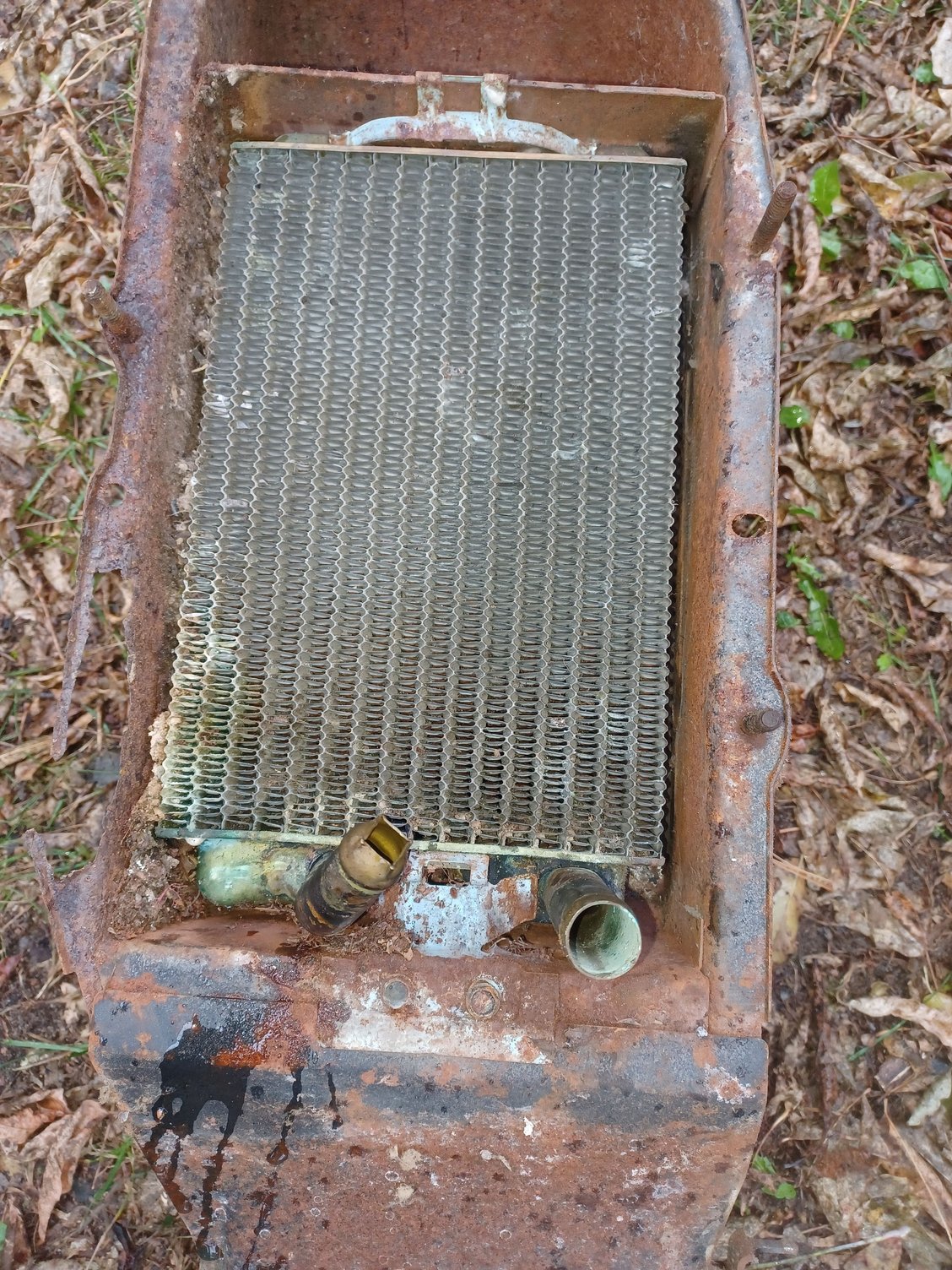

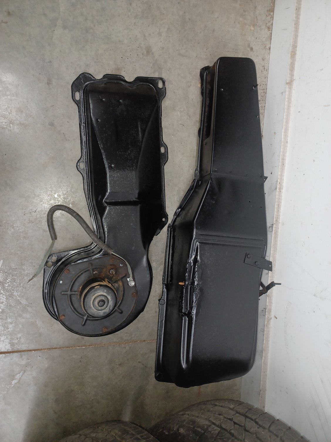

Posts: 44
The heater box sure did seem to make a good mouse house. I really hate those F'n things! Patched up, new heater core installed. Note the fan box is bent from the "mailbox" hit. I suspect the mailbox may have been attached to something like a bridge pillar...

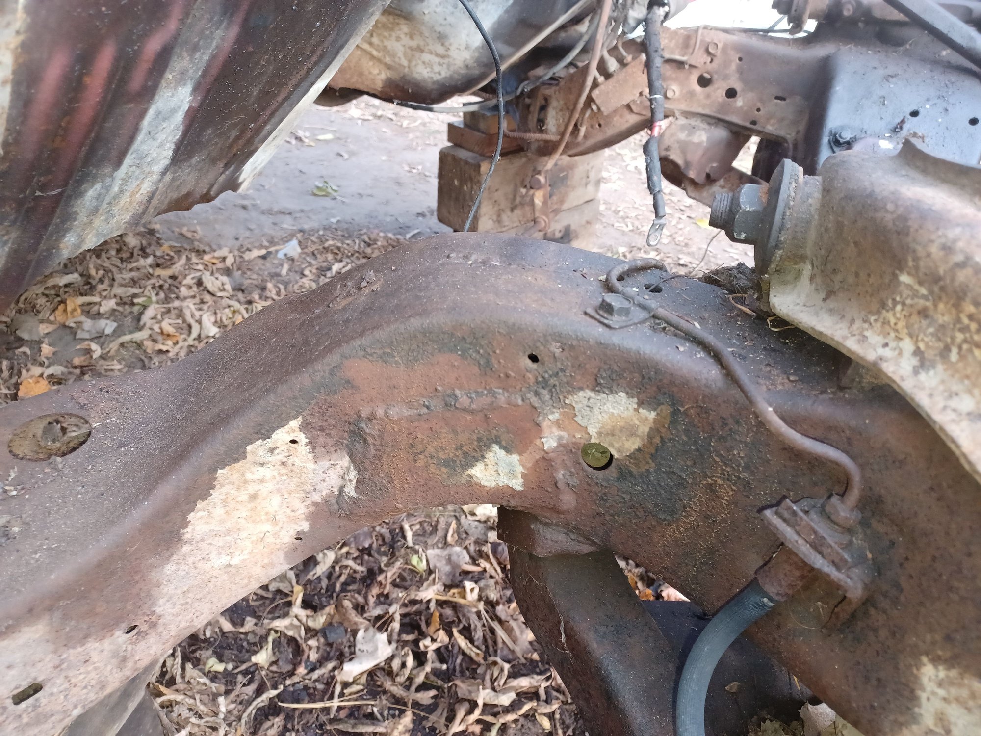

Some frame repair that I suspect was from the "mailbox" hit. The previous owner told me that he thinks that the spindle is also bent on that side, which could be true. The alignment isn't terrible, but there are more shims on that side vs the drivers side. I have another spindle that i'll swap (sometime) to see if it fixes that.

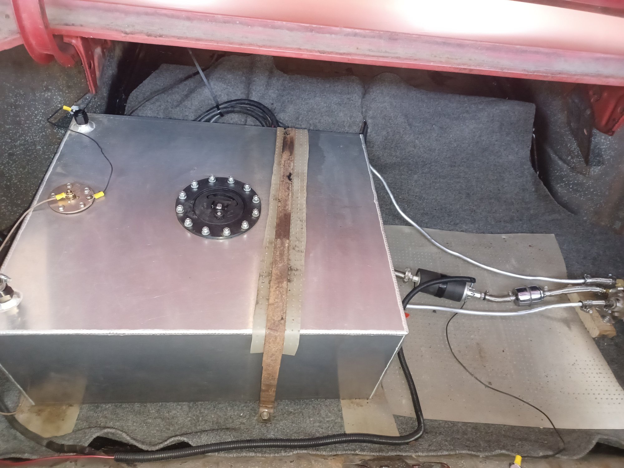

The trunk - the body supports underneath were totally gone. I welded in patches, made my own body mounts out of some HDPE and rubber that I had on hand. I then welded some scrap angle iron on the top side to help give it some strength. It isn't as good as new was, but it isn't terrible. Here are pictures mid-hack, and as it is today in use.

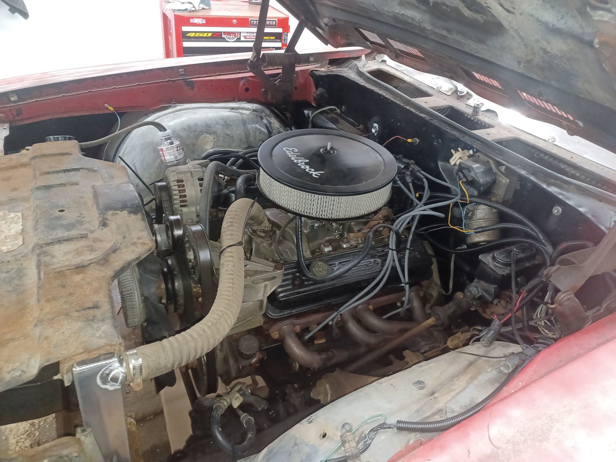

Over the the years I have ended up with 3 sets of vortec 350 front accessories and 2 tbi 350 motors. This motor came from a rusted away 1989 square body plow truck. I bought the motor for $100. Added my front accessories, replaced the oil pan ($50 from Summit) because it had rusted through, bought a GM 4 barrel intake that had a Mr gasket spread to square bore adapter on it already for $20. Added an edelbrock 1406 that I had, and a china HEI that I had replaced the vac advance and module on. I used some cut up headers that I had on hand, making my own 2 into 1 exhaust that exists through a used dynomax muffler. It sounds kind of farm trucky, but runs real good. I like these tbi 350's as drivers. Nobody wants them because they make no power above 4000 rpms. Daily driving I never see that many rpms and they work real well. Cheap and reliable.
