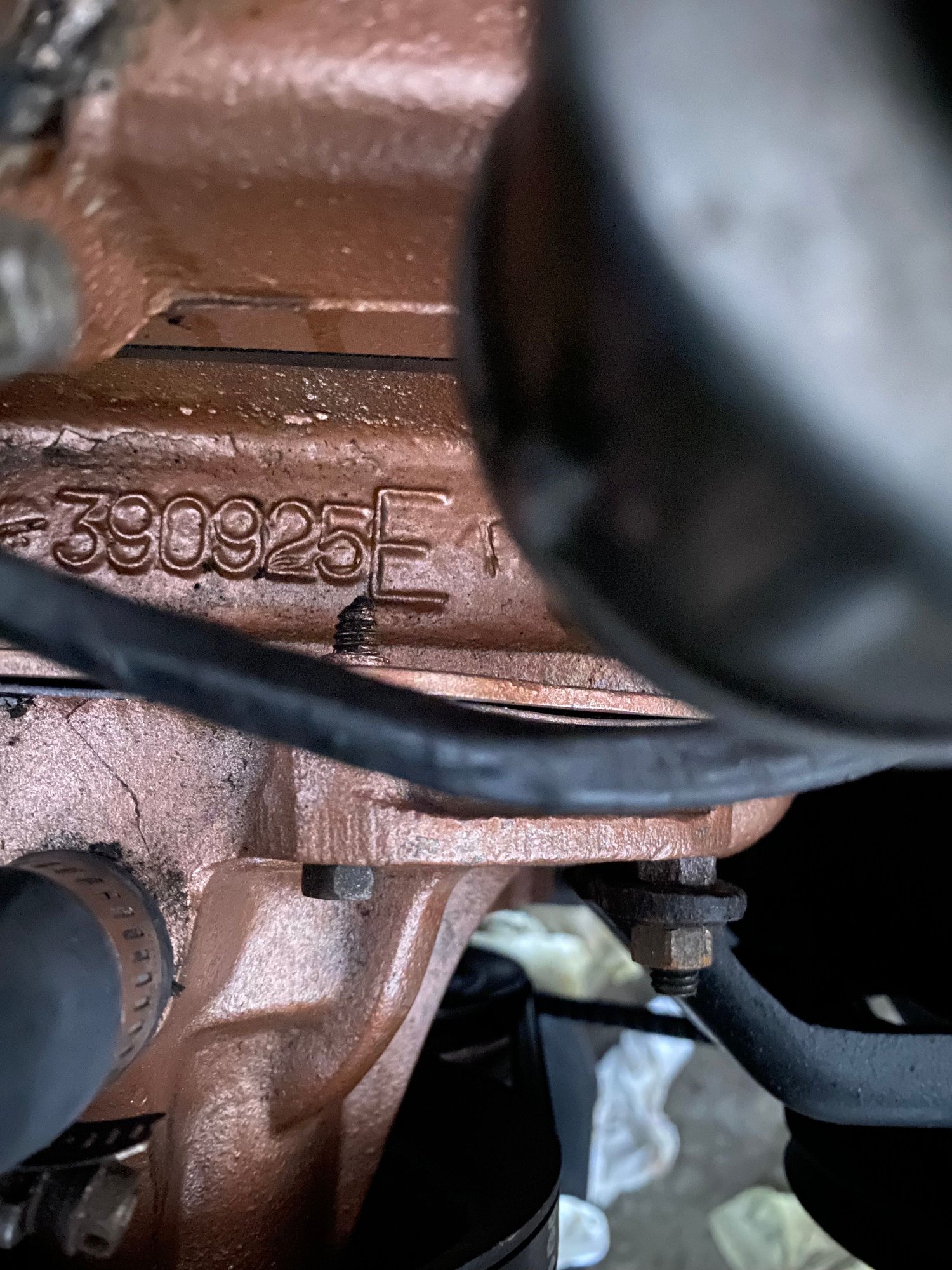

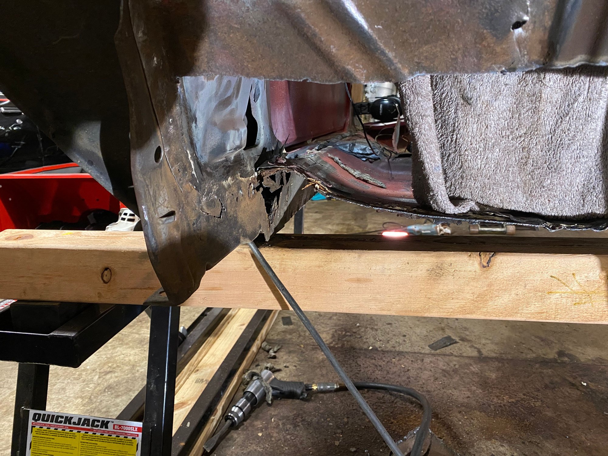

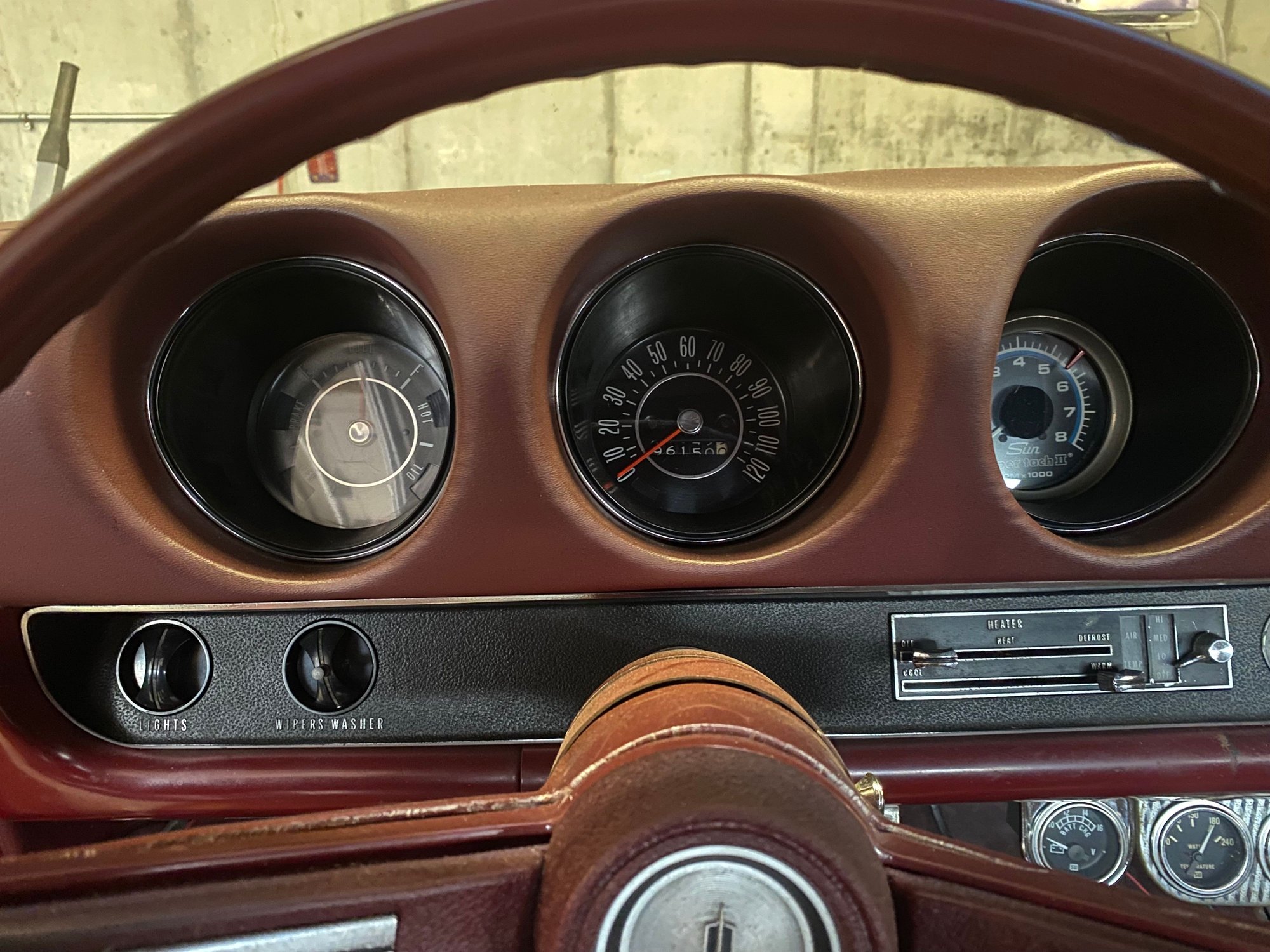

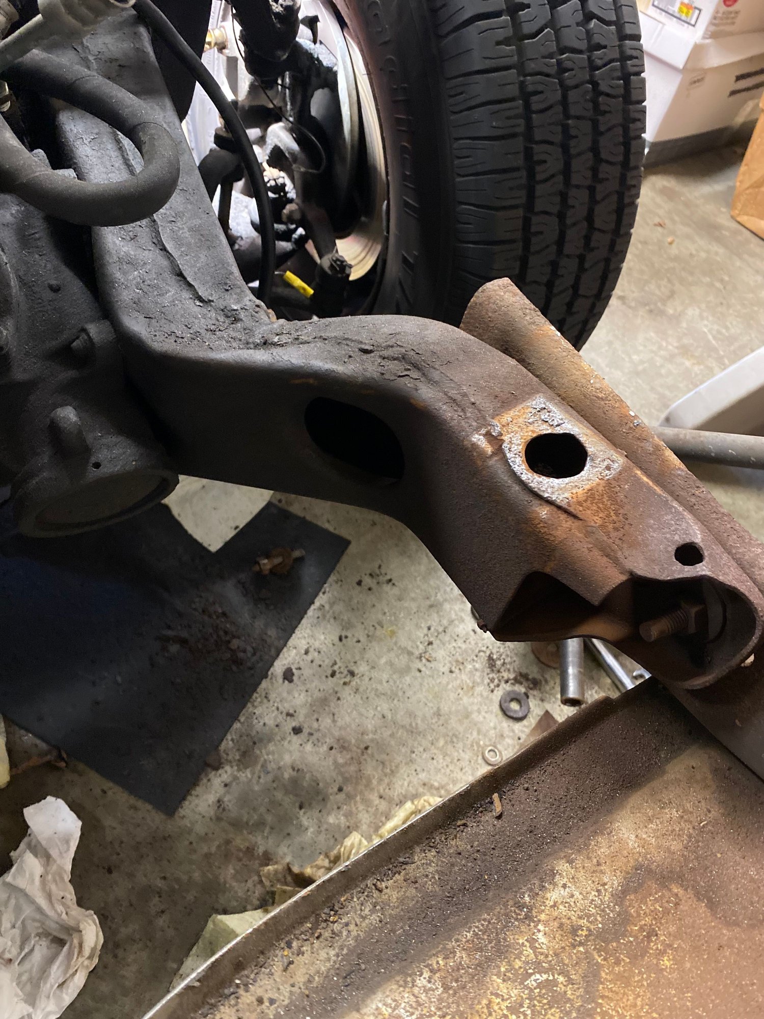

Some Initial Photos. The Engine is OUT! The body wants to twist and rock backwards, so I am waiting on help to lift it any higher.
Early Front Clip Removal.
The "Repairs"
Instrument Panel
1967 400 E Motor. Debating EFI.
The Passenger Frame Rail. Has seen better.
Tweaked driver front frame horn. Rusted out below.

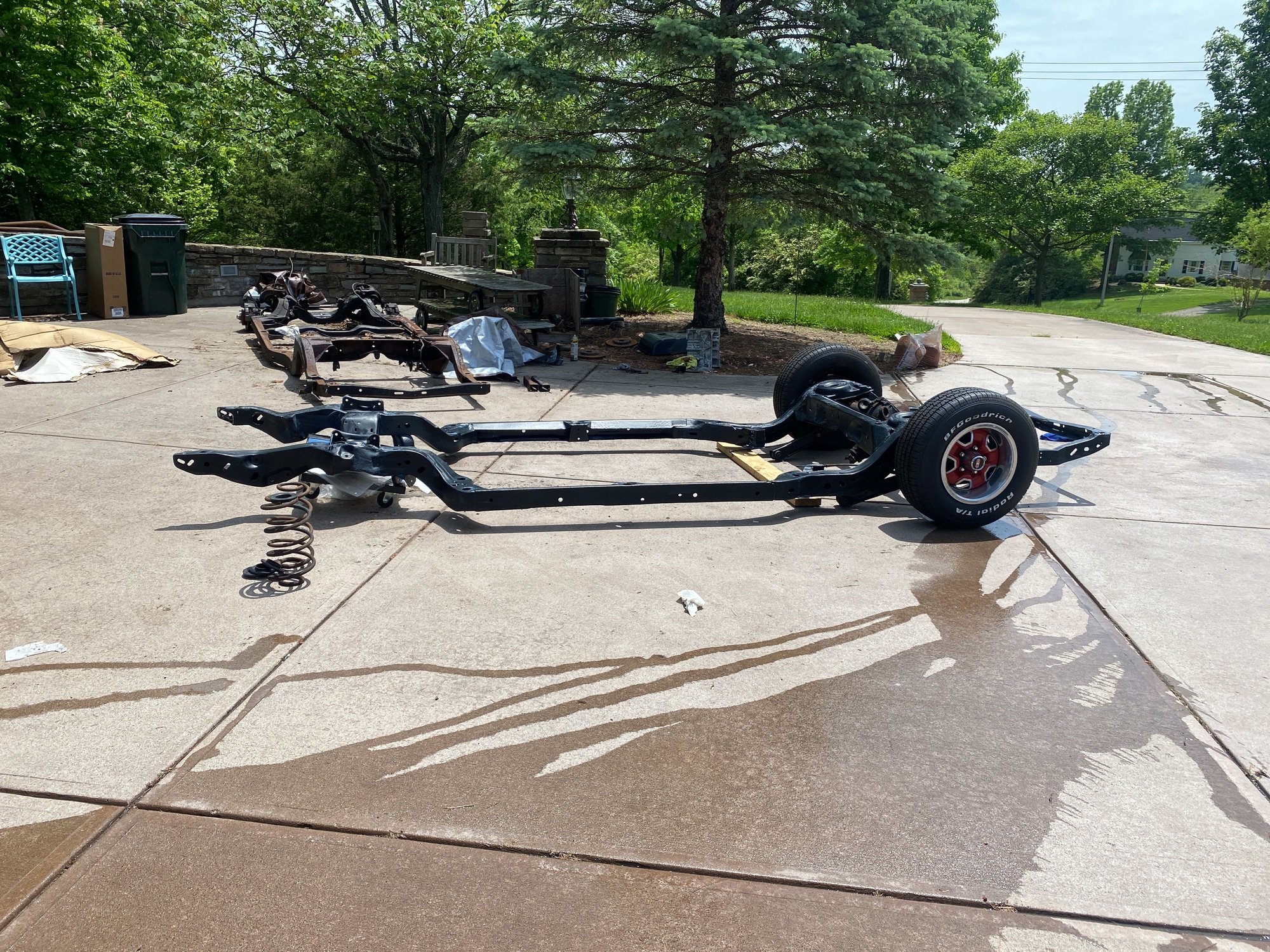

Got the frame scooted out from under the body with some ingenuity. I have Quickjacks (basically hydraulic 2-piece scissor lifts), and used 2 4x4x8 posts, one near the firewall, the other at the back of the pinch weld, plus a jack under the trunk where the gas tank would be (mostly for stability) to raise the body to the full 2nd position. Then, I disconnected everything and pushed the old, damaged frame out!

I got a new frame! and the floor pan is being worked on. Pictures below of transport, as well as my custom top plate solution.

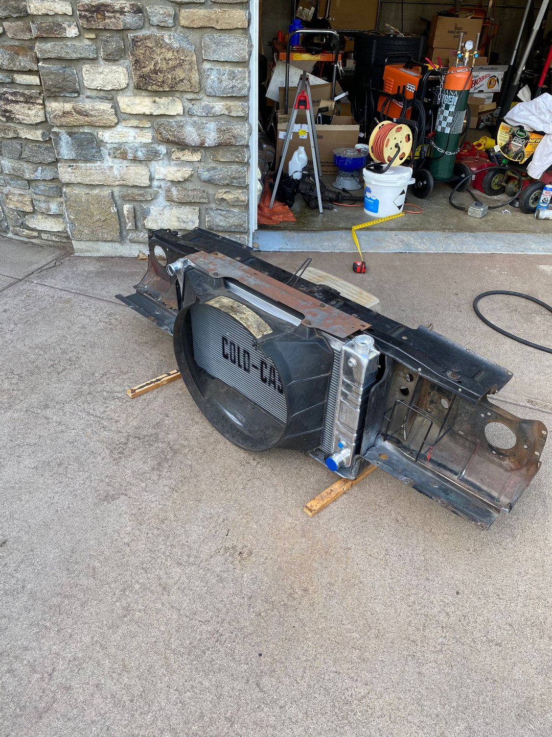

New CUSTOM 1968 4-core top support welded up, fits perfectly. Waterjet cut from 18ga steel and saddles from Inline tube welded up.
Also cleaned up the core support and welded it back up. Rear end work too, but it’s a chevy 12 bolt for some reason. Going with a Detroit Trutrac Helical LSD for long service life.
