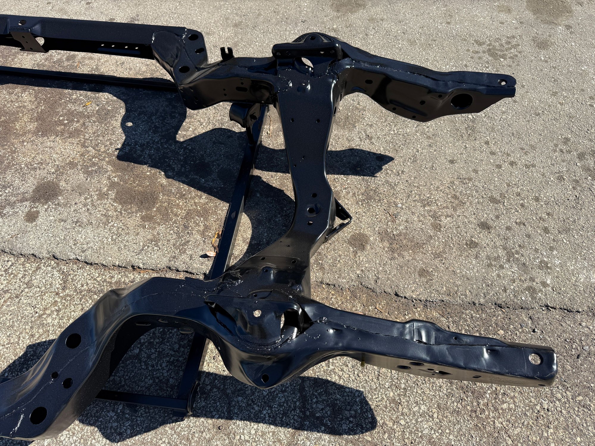

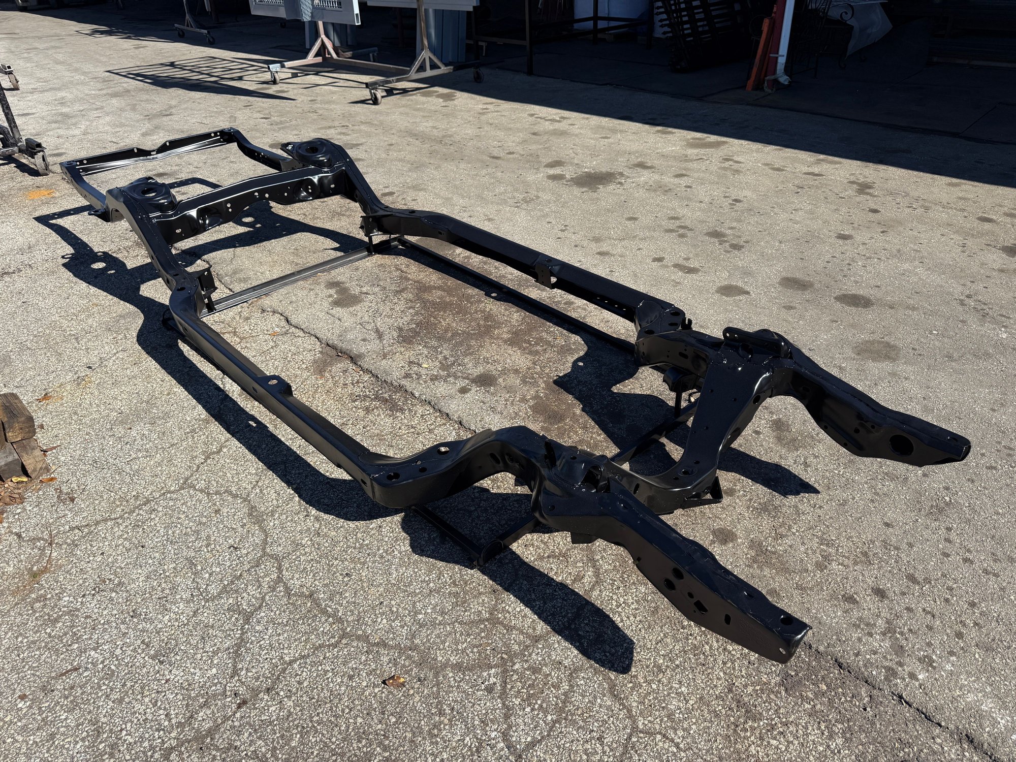

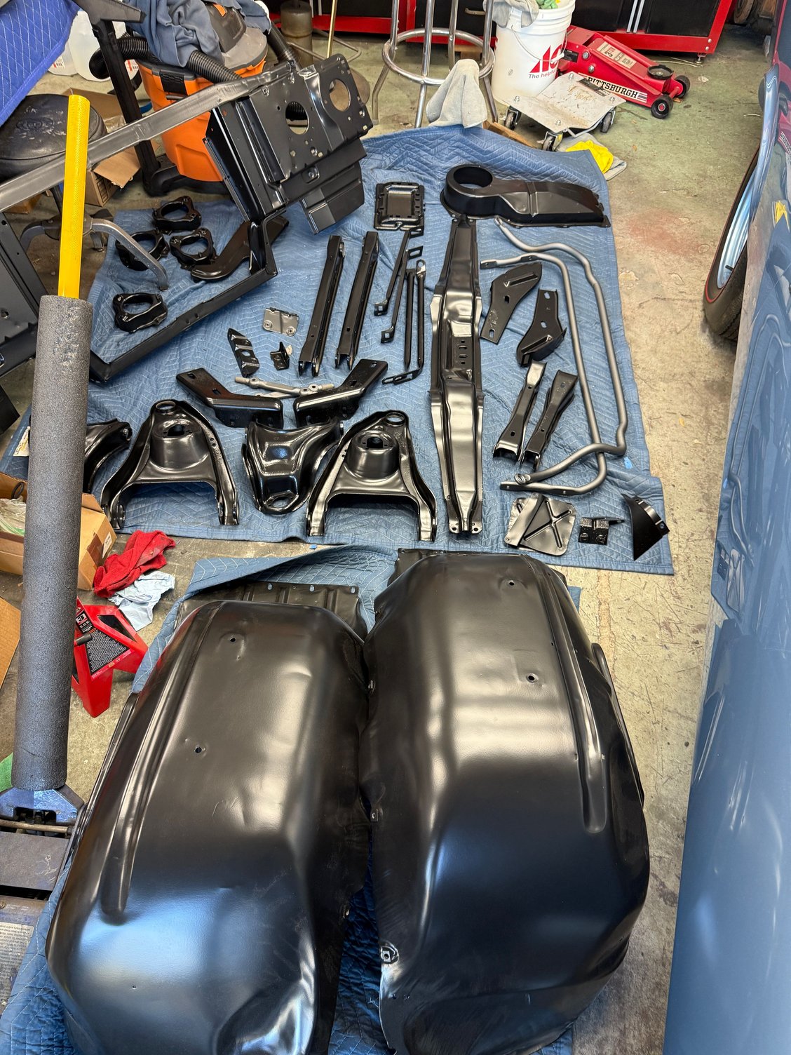

Ok…MAW in progress…
‘But I swear I’m not touching the body…for now. 😁
I did decide to restore the entire chassis and floor/trunk pans.
But for now… just mechanicals.
The frame was in amazing condition…blasted and powder coated.

Extra parts are already done.
now just an afternoon on NPD to order up some new consumables.

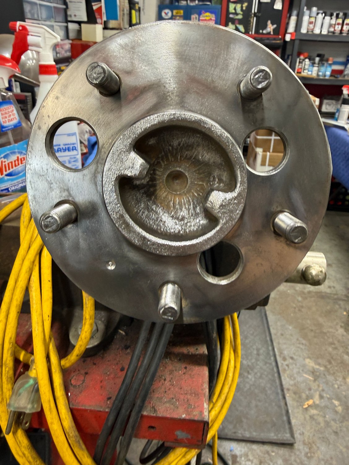

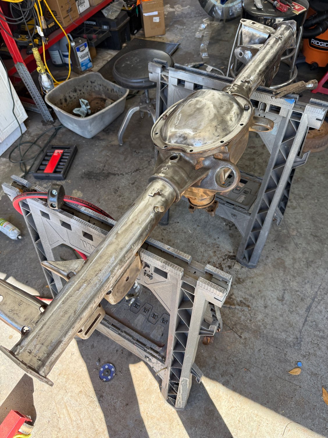

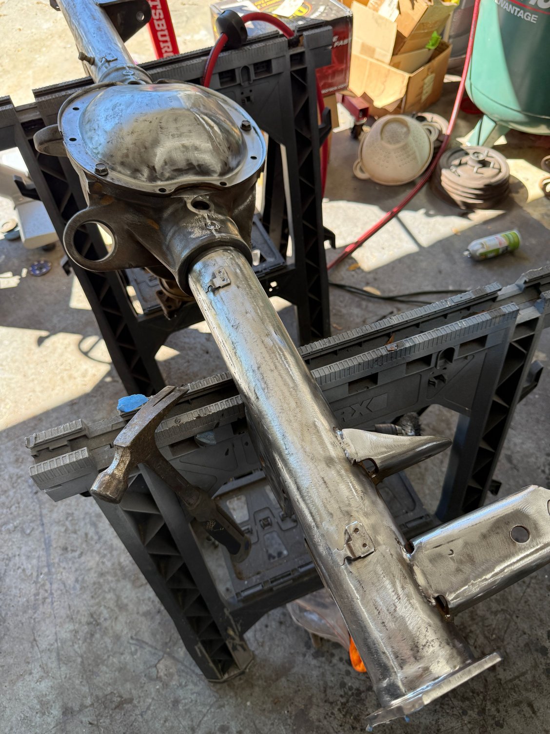

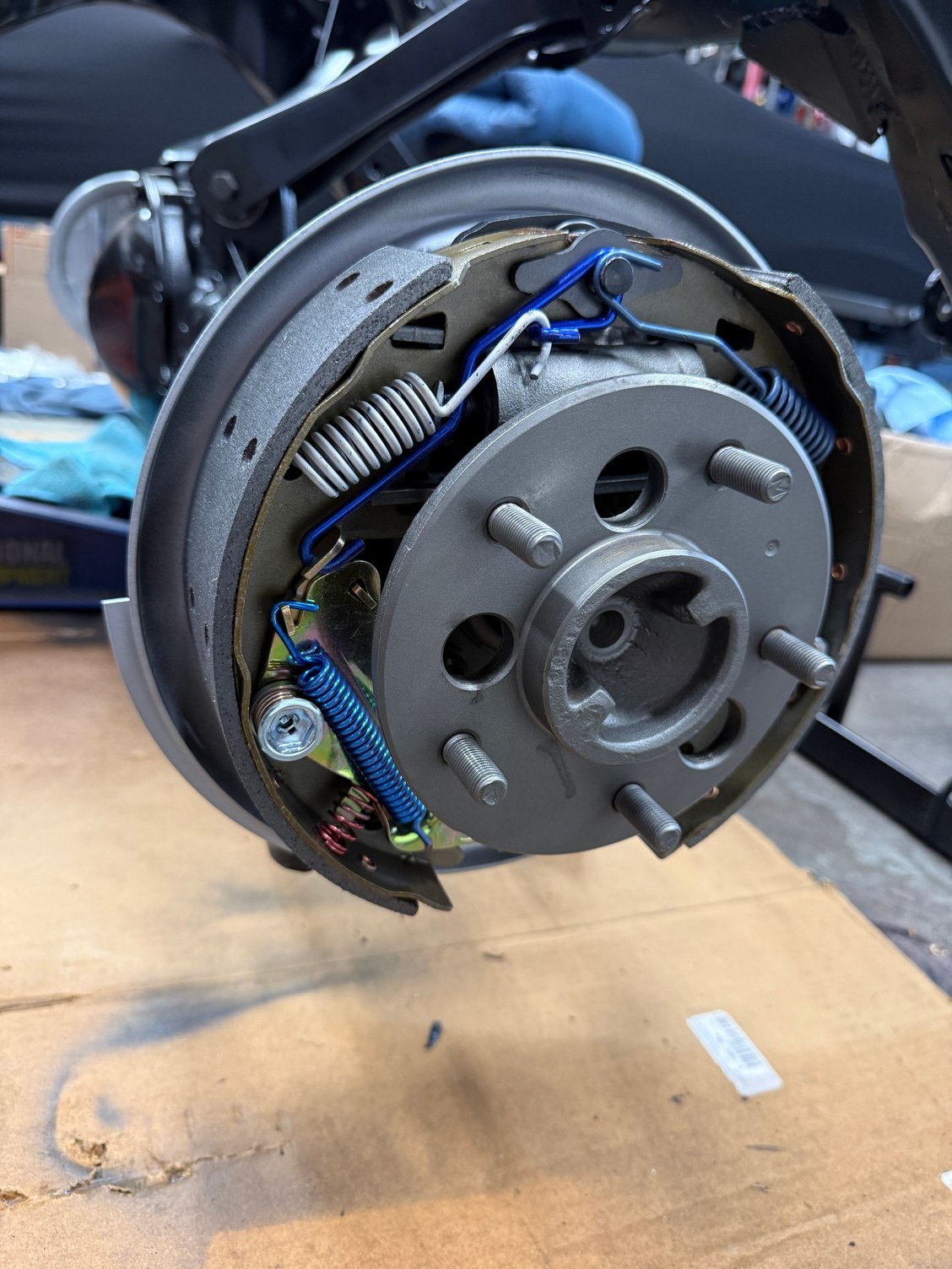

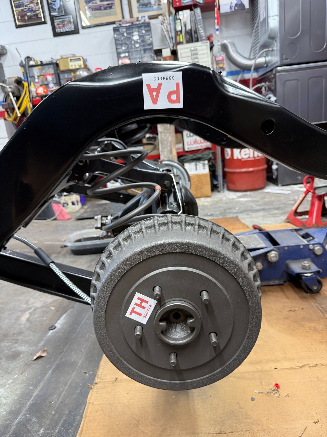

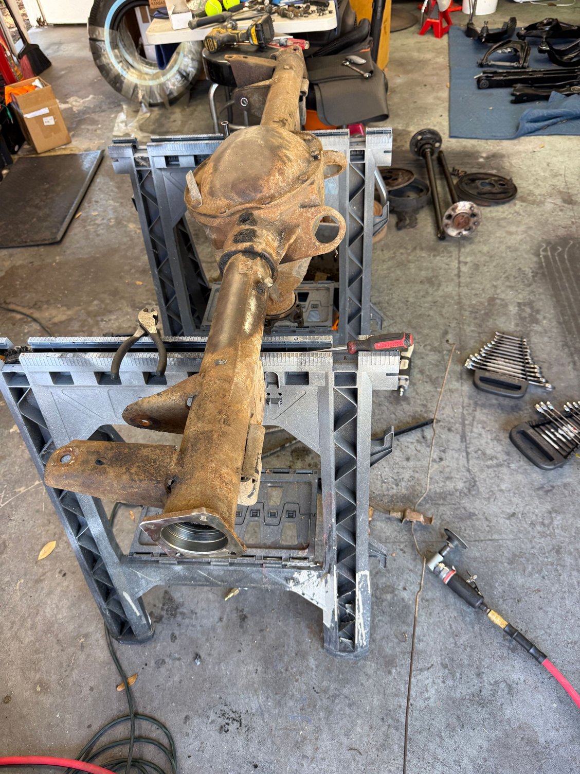

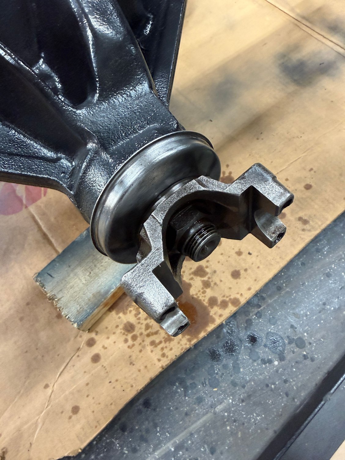

Got out today to disassemble the rear and start the rehab

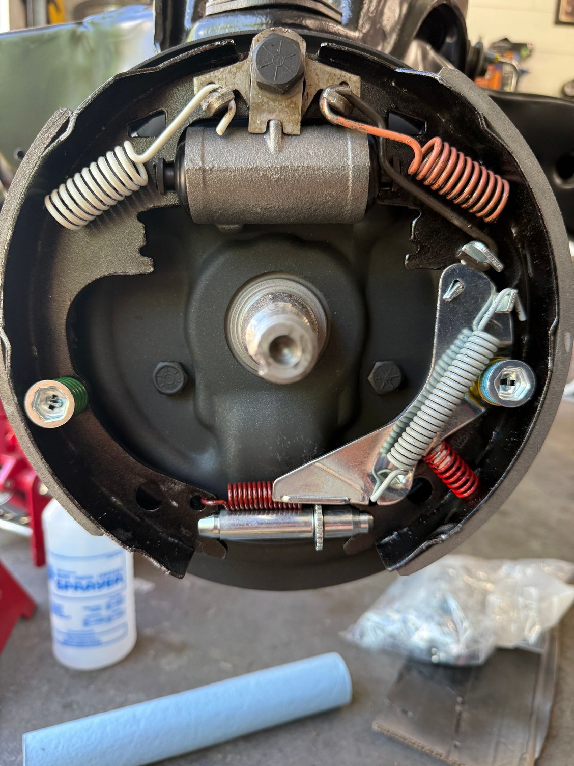

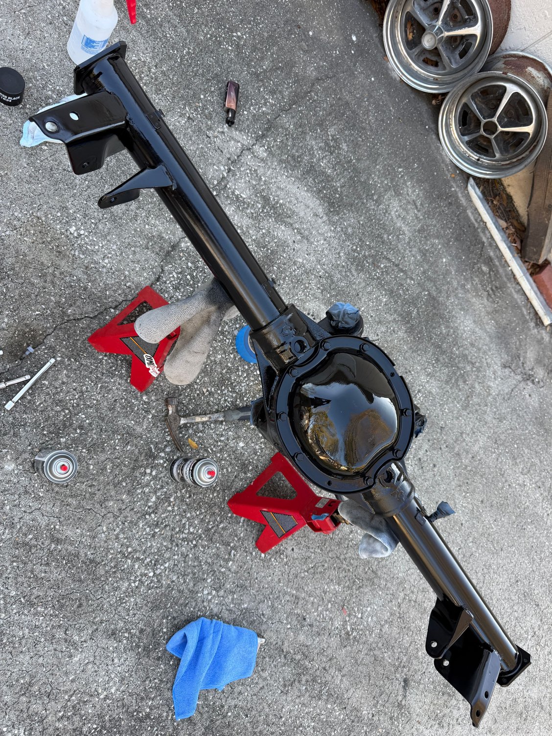

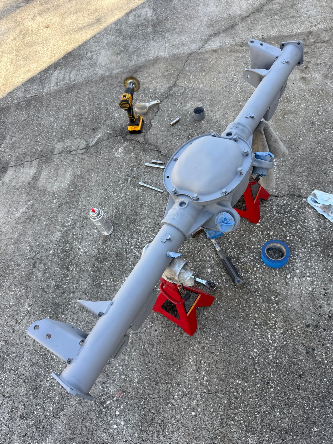

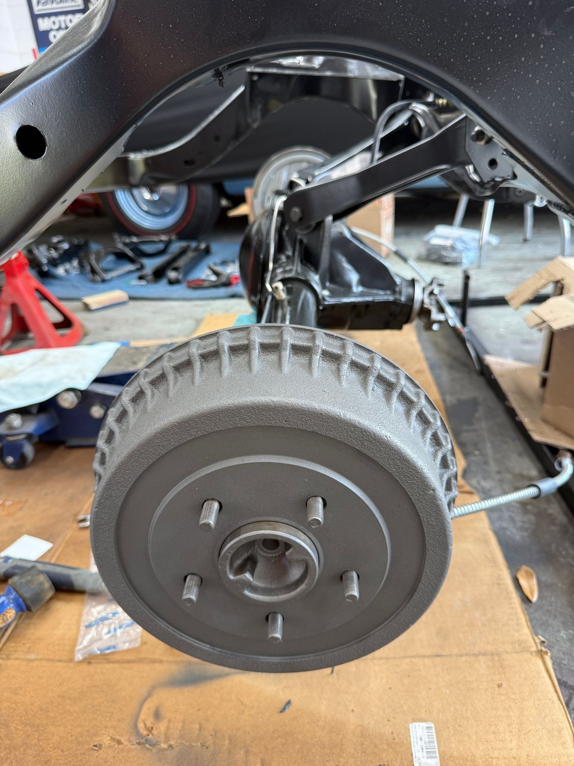

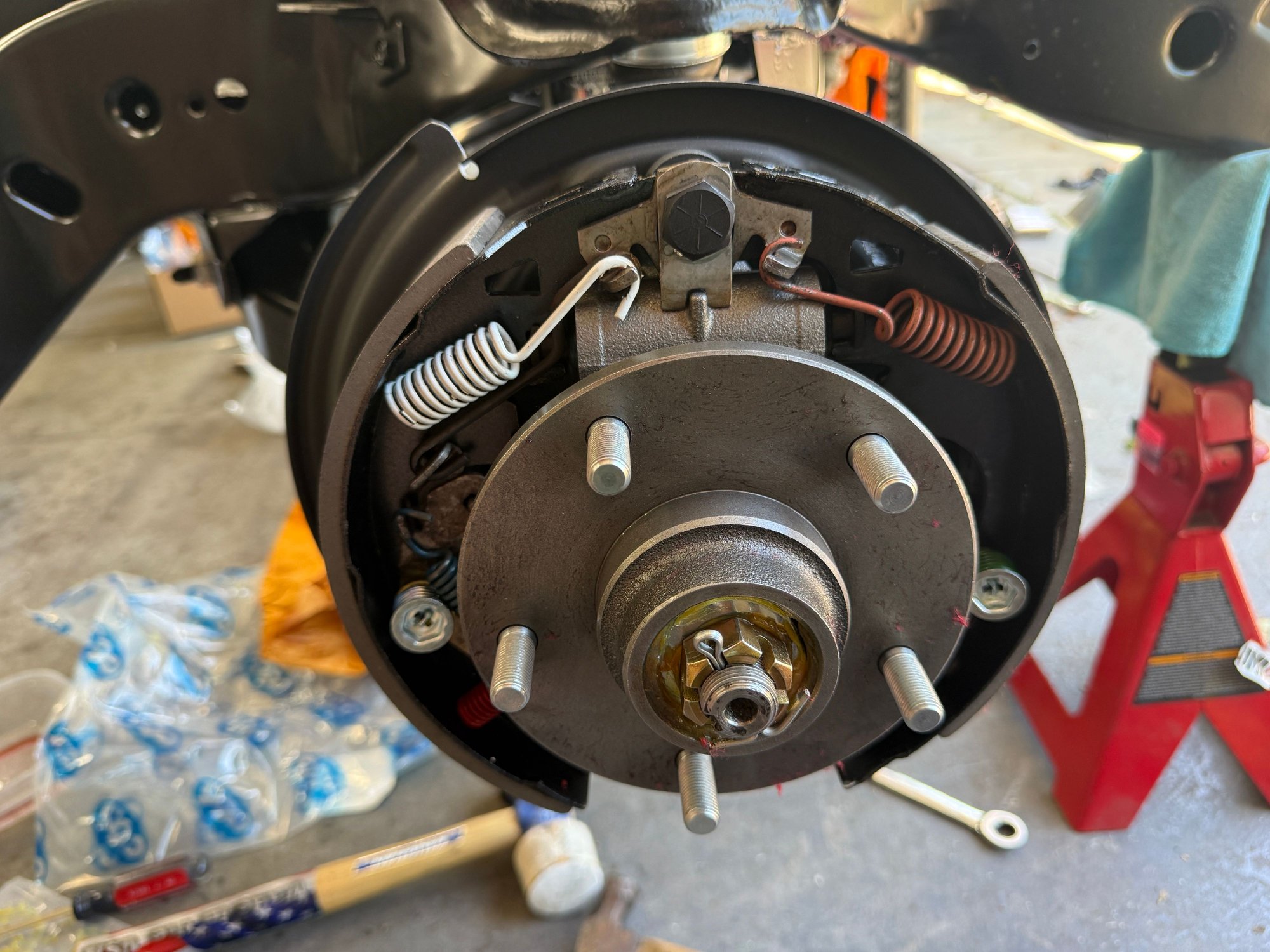

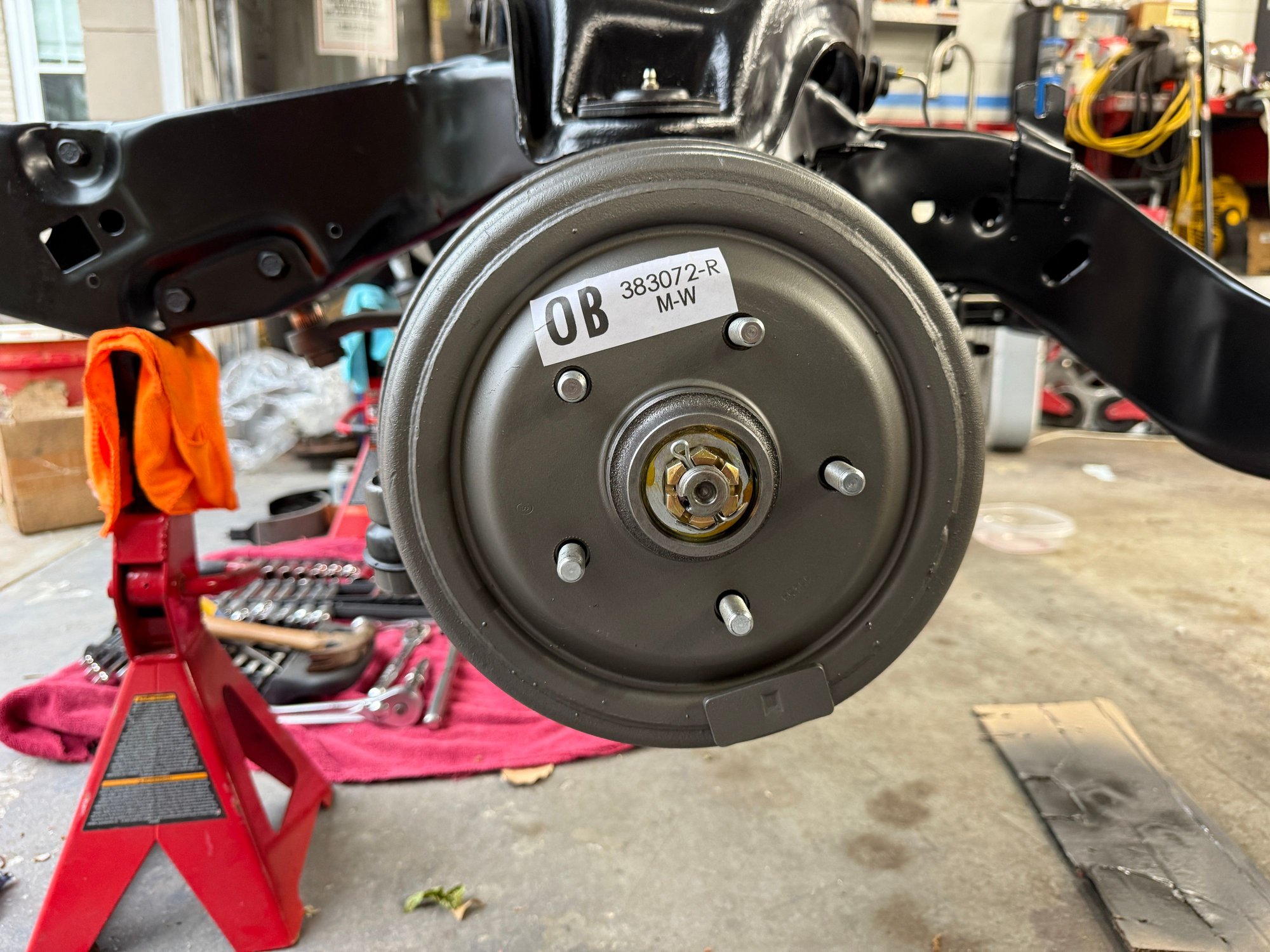

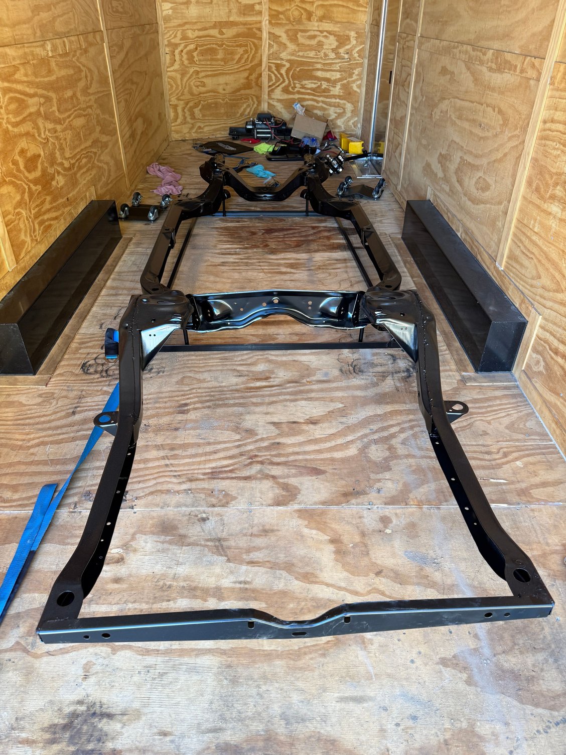

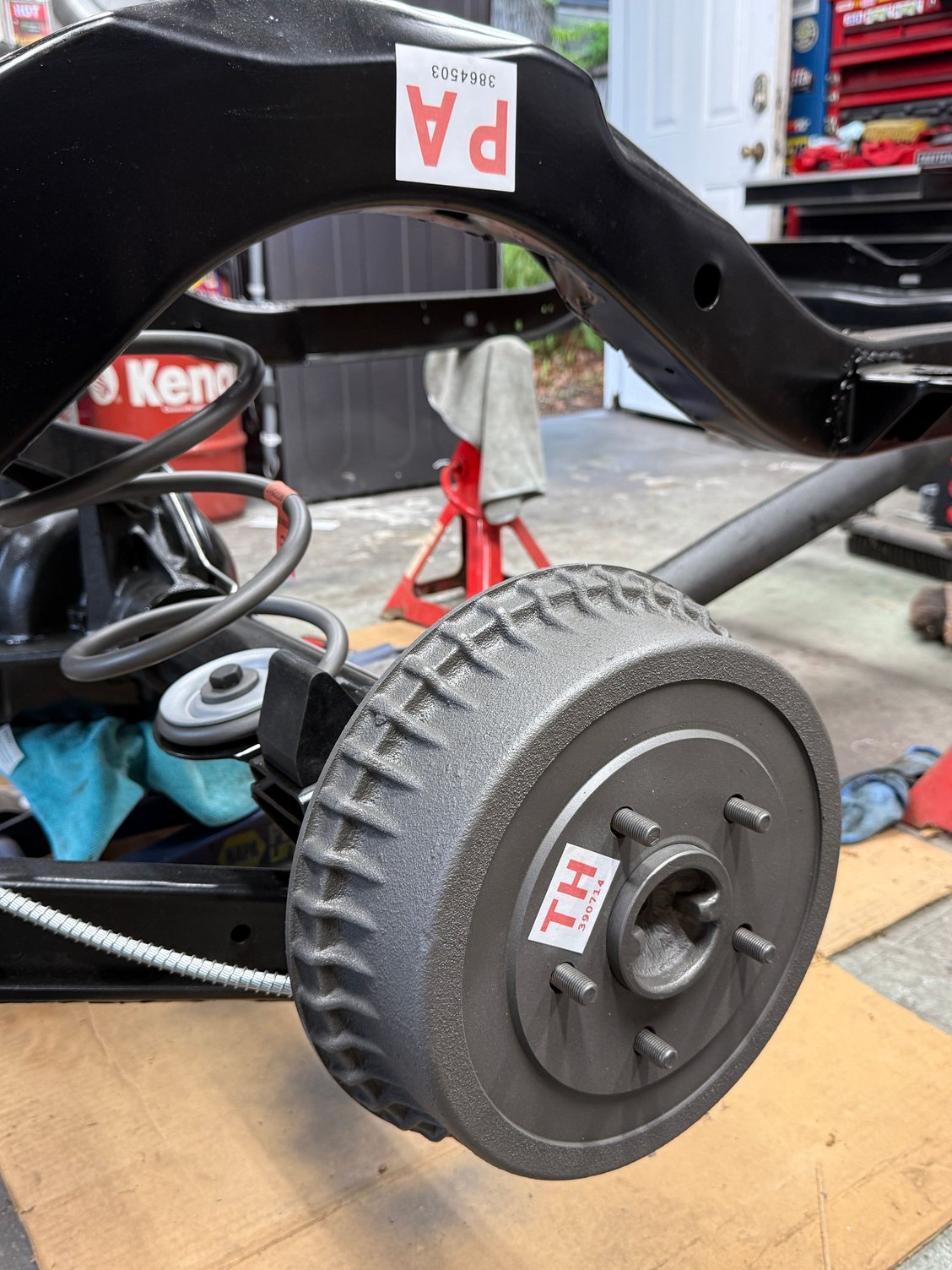

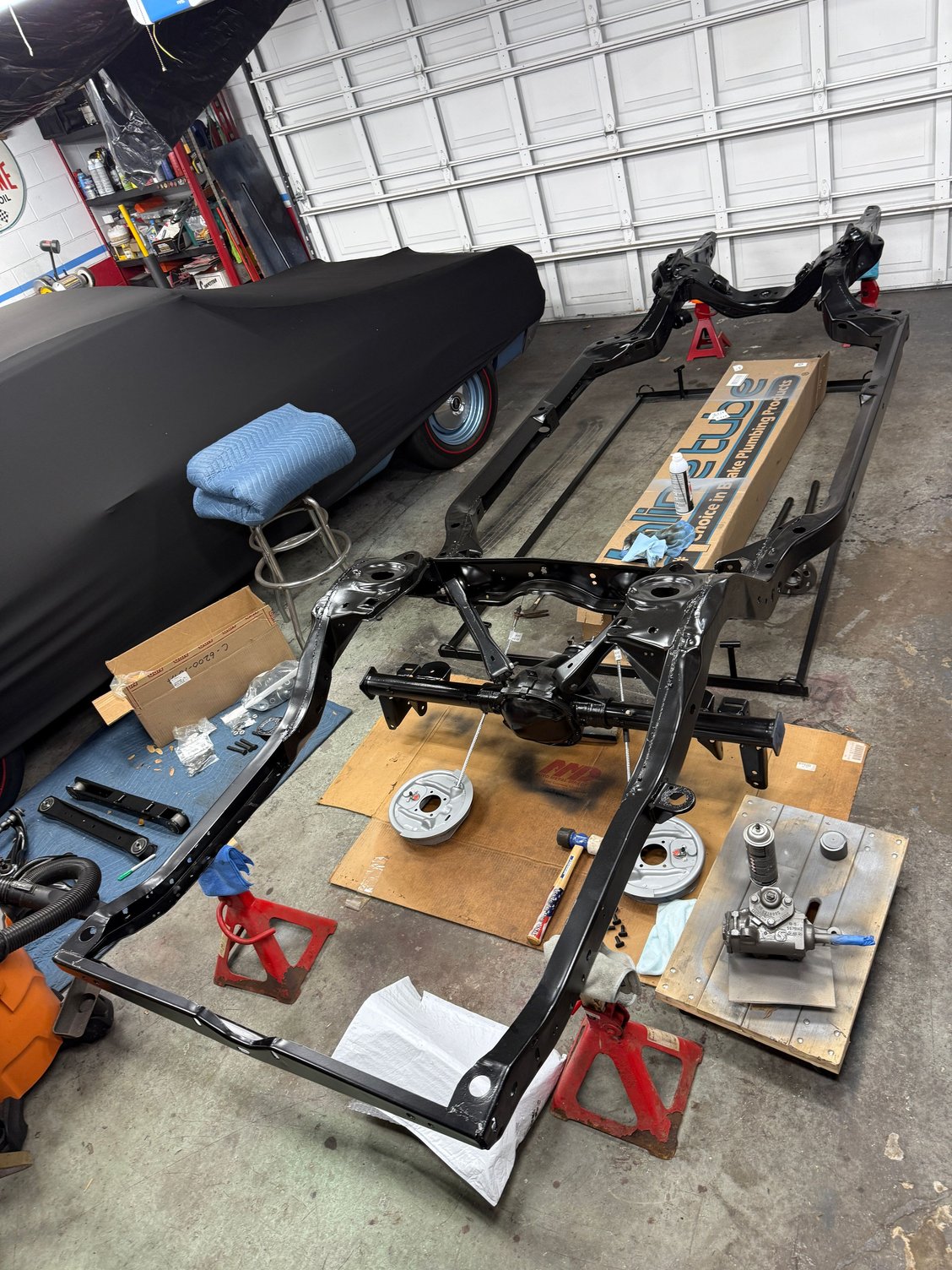

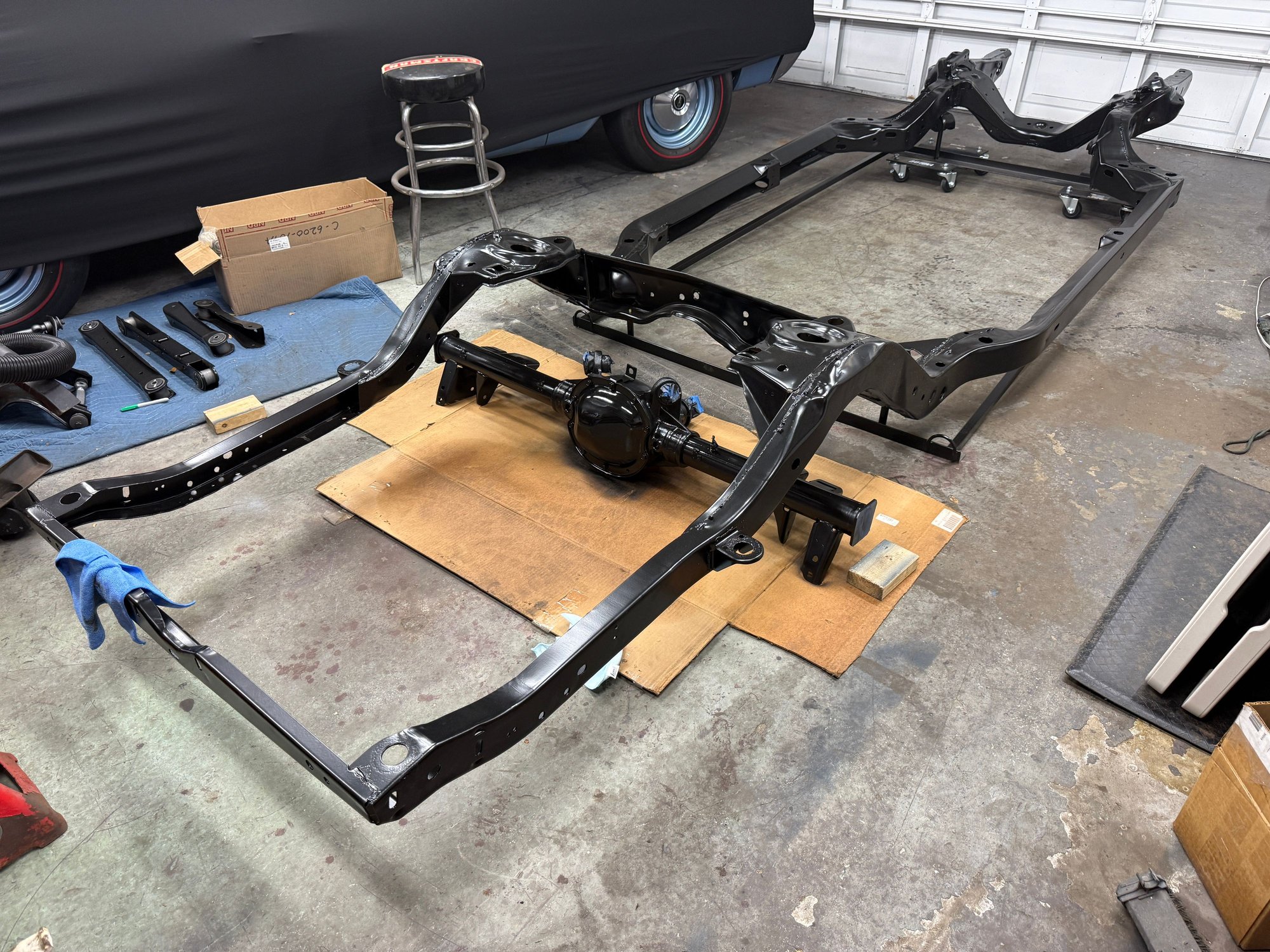

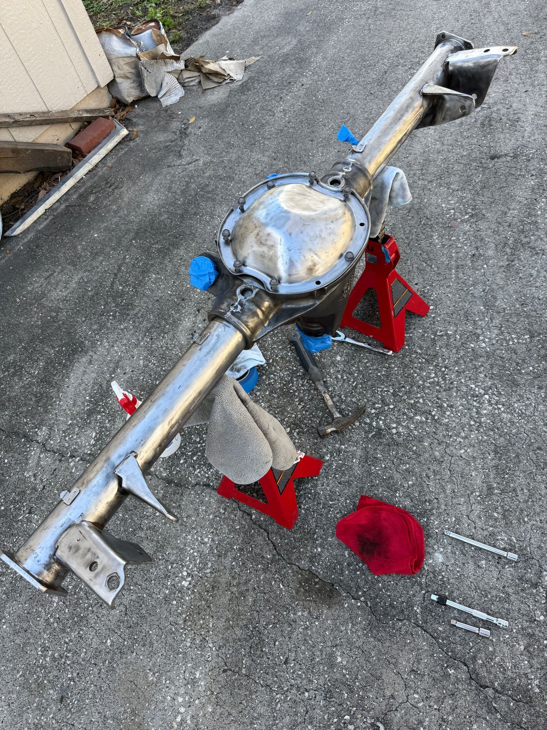

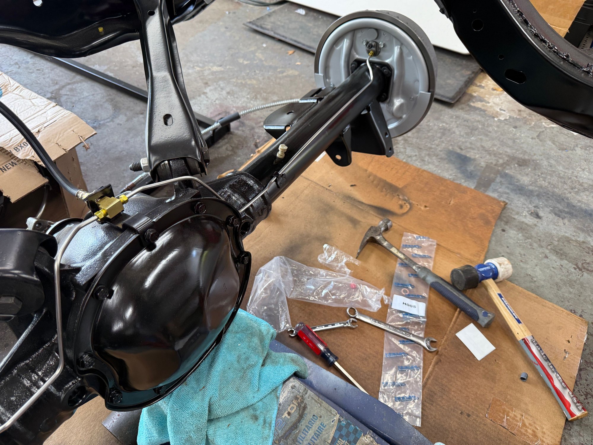

Lotsa prep work done(only 1 wire wheel accident…they usually come in 3’s.
Rear was prepped and painted, brakes and backing plates are ready, manual gear box and axles cleaned.
The frame left my trailer and came inside to get built.

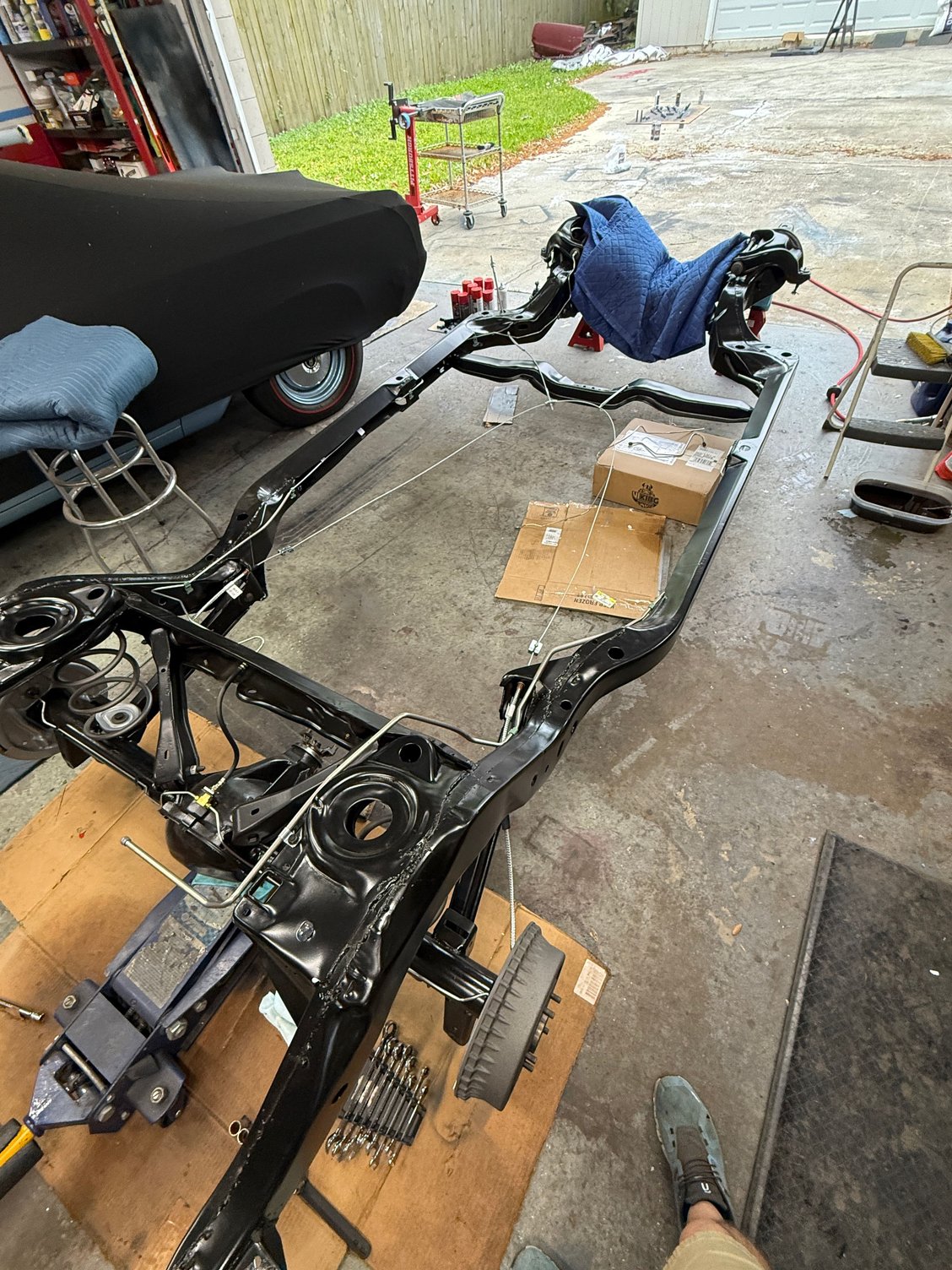

Picking up a little steam.

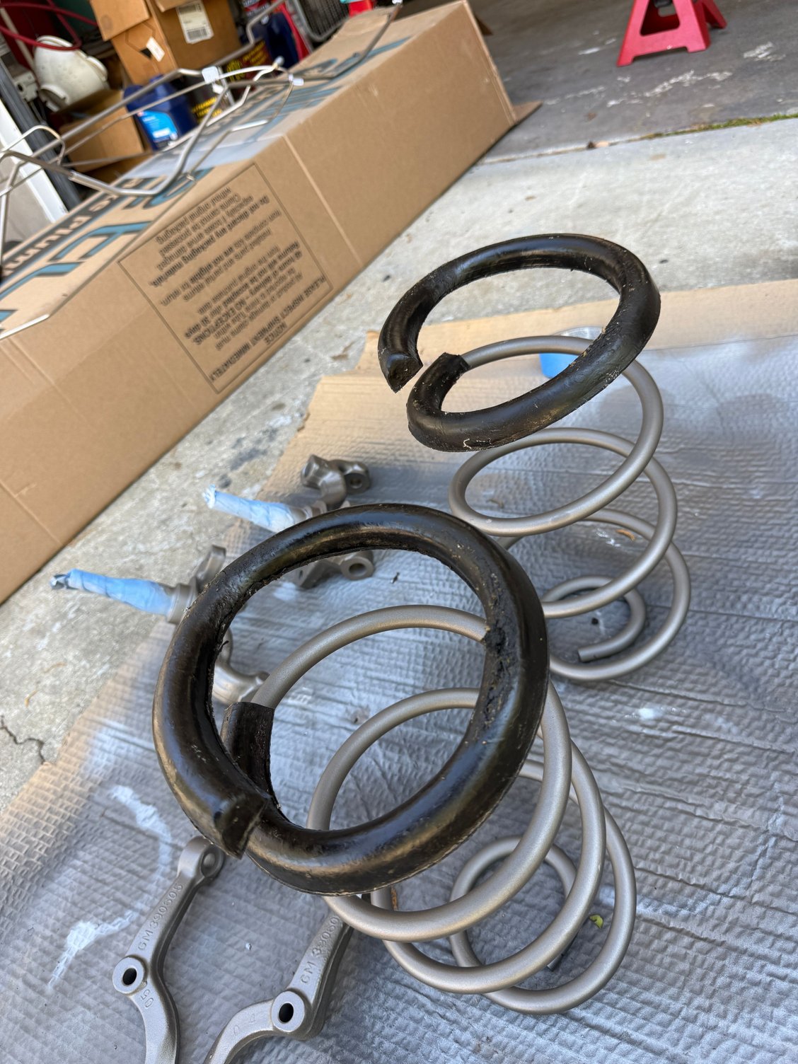

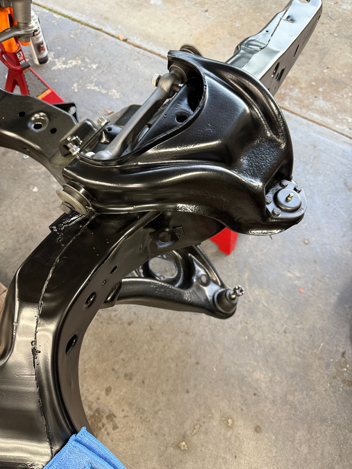

Just plugging away, painting, LCA's, springs, A-arms...

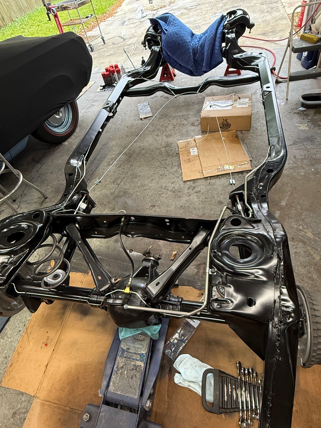

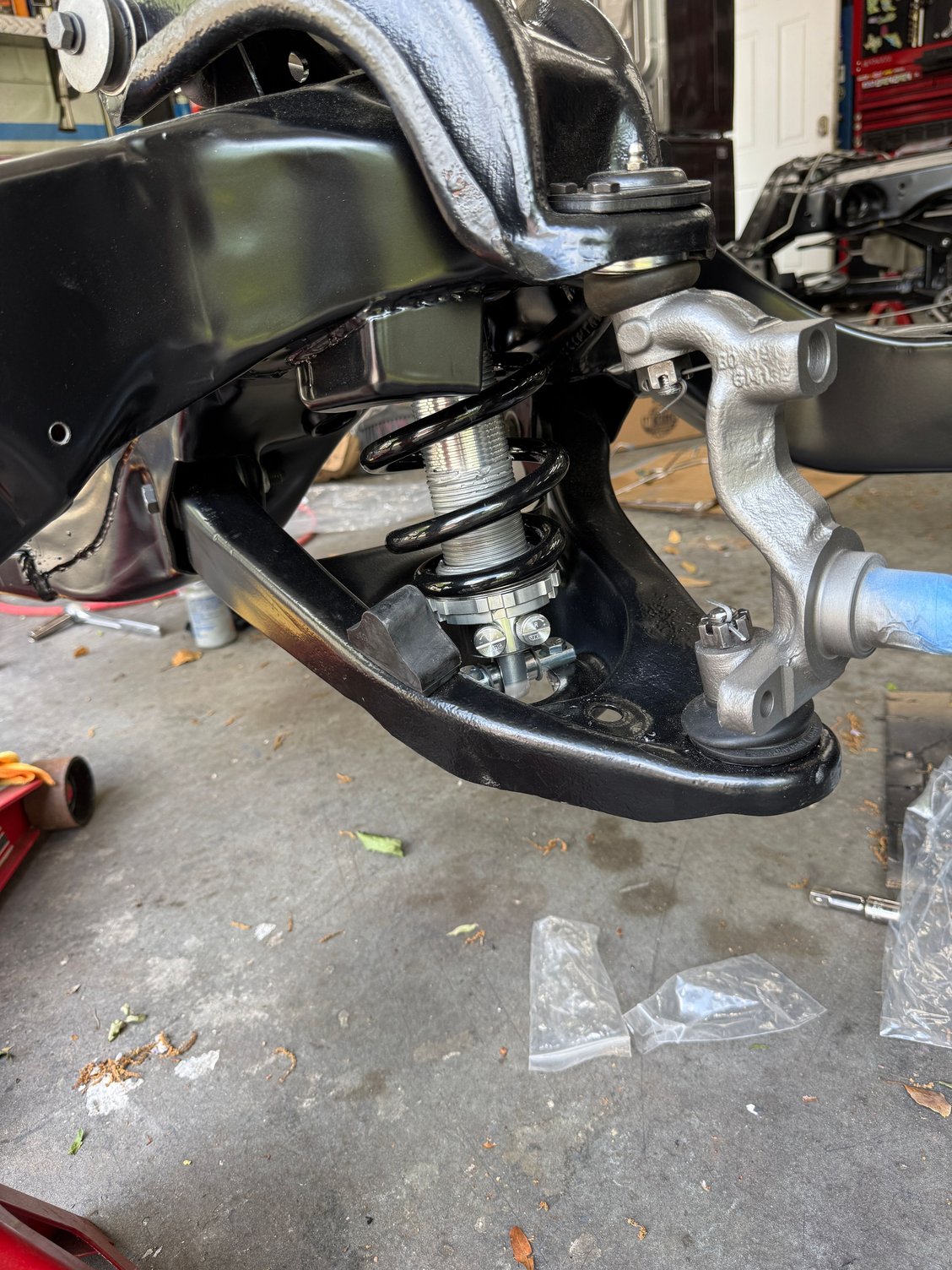

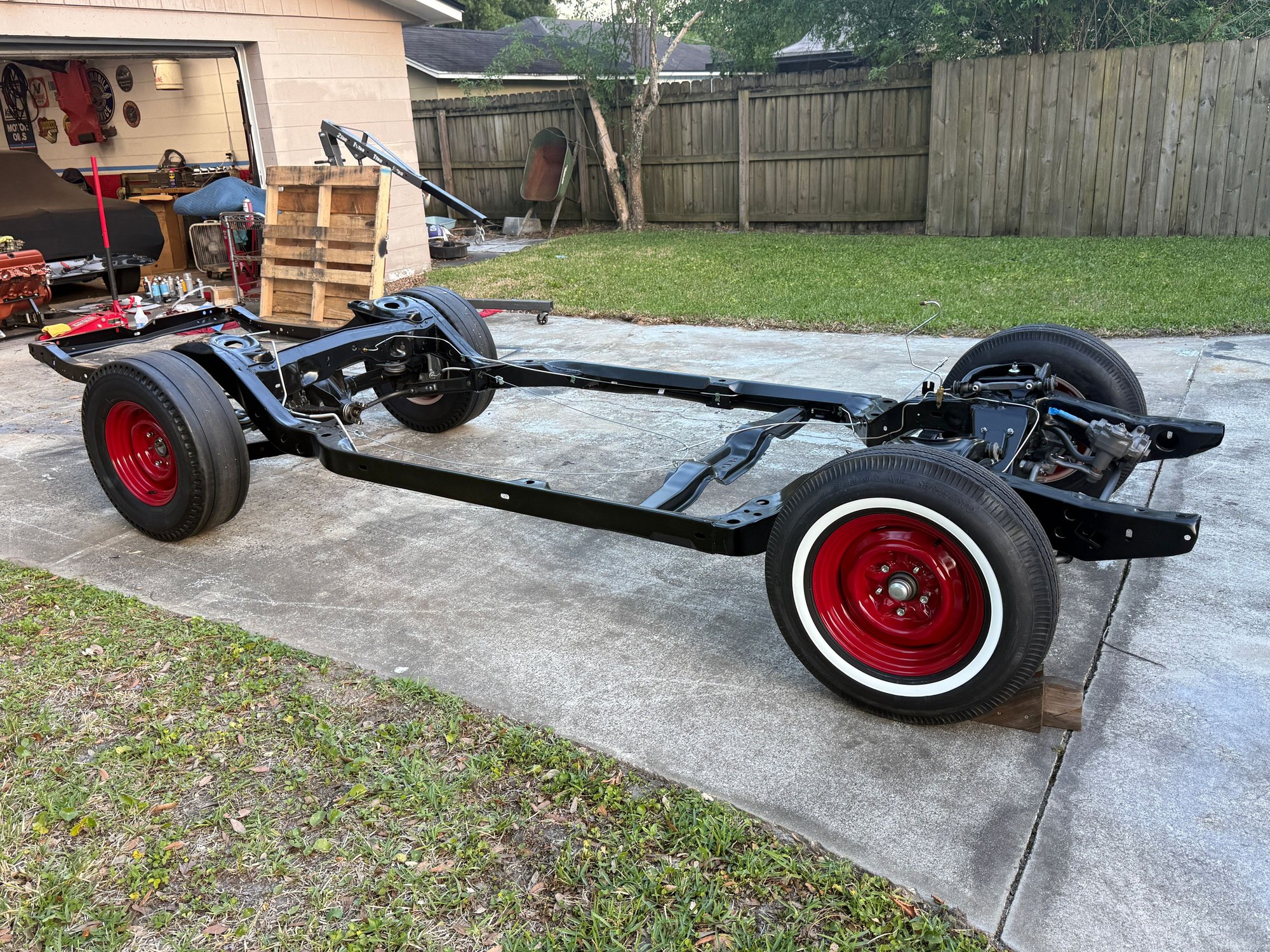

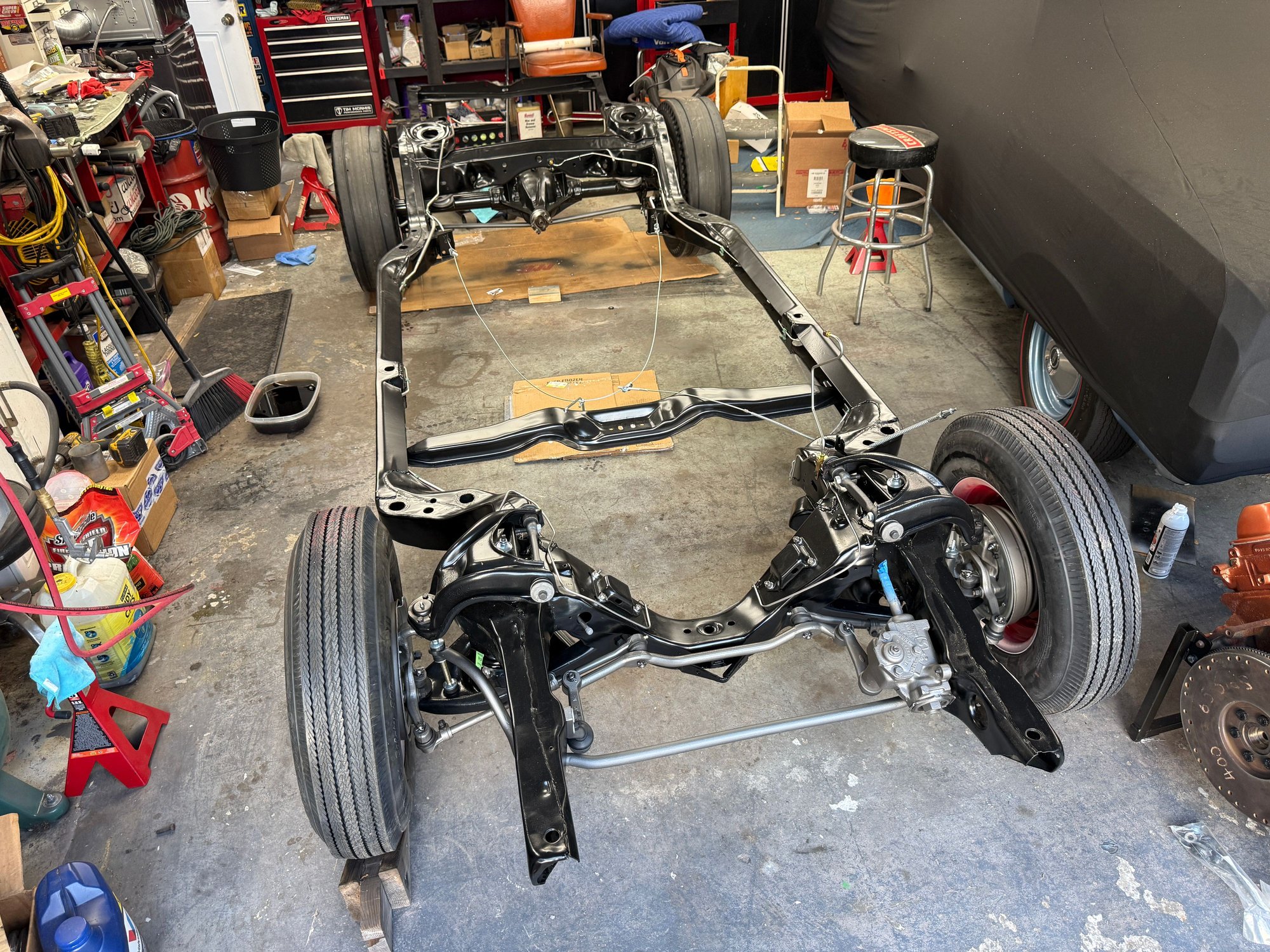

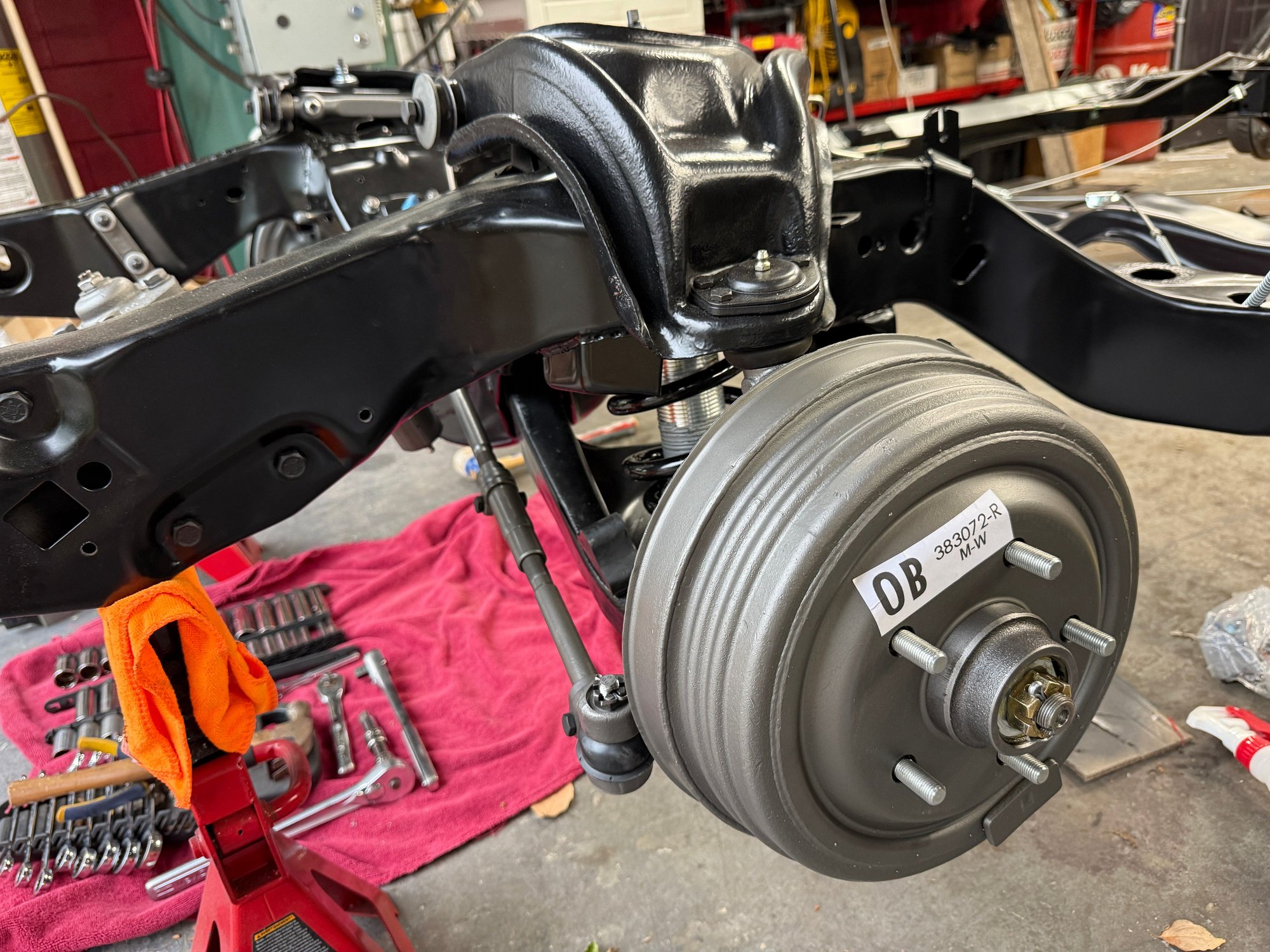

Fuel, lines, brake lines, e-brake cables, spindles, and coil overs bolted up
you really forget how expensive it is to complete the chassis until you do it again.
Old Mar 31, 2026 | 01:43 AM
  #59
Posts: 5,592

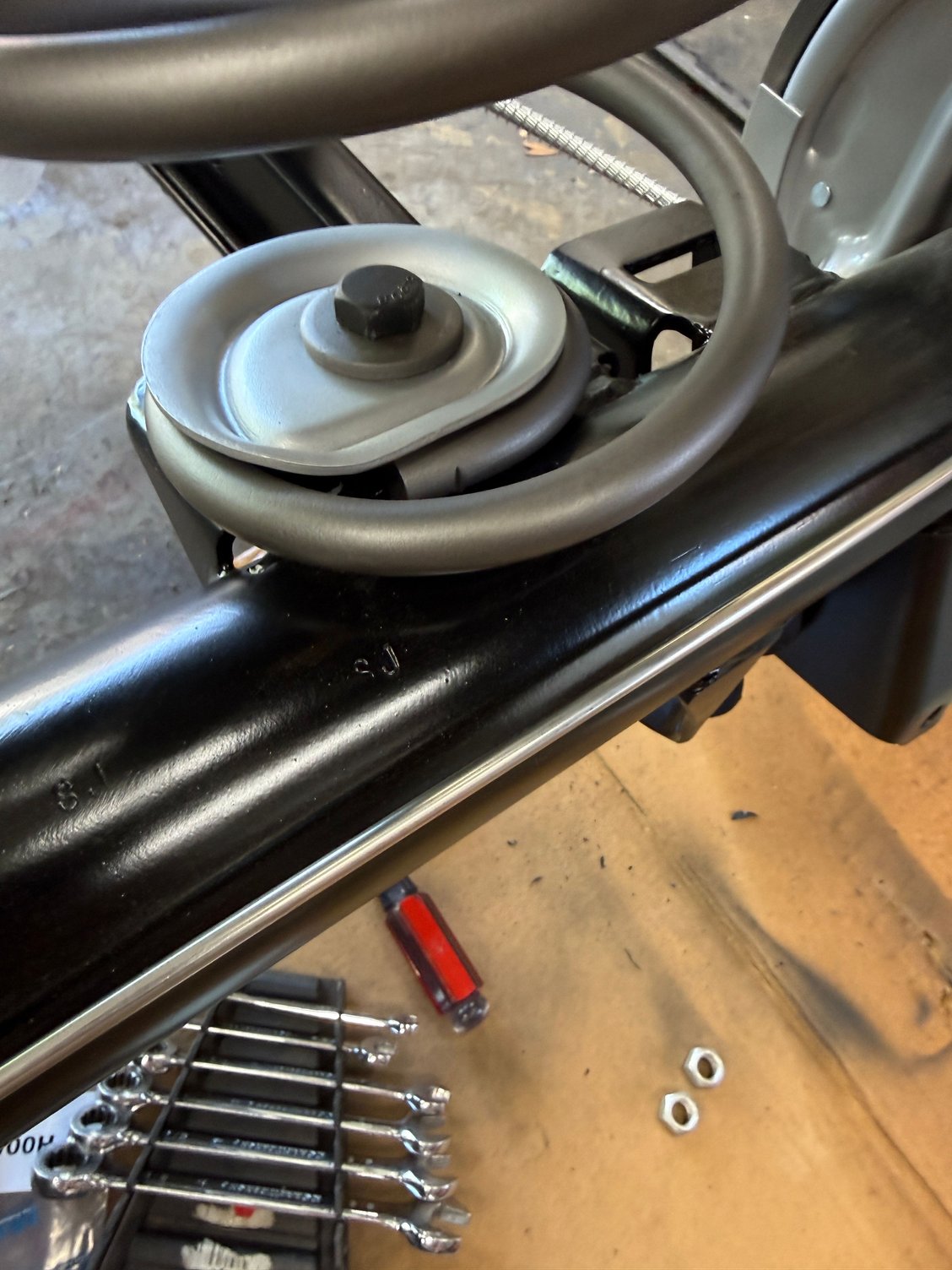

Pete, I'm really curious about those front "shocks". Looks like a type of coil over and attached to the top of the lower shock mount holes? Does all the weight of the car push on those holes, instead of the spring pocket? I've never seen anything like that. Interesting. Great job you're doing!
Old Mar 31, 2026 | 04:28 AM
  #60
Rallye469's Avatar
Joined: Feb 2008
Posts: 2,669
From: Jacksonville, FL
Yep. They’re basic coil overs. The bottom bar spreads the weight out past just the shock mounting tabs a bit, but they don’t use the lower spring perch.
Ive used them on 3 builds so far(including the race car for about 10 years) with no problems yet!

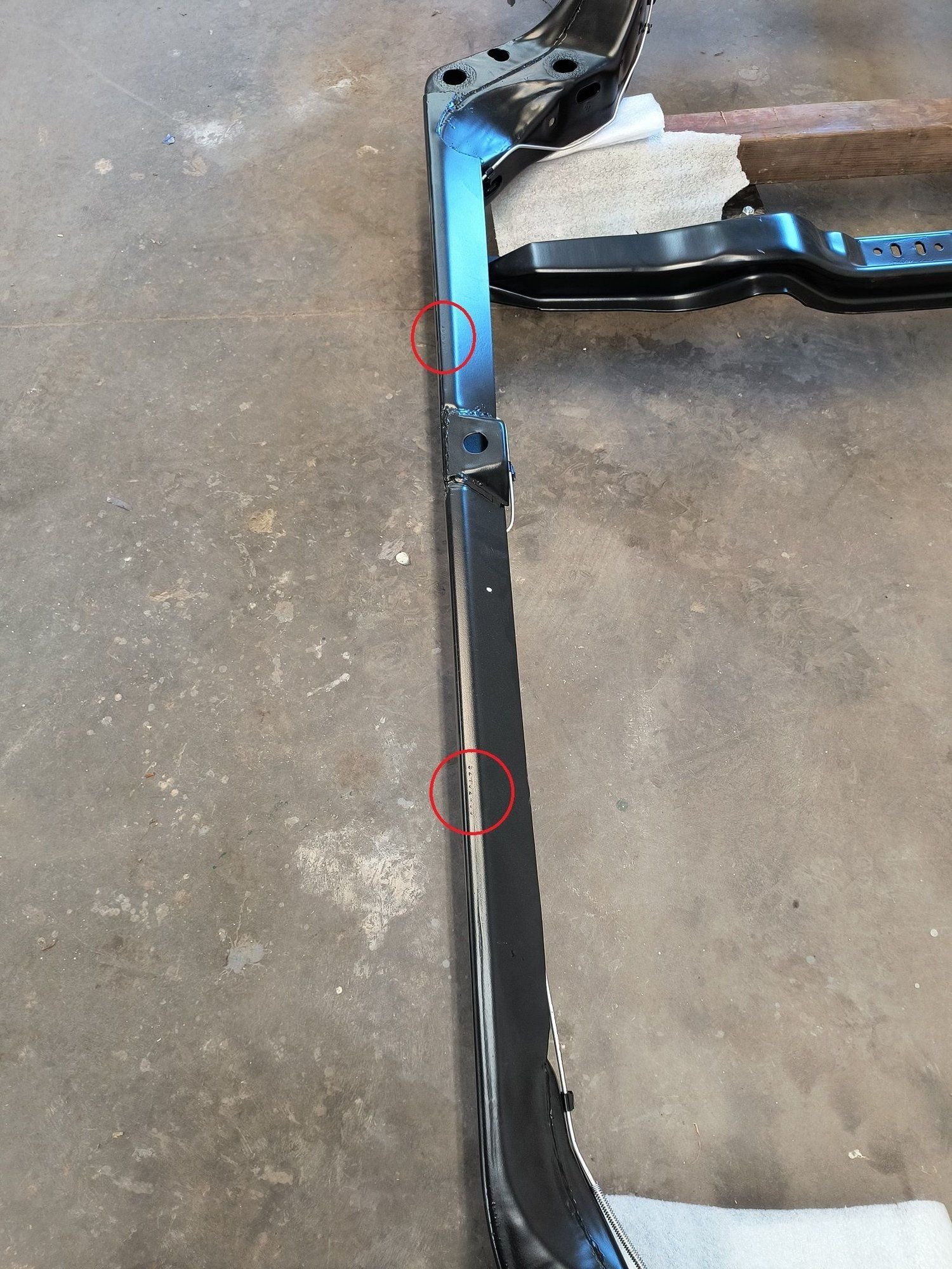

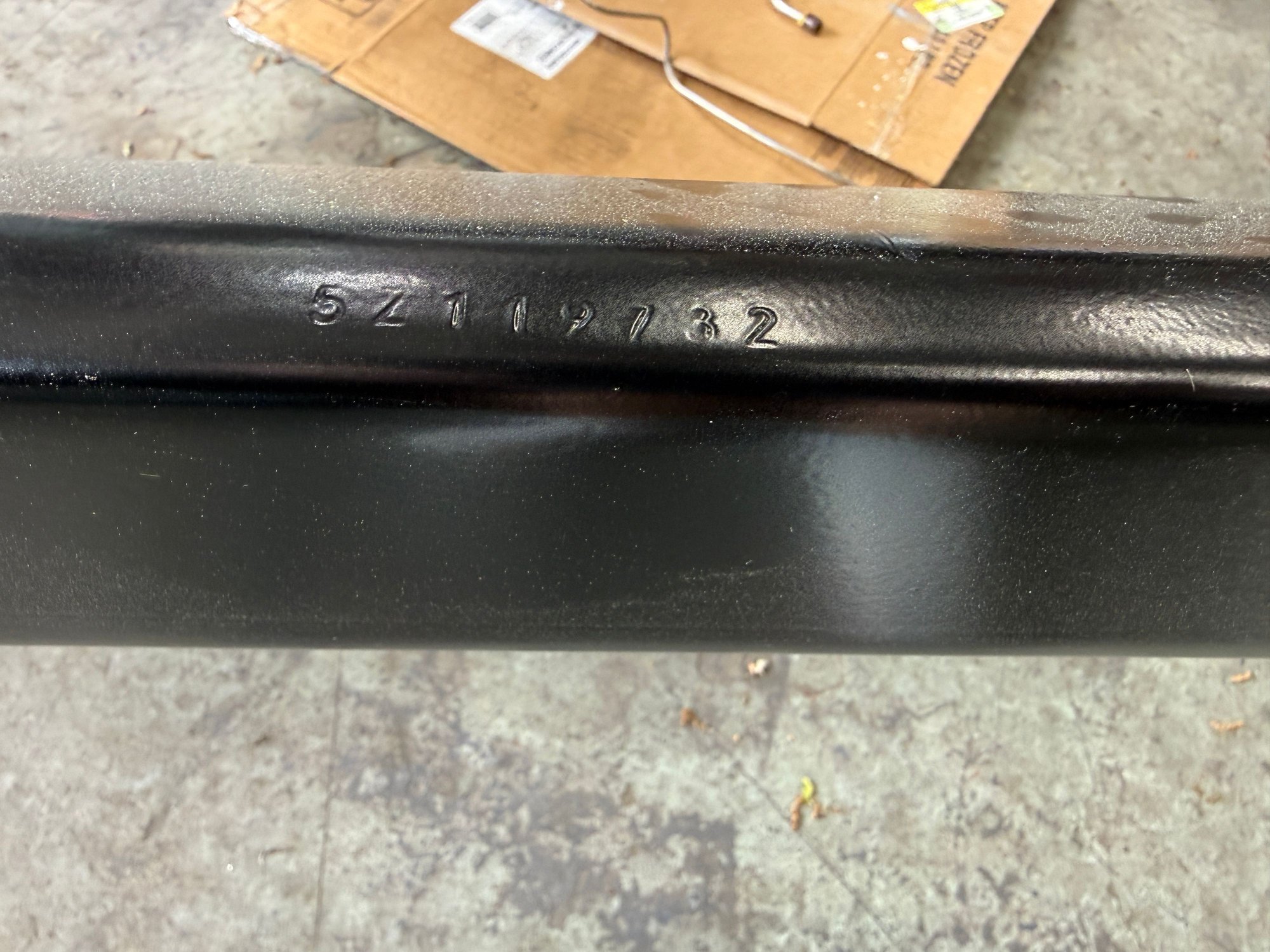

A buddy came over and pointed out where to look for the VIN on the frame...and there it was
It's also a cool reference for how Fremont prestamped there VIN tags.
They knew they were going to make an Olds (3) with the # 5Z119732... but they didn't know what it would be a Club Coupe (3427) until it went on the car.
Old Apr 2, 2026 | 09:43 AM
  #63
1965CutlassGuy's Avatar
9 thats what I mean 11
Joined: Nov 2023
Posts: 211
From: Oregon
you might look and see if yours was stamped in two places like mine.
one on the drivers side in front of the #3 body mount and one between the #3 body mount and #4 body mount on drivers side
both on the flat spot on top.

So both on drivers side?
I'll check

Yes, both on drivers side.
here is where they were on mine.

Frame looks great man!
I’ll have to look for the 2nd one.

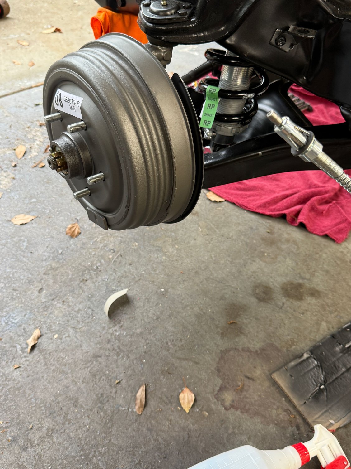

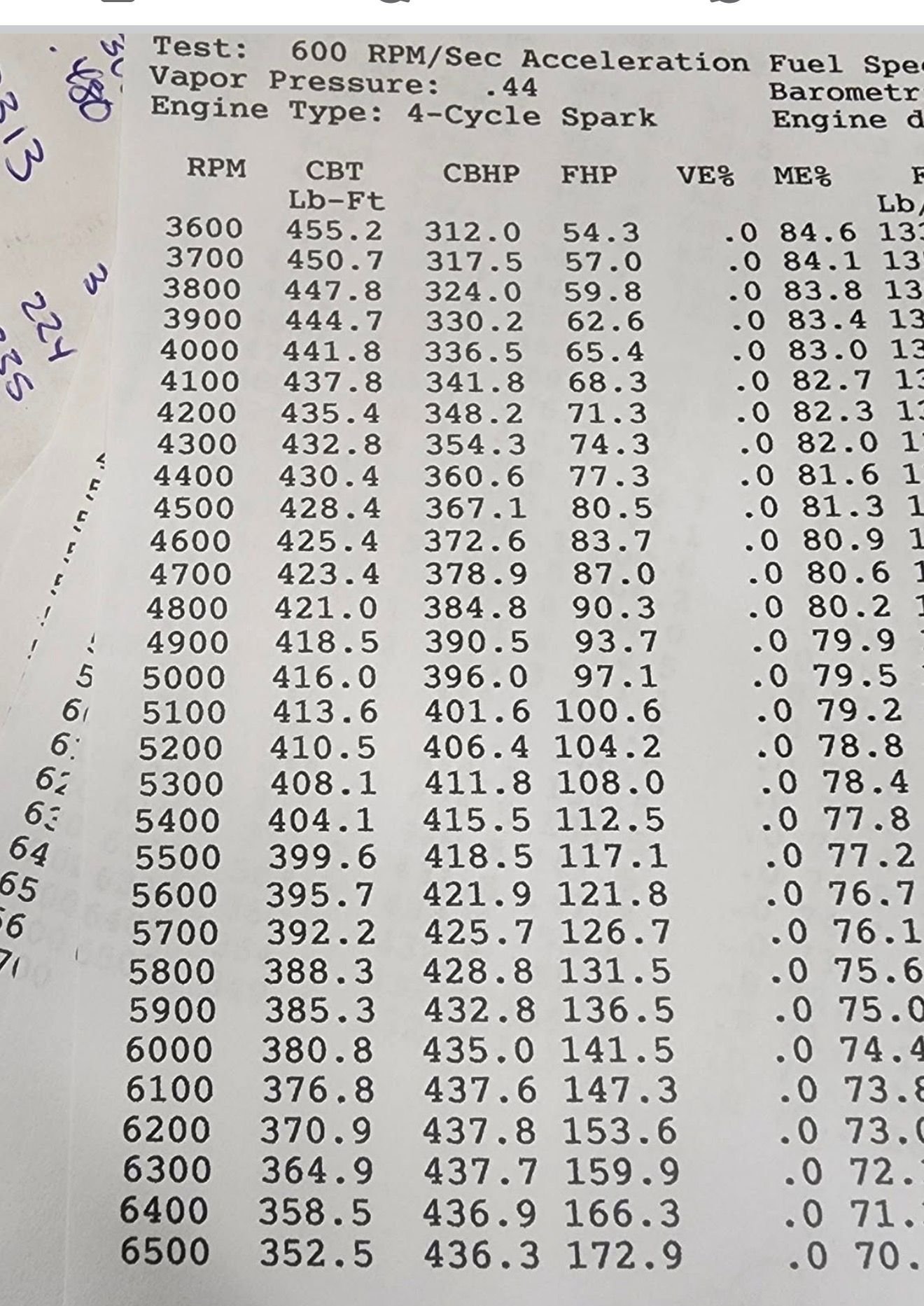

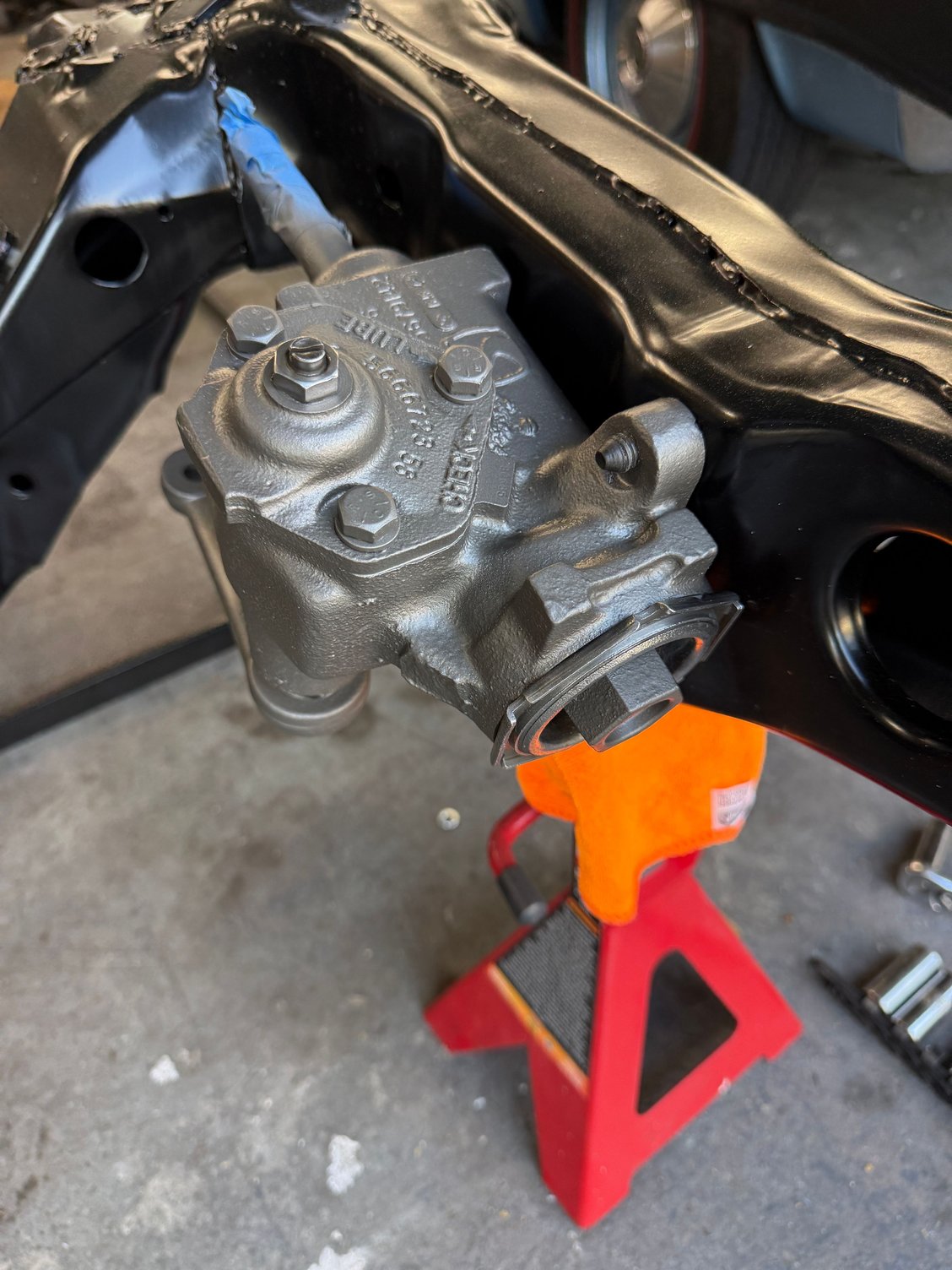

Just a little more work on rakes and hubs…
‘also, my engine got to the dyno!
very pleased.
‘Original ‘65 400.

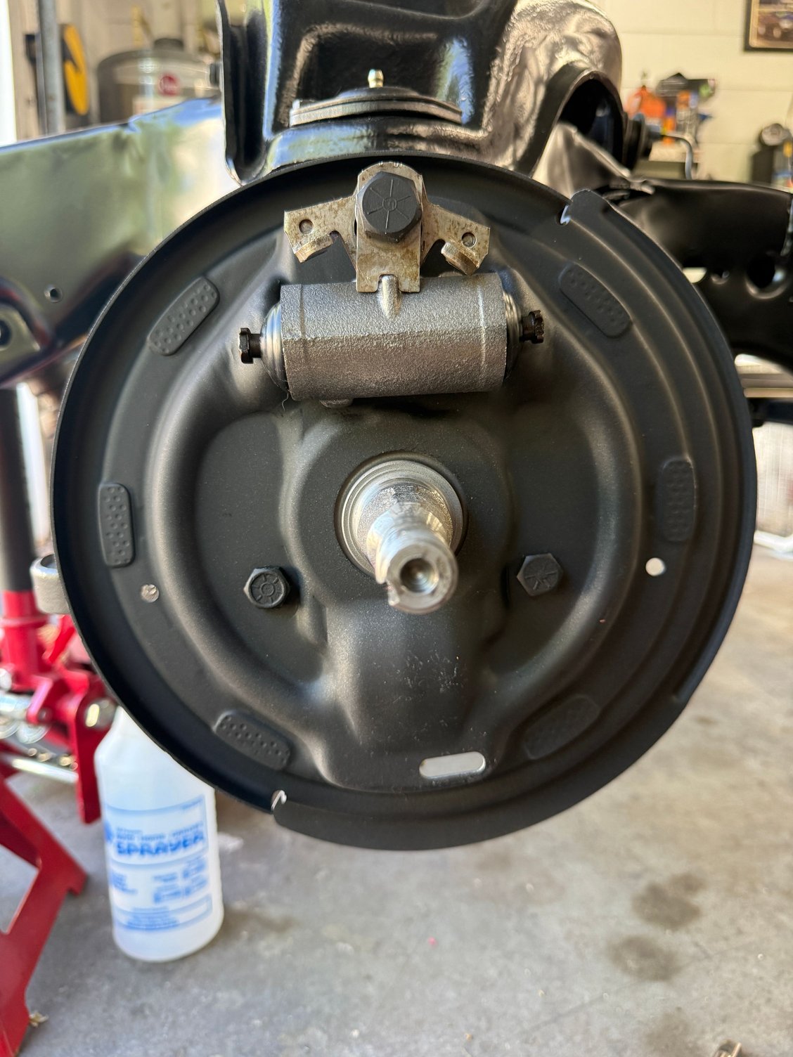

My buddy, also dropped off some decals for that 999 pt look…
‘Front end is done. Just a few things and it gets wheel and tires and I can roll it out.
NOS dust caps are on their way

Great work. What did you change to get that much hp and torque?
Old Apr 9, 2026 | 04:47 AM
  #73
Rallye469's Avatar
Joined: Feb 2008
Posts: 2,669
You’d have to ask Travato for the complete details, but the cam is in the .580’s with a modest duration.
He didn’t do much porting or anything, just cleaned everything up.
very pleased.
‘Original ‘65 400.
Respectable power and torque.
Refresh my memory..........B block ? Flat tappet ? Rochester 4 GC ?
Old Apr 9, 2026 | 08:10 AM
  #75
66-3X2 442's Avatar
Posts: 5,200
From: Birmingham,Alabama
It's got one of my tri carb units on it.
Old Apr 9, 2026 | 11:20 AM
  #76
Rallye469's Avatar
Joined: Feb 2008
Posts: 2,669
B Block, A heads, Solid Roller, with one of Mike's Tri Carb works of art... but nothing crazy with the build.

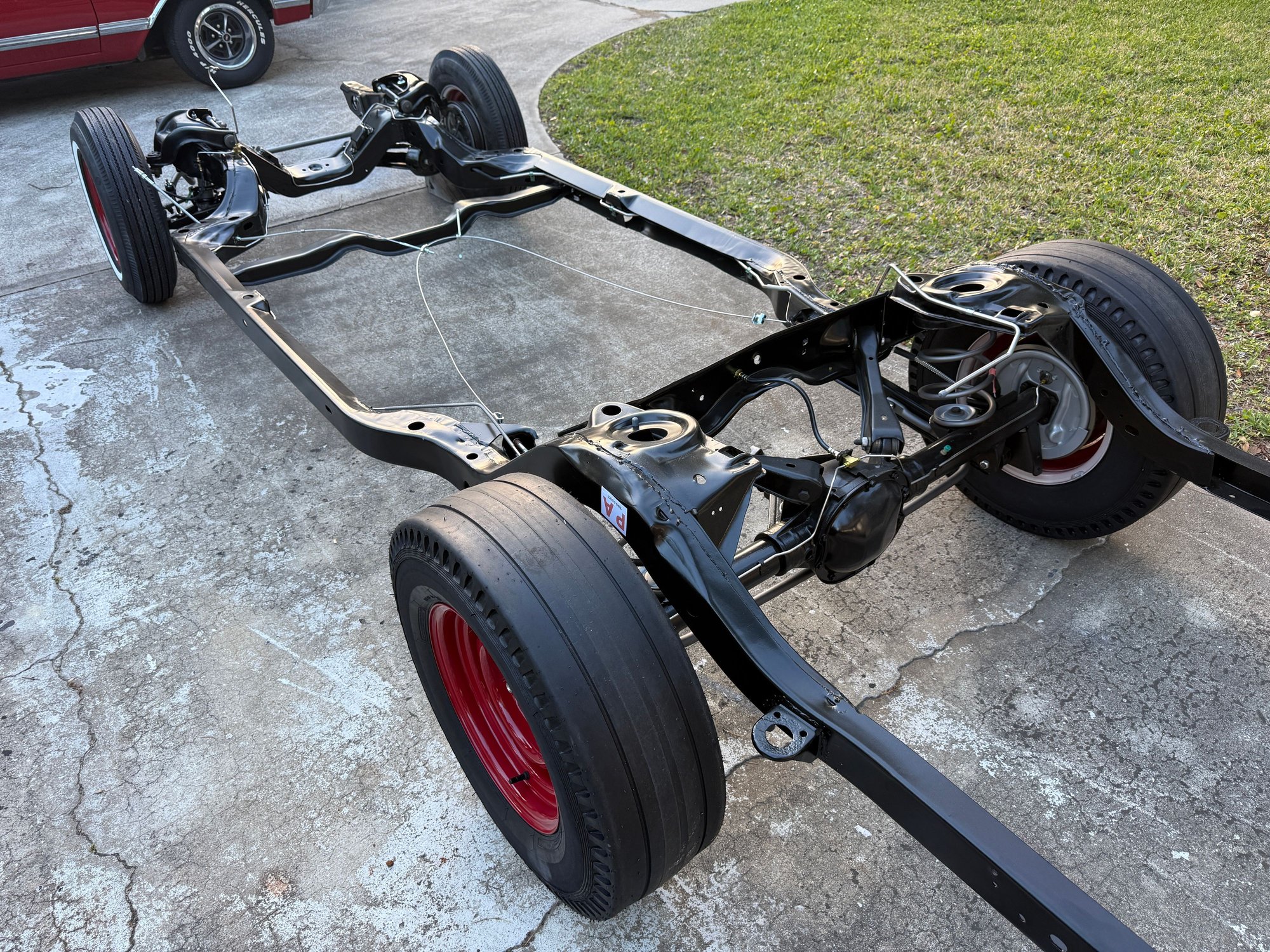

I think the frame can be considered done.
