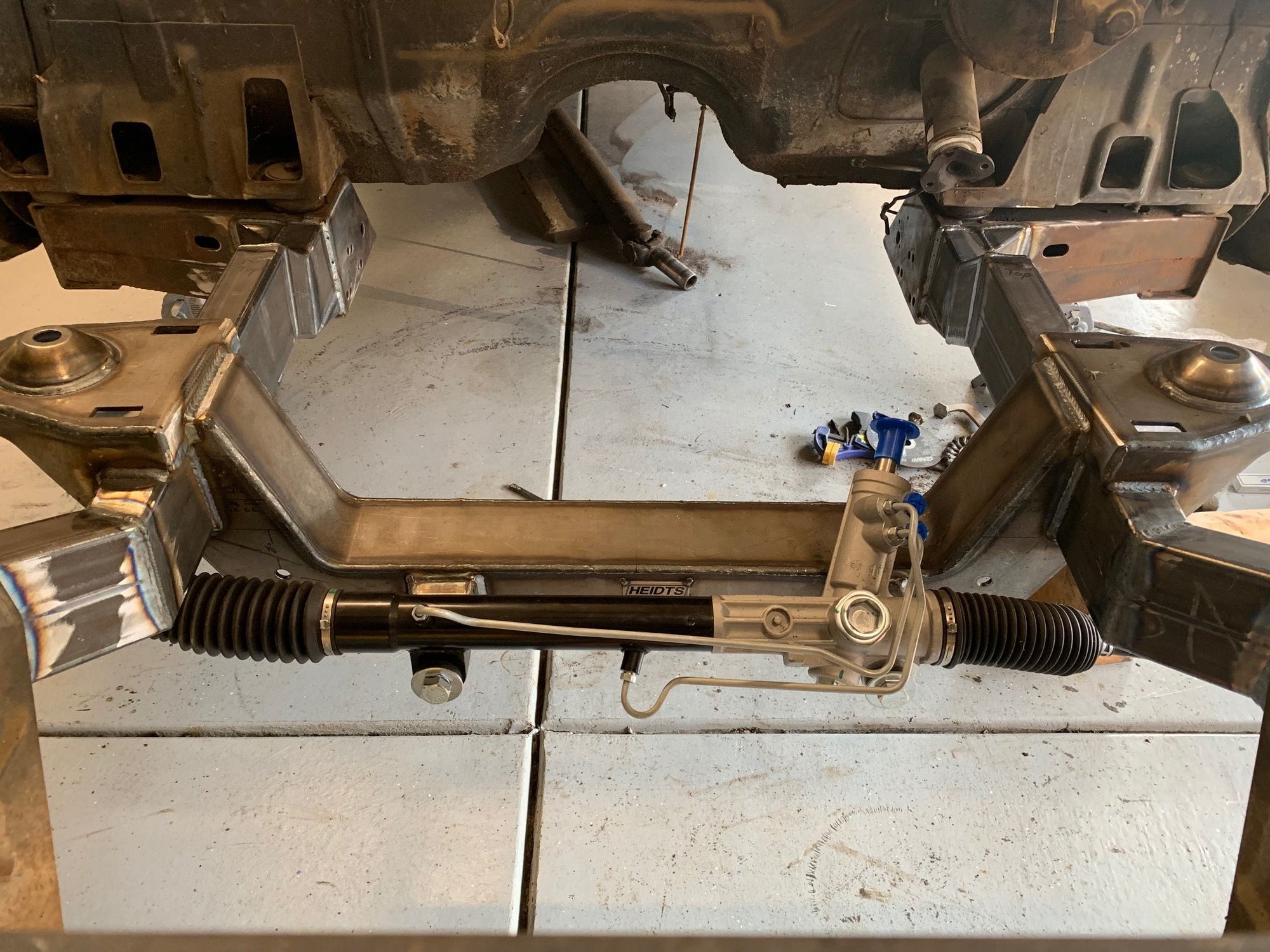

Ended up buying a kit from POL meant for putting a mustang 2 front suspension setup under a 55-59 chevy pickup. This retained the 5x5 lug pattern, kept a comparable track width and was rated for a big block in a chevy pickup. All I had to do was design the frame rails so they would fit the original frame nicely, accept the supplied crossmember width easily and then meet the front clip to accept the factory bumper brackets and come really close to using the factory front body mounts. I ended up whipping together some custom front mount brackets but they will prob get re done. The power rack and pinion sits a bit high over the crossmember so I'm currently fighting the overall height of the engine/trans trying to get it as low as possibly and as far back as i can. So far so good.

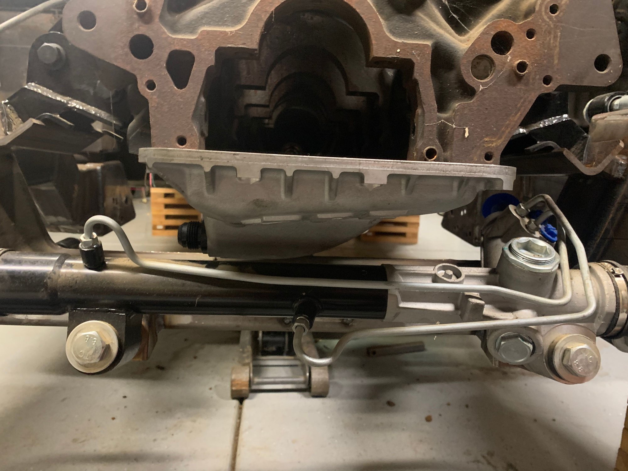

Lost the smallest bit of oil capacity to gain 1.25'' of room to lower the engine. Relocated the steering rack brackets down 1'' and lowered the control arm mounts accordingly. Also didn't realize that the drama engine had offset engine mounts so I built some relocation plates similar to the types used on ls swaps
Old Dec 1, 2021 | 04:24 AM
Bfg's Avatar
Bfg
Posts: 2,291
You most definitely have some talent there, anxious to see it completed!
Old Dec 1, 2021 | 04:28 AM
Posts: 5,584
Looks like great engineering! I'm watching, great job!
Old Dec 1, 2021 | 09:30 AM
Beautiful work. Those welds are sexy. 🔥

WOW! Don't know how I missed this thread but I am onboard now. Very impressive fabrication and swap, you will most likely have the only 64 Jetstar with these mods!

Man, you can lay down some bead!

No lie. Some perfect cuts and sexy welding. Very impressive.

So interesting to follow & watch. You have a thing for clean mods! They look straight as an arrow... Ransom E. is smiling down at you.

Awesome work, and a very cool project... Did you have any problems with the oil pan cracking as it cooled down from welding?

None whatsoever, it actually went fairly easily. I wasn't worried about trying it because I have another so i just grabbed the first filler rod out of my cart and laid into it. Honestly couldn't even tell you what alloy I used.

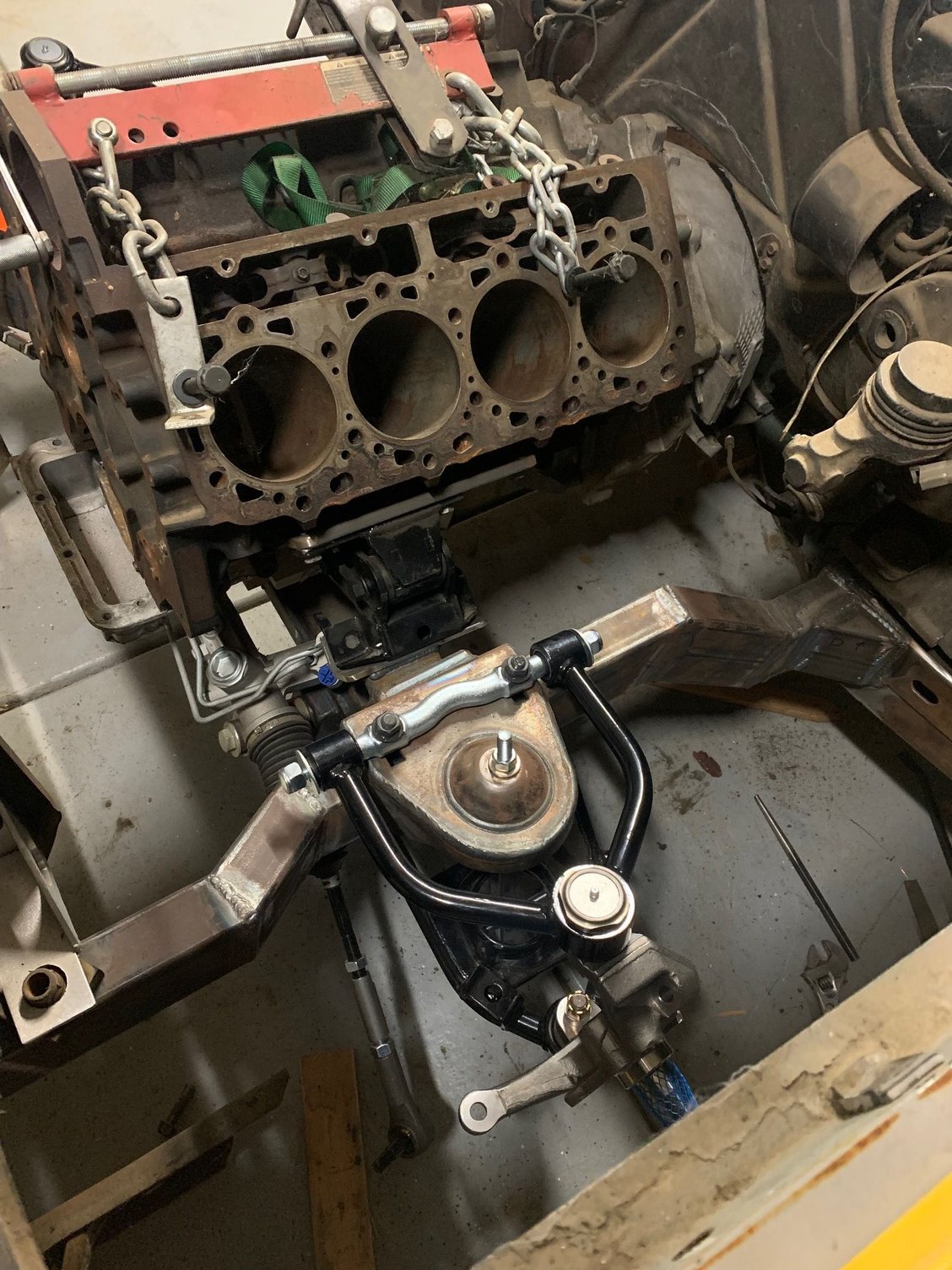

Couple updates. Been very busy for a while but trying to get stuff done here and there.
Engine mounts finally mocked up and started welding
Mustang 2 type front suspension hung
Few pics of the converter I had built to handle the torque.

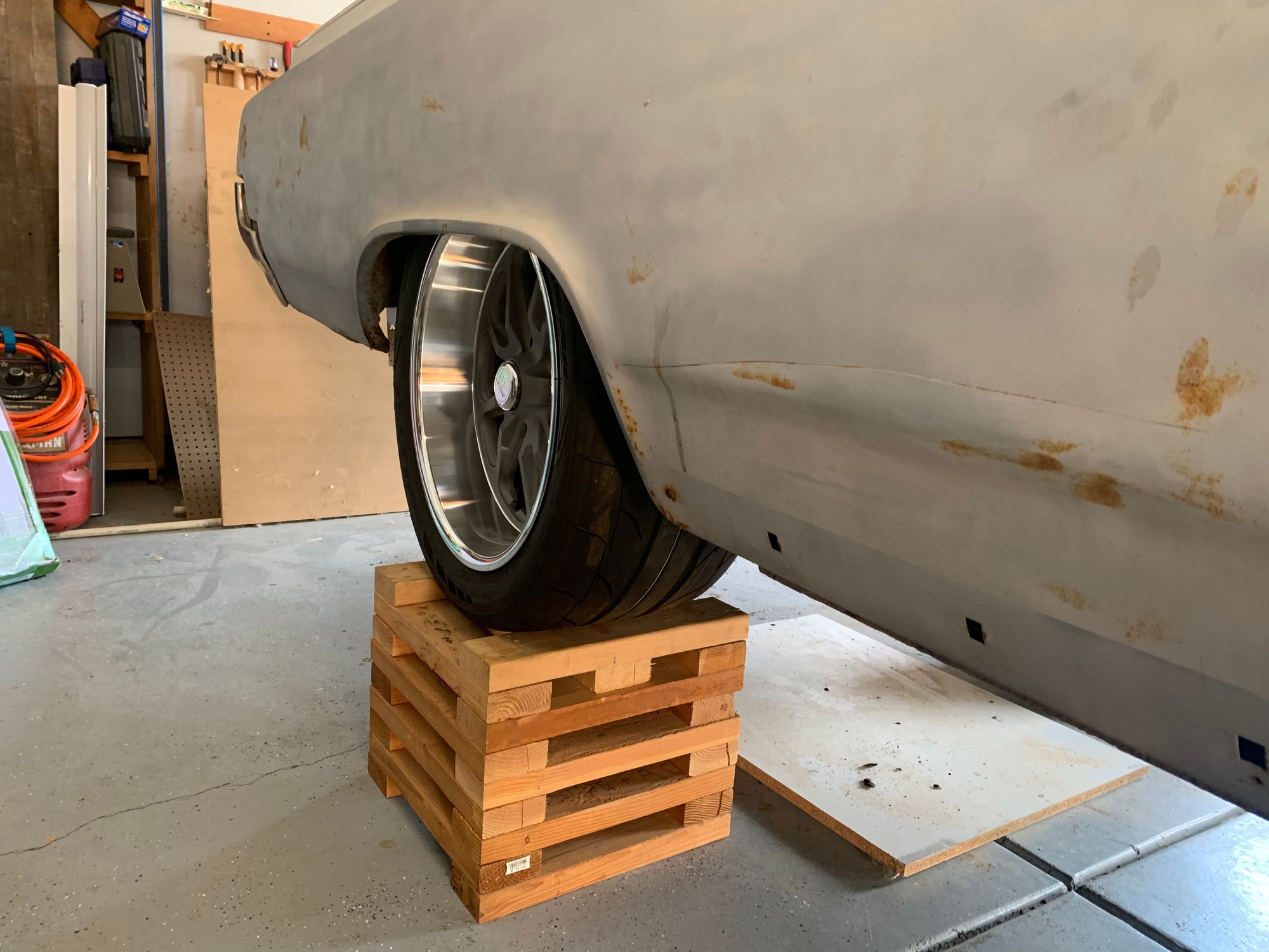

New shoes
18” US mags
285 rear fit well in factory wheel wells on a 9.5” wheel with 5.25” backspace
255 front on a 8” wheel with 4.5” backspace. (Custom front framerails)
New tires and wheels. U.S. mags u111 rambler with nitto nt 555 g2 front tires in 255/45r18 and nitto nt 555 r2 285/40r18 in the rear. This is at ride height

Scored almost everything I need for the dry sump oiling So now that oil pan I built is unnecessary. Didn’t really gain much clearance over the crossmember but damn if it won’t look cool as hell.

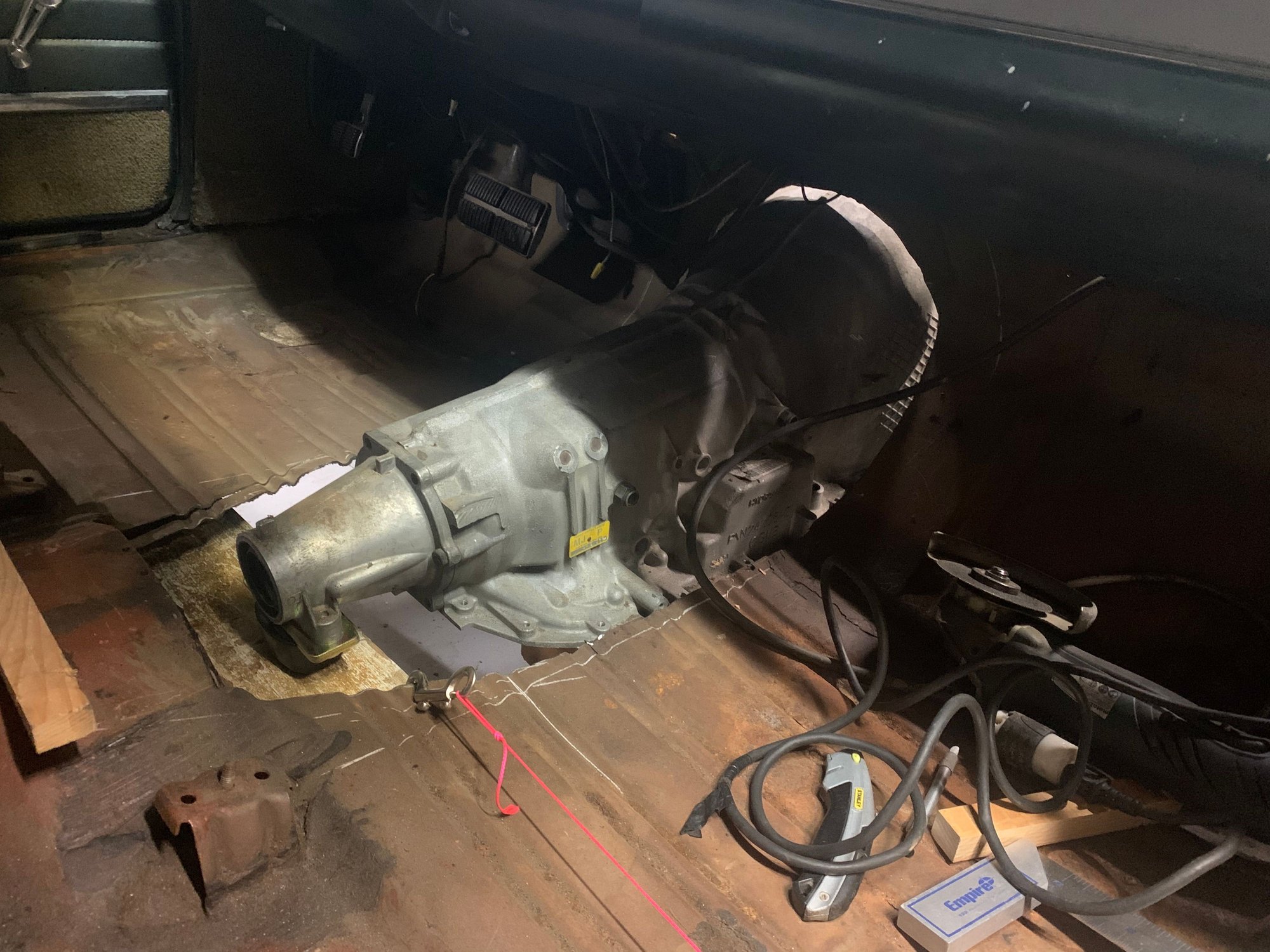

Pic dump
Finally tearing into the engine.

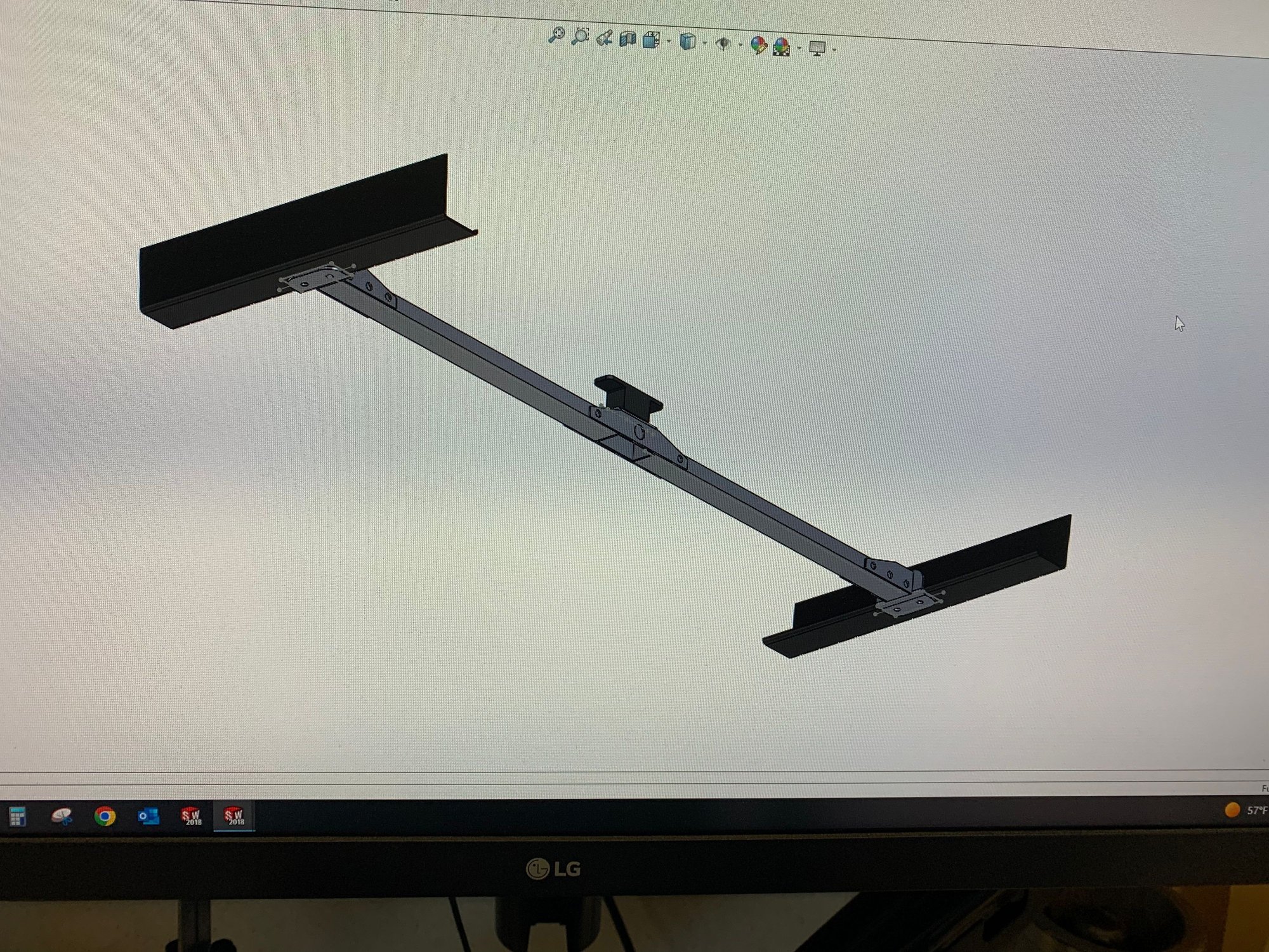

Designed a crossmember for the 4l80
Got the trans crossmember in and hate it. Will prob change it but it’s a good placeholder for now
Fit up the dry sump pan and found out I actually lost a little clearance… no turning back
Entire trans tunnel and most of the factory driveshaft tunnel will come out.
