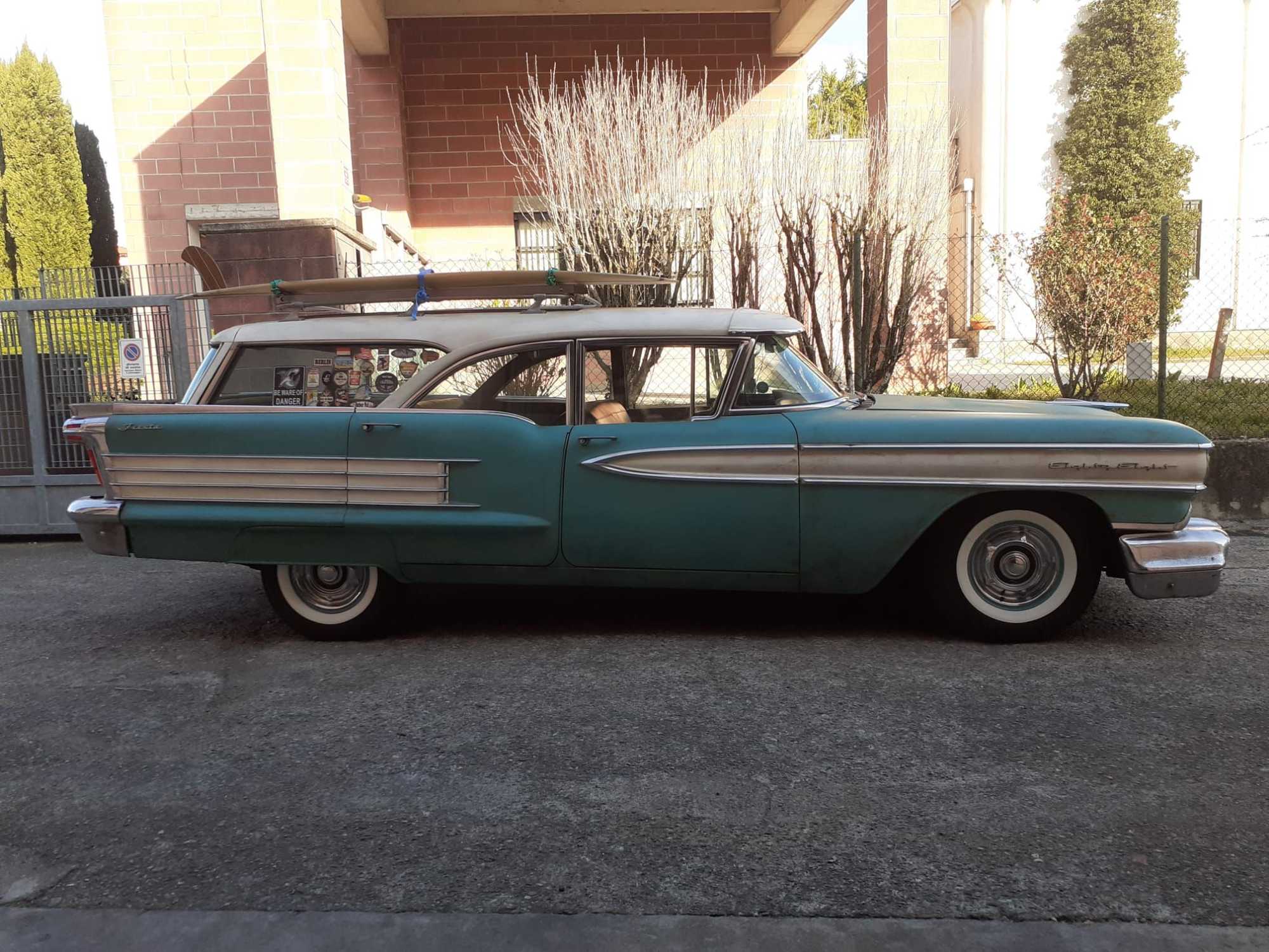

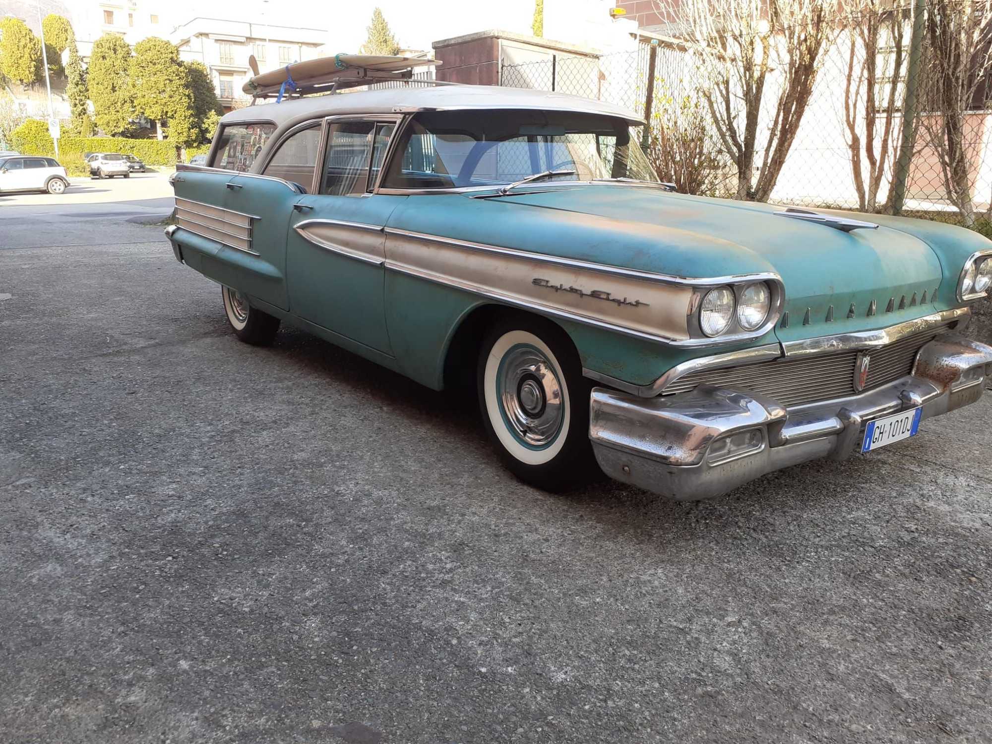

1958 Oldsmobile Dynamic 88 Fiesta Sedan
Good morning, Mirko from Italy. Buy this car from my italian friend. Want restore engine and mechanic, restore body but no totally repaint. Can send me some seller to buy mechanic complete kit? Brake, front/rear end kit? Thanks to all.

Welcome to CO. Thats a rare car. I have only seen one in my whole life. That would be a nice car when painted.
Old Dec 7, 2019 | 06:40 AM
As I get older I appreciate these cars more and more. Looks like a great project.

Sure looks like a post inside to me.
You know, I didn't look that close. It does look like a post car so it wouldn't be a Holiday. I think you're right. I like post cars because the doors sound better when they shut and the windows work better. On a daily driver I vastly prefer a post car. For a show car I prefer a hardtop. Like I said, these post wagons seem to be pretty rare these days. My books say they sold 3249 Dynamic post wagons like this and 3323 Dynamic Holidays and 5175 Super Holidays, there were no Super 88 post wagons so even back in the day they were more rare.

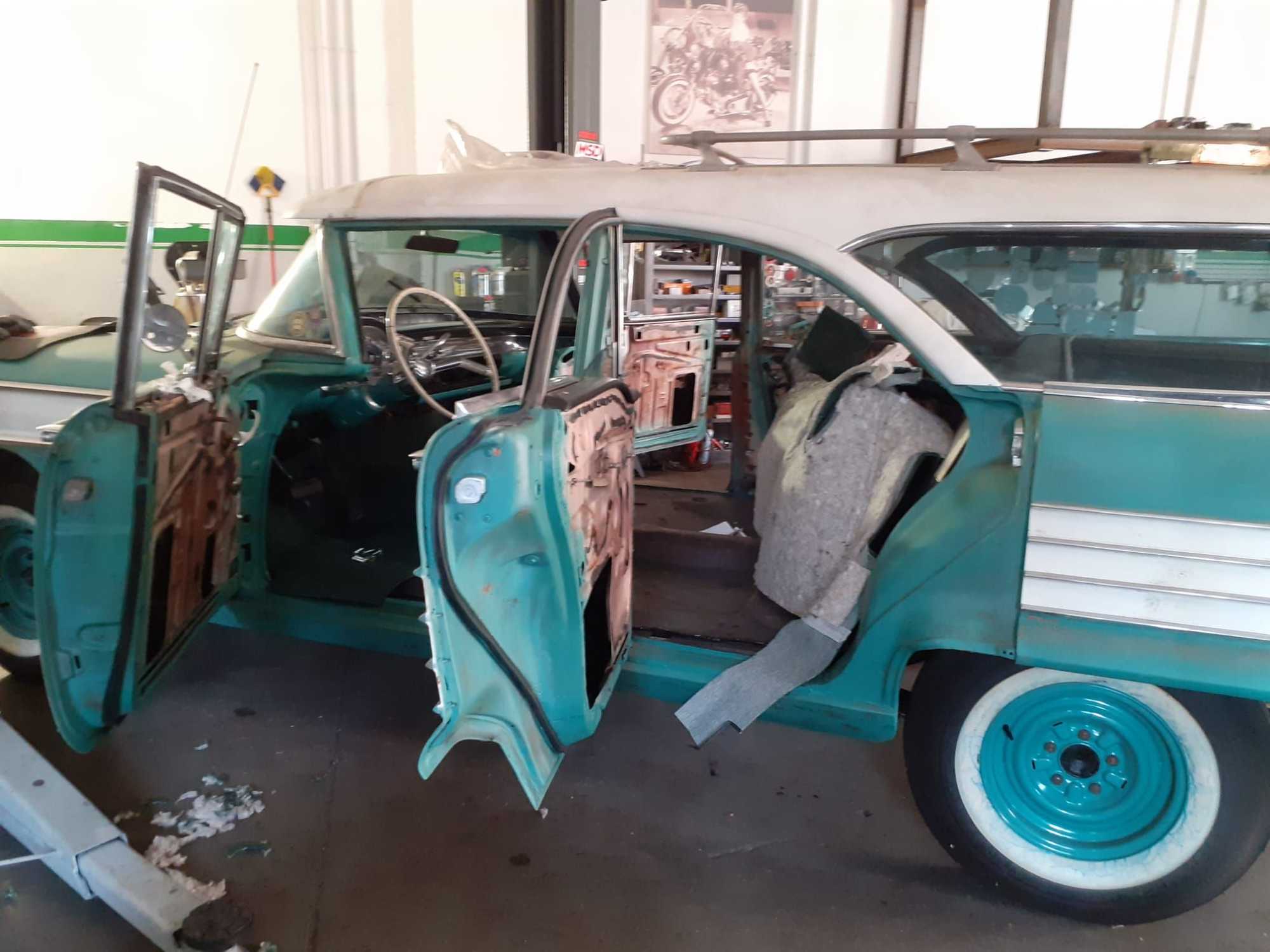

Here are great examples of the differences between a "post" car (sometimes referred to as a sedan) and hardtop. There is also a 2 door sedan or a 2 door hardtop. Hardtops in Oldsmobile jargon are referred to as "Holiday" hardtop. Sedans (with visible support) are sometimes called "Sport Coupe".
When front and rear windows on the same side are in a lowered position, no vertical support post is visible. This is called a "Holiday" hardtop. As is shown in the picture below.
This is an example of what a "post" car looks like when both windows are lowered on the same side. There is a vertical support structure visible. See the picture below.

It's just a nick name, or slang term for a sedan body type vs. a hardtop body type. It refers to the B pillar that is between the front door and the rear door. Somebody, somewhere started calling that pillar a post and it stuck. Now people will often refer to a non-hardtop as a "post car".

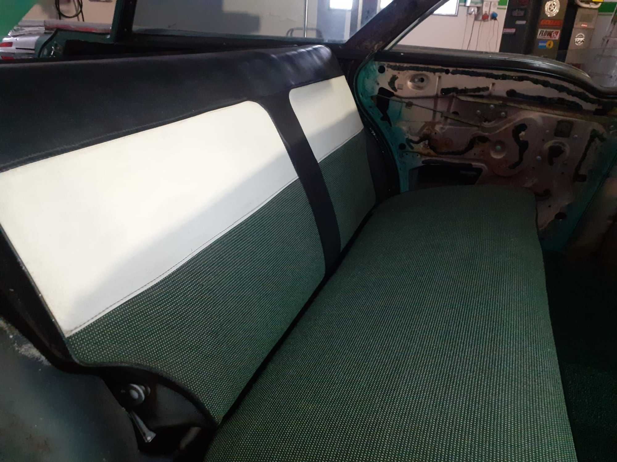

SMS fabrics can supply original cloth and vinyl to re-upholster this car .
If the original upholstery matches what is on this page then the trim number was 367 ;
https://smsautofabrics.com/collectio...wagon+trim-367

I think your model number would be just 3693 with no "D" suffix. The D is for the Super 88. A long time ago the D stood for Deluxe. Your car is not a Super 88 because it is not a hardtop and the sedan, or "post" version of the wagon was only offered in the Dynamic 88 series. AT least this is what my books tell me.
From you pictures you posted, it looks to me that the body color of your car was originally Desert Glow, or number 65 on the chip chart, based on the inside of the driver's door and the door threshold. It looks like the right passenger door and the tailgate might have been Banff Blue, so they may be replacements from another car. I think the green on your car is not factory.
You'll have to do some automotive archeology on your car and get down under the top paint job to find out the true, original color of your car. Any area that does not bolt on, like the doors, or the hood for example, is a good place to look. So that means the door jams, the roof and the quarter panels are good places to get out your scraper, sandpaper, or a place to remove and look under trim. On a car like this one with so much trim, I bet whoever painted it last time just masked off the trim rather than remove it, so you may see the original paint under there.

The car looks like it could be 30 lower (surf green), but the upper is obviously WHITE. Allegheny Green is a pretty dark green.......not whats on the car.

And finally , here is some information on the interior trim ;

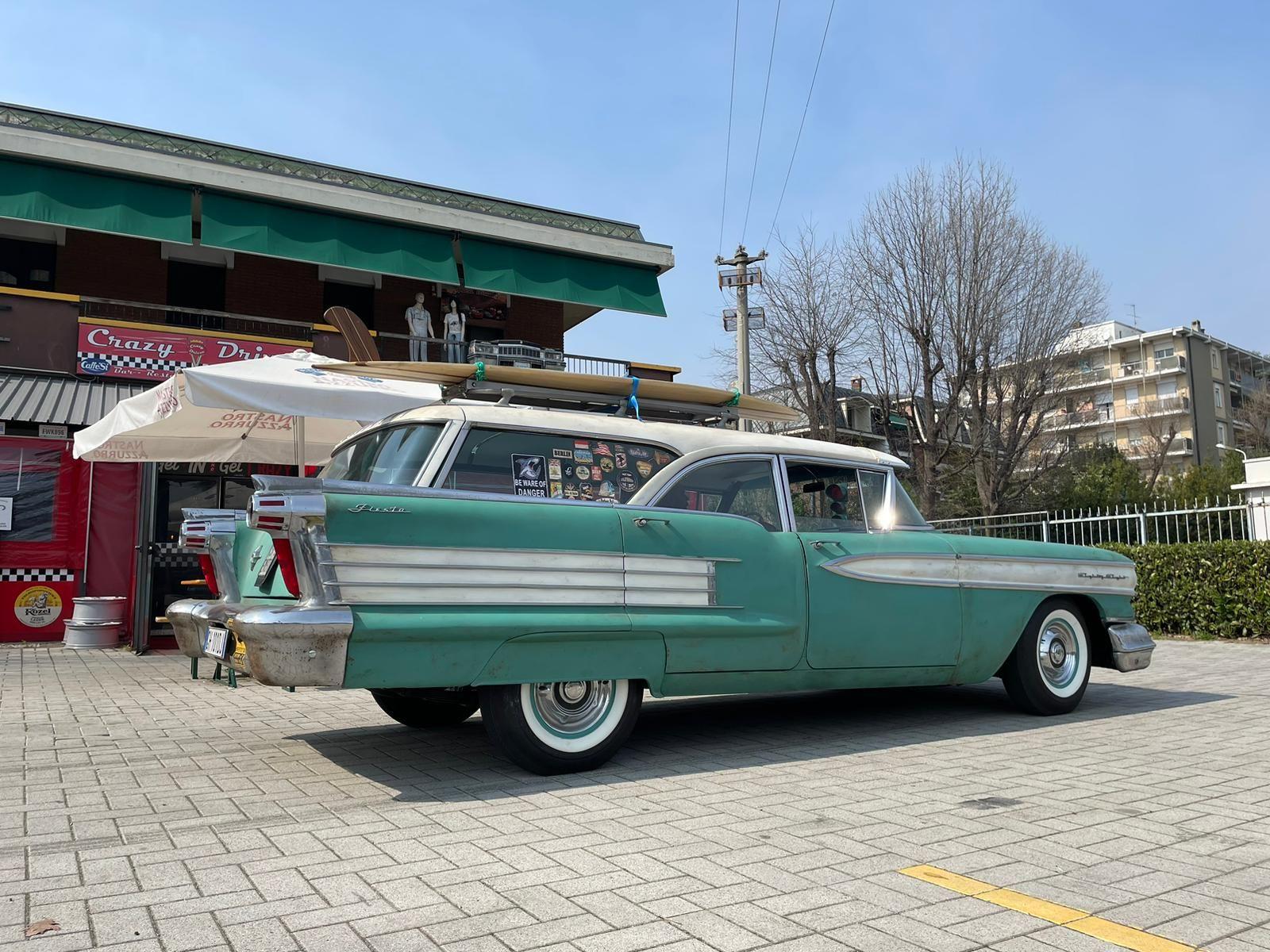

Car is going to be AWESOME!! Do you plan to leave it flat, or spray it with clear once you are done?
Old Feb 27, 2021 | 09:19 PM
Posts: 12,798
Big progress.
Old Mar 15, 2021 | 03:20 PM
Looking great!! Great job. What a cool car.

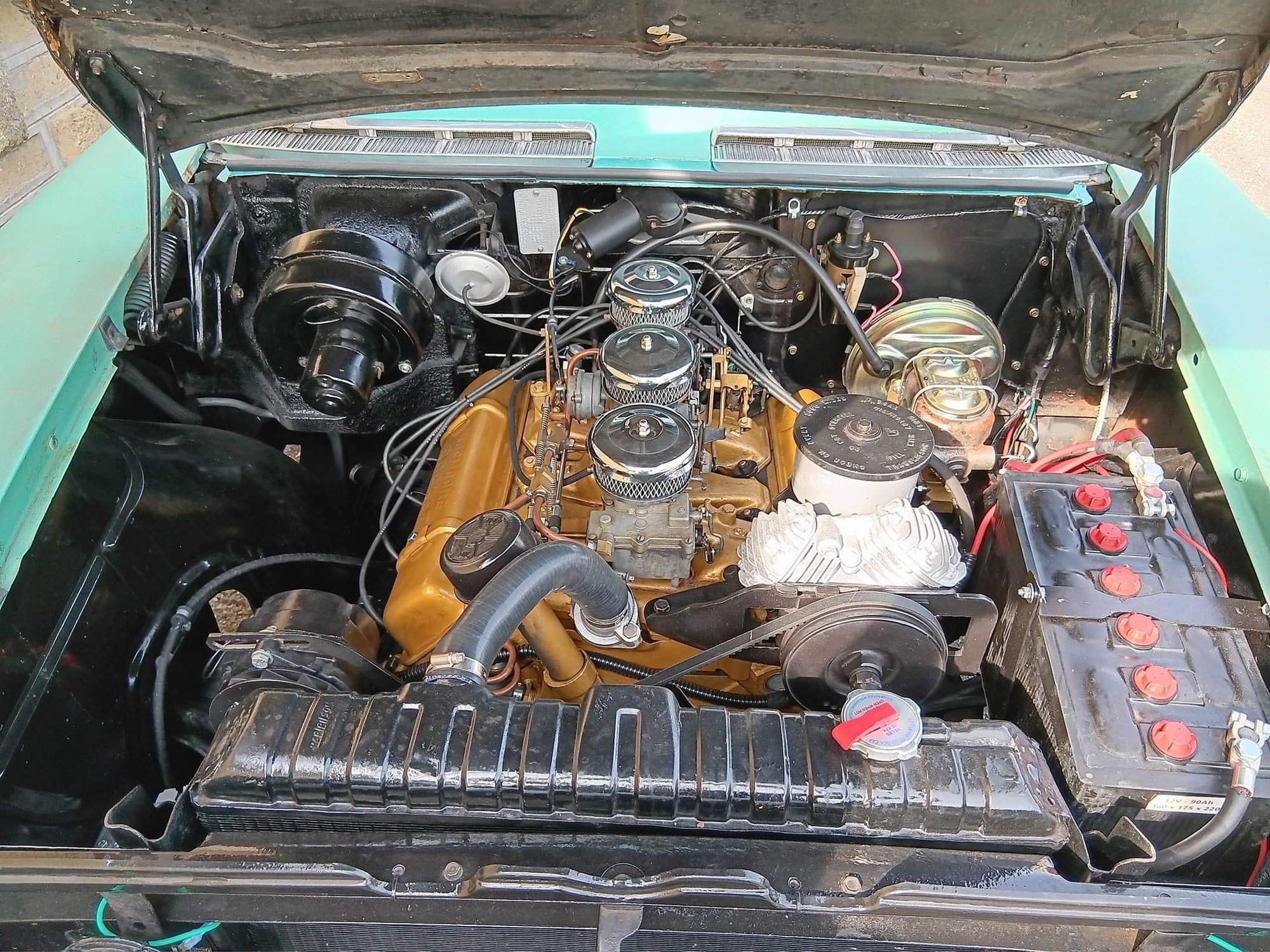

Nice job . I like the valley cover . Do you have valve covers to match ?

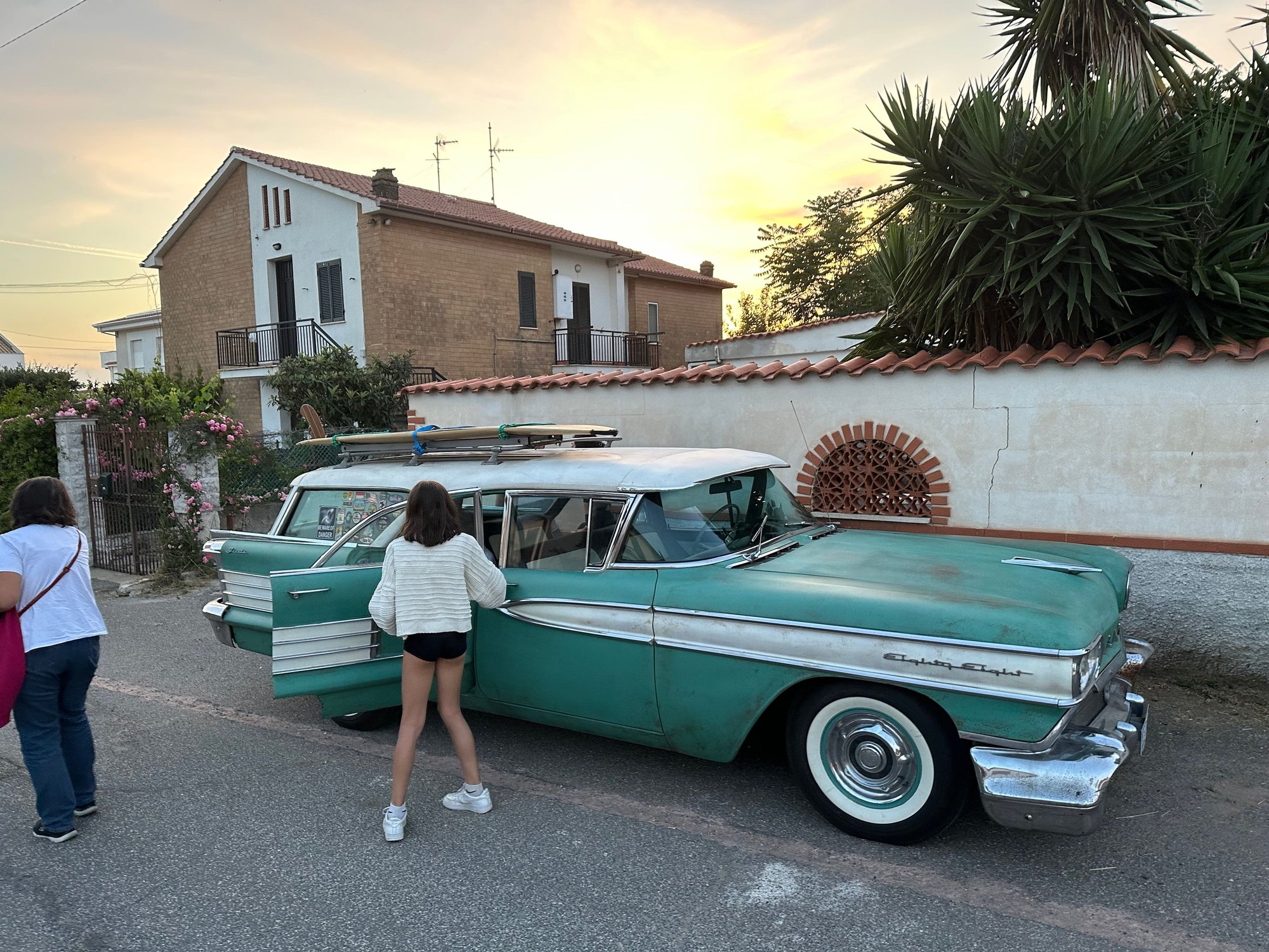

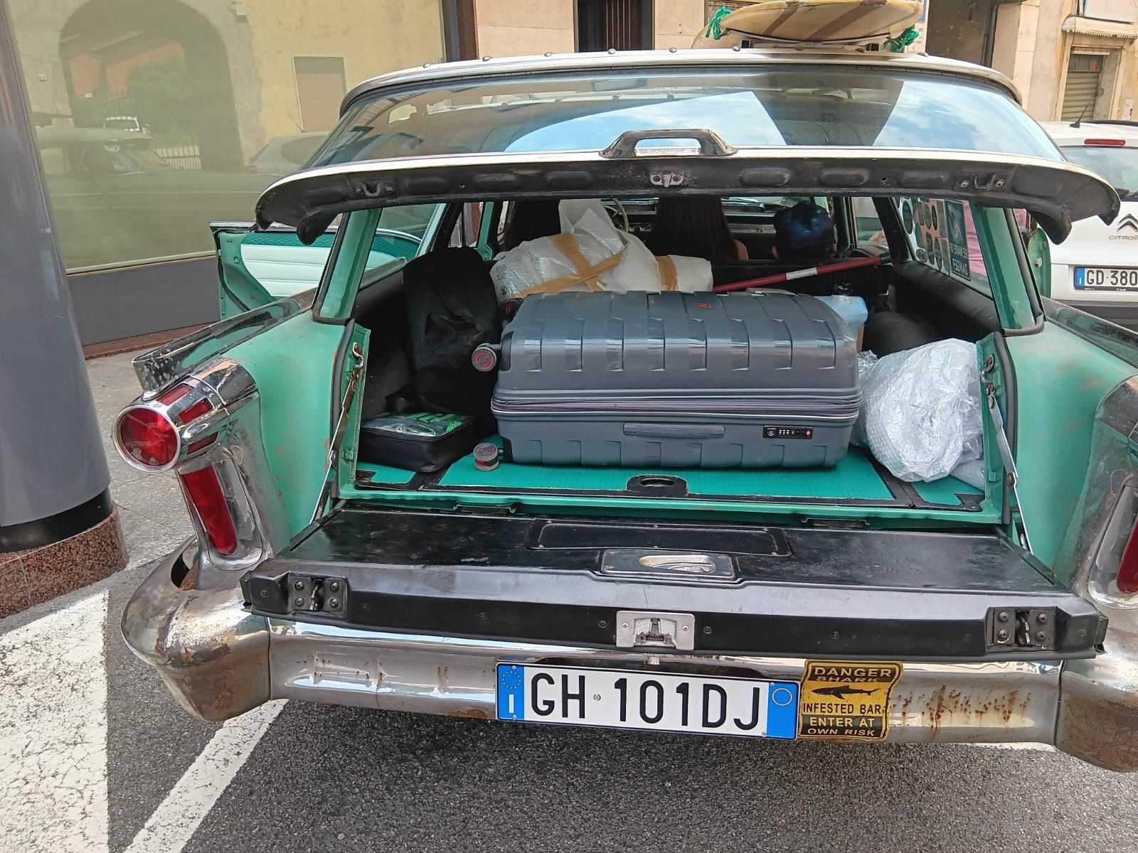

Hi Mr, thanks for your email,
Yes car is finished, some pics for you
