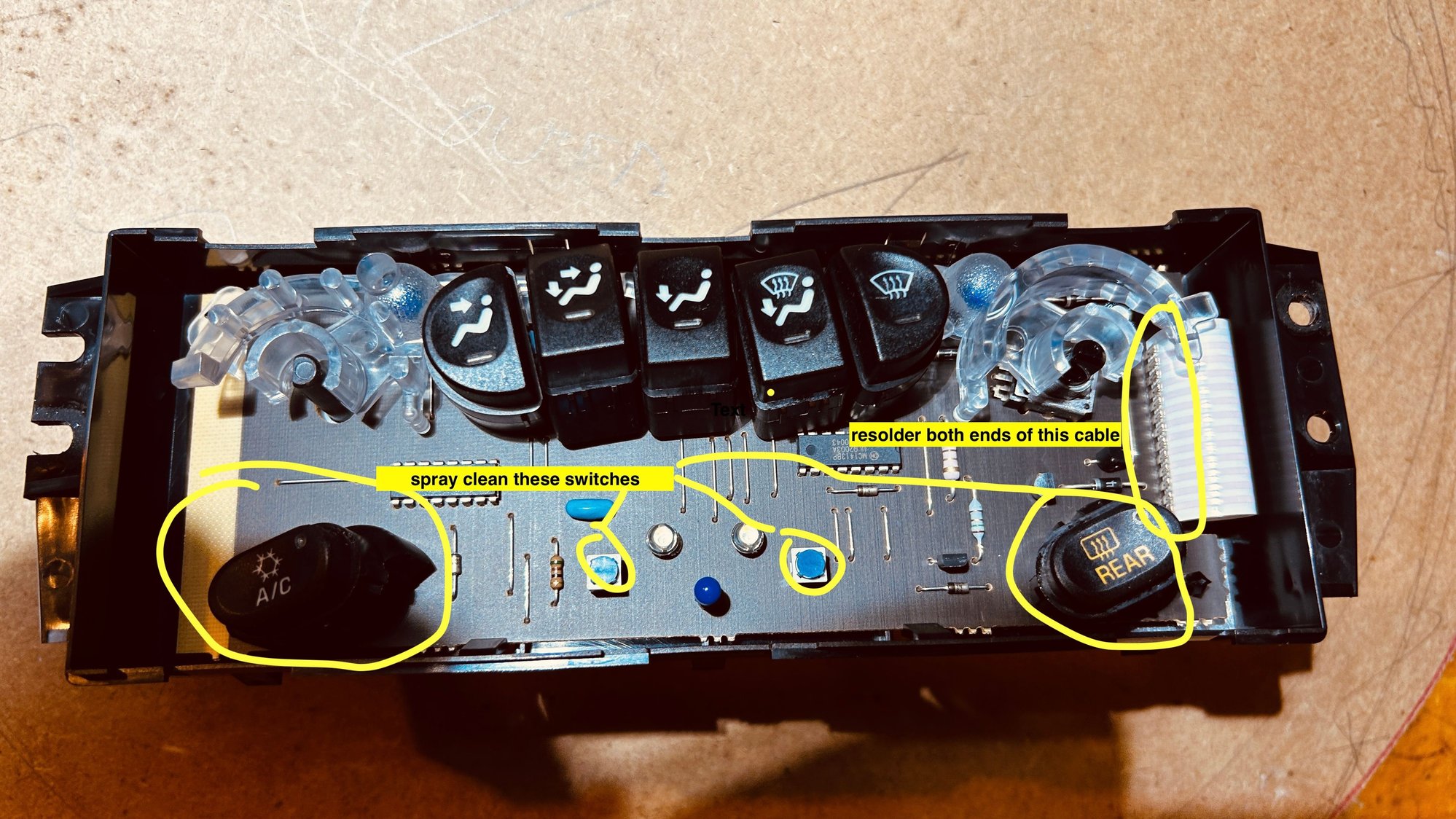

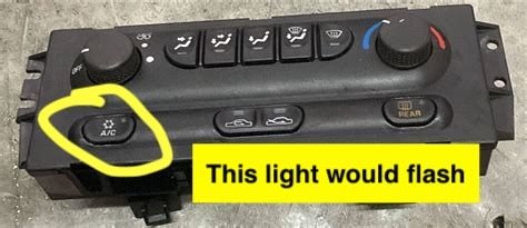

Hello all,
I have a 2001 Intrigue with the 3.5L engine that I got a few weeks ago and it's been a great little car so far. the only issue i've had is that the AC works But, it will randomly stop cooling. If I hold the AC button down for a while it seems to be just fine for the trip but if I don't it will randomly just turn off and back on and then off again all at seemingly random times. I did try a recharge kit and it seemed to get better but still has the issue. the gauge on the recharge kit red in the high green area but I know that's not really a super reliable method for looking at actual system charge.
when it turns on and off its a very random flash almost like there is an electrical contact problem in the switch or relay system or something like that,
anybody heard of such a thing?
its been working for a few weeks so Im calling it fixed
