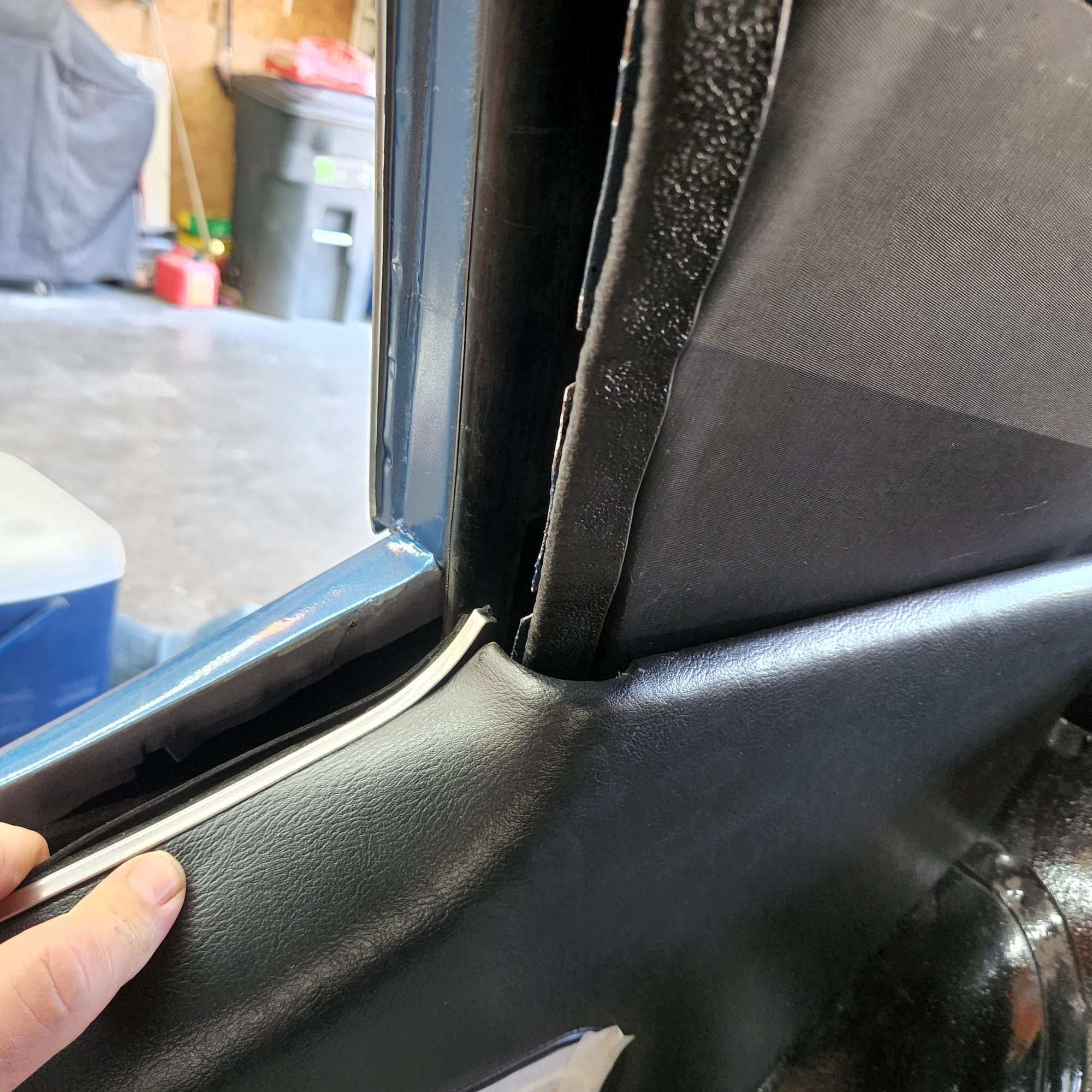

Does anyone have an up-close pic of where the door windlace meets the rear cover? trying to figure out if the windlace should stop above the panel or continue behind it on a 1970 Cutlass Supreme?

not the best pic but correct placement of top of windlace...tucks into a "cut out" spot at the top of the QP jamb....and goes UNDER the rear side panel.
This pic is the Passenger side.

this is the area I'm referring to.

The original headliner windlace also tucked under the rear side panel...does not end at the top of the panel. I have a loose set from a '70-72 Skylark and it's apparent where the side panel pushed against the face of the windlace...above the end of the windlace by about 1" or so. GM didn't want unsightly gaps and the install would also serve to keep the end of windlace in place.

If it matters....that appears to be a thinner aftermarket windlace you show in your two pics.....not the original style which is much wider and also has a distinct bevel/edge running along the length of the windlace. Yours is a simple "tight U" shaped windlace....more like what was used on the convertible top frames along a piece of the inside metal that ran above and parallel to the top of the windhshield. Your style is likely some aftermarket vinyl "generic" windlace that you can buy at local upholstery places.....I buy the same stuff here.
