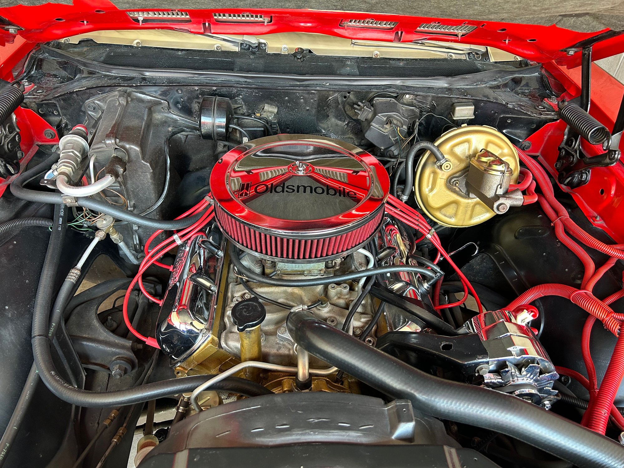

Nice clean engine compartment. Holy Smokes there is lots of RED..

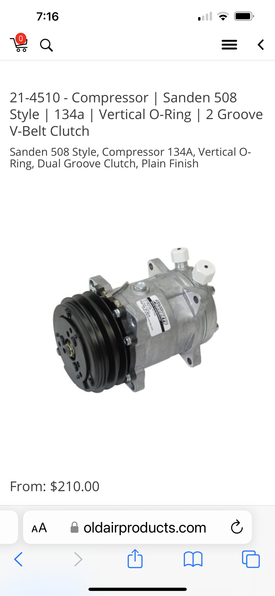

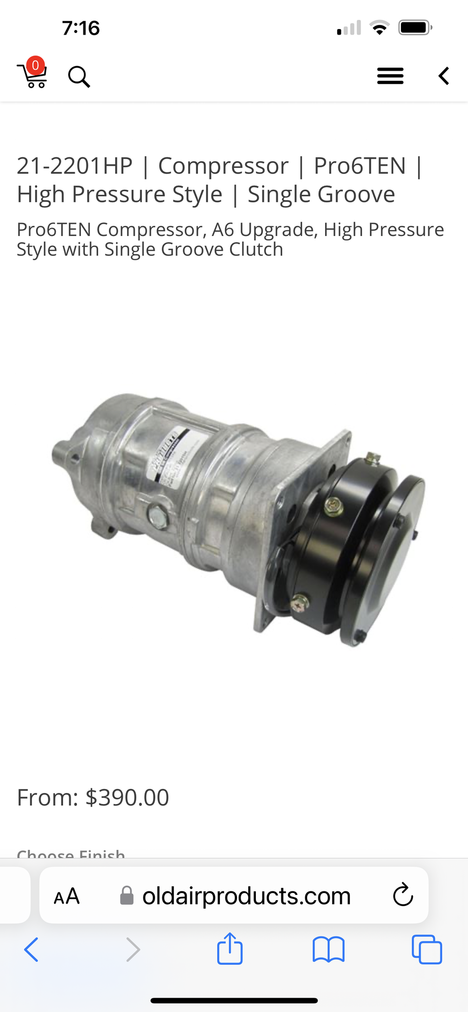

Hi Gary. Im having issues with my compressor and after looking at the Pro6ten compressors as a replacement I see they have two different ones for my vehicle (1971 442) they sell a High Heat Style and a High Pressure Style, do you know the difference between the two? My vehicle already has the Olds Air POA 134A kit if that makes a difference. also what would be recommended changing since im going to open the system, expansion valve, and dryer? Thanks

I run the Pro Ten 6, purchased from Old Air, along with their drier, the expansion valve (Ac Delco) is available on Amz.

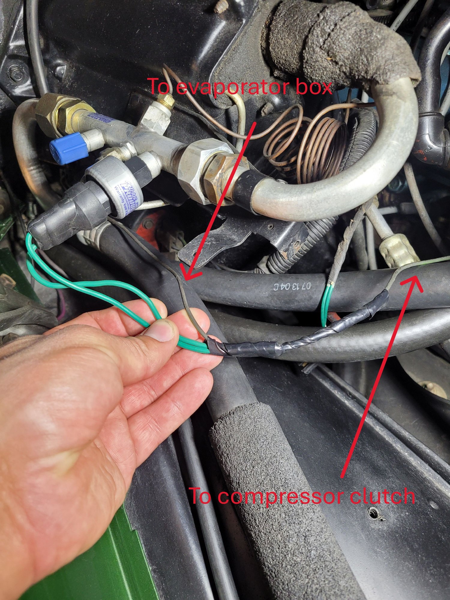

Okay so I finally got the new Pro6ten compressor, I ordered the high pressure version not the high heat. A few questions about how the POA wiring works as someone else spiced it in, along with some pictures of my old compressor making sure its not a high heat version.
Curious if this is wired correctly one wire goes from the POA to the evaporator box and one to the clutch on the compressor.

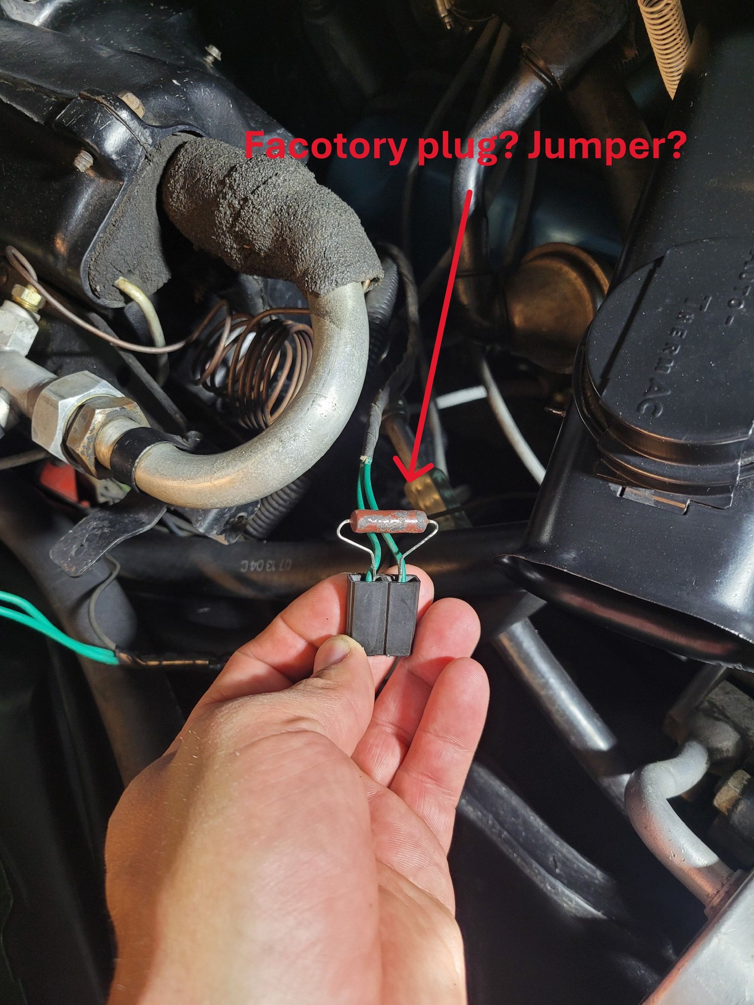

Is this a factory plug? It was hidden/tucked away by the evaporator box. Is that a jumper?

The Olds A6's of this generation were super heat. It's not critical which type you get - they're both safety interrupt switches that prevent the clutch from engaging when things are problematic. You don't have to include them in the circuit.
The material on the evap tube is called "cork tape". It's a long strip of cork, 2" wide, soaked with tar. Autozone usually has one dusty box on their shelves. Good insulator and easy to wrap and mold. You can just cut through it, pull it off, then wrap it back around. Super sticky stuff. There are different shapes and sizes of expansion valve probes so it might take a moment to figure out how to get it secured in the little brackets.
You don't have a POA any longer. That's now a cycling switch. It's advertised as an "upgrade" but it's not - it's just a different way of controlling the refrigerant flow. It's simpler and cheaper which is why most manufacturers started using that style in the 90s.
Looks like you should pull apart the wiring to see what's going on and make some fixes. Someone got pretty creative! The brown wire from the evap box is bringing power to the clutch. The two pin connector on the evap is a freeze switch - it interrupts the circuit if the box gets below freezing. From there you go into one side of the switch hanging off the side of the ""POA"" tube, the other side of that switch goes straight to the clutch. The clutch may have one or two wires. If it has one wire then the other is already grounded to the compressor body. If it has two wires, then one wire just goes to ground.

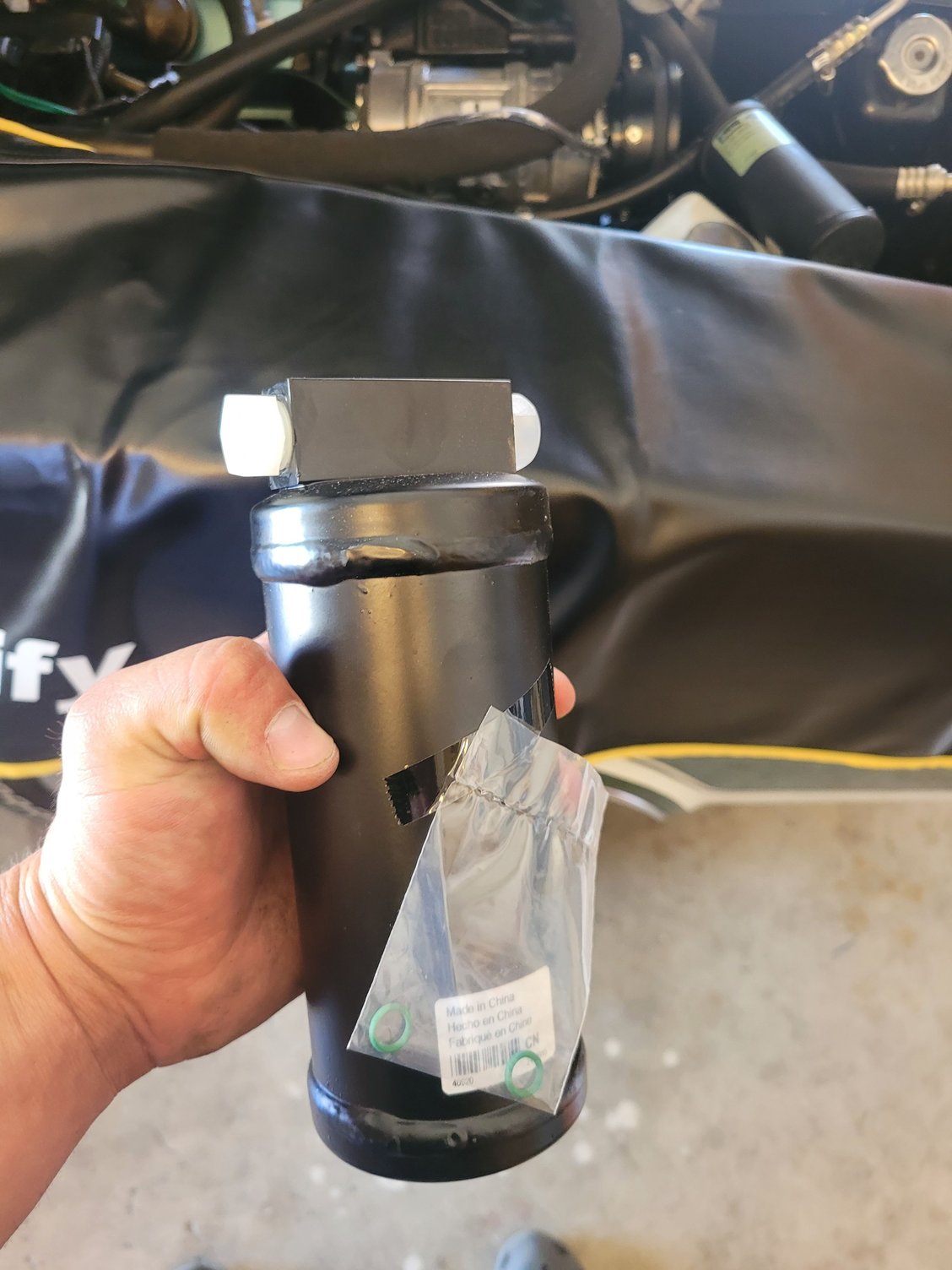

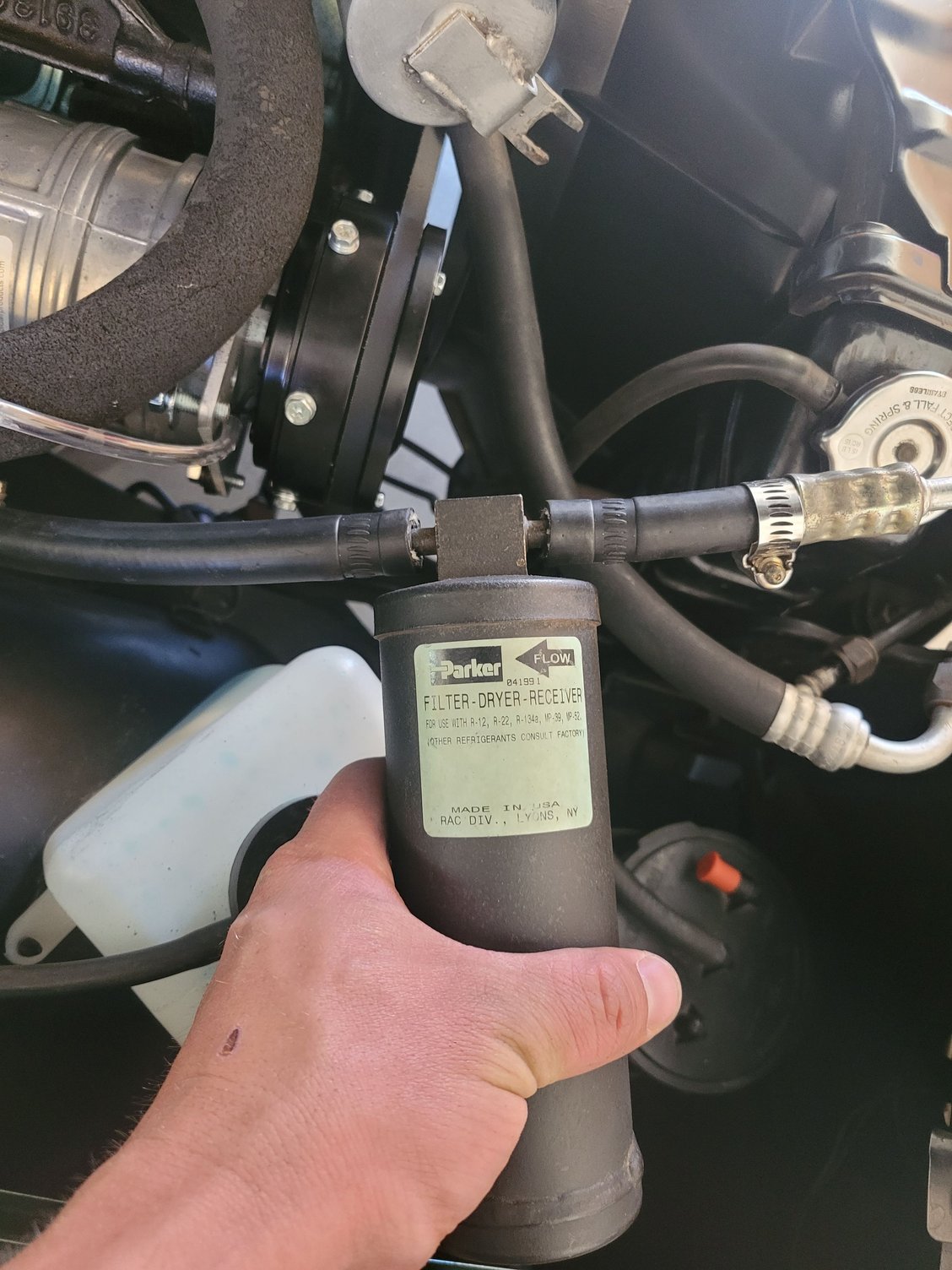

So not sure if I ordered the right dryer. The current dryer in the car is installed on the line between the condenser and expansion valve with I'm assuming like barbed ends and hose clamps. I for the life of me cant get the dryer off the hose with out probably having to cut the line. also the new dryer I got has threaded ports which wont work with the way my current dryer is connected. Is the dryer supposed to be connected like that or do i need a different line (what do they call that line?)Thanks Pics below

The line to the drier normally has an 90* pipe ending in a threaded male fitting to the condenser . Your line has been hacked a little. One of the guys here probably has the correct line.

Is the dryer supposed to be connected to the line that goes from condenser to expansion valve? Or is the correct dryer threaded and goes somewhere else?

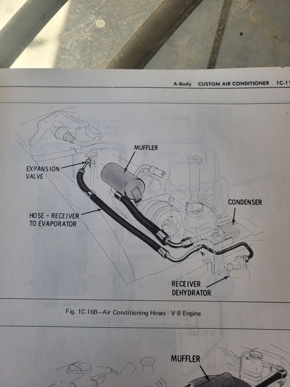

After looking at the CSM it looks like somebody changed the set up quite a bit. Looks like they might of changed the condenser with one that's not original and put the dryer in the engine bay. There is no dryer in front like it shows in the manual or a place for one to live. I might have to order a new condenser, dryer, and line that goes to the expansion valve. I was trying to save money without buying a new condenser but now I guess I have to LOL.

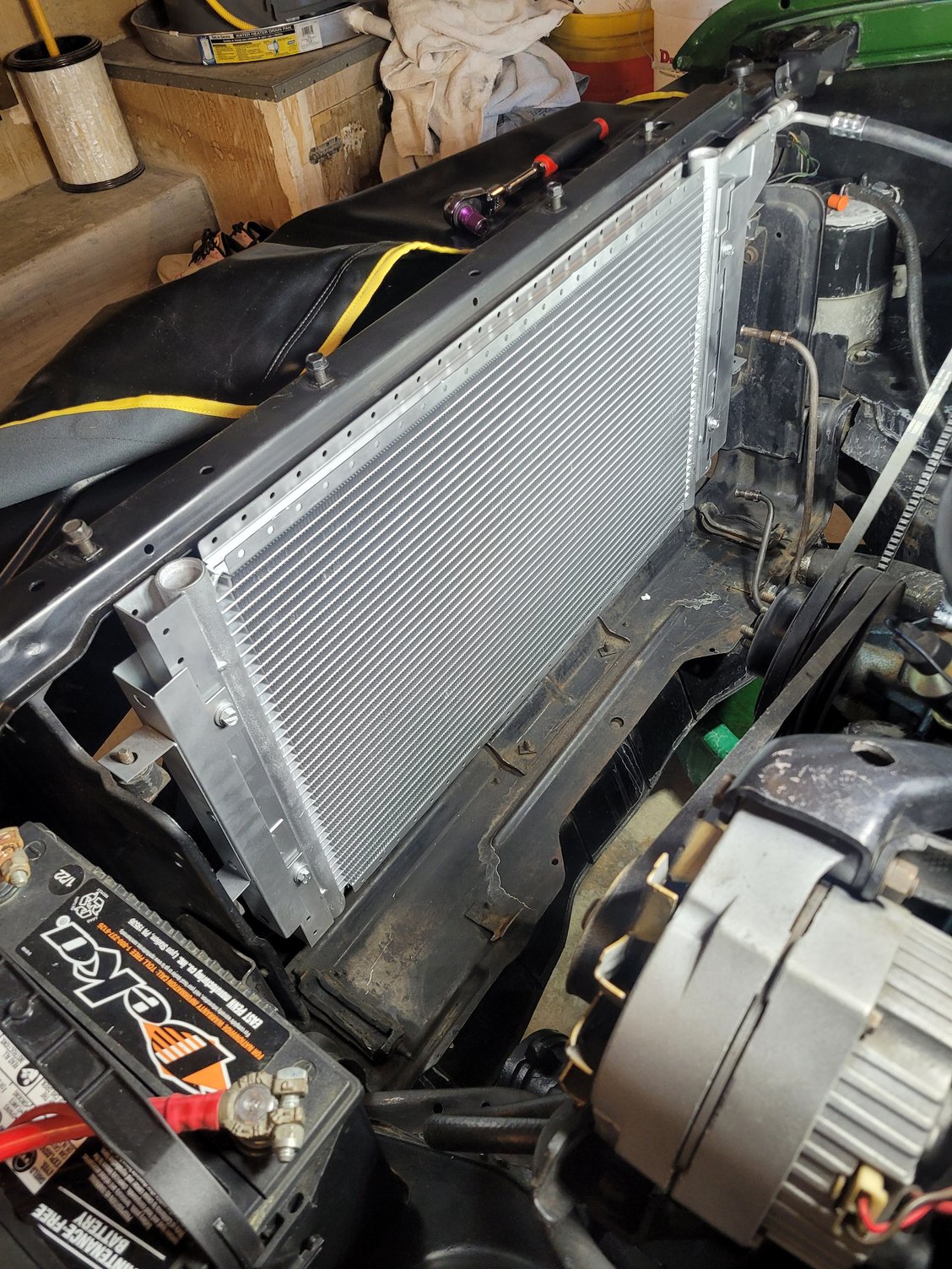

Okay so I went with the Vintage Air. SKU 021172 its advertised as a parallel flow condenser. I plan to install it tonight but was wondering about how much 134 and PAG oil to add. The new compressor came with 220cc of PAG 46 oil, since I'm replacing the condenser assuming the old one would hold some oil and the rest of the system would have residual oil, how do I know how much to add? Also for the refrigerant the manual says to add 4lbs of R12 so do I add 80% of that of 134? (64oz X .8 = 51.2oz) Just trying not to burn up a new compressor if i can help it thanks!

Do your installation this weekend (the time consuming part) and ask Vintage Air on Monday about the finishing details.
They will have good advice about oil and refrigerant charge.

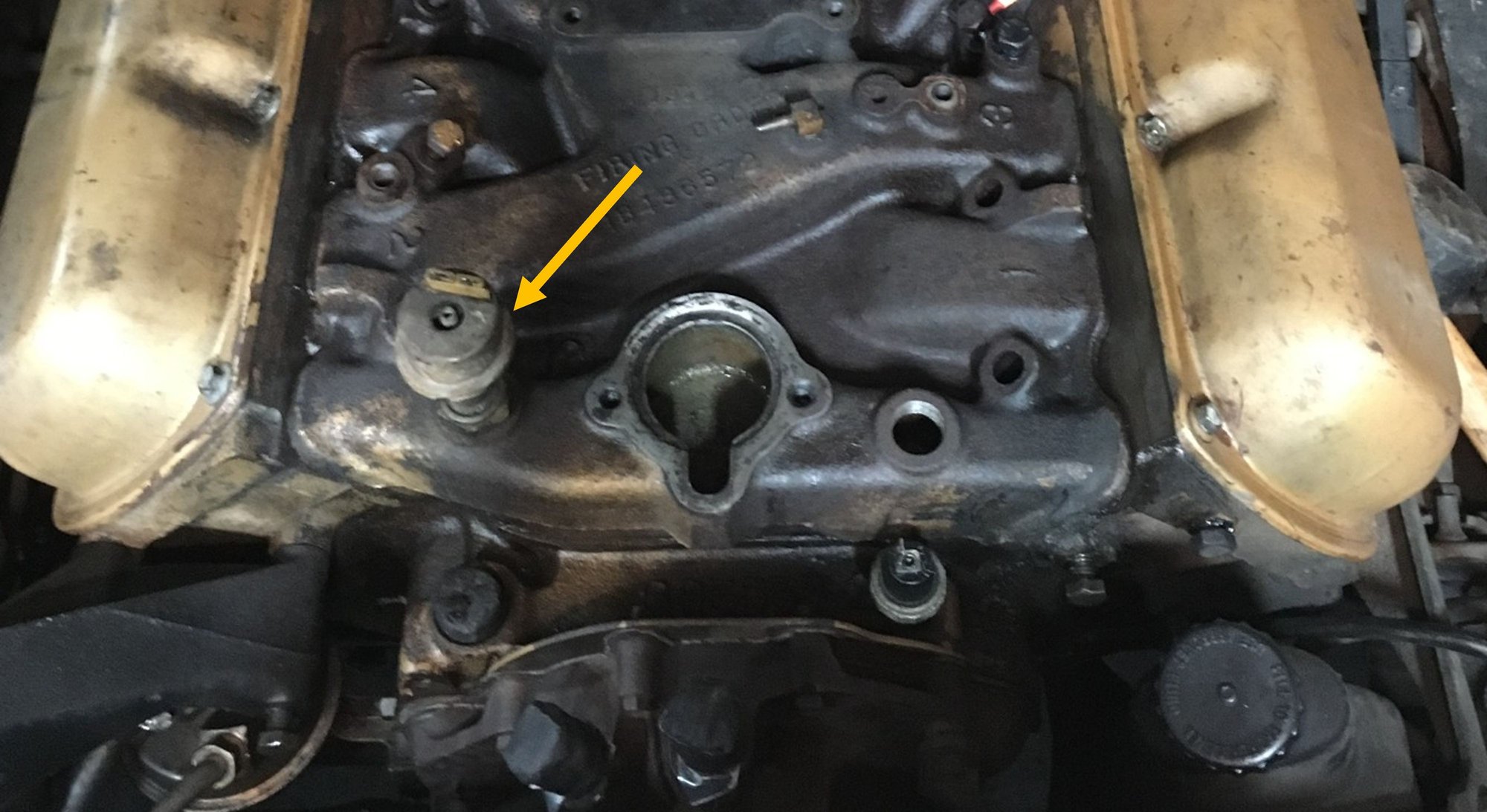

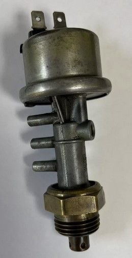

Old Jun 7, 2025 | 05:45 PM
Posts: 26,066

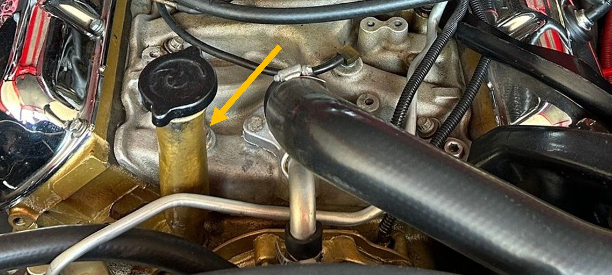

Yes that (below image) is a factory plug. Likely someone removed the DVCS (Distributor Vacuum Control Switch) from your intake manifold - many owners remove the DVCS. The x2 green wires & the attendant plug/connector (in your hand) connect(ed) to the solenoid located on top of the DVCS. The other end of those x2 green wires connect(ed) to the transmission. If someone removed the DVCS, & its accompanying top-mounted solenoid, the plug and the x2 green wires are no longer required/needed. You can leave them connected to the transmission w/ no issue. You can hide the x2 green wires and solenoid (resistor) plug wherever is your liking. Page 6K-12 (Engine Cooling) Fig 6K-19 of the 1971 CSM or whichever Fig. is appropriate for your engine & equipment.
1971 DVCS
1971 DVCS
Old Jun 7, 2025 | 06:10 PM
Posts: 26,066
Location of DVCS 1971 intake manifold.

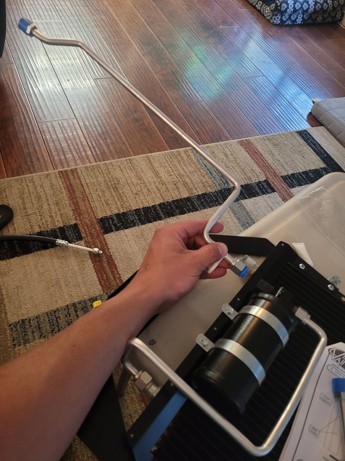

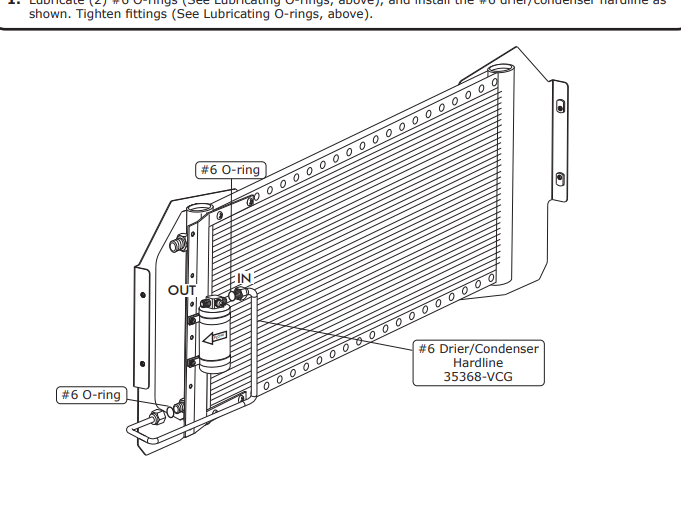

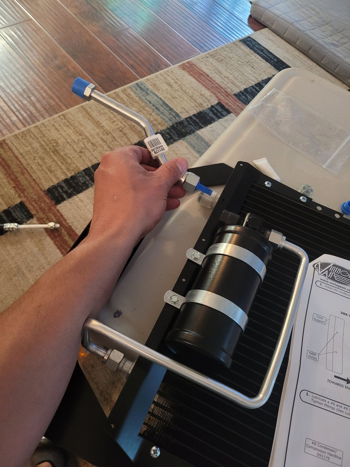

Thanks for the info Vintage Chief. So I installed the Olds Air compressor and when setting up the brackets and dryer on the new Vintage Air condenser I realized an issue with the hose routing. The Vintage Air condenser is supposed to be a factory fit for a 71 442 with or without air. If you read my previous post someone installed a non factory condenser and the dryer was spliced in, in the engine bay. So I ordered a new line that goes from the dryer that is supposed to be mounted in front of the condenser to the expansion valve along with the Vintage Air condenser dryer combo SKU 021172. Some pictures below
So I ordered the new line that goes from dryer to expansion valve which looks just the one from the CSM
Here is the new hose. Dryer to expansion valve.
Here is the line that came with the kit that goes from dryer (out) to expansion valve.
This is the hard line that goes from the condenser to the compressor with the muffler.
Is the dryer hardline in this kit wrong? It looks completely different from the one I ordered that matches the CSM.
Is the dryer hardline in this kit wrong? The CSM looks like the line (out) to the expansion valve is coming off of the driver side of the dryer and the kit i have has that crazy long hardline coming off the passenger side of the dryer. Sorry for all the pictures this is confusing me. I feel like this direct replacement kit isn't so direct.

The condensor is designed to work with their entire kit, which uses a very different hose routing that runs through the blower fan hole in the cowl. By "factory fit" they mean it mounts in place and they are really talking about the entire kit since the interior box uses the OE vents and OE-ish control unit. The standard aftermarket condensors are very different than the OE so mounting takes a little bit of creativity to get them mounted.
The connections on that one are in a slightly different location but you could get stock tubing and hoses to work with some effort.
Don't use their condensor-to-dryer tube. Get an OE tube. You can bend A/C tube with a tubing bender.
There was one company that made a true OE-fit parallel flow condensor but I'm not quickly finding it. Maybe the OPG unit?

You sir are correct. My fault for assuming factory fit was going to be and OE replacement. I spoke with them this morning found out its part of their kit not a stand alone replacement condenser. Now I get to pay return shipping and a restocking fee. However I did find from a company called Cooler Classics, they have a parallel flow condenser with drier on Ebay advertised as direct replacement about $400 with shipping. Should I post updates to this thread when the new parts come in, not sure if it would help anyone else out down the road I'm still new to forums and how they work.
1971 DVCS
1971 DVCS
THAT IS NOT A DVCS PLUG! That is the factory compressor plug that is in extremely good condition. Since your system has been heavily modified, it may be redundant. That plug should have a ground ring on one lead, and the other supplies the 12 volt positve to turn the compressor on. You have aftermarket safety switches/sensors on your A/C sustem so you will need to find out if that plug still functions, or if an aftermarket lead now controls the compressor.
Old Jun 11, 2025 | 07:01 PM
  #32
Posts: 26,066
Hmmmm....I thought factory compressor plug wires were purple or blue & black? Don't have the CSM in front of me at the moment. I know my DVCS plug was green/green.
Old Jun 12, 2025 | 06:01 AM
  #33
cjsdad's Avatar
Joined: Sep 2010
Posts: 1,664
From: Norfolk, Va
Take another look at the pictures you posted. GM never made a jumper that would reach from the evap box all the way to the front of the intake manifold, and the DVCS plug never had a resistor on it.
