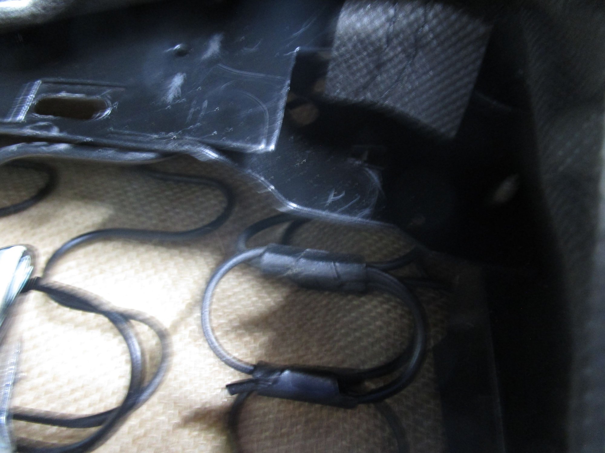

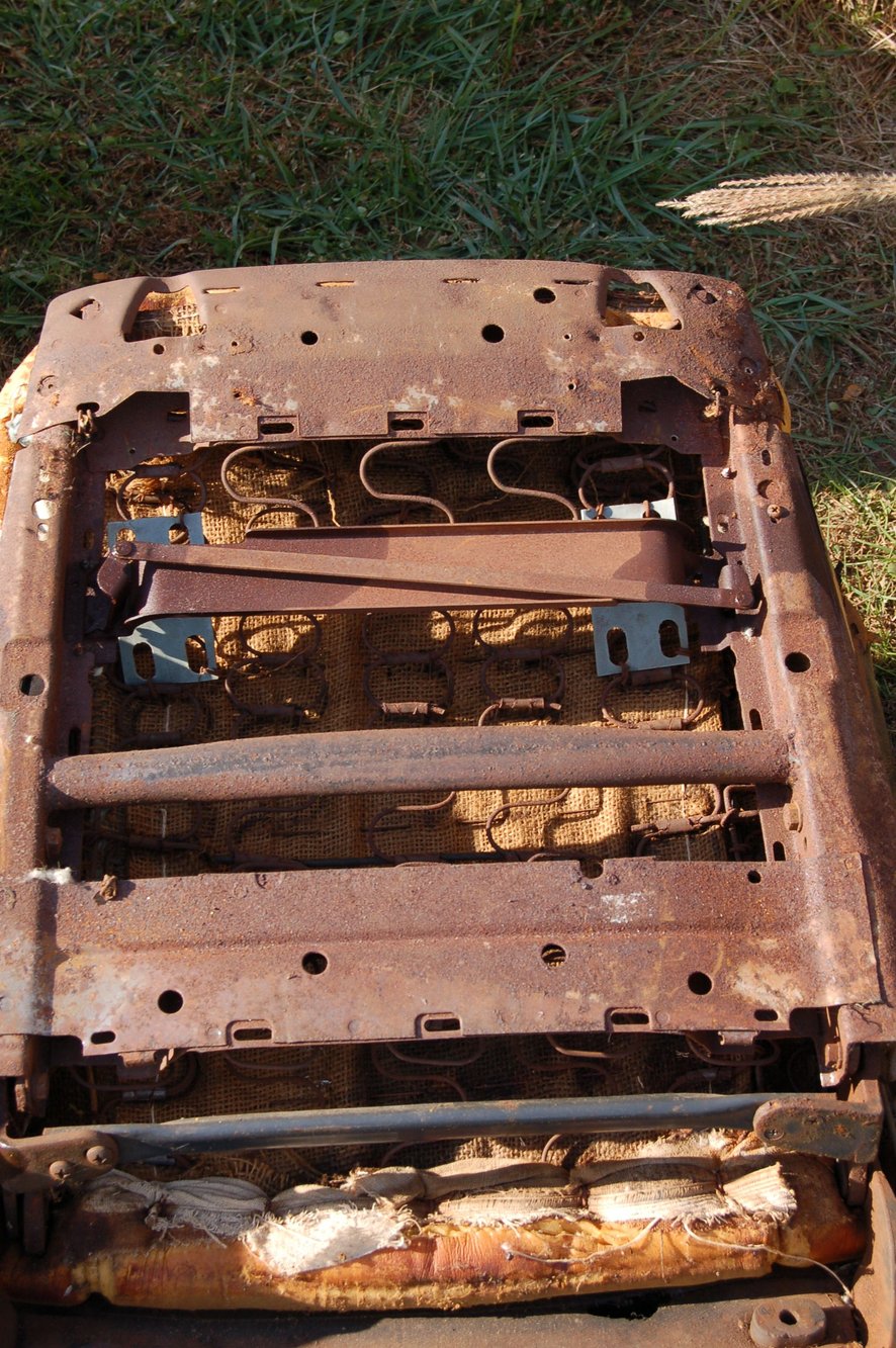

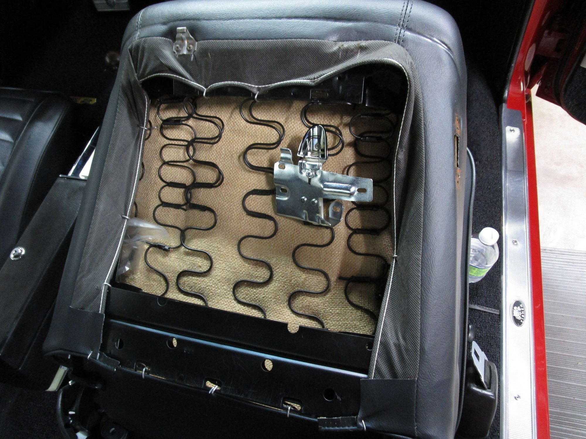

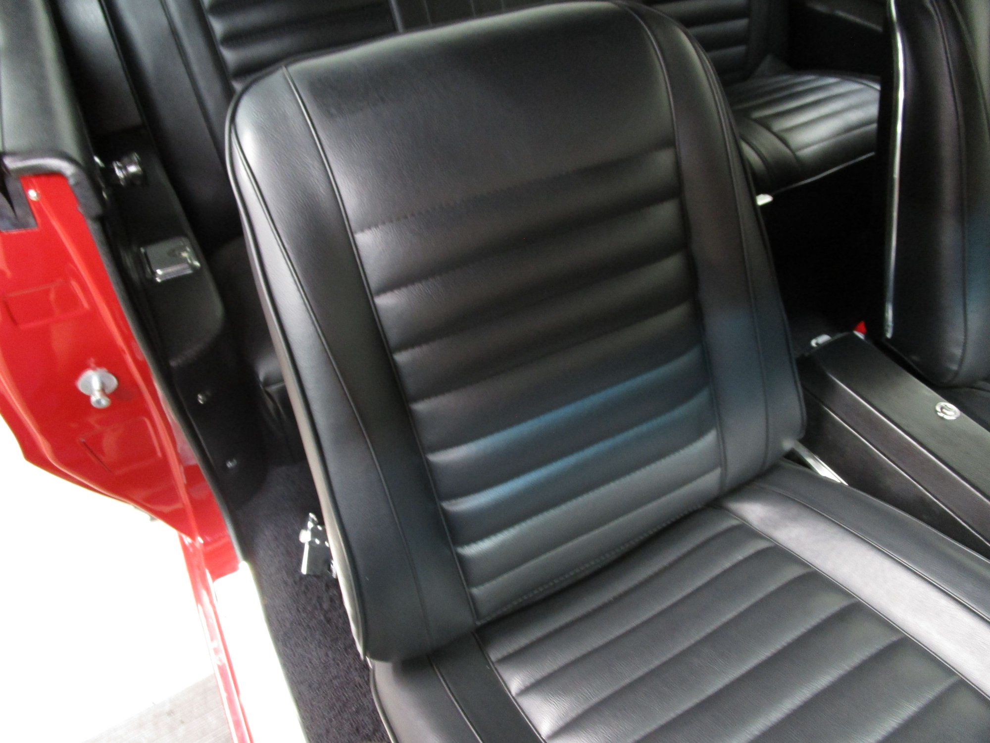

The rods don't go through the seat top like the later 68 or 69-72 seats. They go just in front of the metal seat back. You need to remove the metal backs to install the mounting hardware.

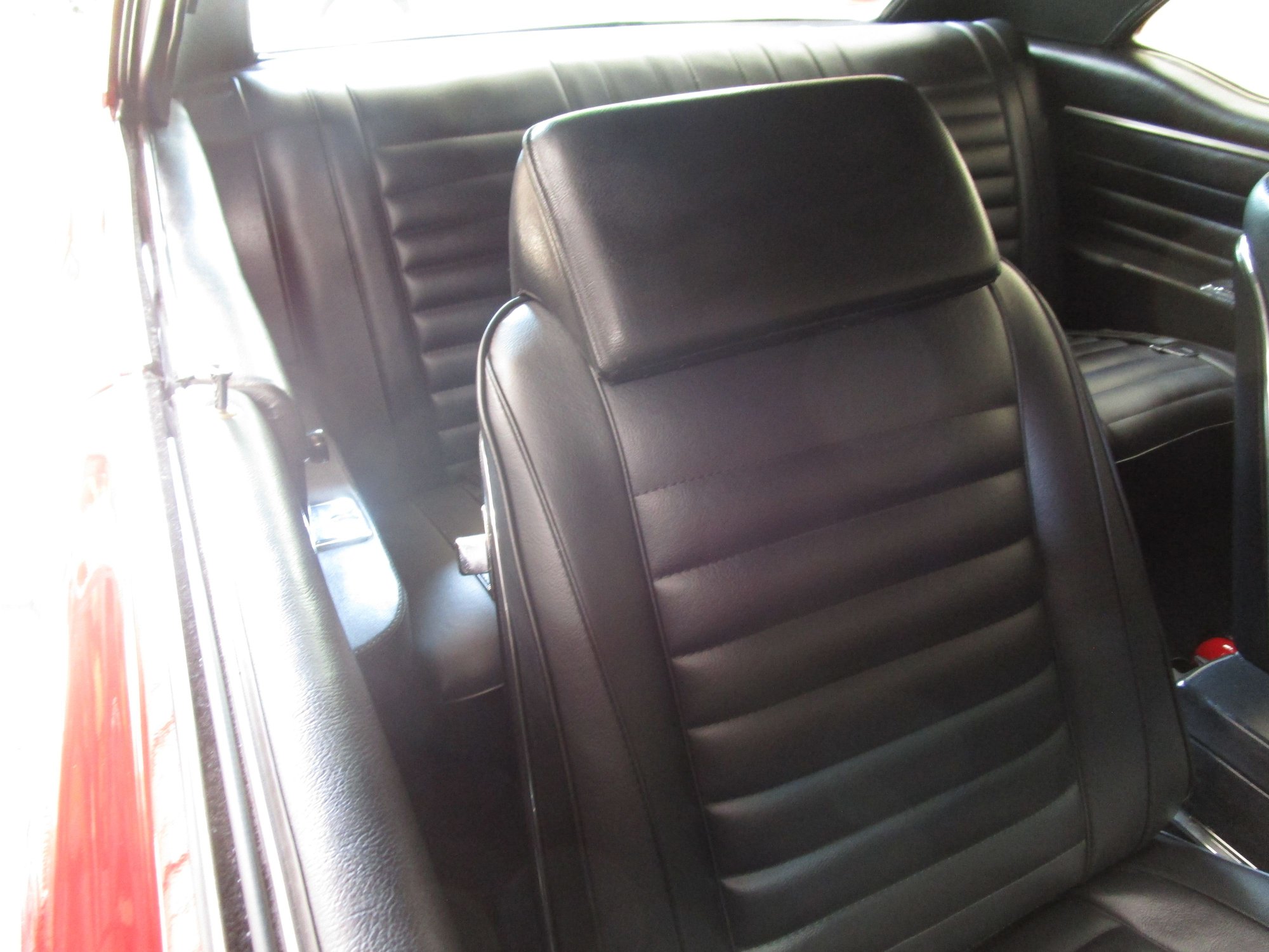

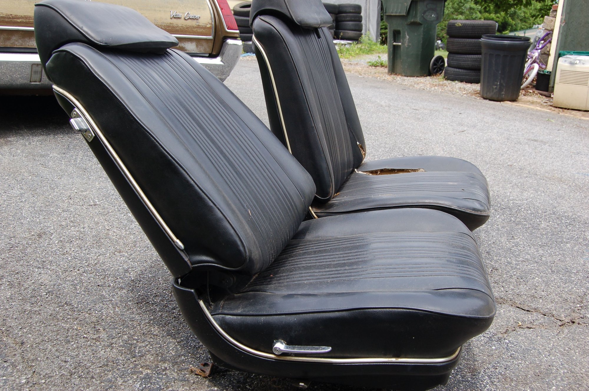

Here are some pics of a bare 67 seat (notice the notches just above where the top of the metal panel sits) and an original set of 67 passenger reclining seats with head rests. I have a reproduction set of head rests in another set of original 66 reclining/ headrest seats and the spacing on the rods fit in the original brackets just fine.

Now I know where those tear drop shaped pcs go

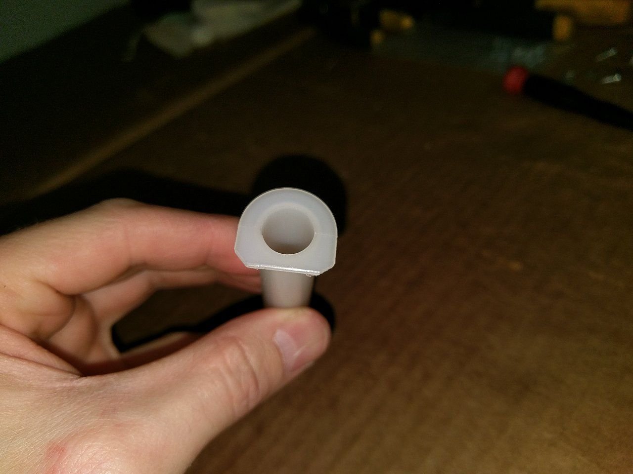

What are the 4 rectangular pieces with the slotted holes for?
Old Aug 15, 2023 | 06:07 PM
Loaded68W34's Avatar
Joined: Jul 2020
Posts: 1,938
From: Pennsylvania
They get hog ringed onto the seat springs, so the headrest post does not rub the springs/ foam when you are sitting in the seat and the headrests are down.

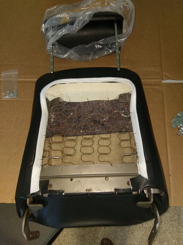

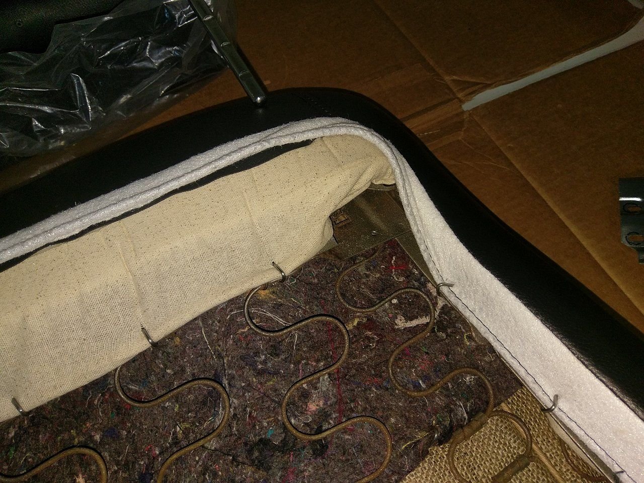

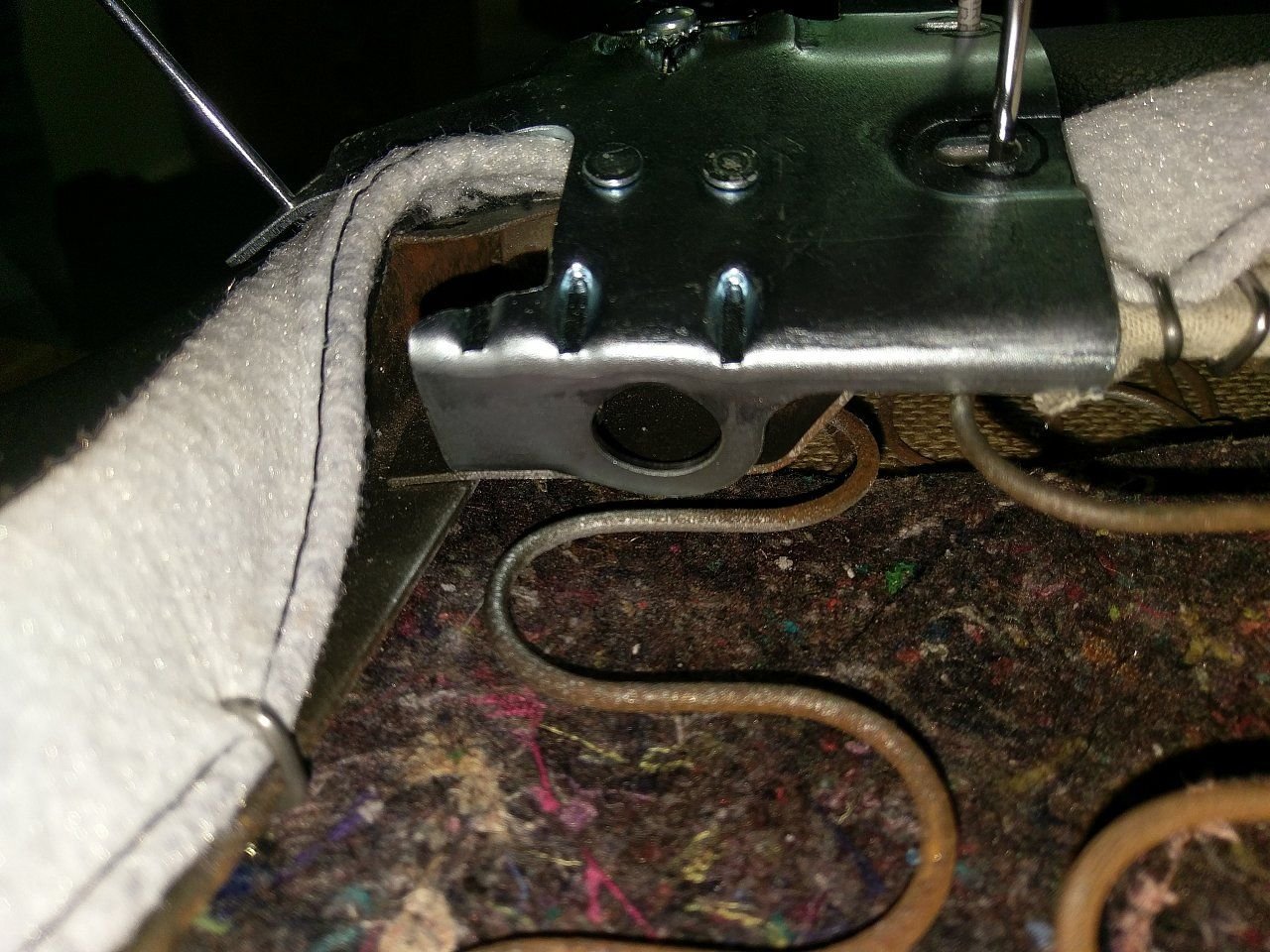

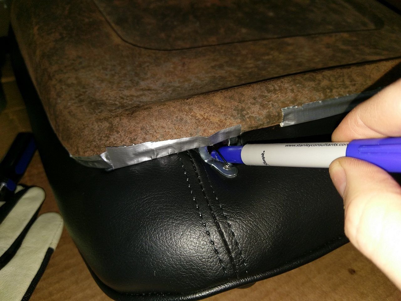

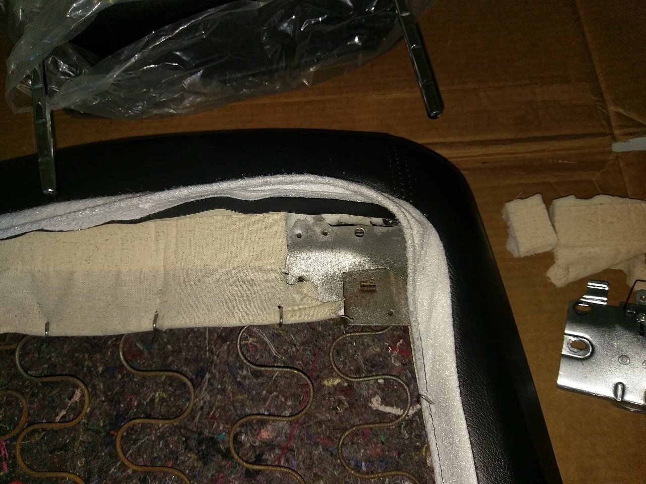

Does anybody recognize my seat as being a 67 model. It does not seem to be like the picture above posted by Loaded68W34 of a 67. The bracket I got with the headrests will not fit my seat. Maybe I have a 68 seat? See pics attached.
Old Aug 16, 2023 | 05:30 PM
RAMBOW's Avatar
Ben
Joined: Mar 2009
Posts: 1,851
From: Snohomish, WA

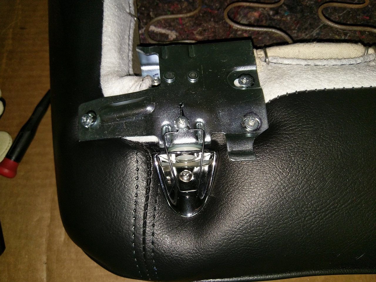

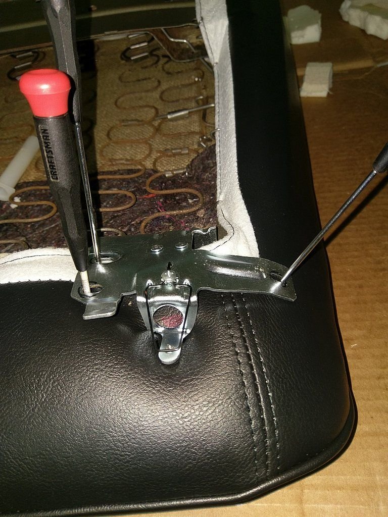

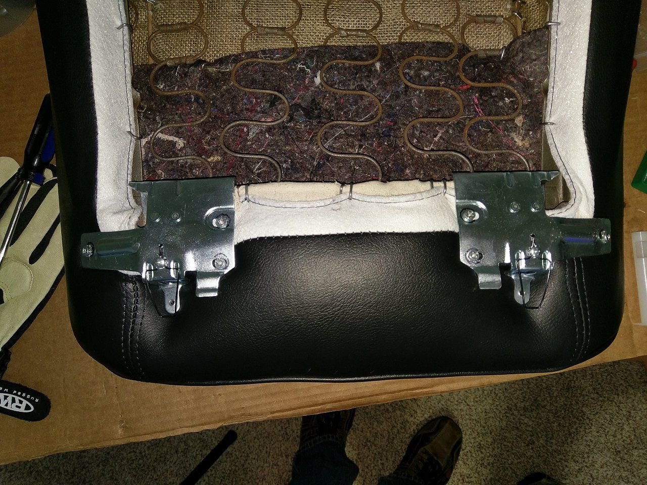

Your seats are 67 seats, no worries there. There is a cardboard insert under the buns over the rectangular opening where the headrest stuff goes, you will have to cut some hogrings in there and stick your fingers in and pull that out... then the metal insert will press in properly.

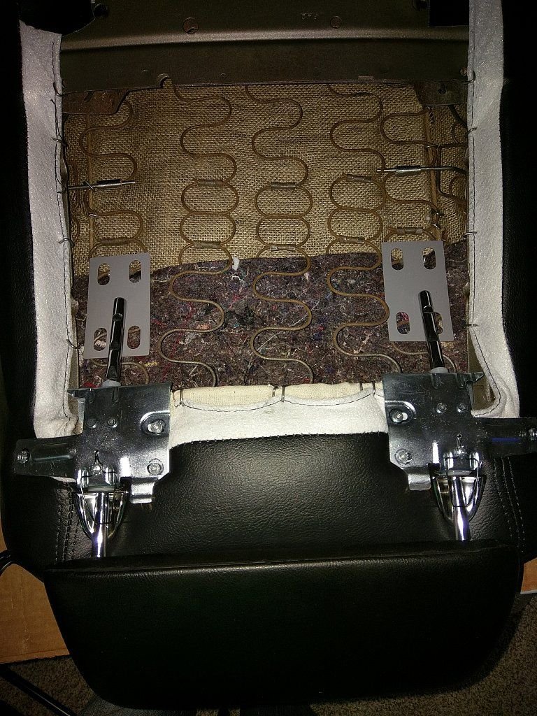

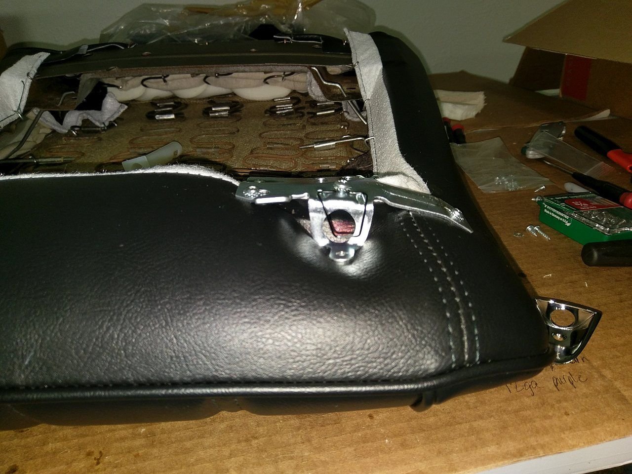

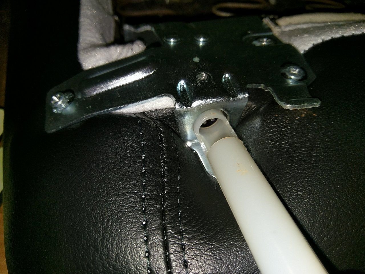

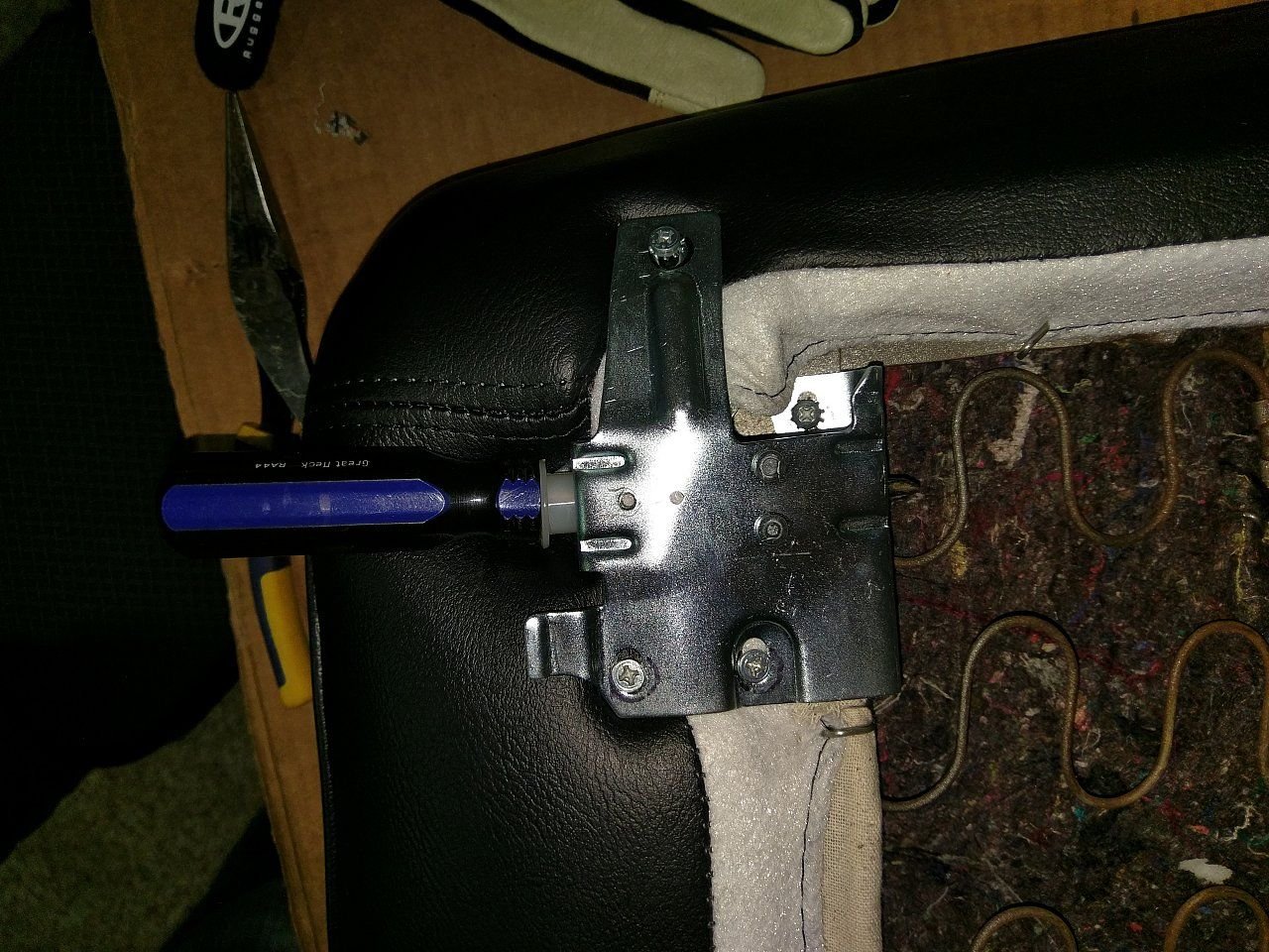

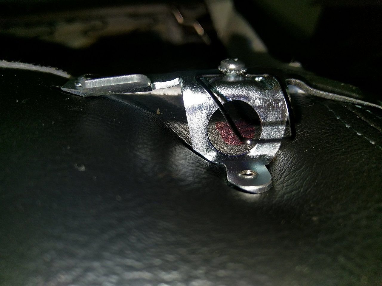

A friend of mine did this conversion a few years ago with the repop headrests and parts, these are pics from his project... hopefully will make it clear.

Thanks a million RAMBOW! I would never have figured it out without the pics. I knew someone had been there and done it.
I was trying to get the bracket under the top metal frame, now it looks easy.

Got one side completed today. Everything went fairly well. One tip, when trying to slip the plastic tube down into place stick a drill bit the size of tube ID up from the bottom to guide it and depress the spring steel clip. Also use a pair of needle nose vise grips to hold plate in position as you locate holes with pick.

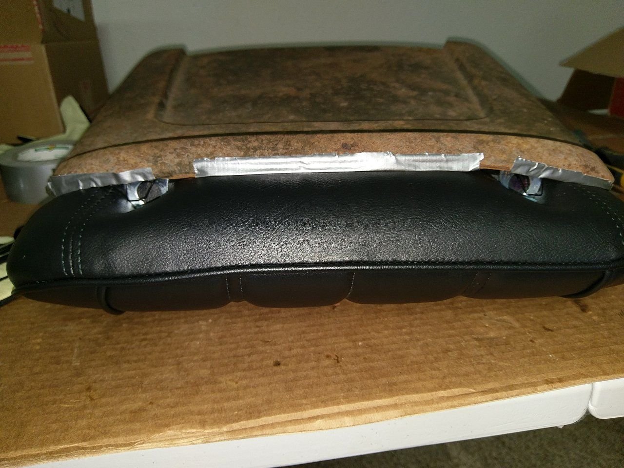

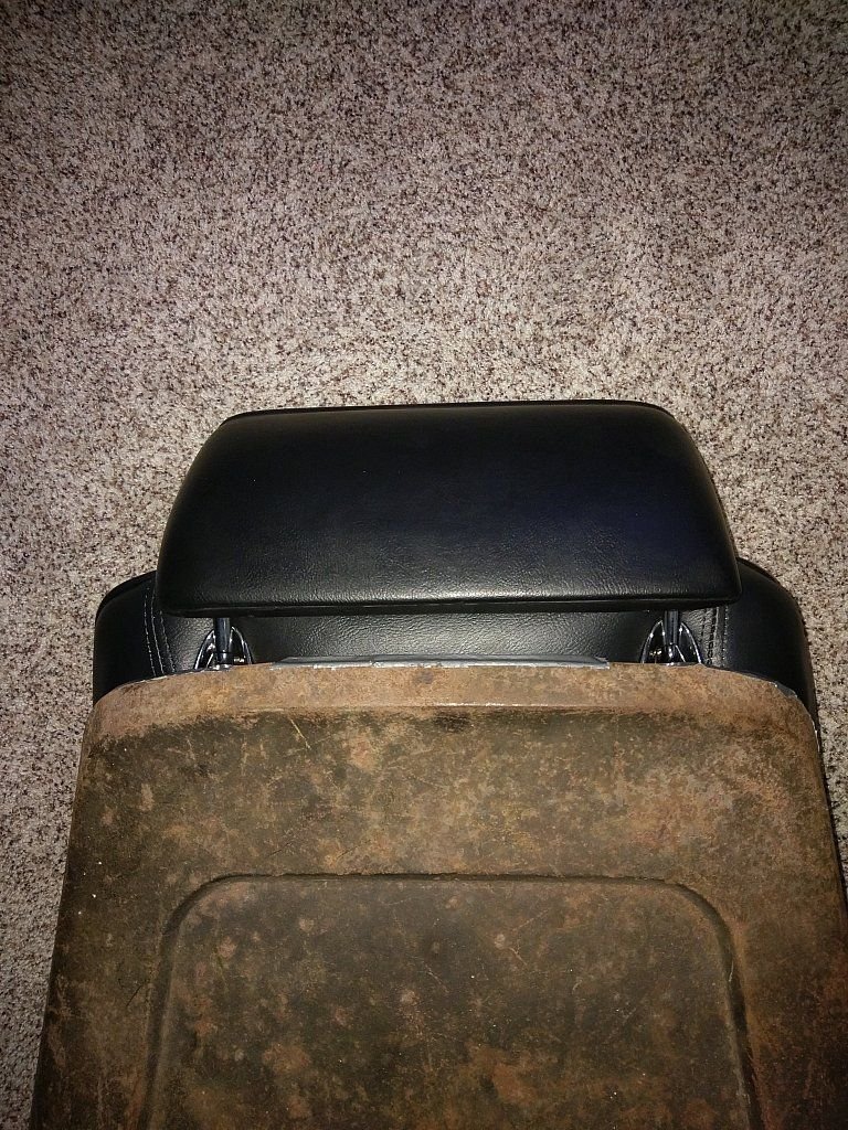

Job complete!
