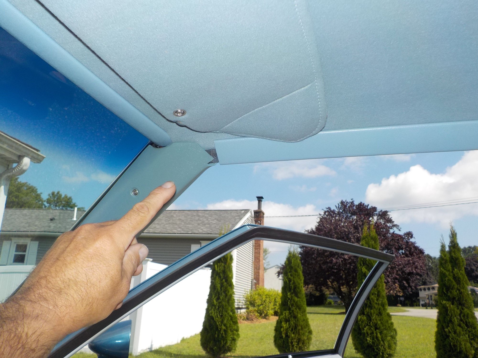

Does anyone know if the A pillars in a 1978 Delta 88 are specific to that car or do other models interchange? Are they the same as a 98? How about a Cutlass? I have a box full of A pillars from 1978-79 Cutlasses. I could use one of these if they're the same.

Are you talking about the actual metal A-pillar or the interior cover? Windshields and thus A-pillars are the same on 1977-1985 D88s (and all other B-body cars), 77-84 Ninety Eights (and all other C-body cars), and 77-90 Custom Cruisers (and all other B-body wagons). Actual interior trim configuration may vary with trim package.

The shop that replaced the headliner did an excellent job but did break a piece off the interior plastic A pillar. I'm surprised only one piece broke. 41 year old plastic pieces are brittle. Didn't know if the trim was the same as an A/G body only because I have a bunch of them in different colors.
You can see in the photo I'm pointing to the broken piece.
