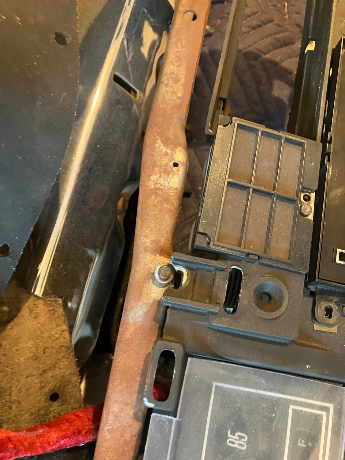

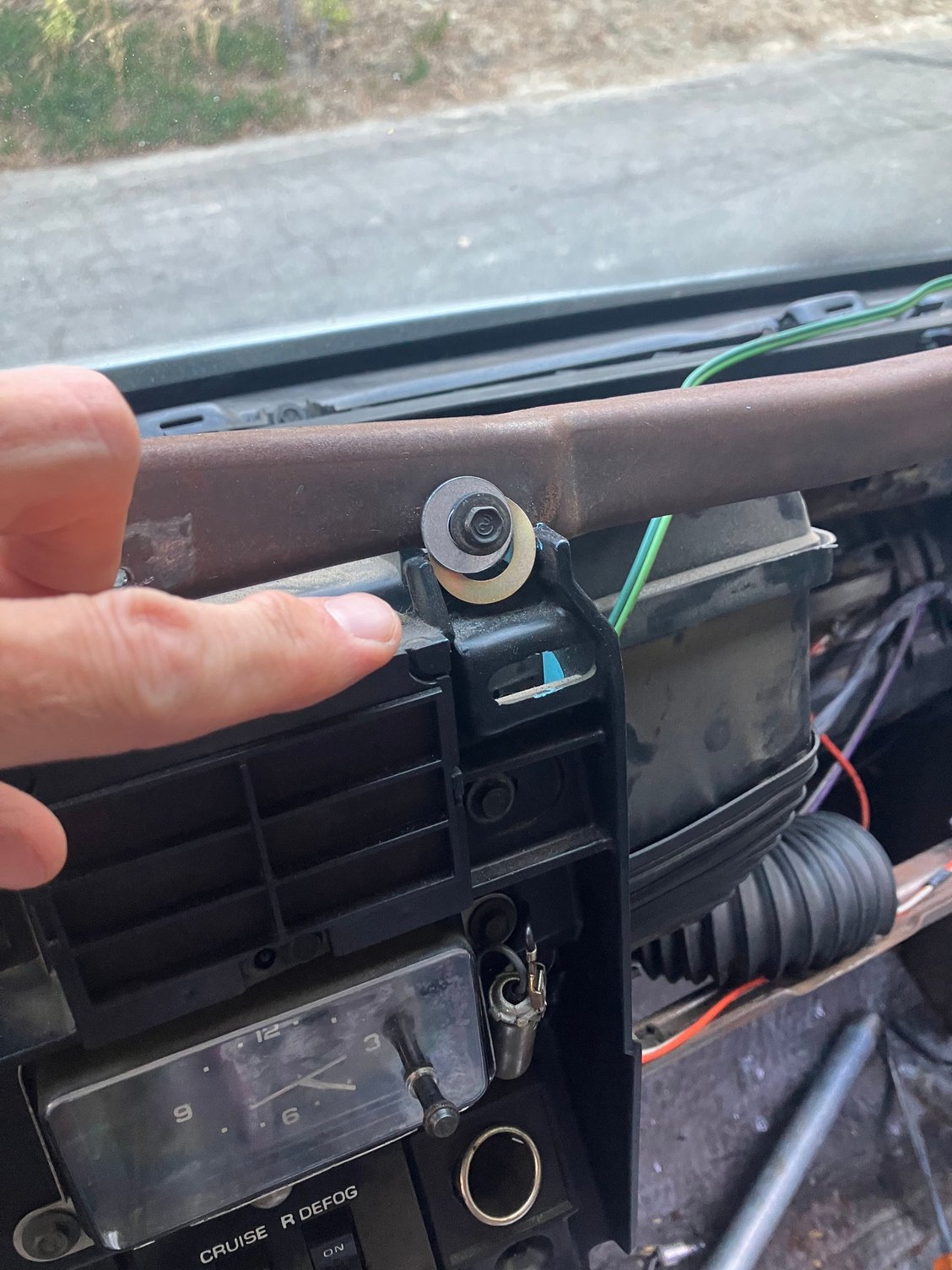

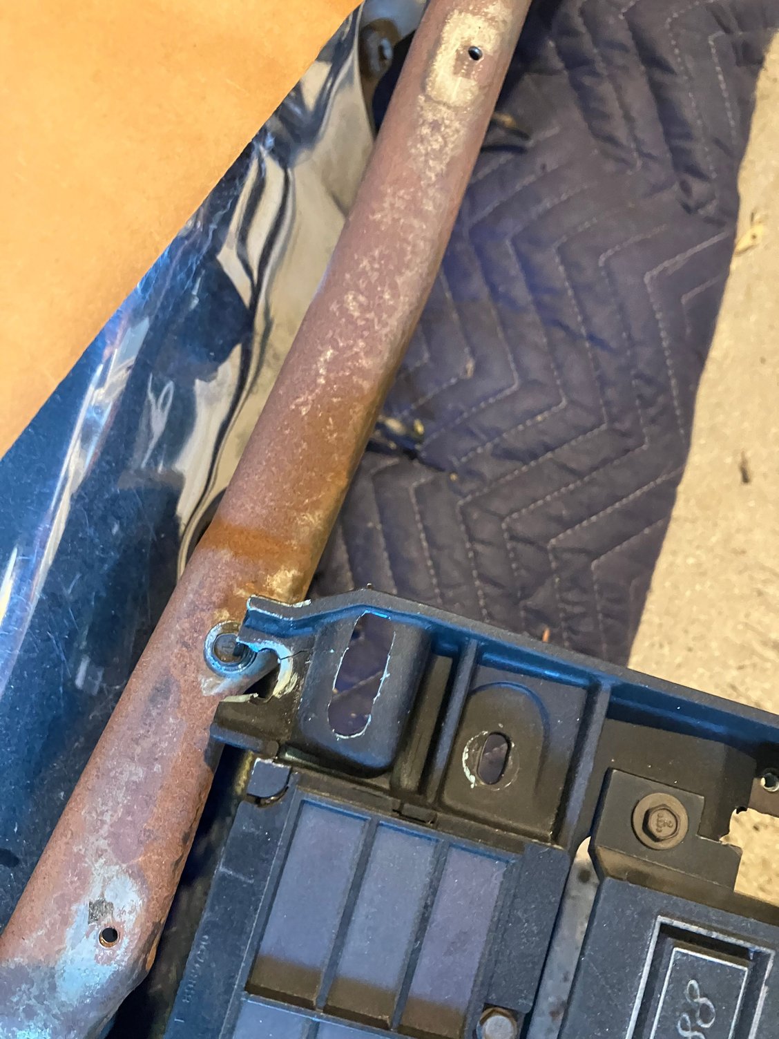

So unfortunately the top of plastic frame that sits underneath the dash and holds all the instruments, gauges, radio, etc cracked when removed and reinstalled.
The bottom held strong but two of the upper screw holes just kinda disintegrated on me… Bummer for sure… But… Not all that surprising given it’s almost 50 years old .
I tried some washers for now. Just a temporary fix. Any suggestions on how I might better repair it to give it some more support ???
Thanks

Comparing the dash photo from your other thread you don't have all the steel support brackets in place which is causing alignment issues. The piece you are screwing in is hanging lower and away going from left to right where it's supposed to be connecting to the steel cross member. Because it wasn't flush and aligned the tab could only be stretched so far and snapped because it's only plastic.
Not an easy task of what you are tackling. If you find you are forcing parts, stop and look carefully at how the pieces are going together, check your photos for reference to see what is different and study what is causing the issue.
As far as repairing the broken tab, I saw a video some years ago on youtube of a guy who repaired the plastic tabs on his headlight housing that was similar to what you need done. It was a pretty clever repair and it held up good after. Sorry I don't have a link to the video but I'm sure you can find it if you do a search.

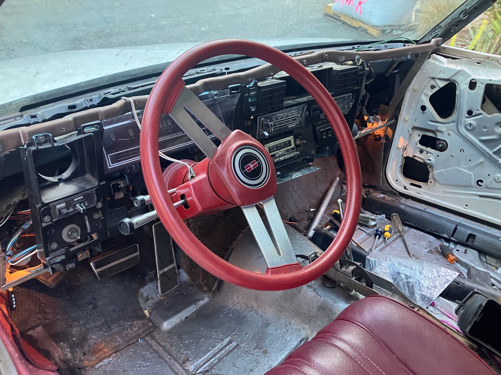

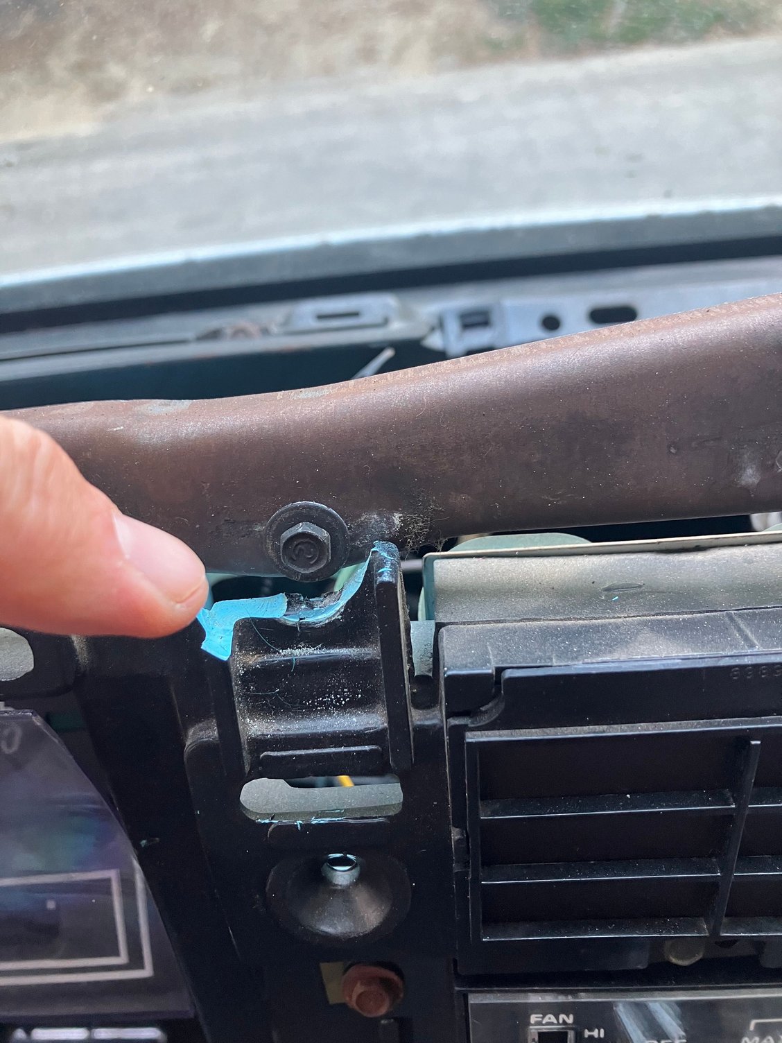

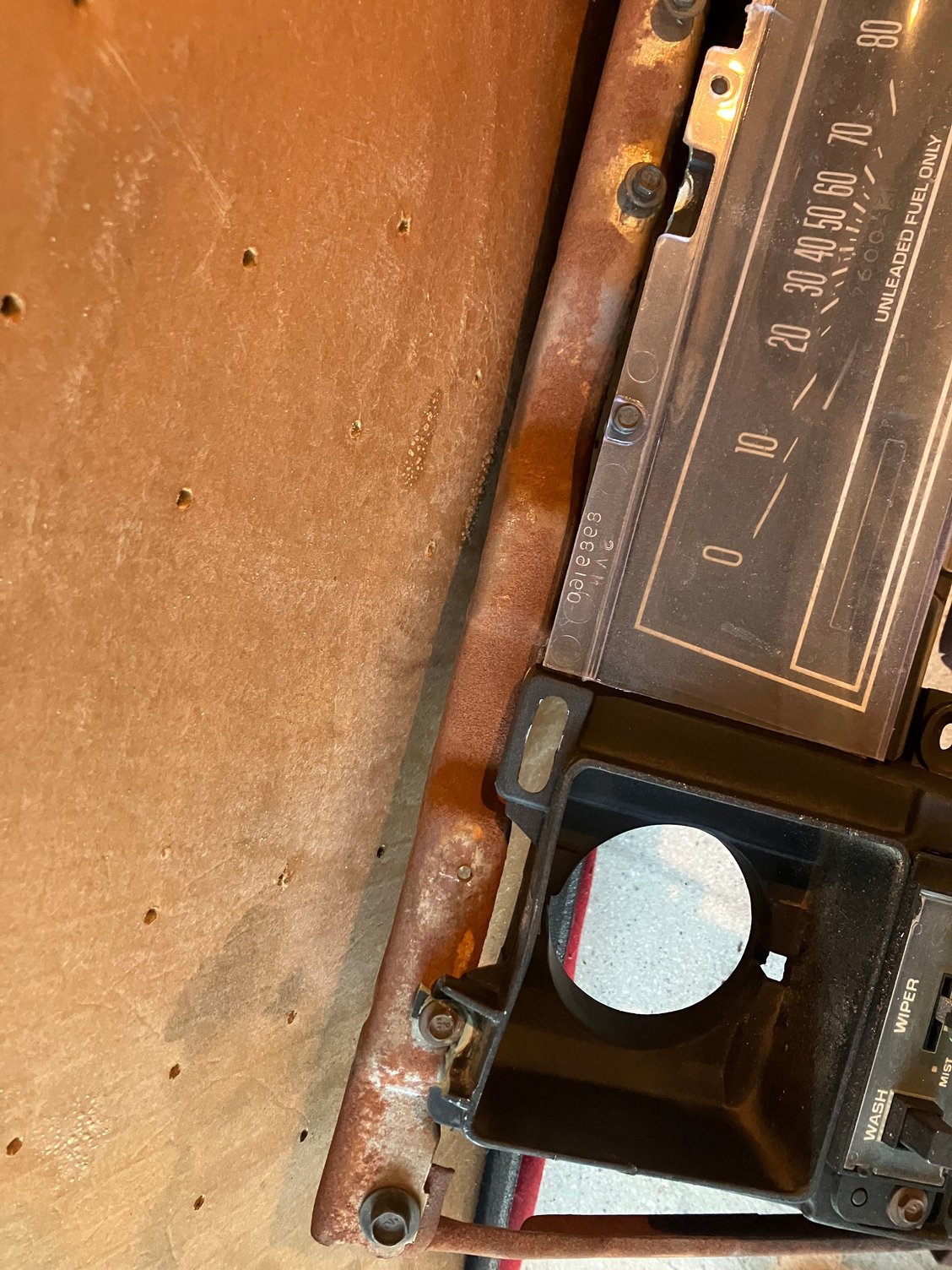

Thanks. Yeah it’s a bit of a challenge. I do have all the same steel support brackets in place (see photo 1). I swapped the entire frame over so the plastic dash itself never came out of the frame.
It seems maybe the upper plastic tabs are just prone to cracking on these?. The other dash has the same problem. And again it’s still in the metal support frame (see photos 2, 3, 4)
As for fixing it, I will figure something out. Probably fabricate a small metal “bracket”
