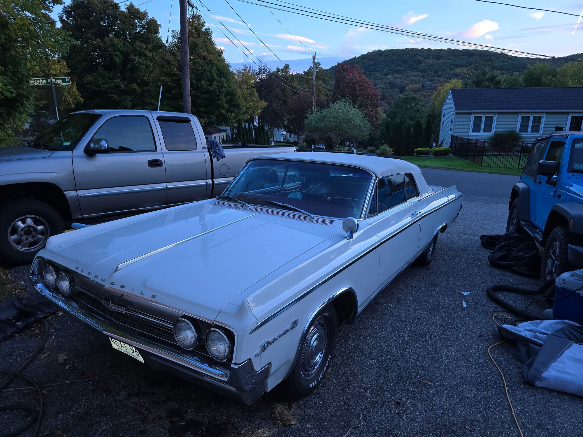

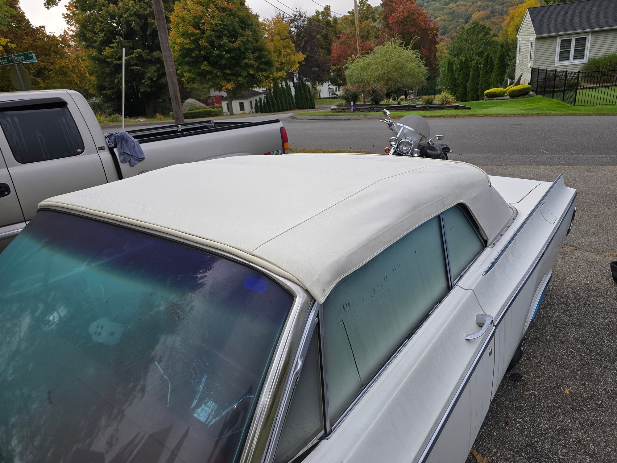

I'm thinking this belongs in the "upholstery" forum, since interior shops typically do tops... I've been installing a new top on my 1964 Dynamic 88. I've never done this before, and I planned to do a whole tutorial/youtube video, but this is so far outside my skill set, it's learning by doing with this. I just wanted to share a couple quick pictures since I'm getting close to the last steps...

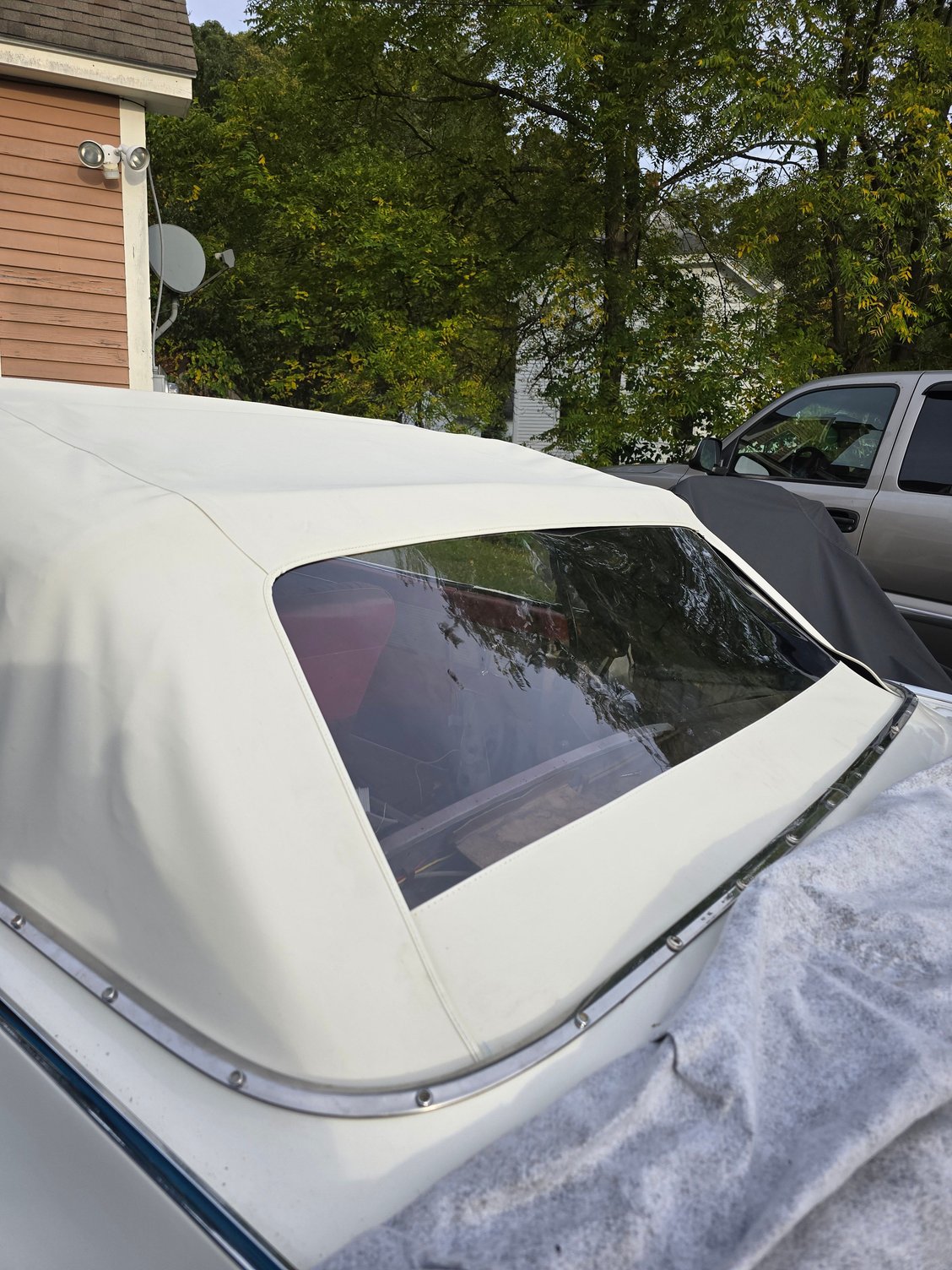

This is your typical 2 piece top, where the rear window piece is called the "curtain" and the rest of the top fits over it. Getting the curtain right is the first most important step. Between the rear bow and the tack strip at the body, you have to get it to stretch and be wrinkle free. The process amounts to making your best 1st guess, test fit, adjust, test fit again, adjust again, over and over until you get it where you like it.
I finally have it pretty much where I like it, so I'm sharing some pictures... the rest of the top comes next...
I know the "sail panels" are still wrinkled, I'm not done yet
Back window looks good, but there's still work to do on the rest of the top

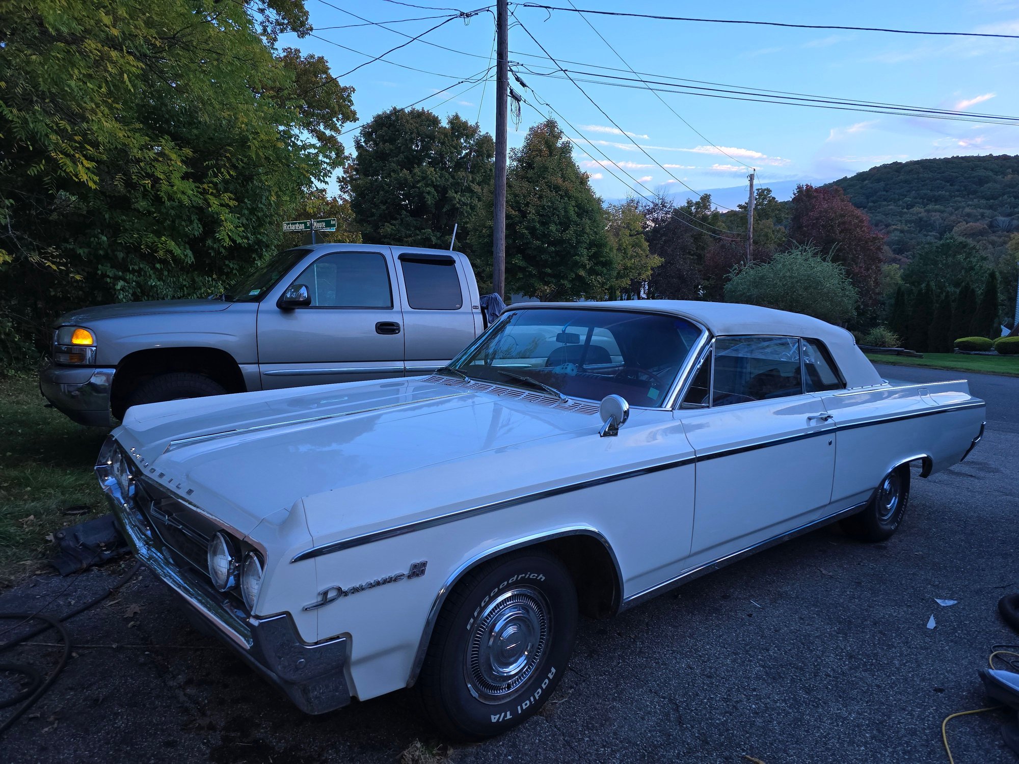

It's done, and it came out pretty good I think. Would I suggest doing this yourself like I did? I'm not sure- It was really hard to get it right. I'm glad I took on the project, but I can see why it costs so much to have it done, and why there's only a few shops that do it.
pictures taken at sunset
I love the white top, better than the black top I think
You're supposed to leave the top up for a few days, so it stretches as I understand it
It's not perfect, but I wonder if they ever are?
