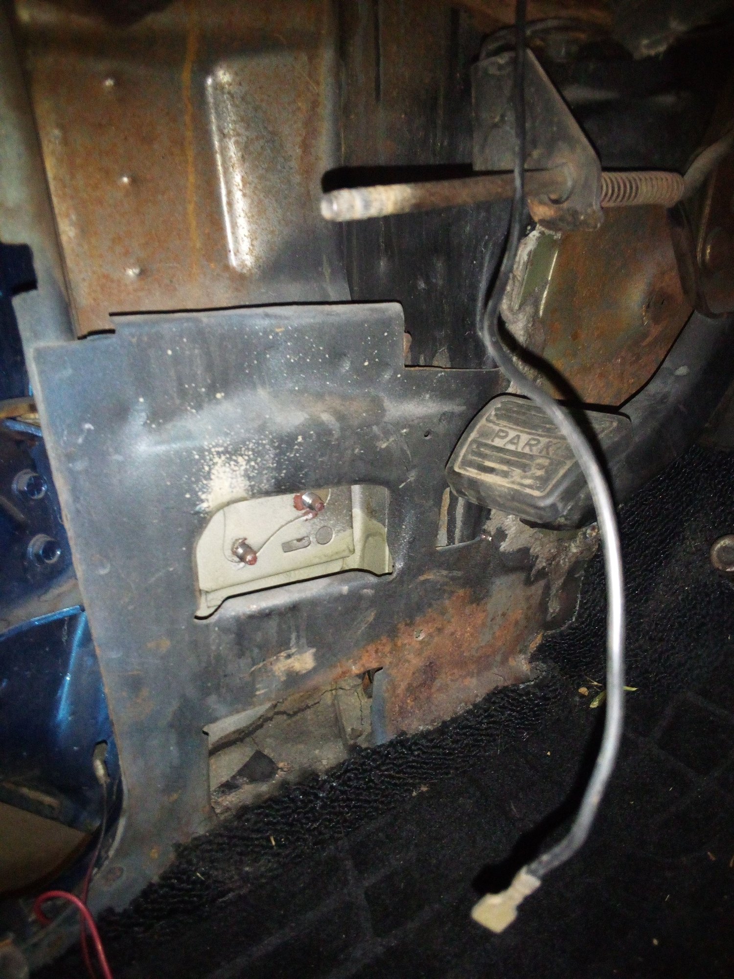

Not exactly sure how to term this piece which is making it difficult to find. Any help or advice would be greatly appreciated!

If this is a Culass/442, you can find these parts at OPGI or many other places.
They’re called kick panels. The factor ones had no provisions for speakers. What I see are aftermarket replacements molded to accommodate front speakers.
There are tons of these available. Happy hunting. This should be easy & fun.

The remainder of the old (broken) e-brake can just be popped off correct? Whats the process on installing the new one? Thanks in advance.

Not that easy. You probably won't be able to just pull it off. Those handles were pressed on and TIGHT. Get some wire cutters or a fine small hacksaw to remove what's left on the metal "pull rod".
Similar thing on installing a new handle possibly (on NOS GM replacement handles I've installed)...basically impossible to push on into place. Maybe repro handles are different...haven't tried this w/any repro handle. NOS GM handle required some careful enlarging of the hole (drilling) to create a bit more room and then it probably helps to mix up a small amount of epoxy and put that in the hole to help once the handle is jammed on. You don't want it to be such a tight fit that you need some serious hammering to get the new handle on (handle can break from hard hammering).....then again, you don't want it so loose that the only thing holding it on is the glue.
You'll also see that the end of the metal rod is splined (once you remove what's left on there of the broken handle)....so you need to pay attention to installing the new handle in a level position (ie - splines also prevent rotation of the handle once it's pushed on over the splined part of the metal pull handle/rod).

I got off easy, was prob a reproduction as vice grips did the trick.
