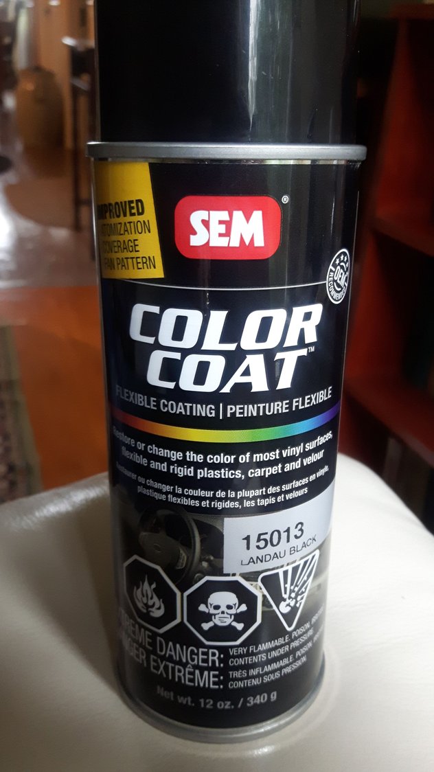

That's very ingenious, much nicer than an empty space between the seats. Great job.
SEM Color Coatings is an option for respraying the console in one step after it has been cleaned.
