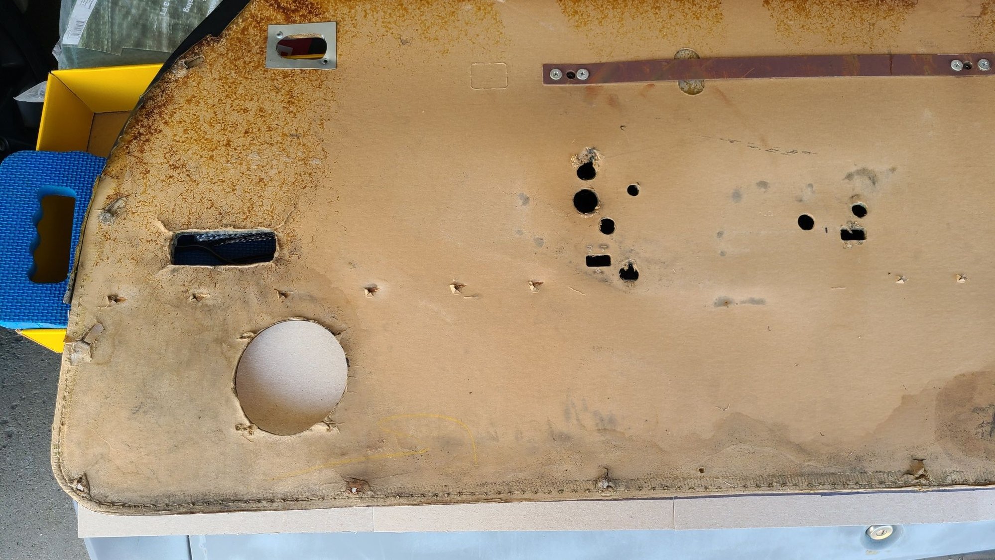

Hey folks,
I bought new carpet from Fusick for my door panels. I haven't had a chance to mess with it yet but I'm wondering if anyone has some tips. I don't want to damage the panels, seeing as they cost more than $400 these days.
Just pop off the chrome trim, pull the old carpet off, maybe sand and smooth a little, then use contact cement for the new?
Help appreciated.

Originally Posted by Macadoo
Hey folks,
Help appreciated.
Pretty much. I did it once; just be careful and slow, it is glued to cardboard. A sharp knive, like a carpet knive will help seperate.

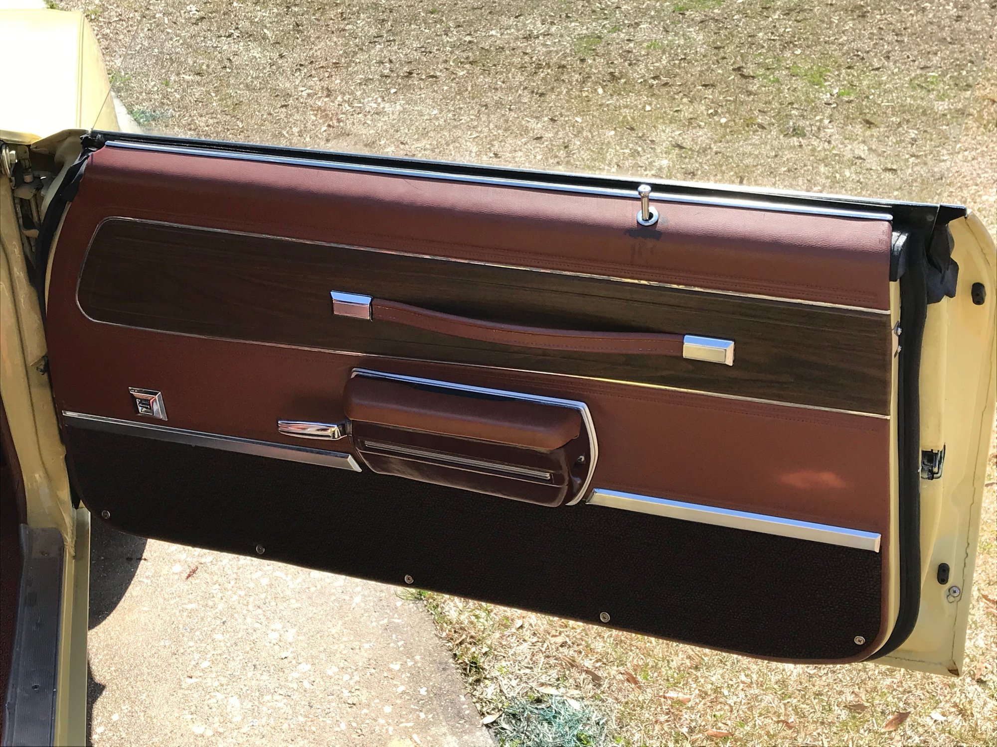

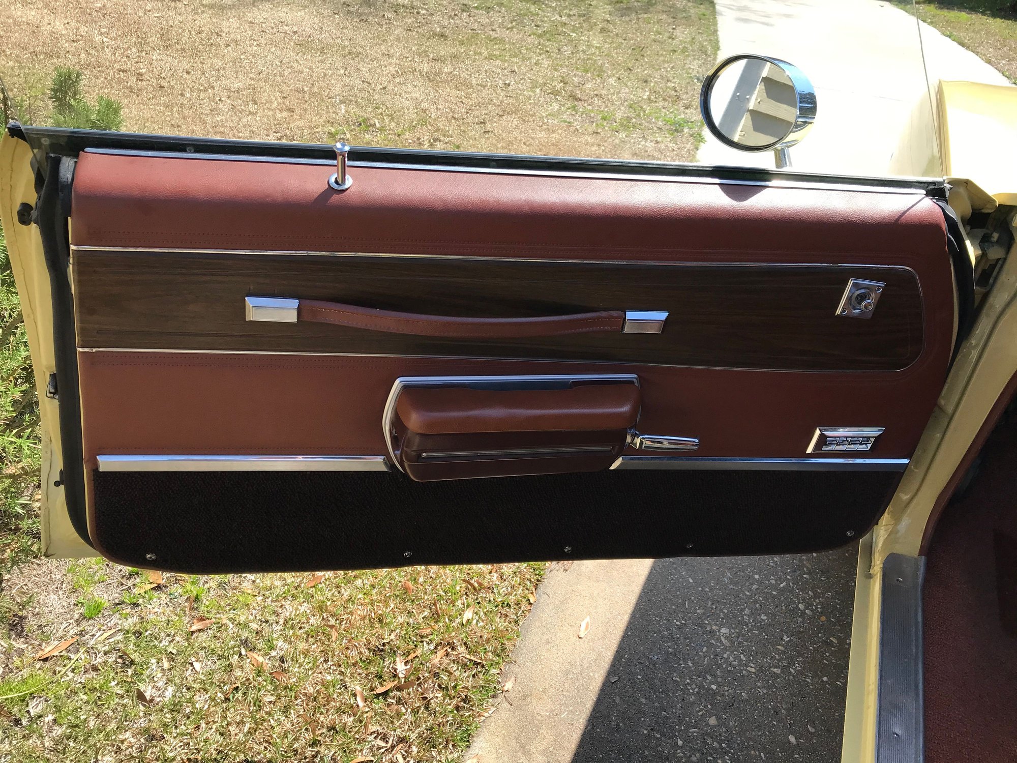

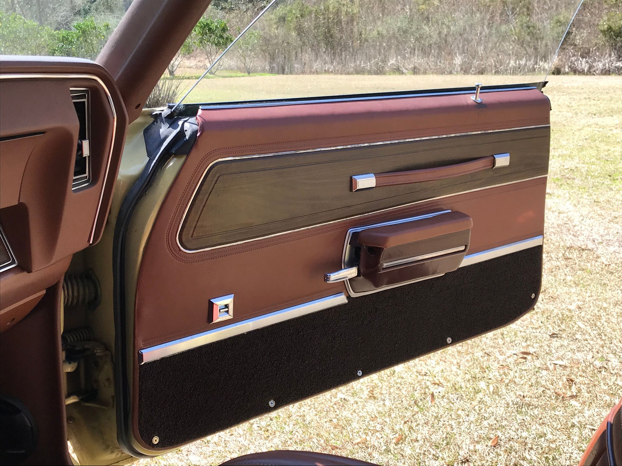

I replaced mine a couple years ago.
I used some card stock to fill the old speaker holes and to re-enforce the lower section

Those look great! And pictures definitely help, thanks guys. Hoping the carpet arrives soon.

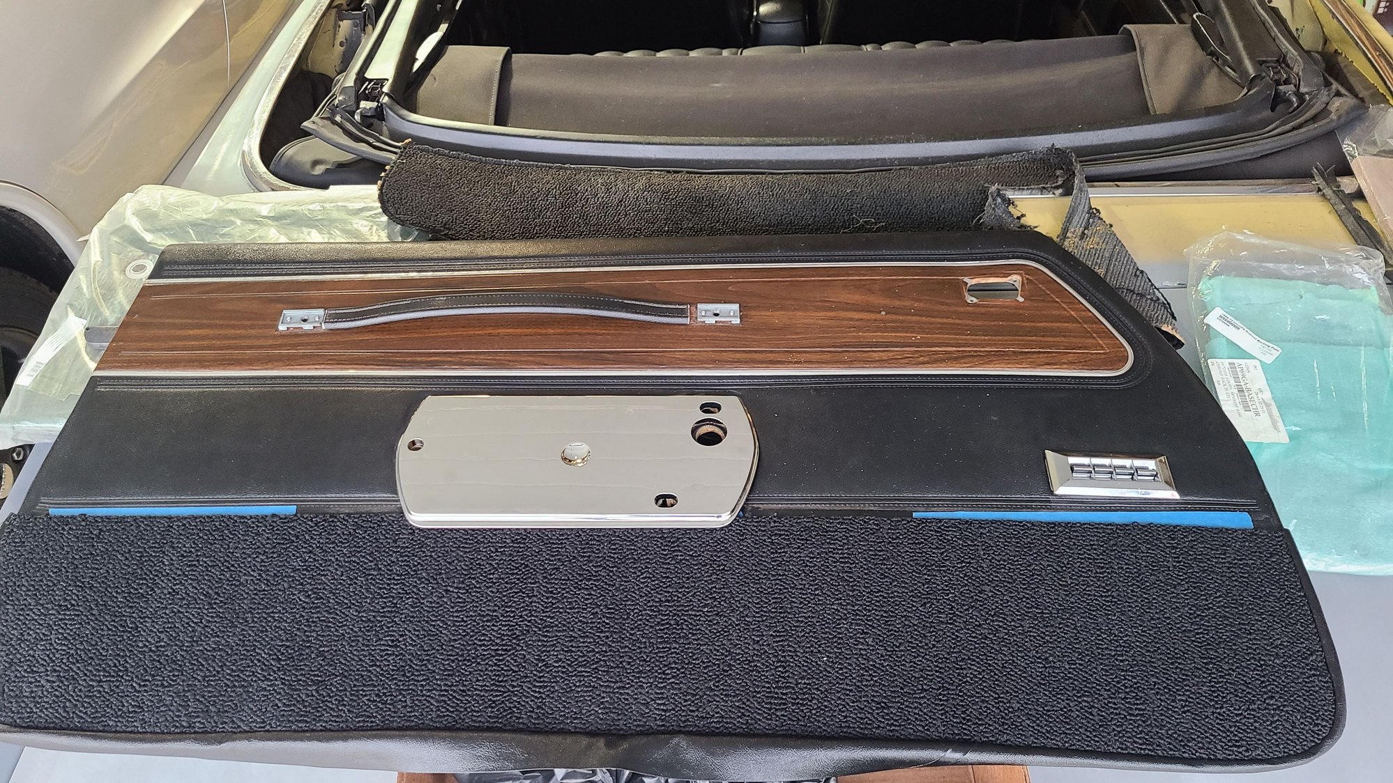

Okay folks, so I got the carpet from Fusick in three days, not bad! Everything seems pretty straight forward, other than keeping the shop warm enough for the contact cement, but I'm not real worried.
