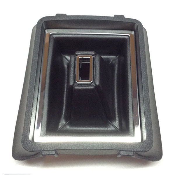

http://www.protoyzinc.com/product.cfm?id=12
Finally found a picture.
I've seen one of these @ The Parts Place.
I had no idea it was an Olds console tho. They are definitely different.
It's not the same console. 90% similar, but that shifter boot section
is wider then then the narrow sections in front and behind like the Auto
Consoles use the entire length.

Originally Posted by Aceshigh
It's not the same console. 90% similar, but that shifter boot section is wider then then the narrow sections in front and behind like the Auto Consoles use the entire length.
It is 100% the same console. The score marks are on the underside for exactly these cutouts. The adapter that fits over the top and holds the boot also covers the cutouts that go past the sides of the center portion. Note the part in the left of this photo.
I can't possibly see a conversion being possible without hacking the center of the auto console to open it up more. I'd rather sell it and have no console then do that.
That is exactly how the factory did it. The same molded piece of plastic was used for the console on all three configurations - A/T, Dual Gate, and M/T. It's well documented in the CSM.
Besides, I really don't know where the shifter will end up yet for the transmission I'm going to be using.
That's a whole different problem. You've obviously got three choices on shifter location on the T56, but whether any one of them is in the right place is a question that can only be answered with a mockup of the installation. Since the console is tapered, the four speed adapter shown above only fits in one location. You cannot easily move it forward and backward to fit the shifter location.

Okay, so it IS the same console.
So I have to do some cutouts on my existing auto console to adapt those pieces in is what you're saying. That makes sense. I just couldn't see it being a drop on top and go sort of thing.
