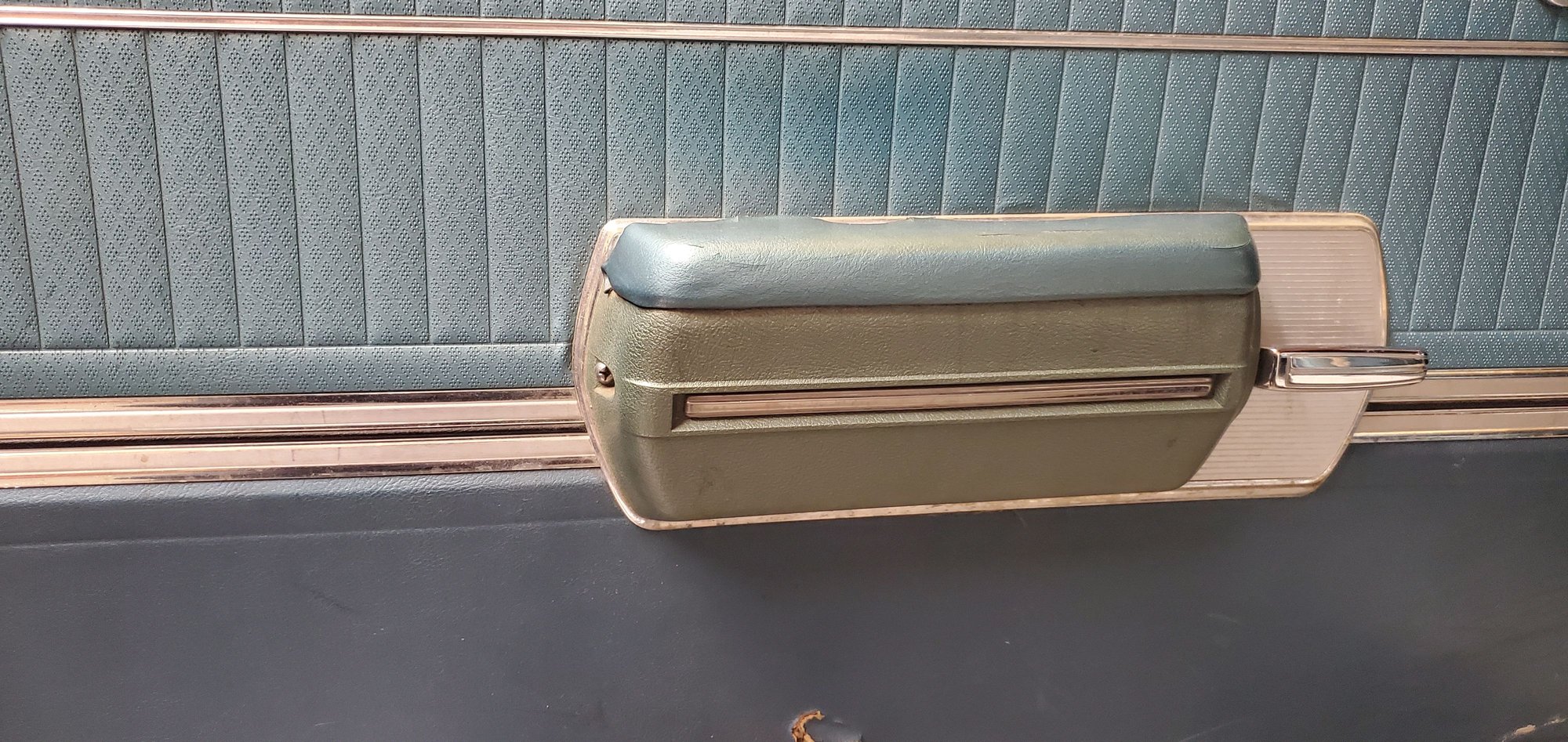

As you can see from the attached photo of my armrest base that the plastic, as well as the rest of the plastic interior trim, has turned from blue to green. Most of the reproduction stuff comes in black only and they state that you must "paint to match" your interior. The problem is that I understand that the color was put in the plastic during the manufacture of the parts and was not painted on afterwords. Now I need to find what to use to paint plastic and what color choices I have. SEM makes a product that works well on plastic but I'm not sure which color comes closest to what was originally used. Any suggestions? Thanks.

I'd just find a close SEM color and go with it. No one is going to be able to tell if the shade is off

I can't seem to be able to find a color chart to compare. I was just hoping that someone with the same color interior as mine would have SEM color number. I guess that I can get a can of each of their blue colors and spray some of each for comparison.
