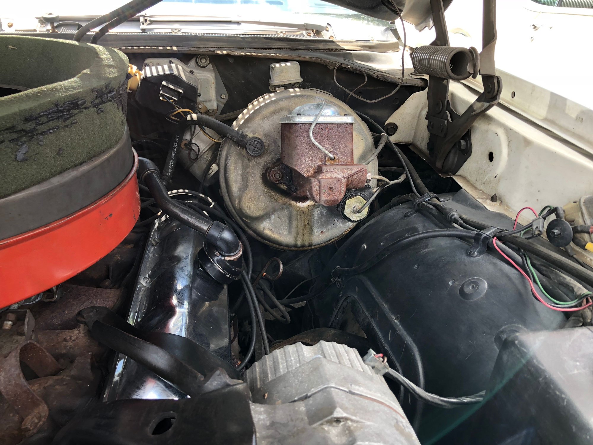

This is a photo of a A/C car that is pretty much all original that was at the HO Nationals in Indy a couple of years ago.
Appears the posi cable has been changed, however it also appears that the routing is over the fenderwell. It still has the battery cable tube and fenderwell retaining clip down low, so it suggest to me that only the cable has been changed but the original parts are still intact.
Hope this helps.
