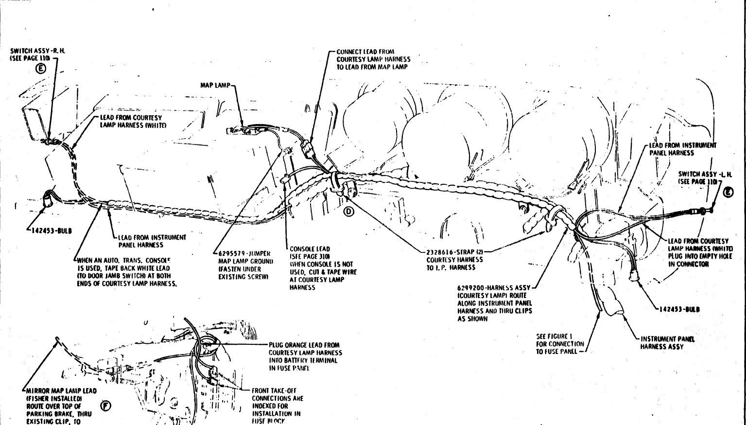

Hey Guys,
I'm in trouble I'm putting interior under the dash courtesy lights that shine down on the floor can't find OEM LOCATION for them - does anyone know or have a schematic there isn't one in the manuals Olds or Fisher nothing - Need your HELP these go on the driverside & passenger just where to screw lamp brackets w/lamps inThanks for HelpingAlsmith787

There should be a hole in the metal which is where you insert the lamp receptacle - they each just plug/snap into the hole.
Old Aug 1, 2022 | 05:07 PM
Posts: 26,026
Bulb 142453

I ended up connecting mine to one of the door pin switches. They come on with the dome light when you open a door, but do not come on with the dome light when you turn the headlight switch.

Follow the wiring diagram in the CSM.
