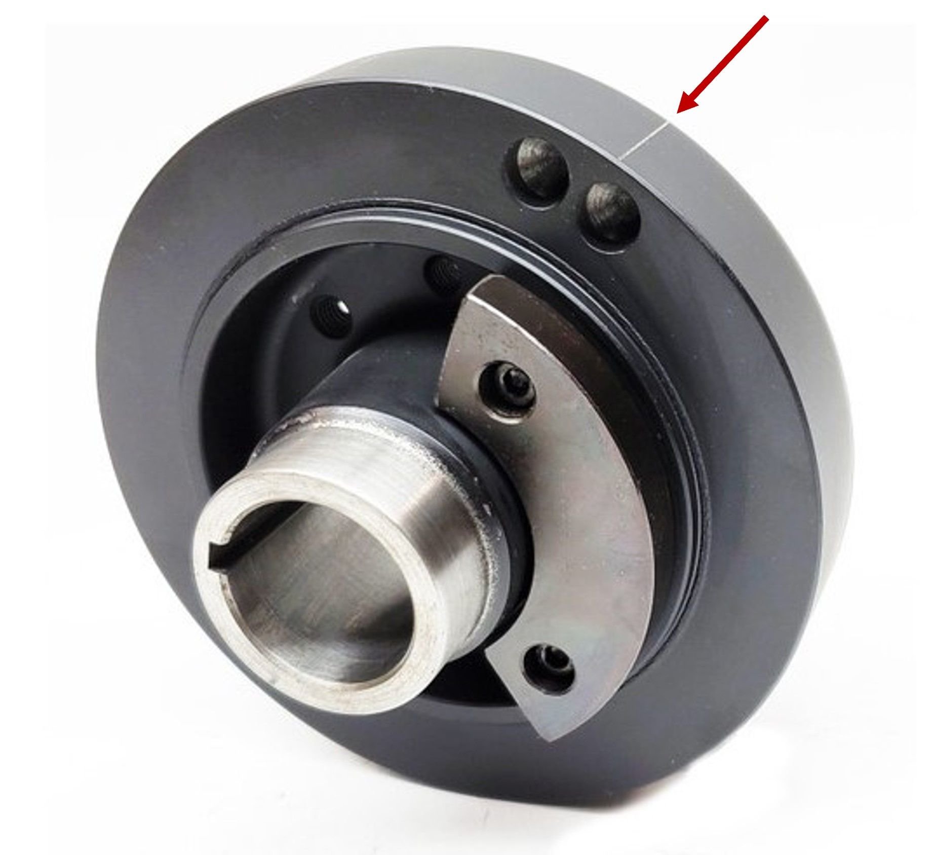

You need to first find the timing mark located on your harmonic balancer. It is illustrated in your CSM. You have a transplanted 455 cid engine - so, you may not have the specific timing mark as per the CSM and perhaps not even the OEM original harmonic balancer (damper). But before you can proceed in any direction, you must first find the timing mark on the balancer/damper. Who knows what it's going to look like? Non OEM? Aftermarket damper/balancer? Who knows? You'll need to get under the car and find it.
Using your fingers and importantly your fingernails (work best), maybe a scribe or small screwdriver work your way entirely around the harmonic balancer looking for a very fine small groove. Once you've located that groove, that is your timing mark. Using white nail polish or anything of similar adhesion and visualization, run a straight white line on top the timing mark on the harmonic balancer. Regardless what type timing light you use, you must first find the timing mark on the harmonic balancer/damper to do anything related to timing. Get under the car on the ground and begin feeling and visualizing (with a flashlight). That's the first step.

Thanks, yes I was able to find mark, and adding some silver marker to it. it was not showing with the timing light gun(?) but did eventually show when I turned over the engine briefly a few times.

White is a little better to visualize, none-the-less you have the mark correctly identified. As per previous suggestions, follow Post #2.
