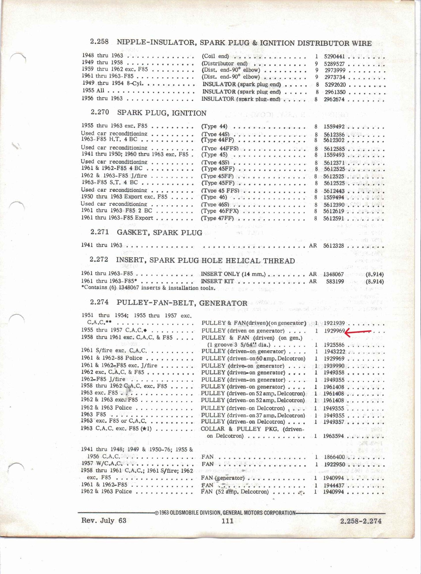

Originally Posted by foxtodd7
Anyone know the Original GM Part # for the pulley?
Looks like 1929969.
