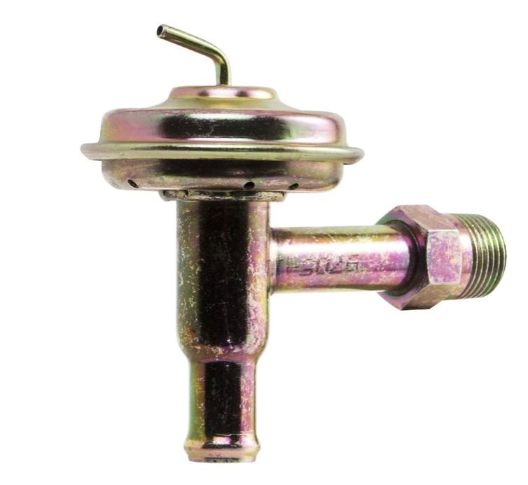

Do you mean one of these?
My understanding is that this valve closes at WOT (when the vacuum goes towards zero) to restrict the flow of hot coolant to the heater core to prevent the pressure from causing the heater core to leak or burst. I could be wrong on the specifics, but it is unrelated to the flow of air through your vents.

The vacuum signal for the HVAC system doesn’t change at WOT due to the vacuum reservoir on the firewall - it has a check valve and maintains the vacuum when the engine vacuum decreases.
The thing that prevents blowing out the heater core is the 1/4” restriction in the base of the heater valve on AC cars and the hose nipple on non-AC cars.
Which brings us to this: non AC cars do not use the vacuum controlled valve. They use a restricted hose nipple.

Another thing to be aware of is there are two versions of the vacuum heater valve. One is normally closed and opens with vacuum applied, and one is normally open and closes with vacuum applied.

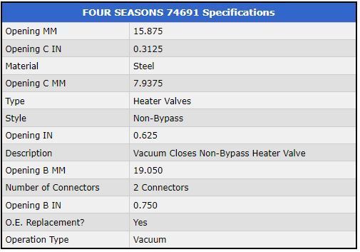

So you have a 1977-era heater valve that is connected to a constant vacuum source. Your problem is the heater valve is normally open and vacuum closes it.
https://www.rockauto.com/en/moreinfo...HTlxyxpQIBUuXW

As said previously, there are two heater valve designs. The early style is normally closed and opens with vacuum application, and the later one is normally open and closes with vacuum application. The HVAC control design was changed somewhere around 1971 or 1972, which is why there are two different style heater valves. Since you have a 1974-1977 intake manifold, you have the later style heater valve - the threaded section of the valve is a different diameter between two styles so they do not interchange (Opening B in the info below).

Thanks; i just looked closely at the valve and it has a 3/4 to 1/2 threaded adapter on it so the earlier version ( open with vacuum) can be installed on the manifold. Good to know, I'm going to pick up a spare one so when this one goes i can plug the new one in and not go crazy looking.
I think my no heat issue is related to a none operating blend door. Either the cable attachment broke or came off im guessing. Got to figure how to get to it first and see.
Old Oct 28, 2021 | 05:22 PM
Posts: 15,409
As Joe already said, get rid of the vacuum valve and install a restricted nipple.
Using the vacuum operated heater control valve with a hose to manifold vacuum is kind of silly. Just replace it with a heater-only nipple. The main downside is that the valve is a potential leak point - the seal around the vacuum actuator that operates the valve is prone to failure. Plus, it can corrode and stick in position. Why keep it?
If you feel you must use a vacuum operated valve, remove the adapter and use the valve that directly fits the manifold and doesn't need vacuum to open, and leave the vacuum hose disconnected. But that just ends up being a restricted nipple...
