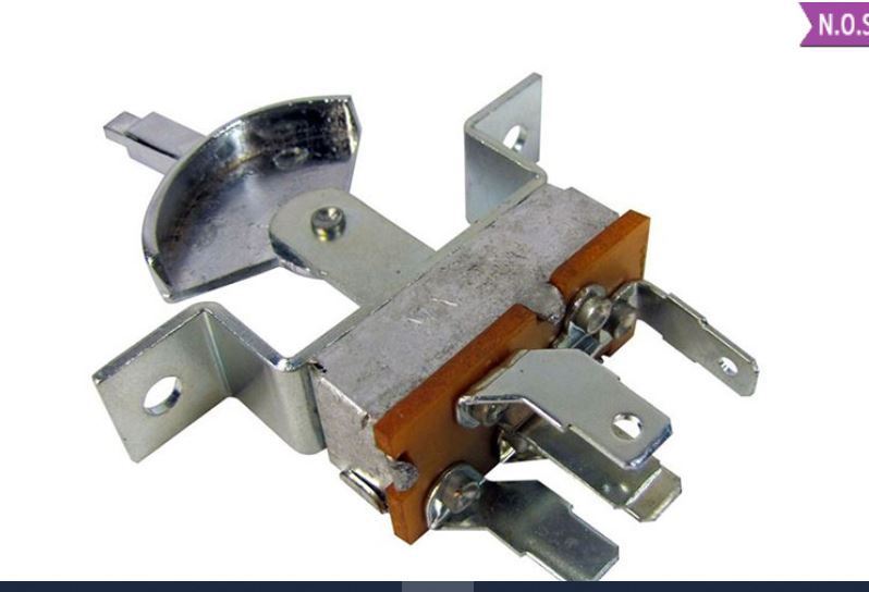

Hello experts,
1970 Cutlass S
Need to replace my faa blower switch on the climate control panel. Does anyone have any ideas/tricks about replacing this from underneath the dash? Removing the whole dash just to replace this switch is out of my league.

You can try removing the instrument cluster and going in from the top thru the clock opening. Going from bottom will require removal of the underdash airconditioning lap cooler manifold and a whole lot of contortions unless you remove the seat.
Should be a 1/4" or 9/32" hex head screw holding the switch to the control head. A magnetic socket helps here.

second towhat Rocketraider is saying. No need to remove the dash. I definitely needed to remove my seat, getting tougher and tougher to get under the dash as I aged !! Seat is easy to remove...….

Oh my gosh - two hours to even get the top hex head screw out going through the clock gauge hole. No idea how I am going to get the bottom screw out let alone put the new fan switch in... Sigh... 60's technology with 6'-2", 240 lbs hands in a hornets nest of cables...
Lord - find me the patience and expert to help...
