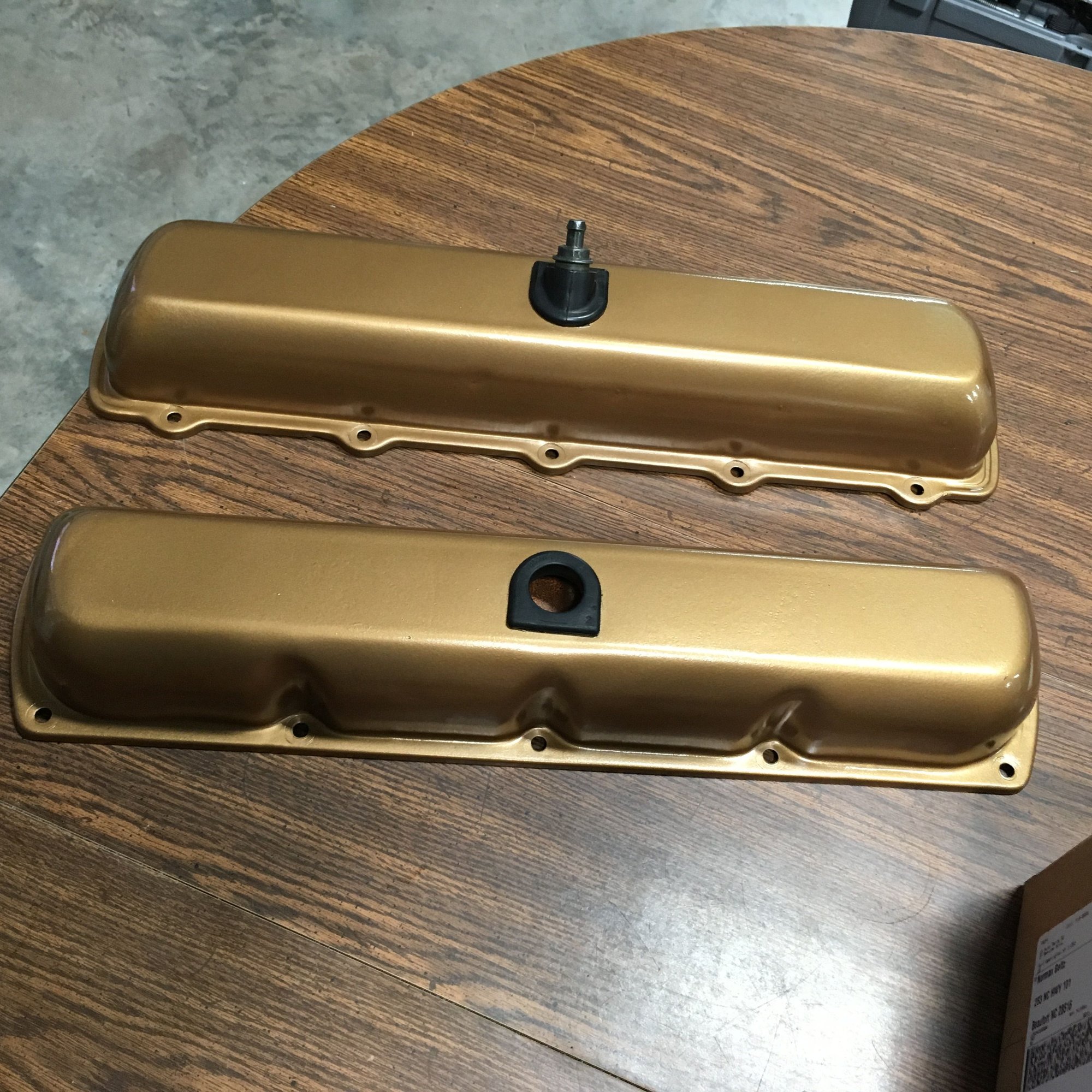

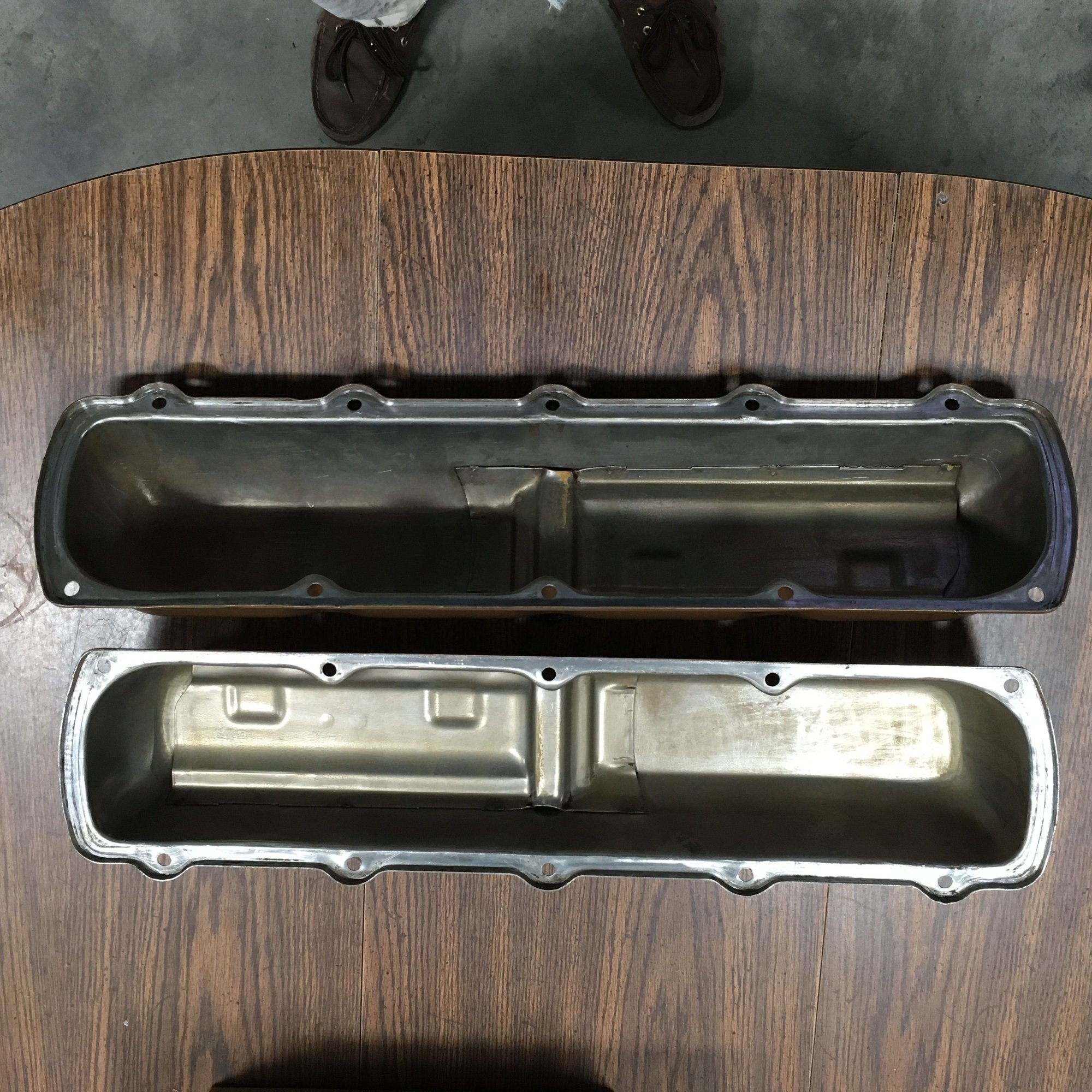

The valve cover w/ the baffle is (obviously) expected to weigh more. I used EZ Off oven cleaner but any oven cleaner will work just fine. You can also use GUNK engine cleaner. Any of those products does an admirable job of cleaning the baffle. Put the valve cover into a pan (of some type). Liberally spray the baffle and apply numerous applications of whichever product you choose. It took me a couple days to be satisfied I'd removed all the built-up debris. Do a final rinse w/ brake cleaner or similar, then a final water rinse. Use an air compressor wand to blow out any remaining gunk. Images are from my 350 intake manifold valve covers before &/or after painting.
