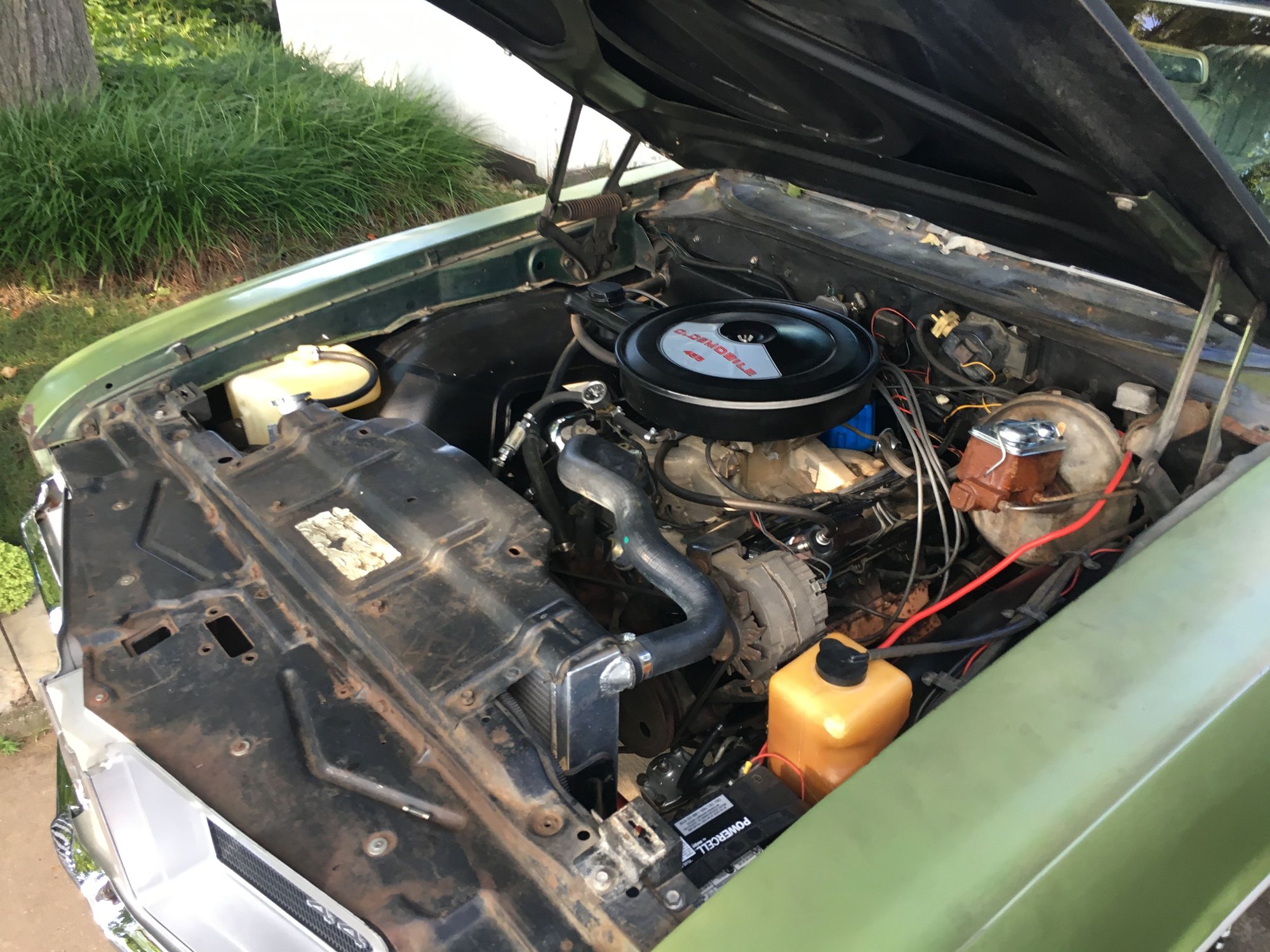

Hi all - just got done with front end build and been running it past couple of days - stopping / steering / riding nice ... today I got in on the highway - around 65mph i could tell it was missing a bit - on the way home from a stop sign it had a major hesitation / lurch - then sputtered / backfired / and stalled - fired right back up but I want to dial it in - here’s the history ... feb last year I rebuilt the quadrajet and the distributor - mechanical advanced was seized - and so was vacuum advance - the previous fall it would barely run - I replaced the points and condenser with blue streak and gaped it with feeler gauge then bought a dwell meter to dial it in - new ignition coil - plugs and wires are from three summers ago but didn’t run it a lot - did away with electric fuel pump and went back to mechanical - have in line filter and carb filter and a pressure gauge - the pressure looks good (not seeing it at highway speeds and it does bounce but I’m sure that’s from the accuator / lobe action) the intake manifold is a performer so no heat stove so no choke - just wired open for the time being - 68 455 c heads - aluminum performer intake - stock exhaust manifolds - 72 quadrajet - points distributor - any ideas? Thanks gang

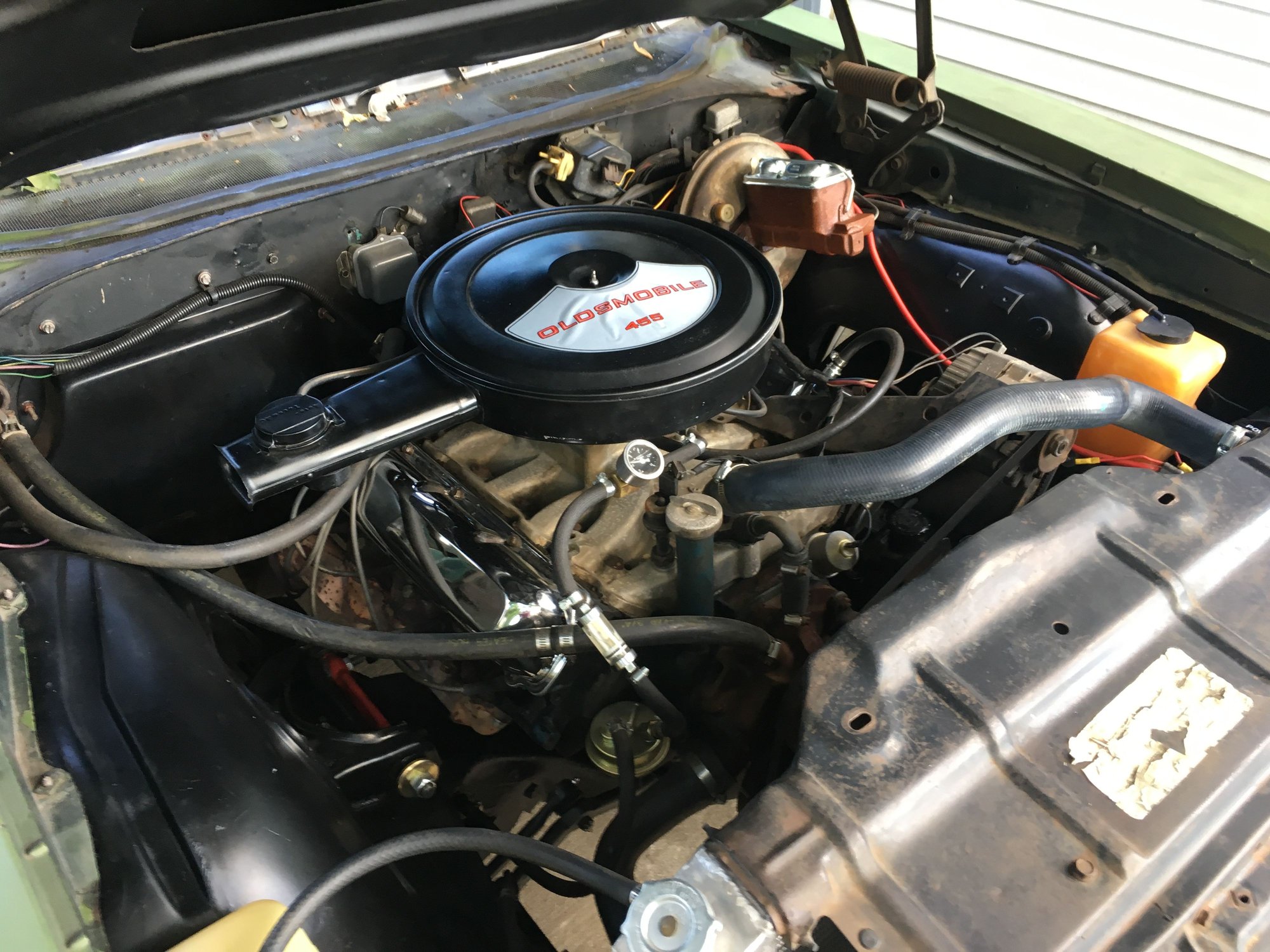

Originally Posted by 72442455
...did away with electric fuel pump and went back to mechanical - have in line filter and carb filter and a pressure gauge - the pressure looks good (not seeing it at highway speeds and it does bounce but I’m sure that’s from the accuator / lobe action)...
You might try this first. You ONLY need one of those items I've identified in the above. Remove both the in-line filter and the pressure gauge. Start driving w/o those items installed in the fuel line. Additionally, ensure the fuel line attachment point to the carburetor is as nearly straight as possible for a minimum of about 3" - 5" before entering the carburetor. I can't tell completely from the image, but it appears there's a rather sharp nearly 90* turn directly after the pressure gauge to rubber hose then the metal line. Remove that 90* turn and ensure a nearly straight-in fuel delivery into the carburetor. I'm not certain I agree w/ you regarding the pressure gauge bouncing around is from the actuator; and, if it is, it shouldn't be bouncing around - you want unimpeded fuel delivery into the carburetor. I don't believe you're buying yourself any advantages w/ an extra in-line fuel filter and a permanently installed pressure gauge in the fuel line. Personally, I'd ditch those items and fix that kink then drive it for a couple hundred miles to see if the problem persists or goes away.
Old Aug 10, 2019 | 08:25 AM
Posts: 42,475
Leave the fuel pressure gauge and lose the inline filter. That filter is a fire hazard. You only need the one filter in the carb. You may see a fluctuating pressure as the opens and closes to let fuel into the carb and fuel pump actuator going up and down. As long as you stay around 6#'s of pressure your good. Doubt the 90* fitting is an issue unless the ID is less than 5/16ths. Before spending any money double check your tuneup settings and take a look at the plugs to see what they are telling you.
