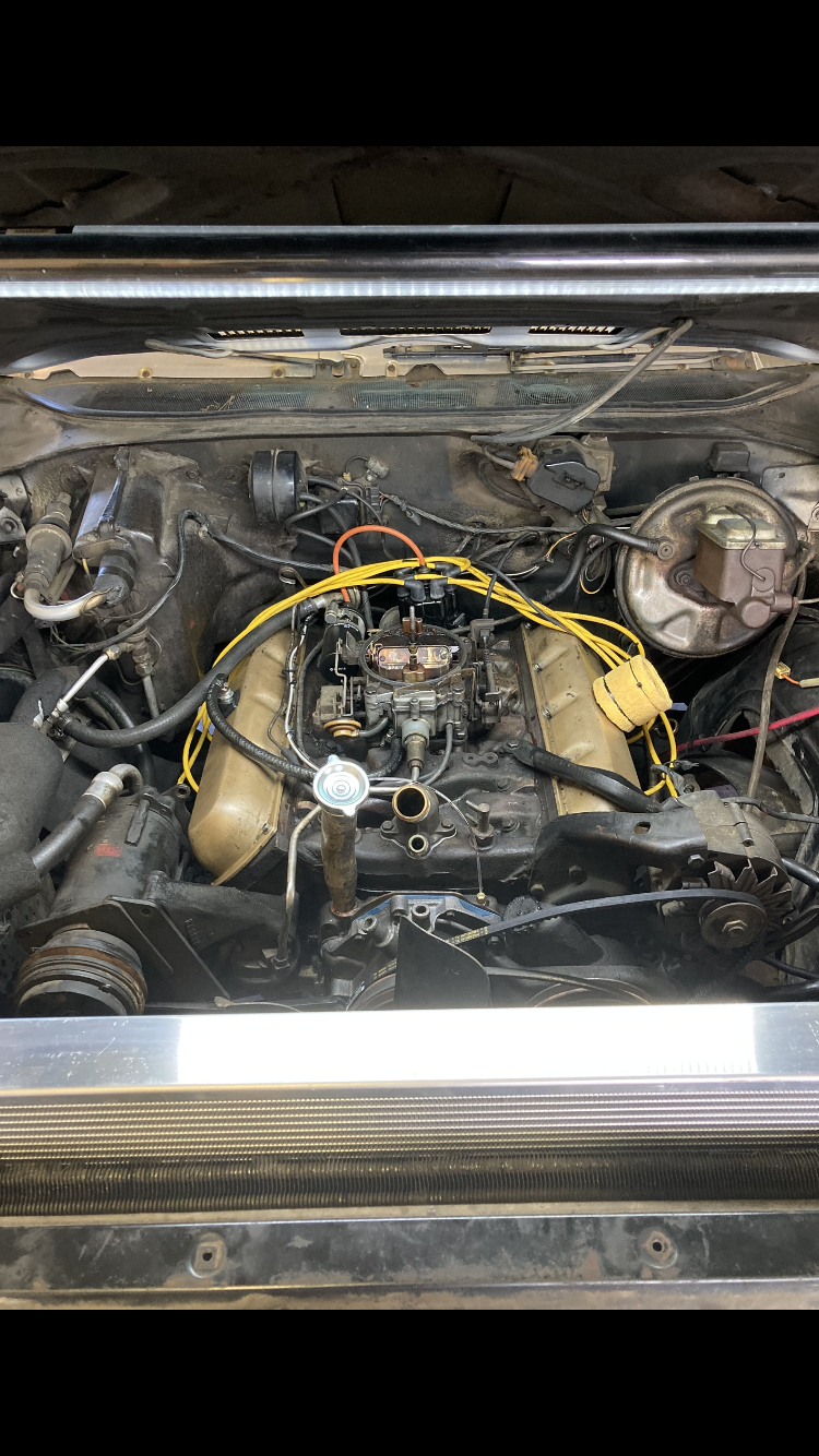

You have a 350 as well? My alternator is on the drives side, and has a bracket that certainly won’t fit. Can I ask about your passenger side alternator set up?

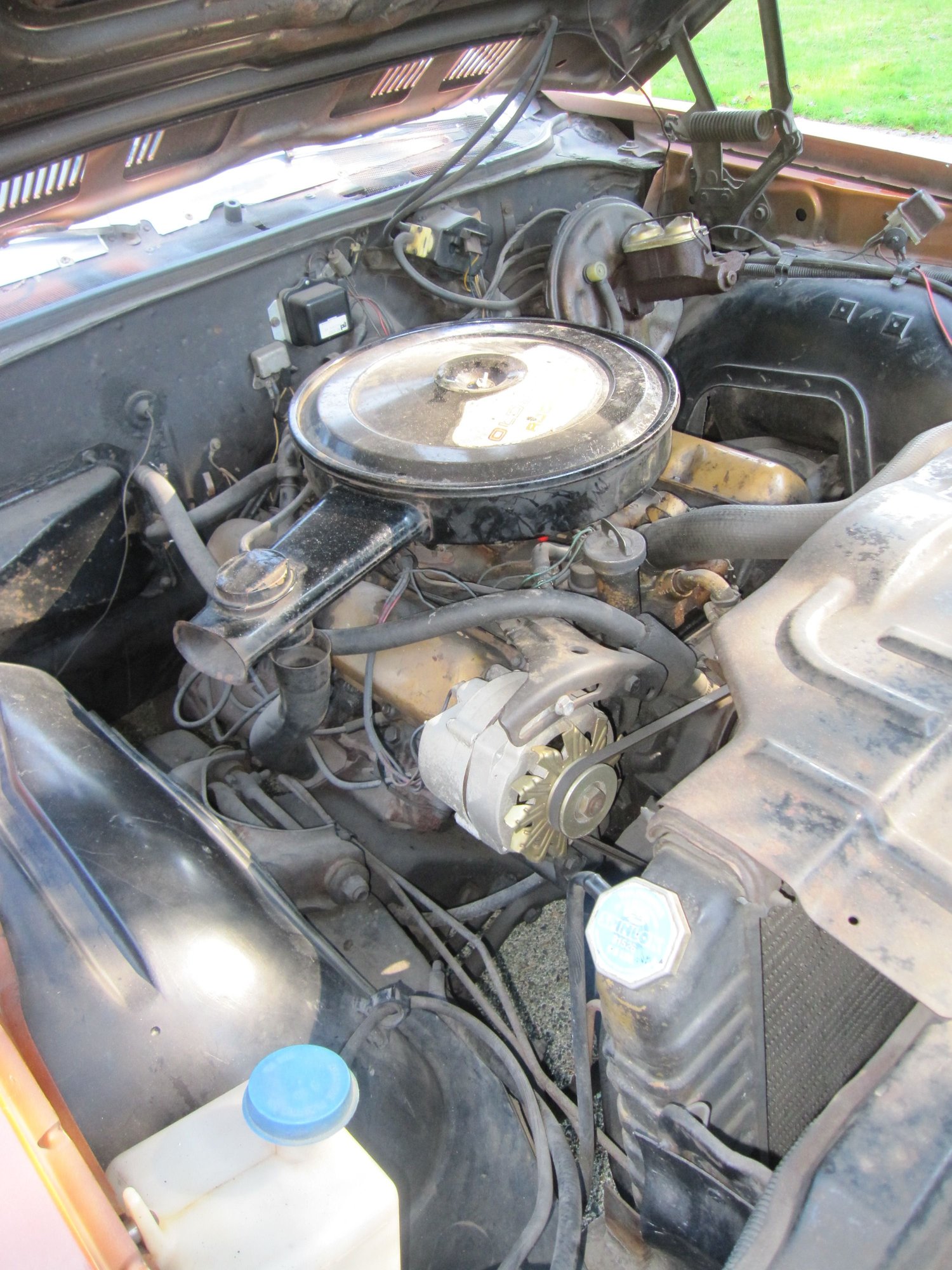

...or, your "factory" ac bracket looks eerily similar to my alternator bracket! Here's the same setup in my all original '71 Cutlass with the 350.

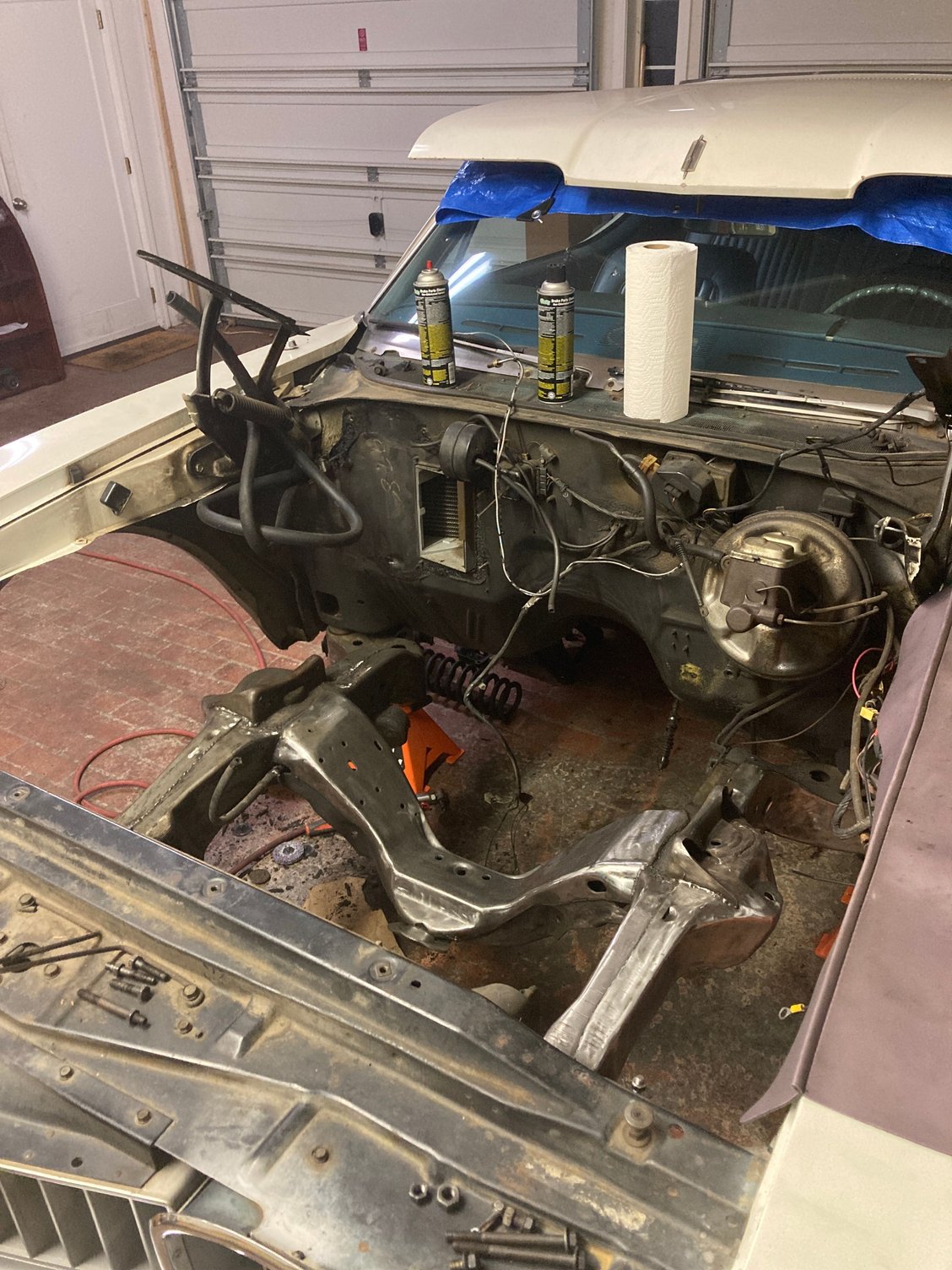

I was wrong haha it’s been a few months since I took it apart.
This is where I’m at now. Just pulled the ac and am working on cleaning the frame rails. I’m thinking about ordering the opg ac delete heater box. Or potentially making my own. It looks like the heater core needs replaced too.

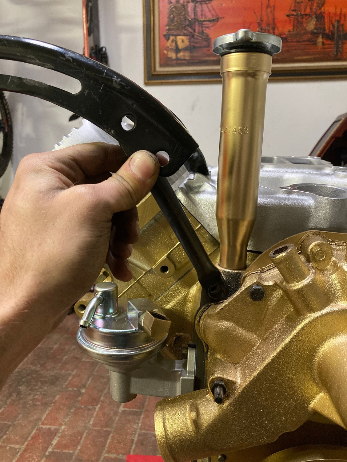

Is this the correct mounting location for the passenger side alternator bracket?
