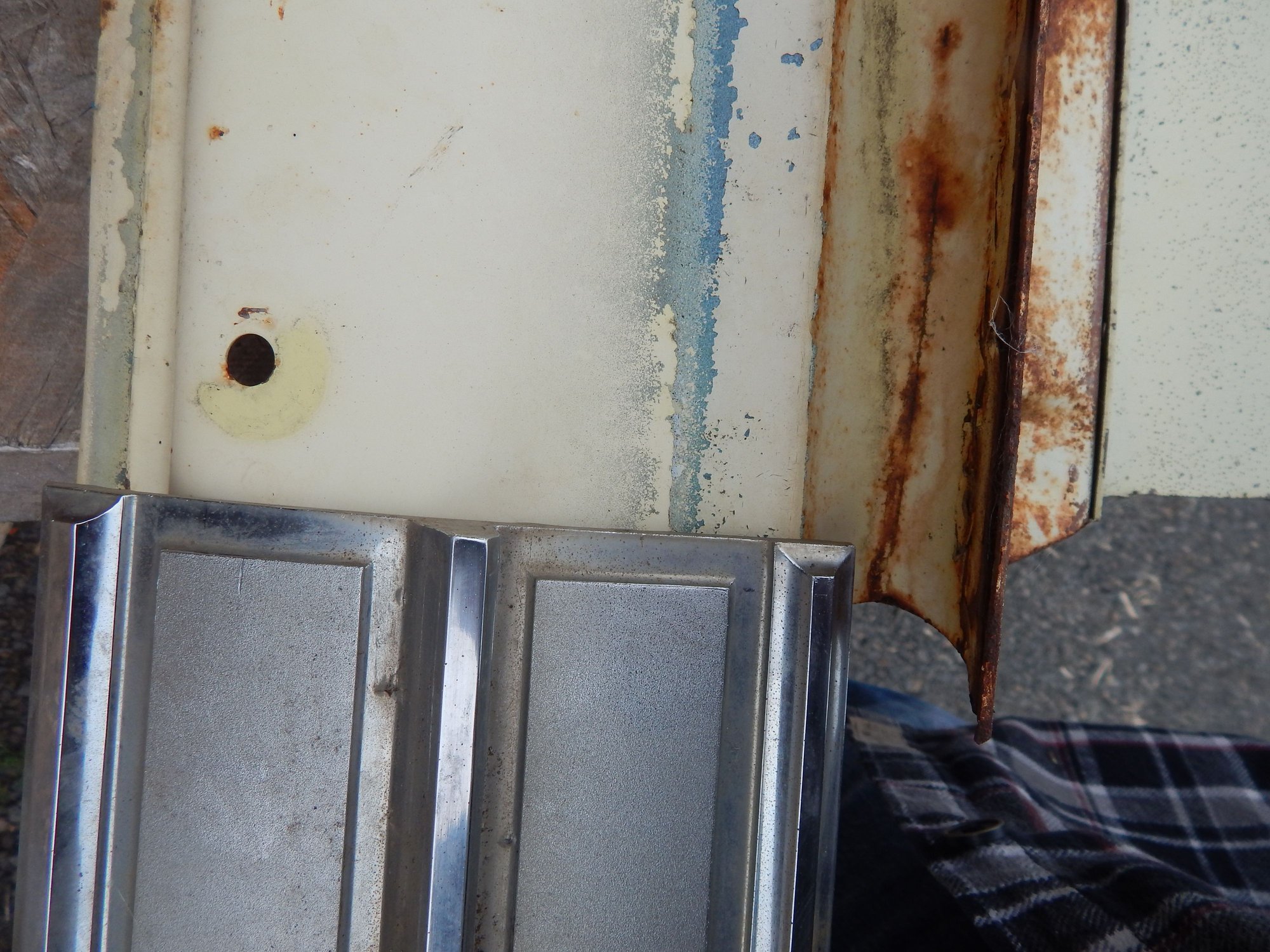

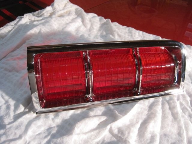

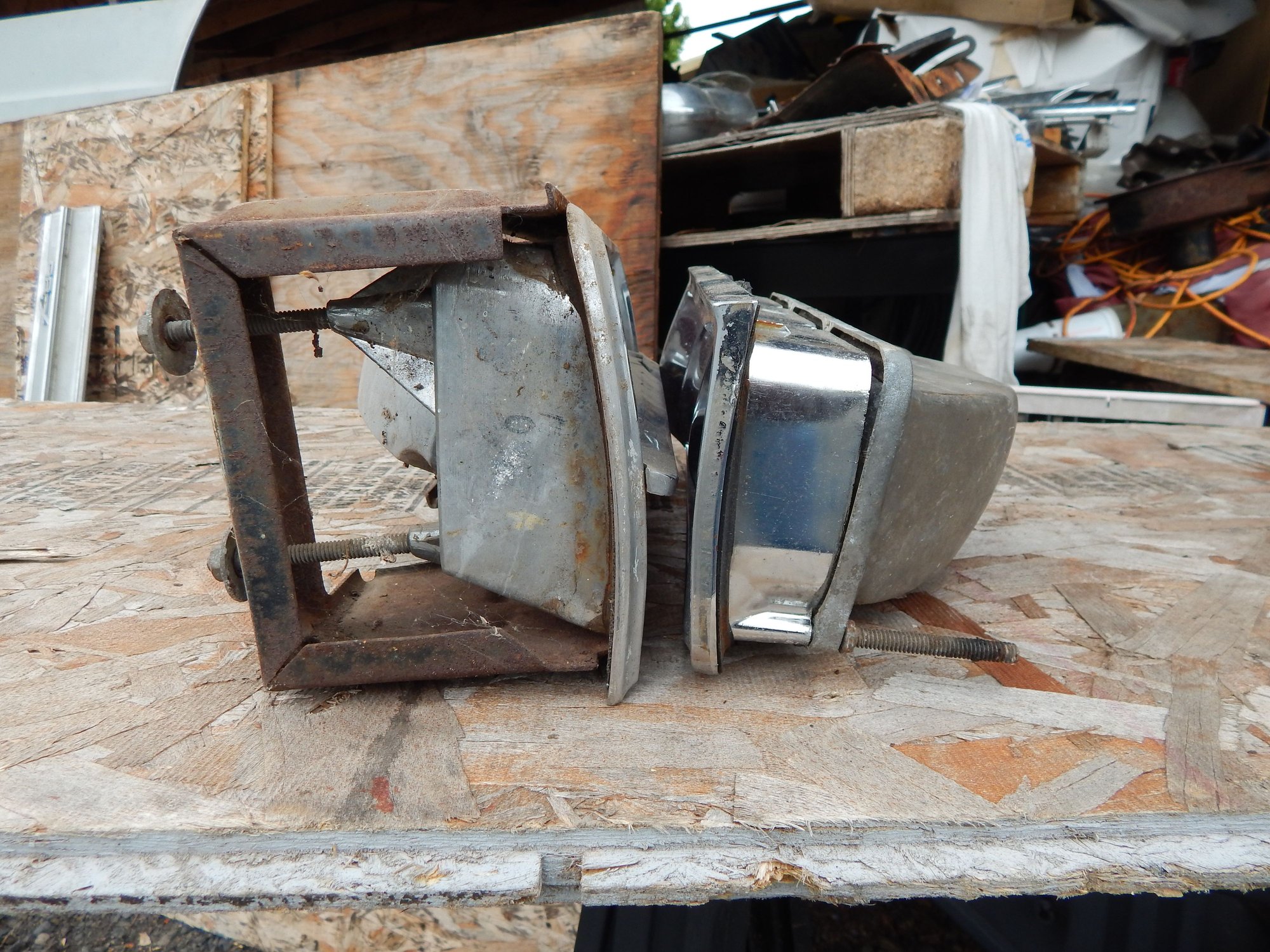

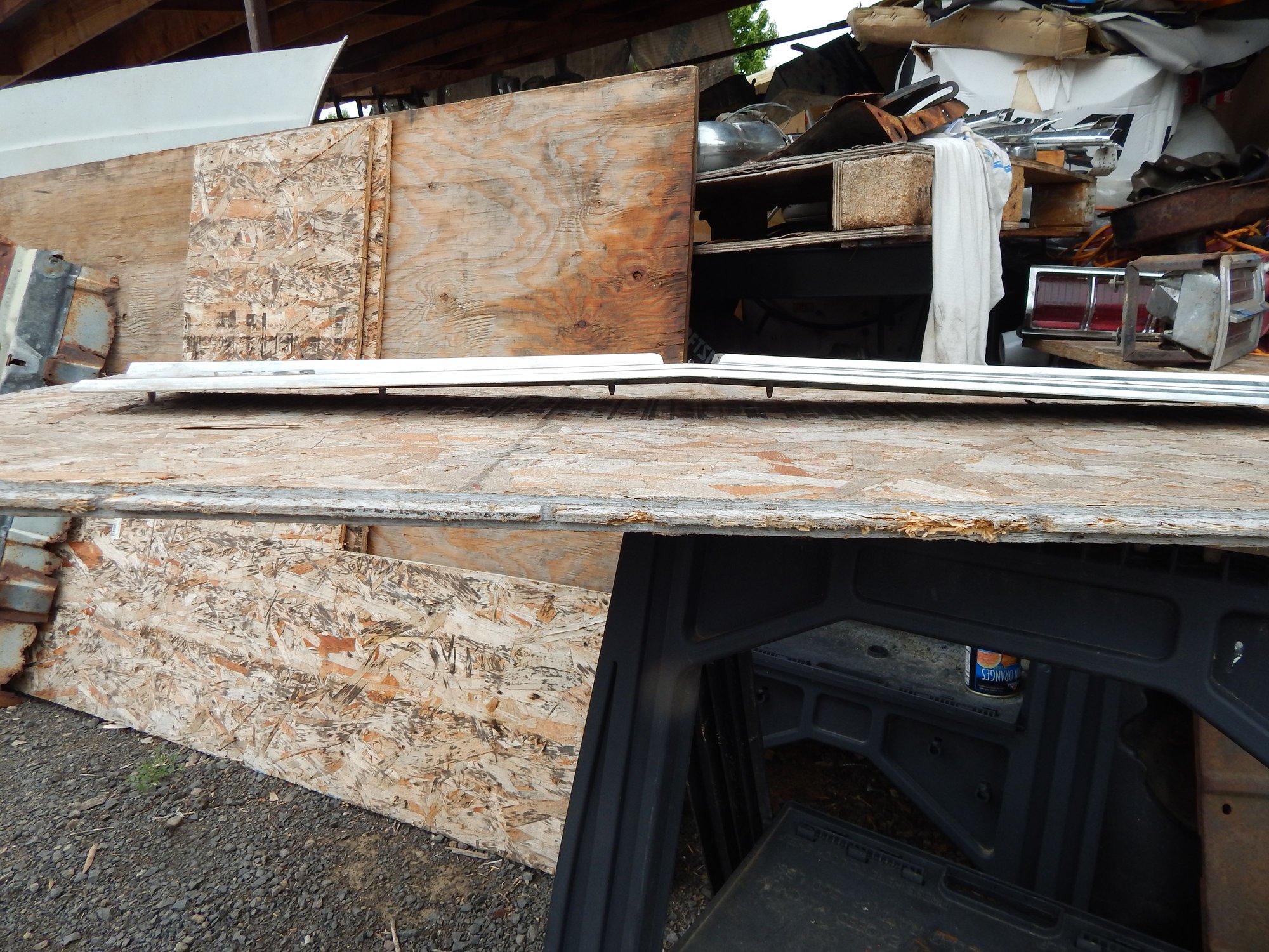

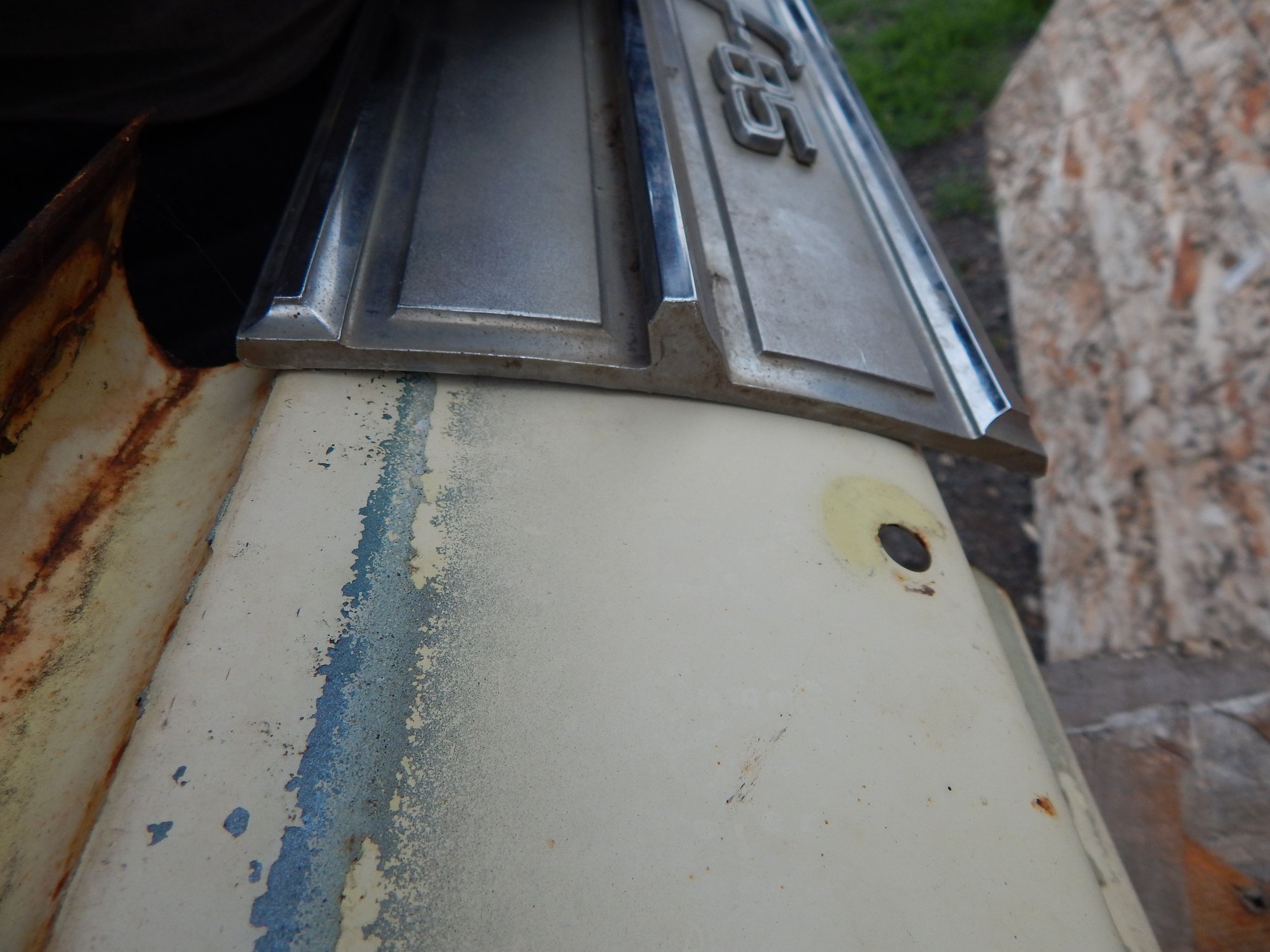

Old May 16, 2020 | 07:32 AM
therobski's Avatar
Posts: 3,190
From: Dallas-Fort Worth

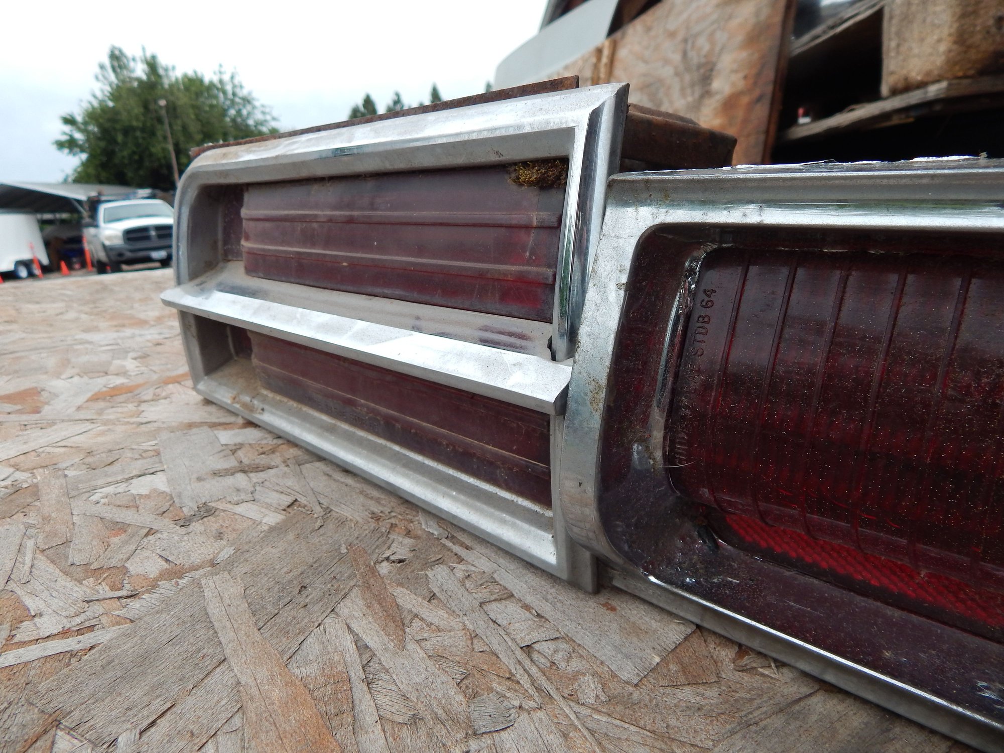

Here are some pictures of a 64 tail light housing and lenses, it may help figure things out..

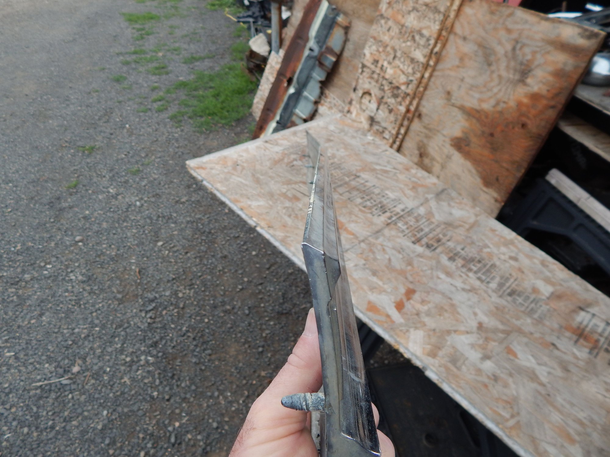

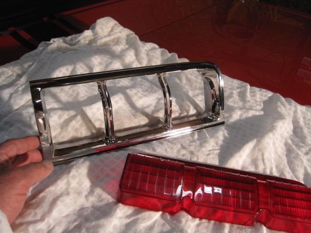

Yes, I agree with the others. You'd need to do metal work to make them interchange and in my opinion your car is way too nice for that! I've got the tail lights side by side but wasn't able to locate a loose 1964 OLDSMOBILE panel this morning. I do have a 1965 panel set against the Sheetmetal between the tail lights on a 1964. The 1964 panel is shorter and the 1965 has a light peak in the center. Let me know if any of the pictures are unclear or if you want to have measurements of anything. John

64 vs 65 tail panels and lights
Thanks to everyone that has responded to my question. I could not see the differences on the car,but with your side by side pics I now see what the differences are. Now I might have to spend my money elsewhere. LOL Thanks again Bassinguy
