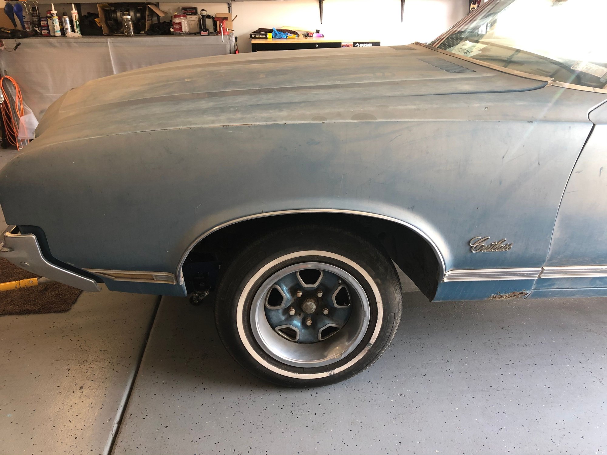

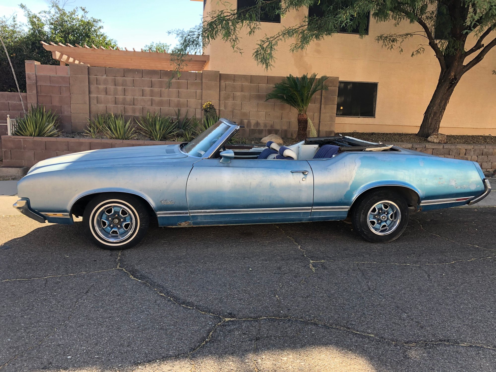

Never noticed the wheel well trim on a covert was different fron the hard top.
its like 2 inches shorter because the side mouldings I guess?
I noticed because i was thinking if I paint it and want to leave the side mouldings off.
they would be too short.

Yes, 70-71 Supreme(convert and hard top) wheel well moldings are cut to match the side trim. If you remove the side trim you can use the uncut moldings.
Removing the side trim requires grinding off the mounting nubs that are welded on at the factory. This will make it difficult if you decide to re-install the trim later

As said above, it's not a convertible vs hardtop thing - the short trim is a 70-71 Supreme thing, either convertible or hardtop.

ahh never new that one! Thanks
so I would need new mouldings if I delete the side trim, and get rid of the mounting nubs

If you delete the side trim you will also have replace the side markers. 70-71 Cutlass Supreme cars did not get the side marker bezels chrome plated because the trim covered them.
