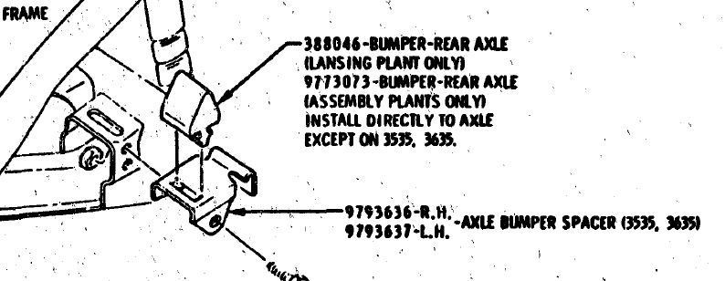

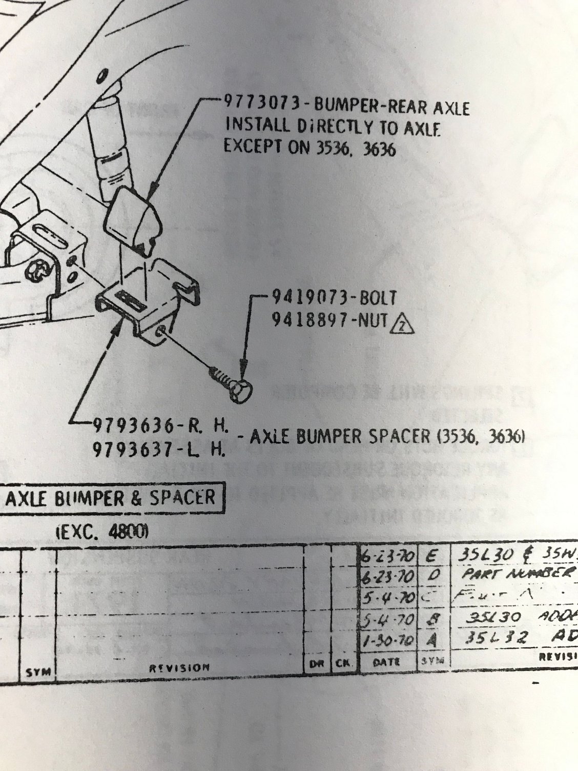

Ok i found a pic and info in the 1970 assembly line manual. pic is blurry so the part # cant be seen. says its for 3535 and 3635 cars?

# 9773073

OK I opened up a couple more Assembly Manuals from various years & I think I found the numbers for the "bracket" itself which is now what I believe you want the number for. Give me a couple minutes to find those numbers.
Old Oct 1, 2021 | 05:32 PM
Posts: 26,056
I'm pretty sure the two numbers are the complete numbers - I'll check another manual for you. 9793636 & 9793637

9793636 rh---9793637 lh.

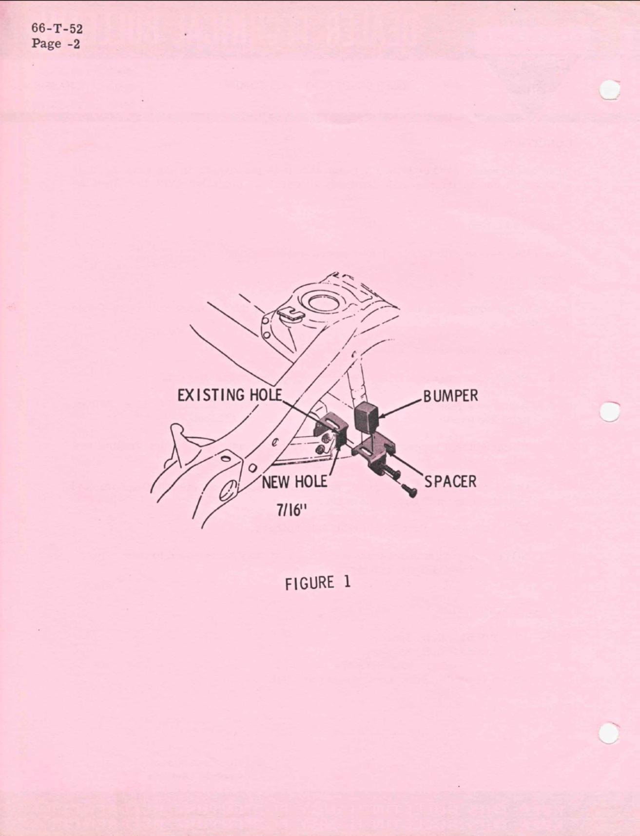

Old Oct 3, 2021 | 07:23 AM
Old Oct 3, 2021 | 11:56 AM
F-85 4-4-2's Avatar
Posts: 941
From: Hinckley, Ohio
"When accelerating hard or hitting a bump with four passengers in the car, ..."
So a driver and four passengers? Exactly how large are these passengers? Not after an answer, just loving the days of simpler times. Like an old service manual, one that assumes a lick of mechanical aptitude.

Excellent! and you can clearly see the added bracket

Obviously, those part numbers were not incorporated into the 1970 PIM, as can be witnessed via our posts from the 1970 PIM (above). I reviewed a 1969 PIM and I can attest the part numbers Joe provided are not incorporated into the 1969 PIM. I cannot speak to any 67 or 68 model year PIM.
NOTE: There was, however a difference in Part Numbers for the bumpers themselves for the 1969 model year based upon either a Lansing Build or all other Assembly Plants (compare to the 1970 PIM). Bracket numbers remained same for 69 & 70.
